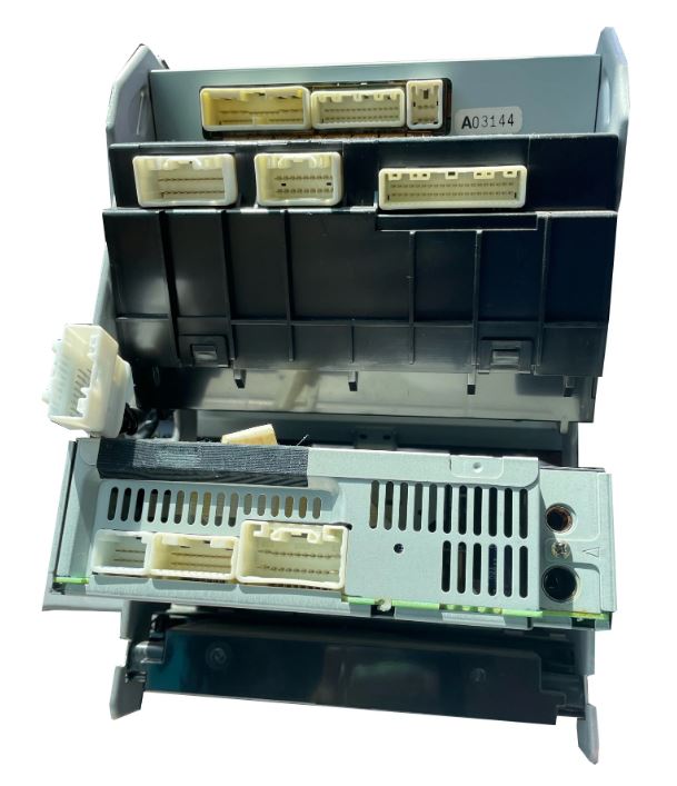

Not sure if it makes a difference, but this is the back of my stock radio (pic below). Do those with no issues have the same setup? Looks like my issues are the same as @JJ_SC

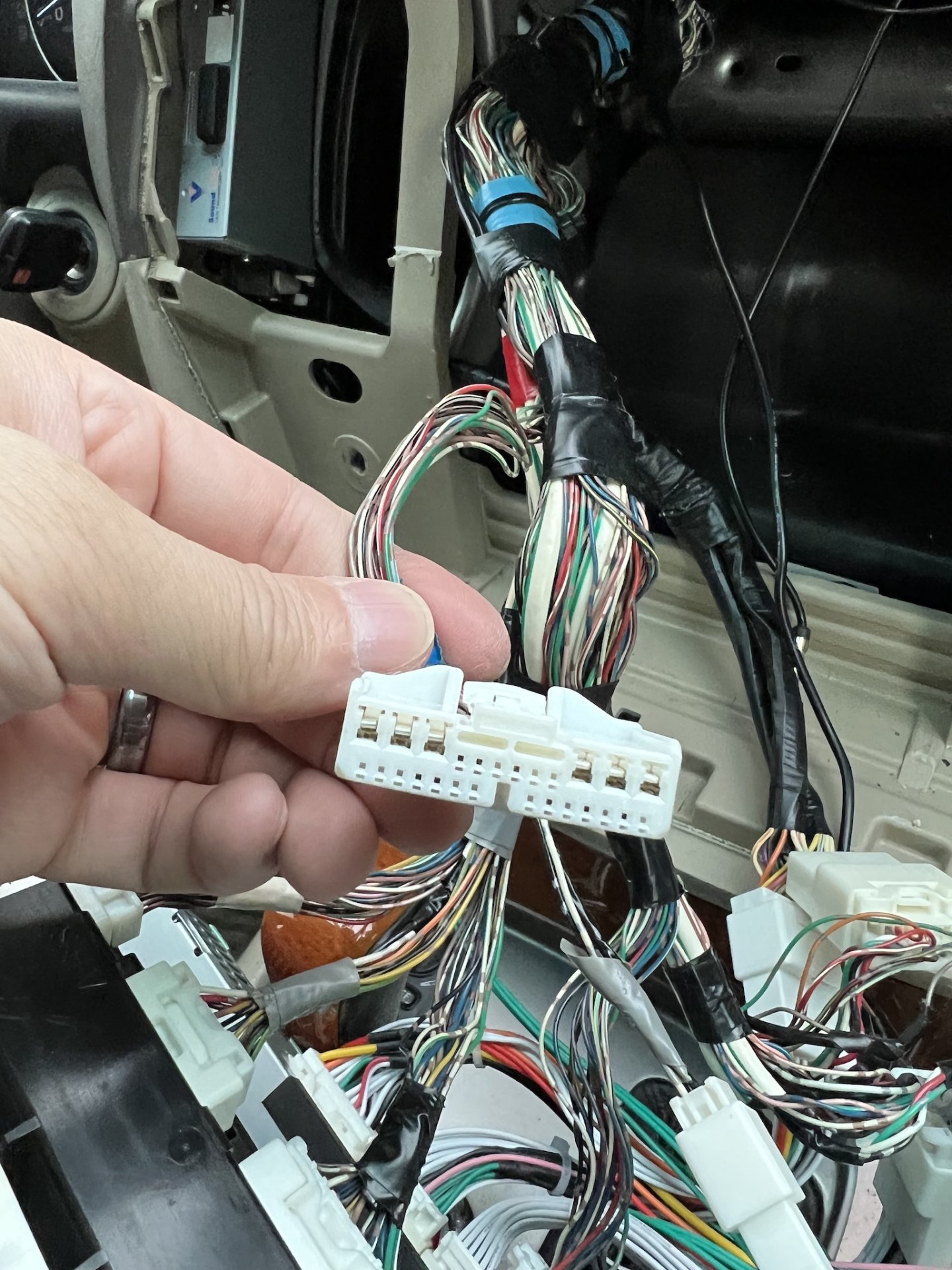

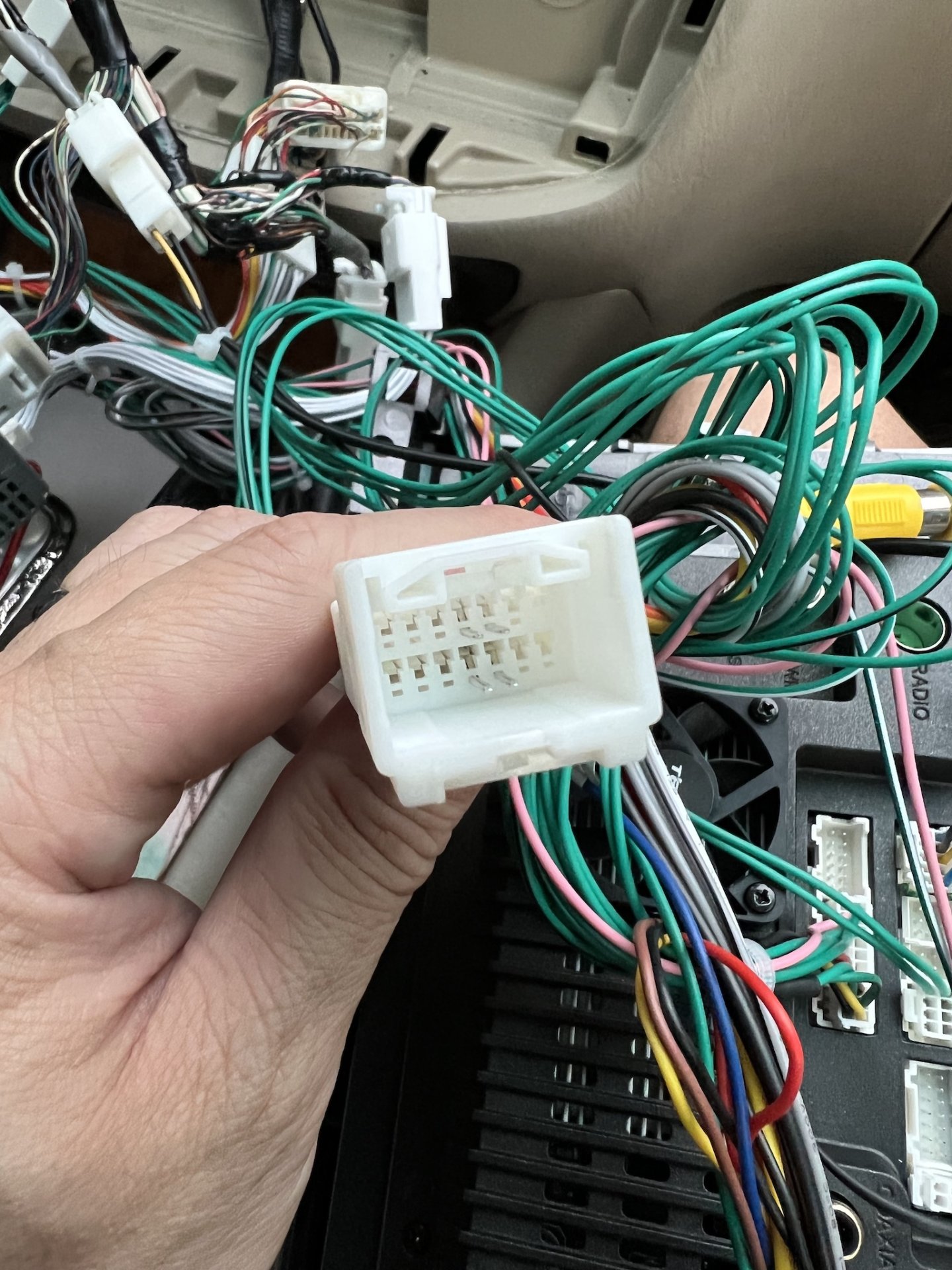

I got my unit, plugged everything in. Except there was one plug from the car and one plug from the unit that don't fit each other. The Teyes doesn't power-on. If I take the lone plug from the car and plug it back into the OEM head unit, the screen turns on. So I think those two should be connected to each other. I've contacted Teyes.
This is the connector on the Teyes adapter that doesn't take anything.
This is the last loose connector from the car which you can see won't fit into the other one.
If i remember correctly one of the plugs from the Teyes Harness doesnt connect to anything. Use the common sense approach if the plug fits it goes in it. If not leave it off.
@xswl That connector from the vehicle side goes into a "conversion" connector. See pic below from the link below the picture.
