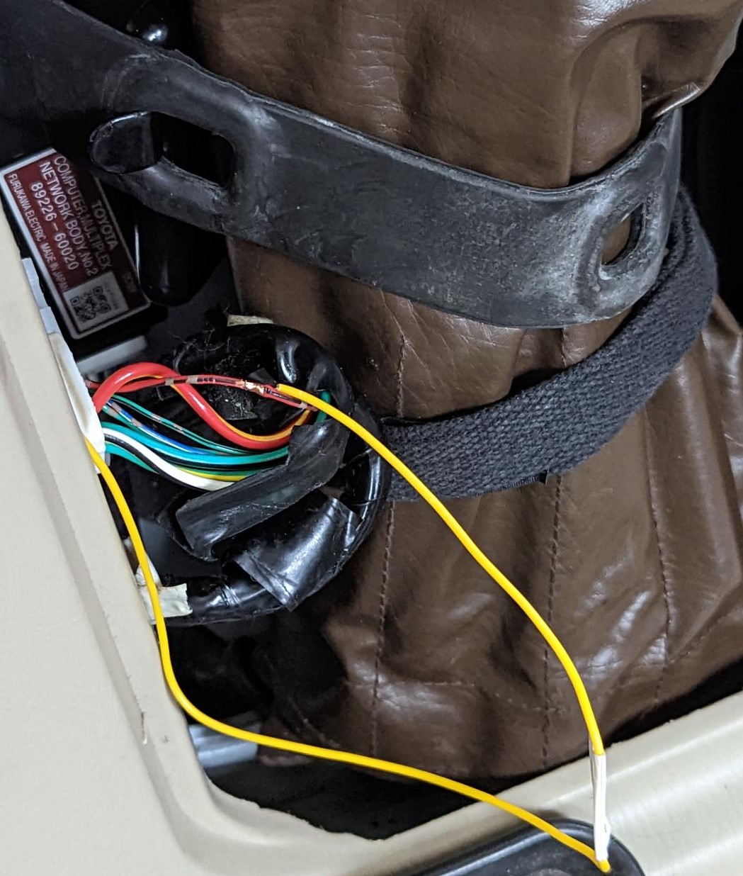

Call me surprised - what about the 6V camera (HU is 12V)?
He installed a 12V -> 6V converter somewhere near the CC3, and then tapped the black/red wire in the camera harness, which is easily accessed in the tyre tools storage area.

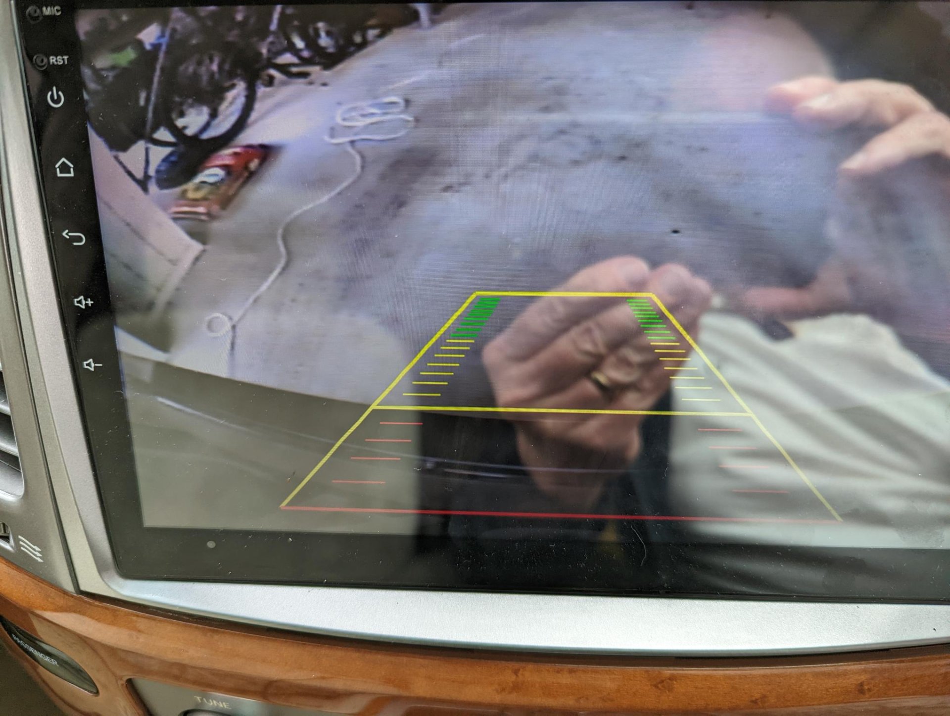

The only issue - the CC3 has these guidelines which I can't find out how to remove. There's a "Cam REC" app which shows the image without the lines...
(Edited - Dan from T'eyes helped out with solution:
Settings - factory settings - 168 - vehicle agreement - reverse lines - turn OFF)
Clear picture of the rear harness, yellow wire tapped into red/black wire (before being taped up).
And a poor picture - car was outside in the sun - showing guidelines.

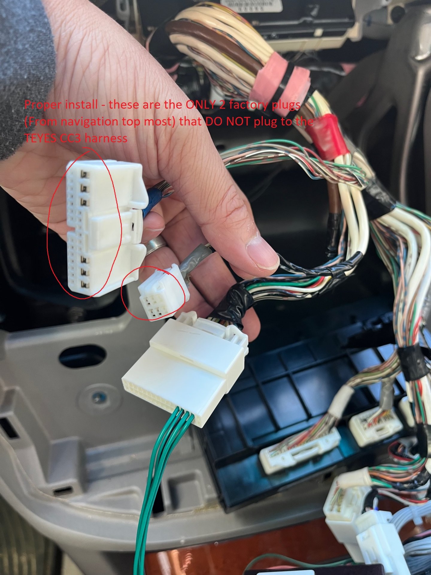

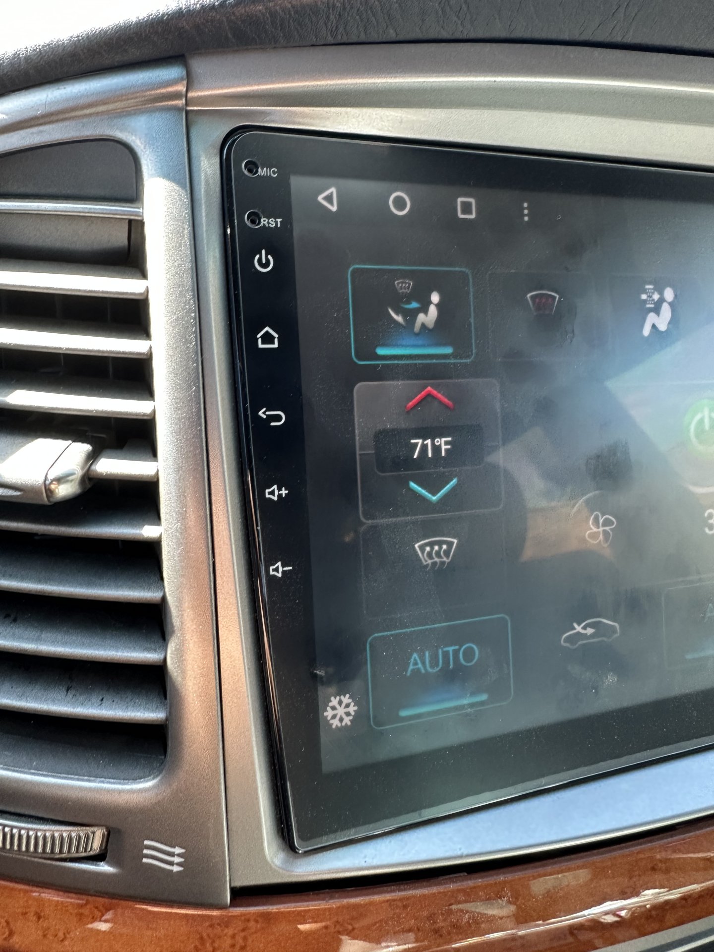

Update: I got the AC finally working. There is one last plug from the provided harness (the one with only 4 green wires) that I plugged into one of the factory plugs (one of the 3 that you pull out of the factory nav, these are the three plugs at the top most when looking from the back). Then, I made sure the CanBUS setting was correct as others pointed out. Then, turned off the ignition and started the car. The CC3 unit will shut off and boot when you shut off the engine and start the car -- this did the trick to "sync" and got the AC working!
I may be lucky but EVERYTHING is working great - no hiss and sounds amazing, factory volume knob works, tuning knob works, steering wheel buttons work, AC works!
I made a video taking you through all the plugs - its better than pictures. In the video, where I threw a "thumbs up" in video - those connectors from the TEYES harness are not meant to be connected. Note that I choose not to connect the "yellow" RCA camera in - don't want to deal with splicing wires, so mine is not hooked up to the factory backup camera. I'll look into that later perhaps.
I made a video taking you through all the plugs - its better than pictures. In the video, where I threw a "thumbs up" video - those connects are not meant to be connected.
