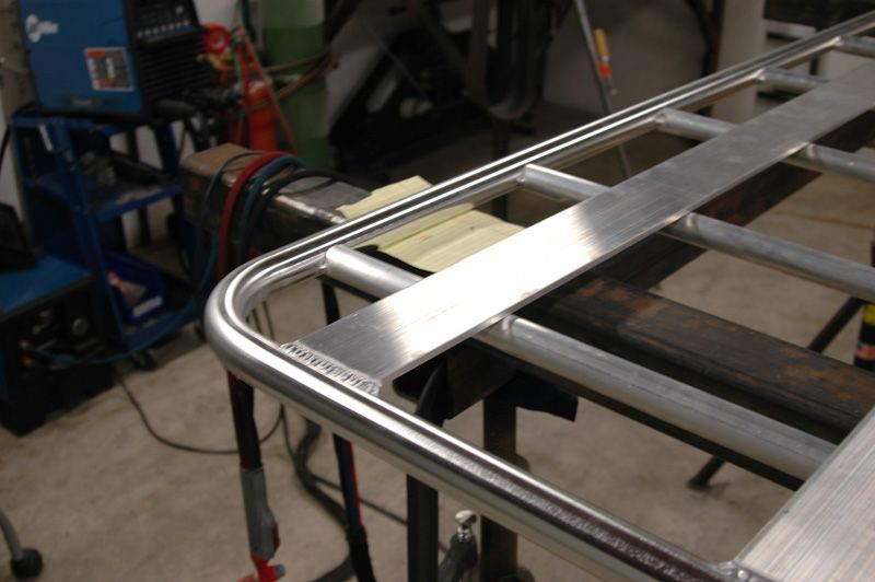

I chose to use polished anodized aluminum on the outside piece that would be seen by anyone looking at the truck since it would match the polished clear coated LX wheels, and the inside rails and slats are raw unfinished aluminum to save a little on cost.

Picked up my roof rack from Travis Clifton of Houston Aluminum Welding It is exactly what I wanted. Very light under 45lbs, the Gamiviti mounts weighed almost as much as the rack and plenty strong. I am working with Travis on some wind noise, I have a couple of ideas and so does he so I am sure that will work itself out, but I am very happy with the rack and the craftsmanship is awesome!
Just kind of goofing off tonight I loaded up the rack with 580lbs of olympic bumper plates, three 5 gallon Jerry cans of water, a 55lb kettlebell and a 72lb kettlebell. (no that's not what I take camping but easy to load and test). So just over 820lbs and no deflection, no sag, no real movement at all, very impressed.

Ok here is a picture of the rack loaded with roughly 700lbs, not bad for a 45lb rack! I didn't do the kettlebells because it was getting dark and because I am turning into a wuss. My neighbor walked by while I was loading the rack and he was like didn't you just do that yesterday.... He shook his head and said you have too much energy.
