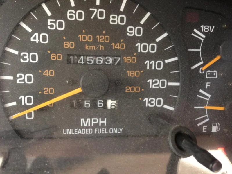

- Still have a lot of work to do on the tune. Truck is running way too rich at cruise not under boost. Seeing 11:1, so will have to work with that. Because it is running so rich it is affecting gas mileage. I know we can lean it up and get at least 20% better gas mileage.
My control loop is 173 miles GPS, 155 miles indicated. I do it with the cruise control set at the speed limit either 55mph, 65mph or 70mph GPS verified depending on the posted limit.
Only difference was before was done without the A/C on, the after was with the A/C on max. lol
Before gas mileage 16mpg
attachment.php
After gas mileage 11.7mpg
