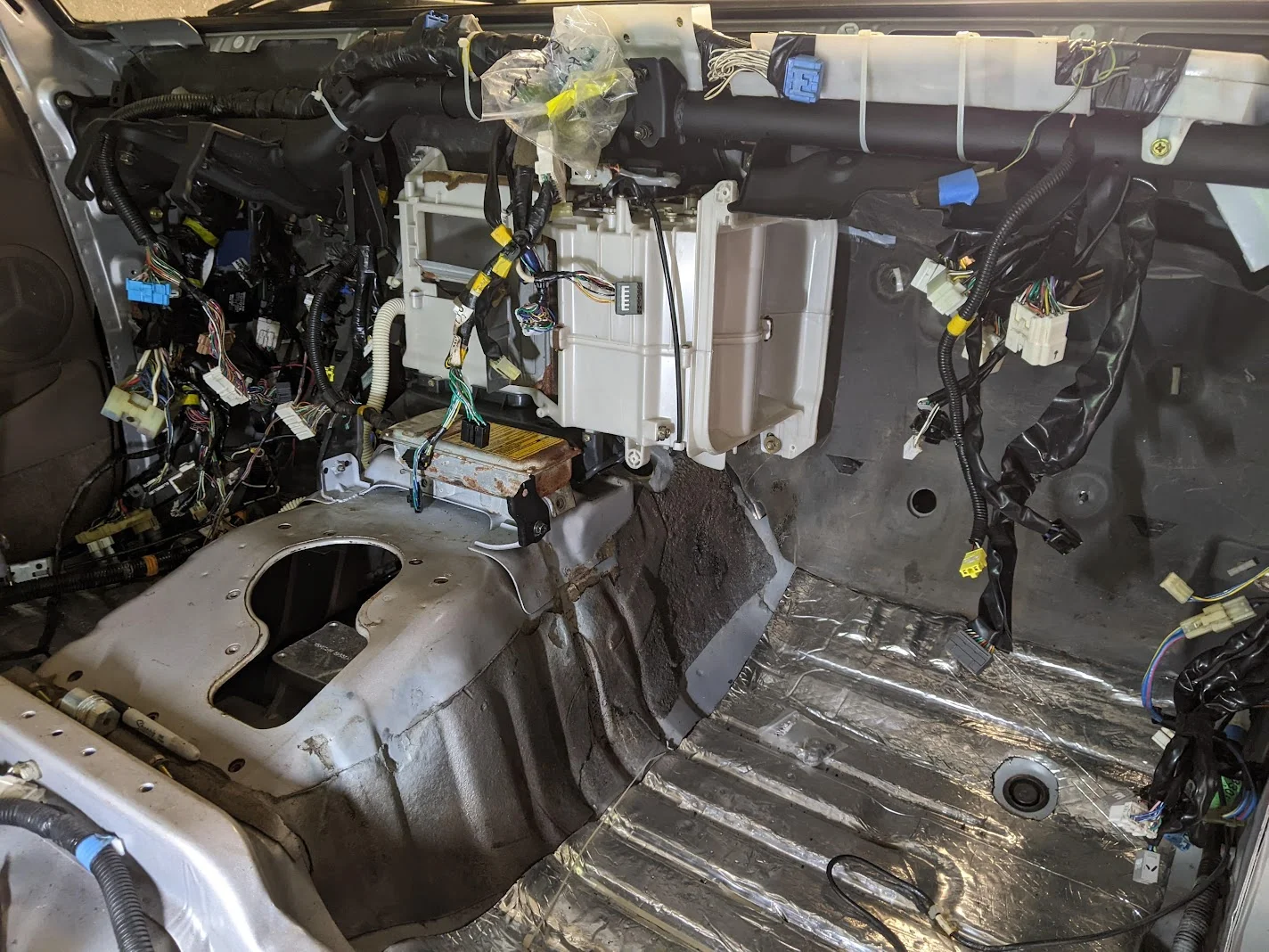

Heating Core HVAC in.
My advice, take plenty of photos of every possible angle as you take something apart. Trying to figure out where each wire pigtail ran was a task in of itself. I only had one photo to refer to, and it wasn't at a great angle.
The plan is to put the dash back on after the motor is wired and running.
The feels when you realize you forgot to put in the defroster ducting.... 🥹 See post #82.
Yep, the defroster ducting is put back in right after the inner dash mat, and before the cross bar, and wiring.

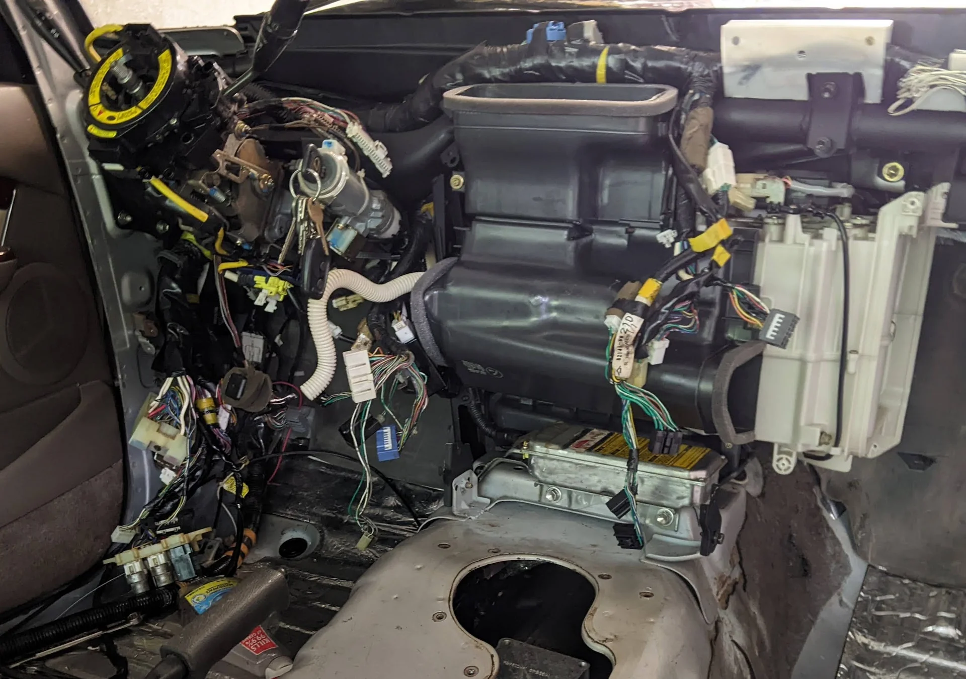

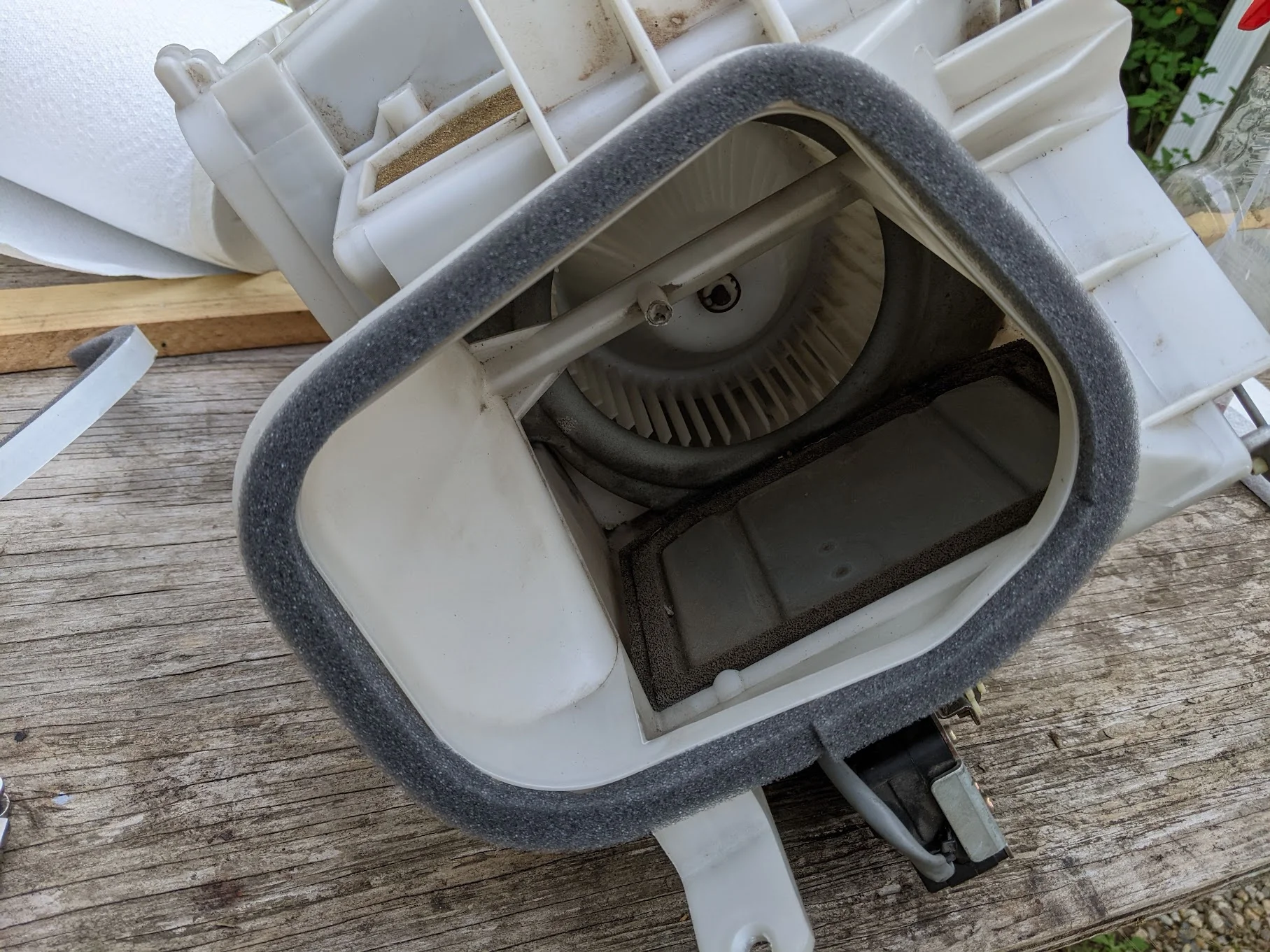

Blower Assembly got new foam (as well as the other duct work). As far as I can tell, Toyota uses run of the mill open cell foam. It needs to be fairly compressible..
This top bolt on the blower assembly is a pain in the ass to get to. Toyota puts a rubber end cap on it due to the nearby wiring.

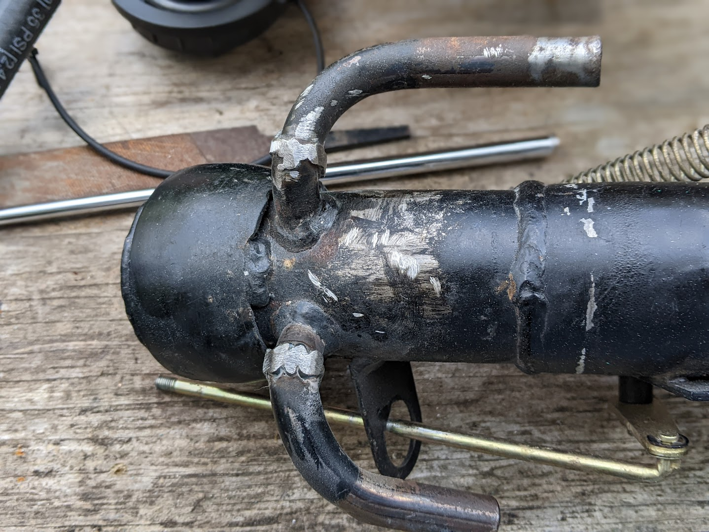

Steering column back in...still connecting everything.

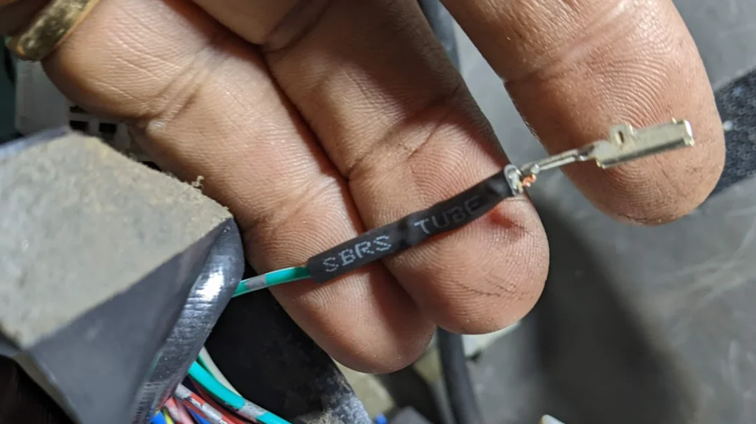

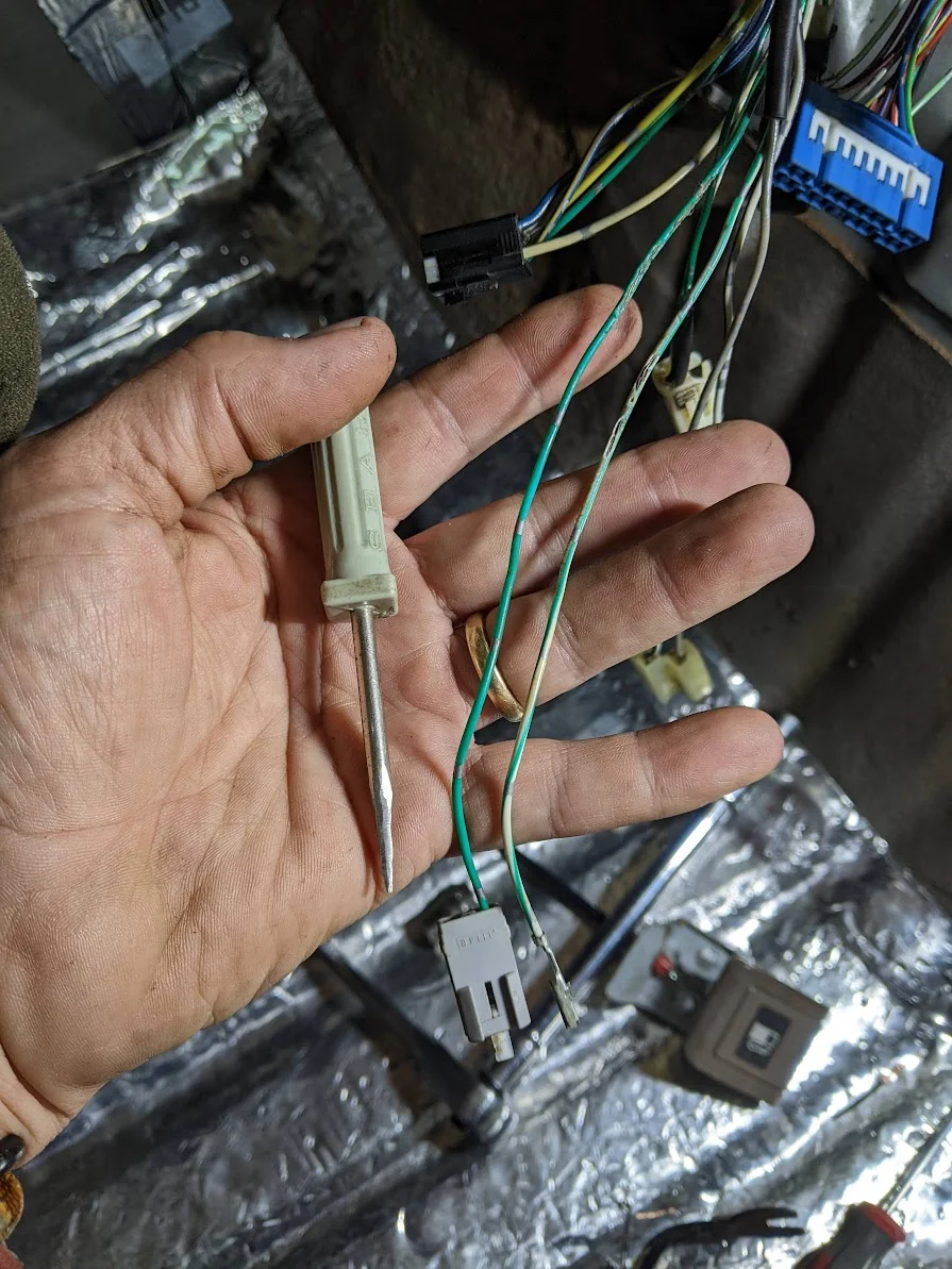

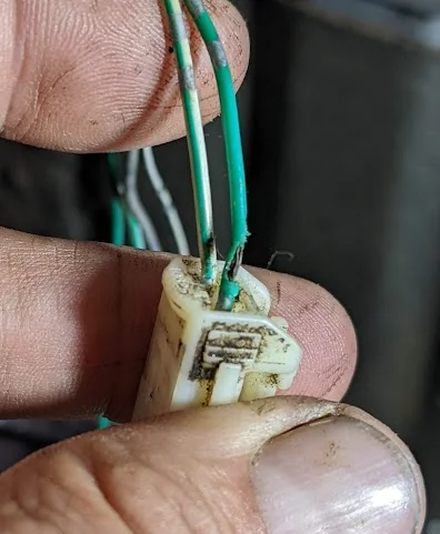

It is always hard to figure out how to de-pin a particular connector, and each one is different.
The ID2 has a connector lock, which has to be disengaged before you can de-pin a pin.
I didn't notice it first and spent way too long struggling... 😉
This is what it looks like with the lock is engaged. Hardly noticeable when you are sideways under a dash. 😁

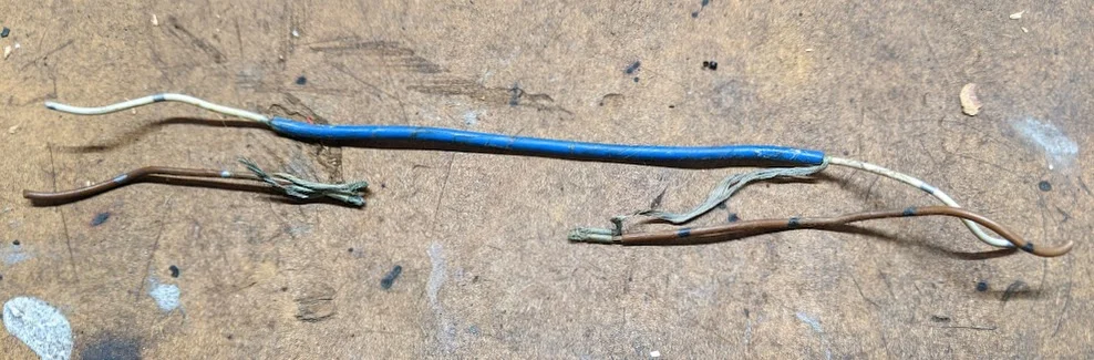

I had to fix the insulation on more wires. I finally made a tool to de-pin, as suggested by Toyota. Screw driver..meet grinder...grinder...meet screwdriver ..
I will be de-pinning a ton of wires soon.
Some of the insulation damage was hardly noticeable
Fixed

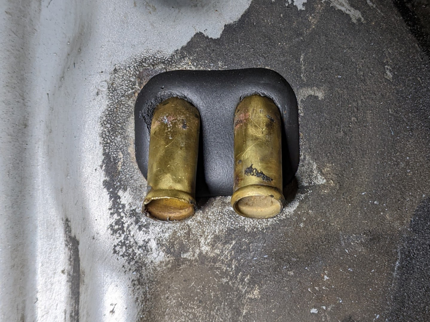

Any chance you could measure the dimensions of the rear heater core?

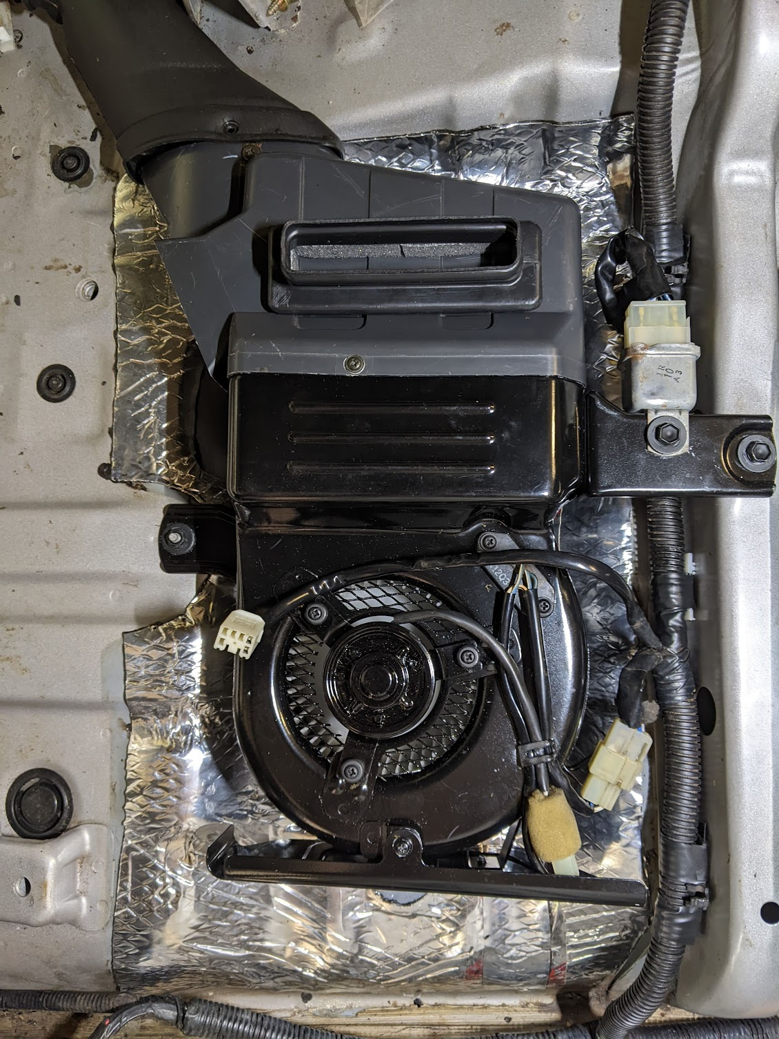

Cleaned and painted the rear seat heater. New sound deadener replaced the factory bitumen.
New 1/2" closed cell foam attached to the bottom of the rear seat heater. I think this is definitely where closed cell should be used, but I think factory used open cell here as well.

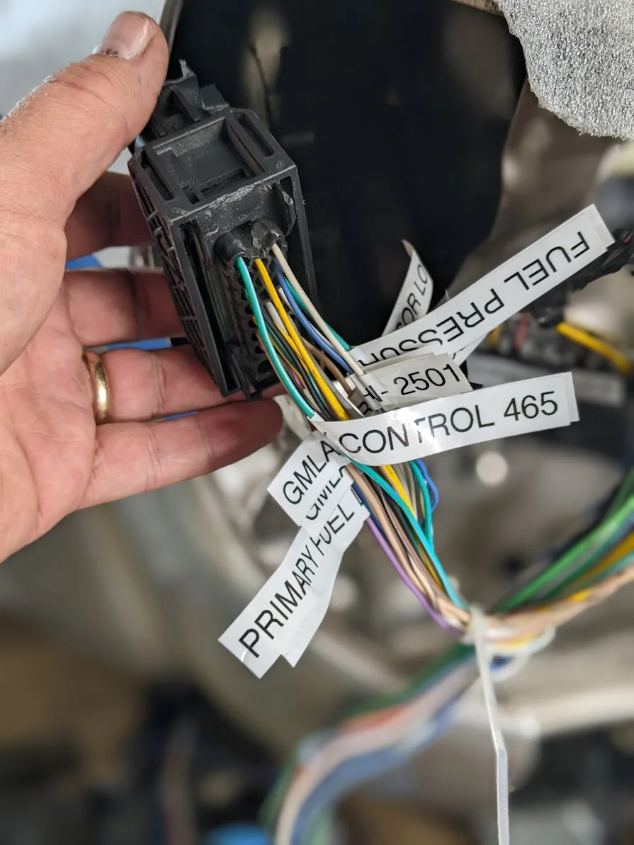

Well, E78 ECM is a bit of a pain to work with. Most web sites, like lt1swap.com, list E38 pinouts (and instructions) but not E78. Cheap E78 harnesses are just not out there... Some people swap out the E78 for an E38 because of this, but I am not sure how that works when you have a 2020 6L90e with its built in TCM. I assume you also have to swap out the TCM to match, or reprogram it to match the ECM OS.
I was able to find a GM Van Upfitters guide for a 2019 GMC Savana that lists all the connectors and pin outs.
I also found a L96 Engine Controller Kit document that also helps with L96 crate engine swaps.
So, this is where I am...labelling...
At first, it seemed very overwhelming...but the labelling has been really helping me understand and identify what needs to be done.

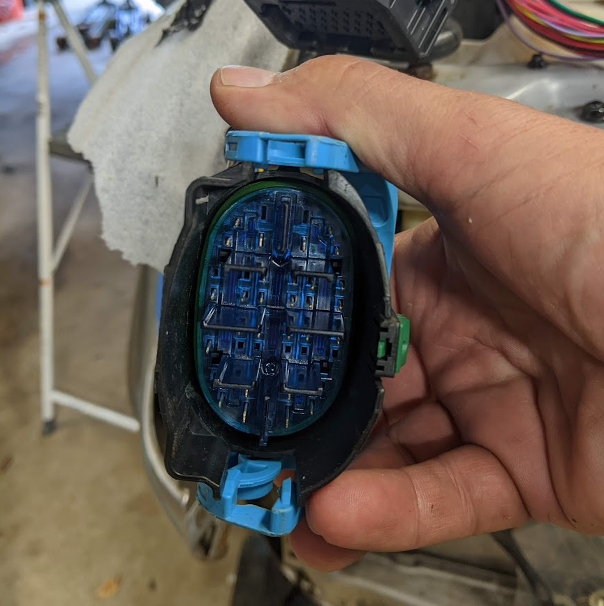

Here is the X1 connector on the E78 engine harness that connects to the van's engine bay fuse box.
This is the X101 engine to chassis harness connector.
I still have to identify and label the other engine to chassis harness connector, X100, and then the elimination of unneeded wires can begin.

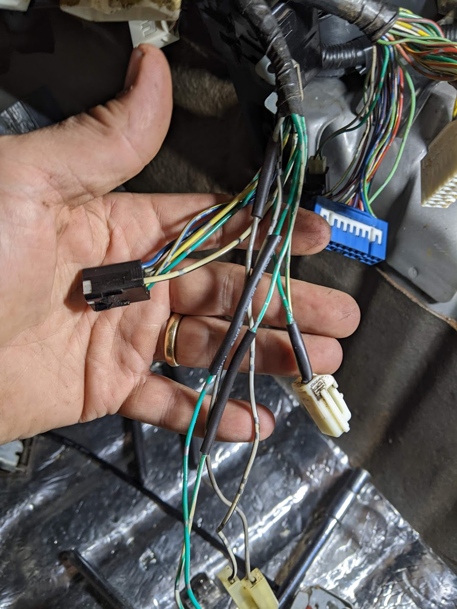

Hey Folks...I have been bin busy thinning the Toyota engine harness, and identifying and labelling IH1 and IH2 wires. FYI, those are named IL1 and IL2 in the LX450 version of electrical manual.
Not much is left of the original Toyota engine harness. All the T-case wires were left unmolested and Ignition On (14 IH1), Ignition Crank/Start (15 IH1) were identified.

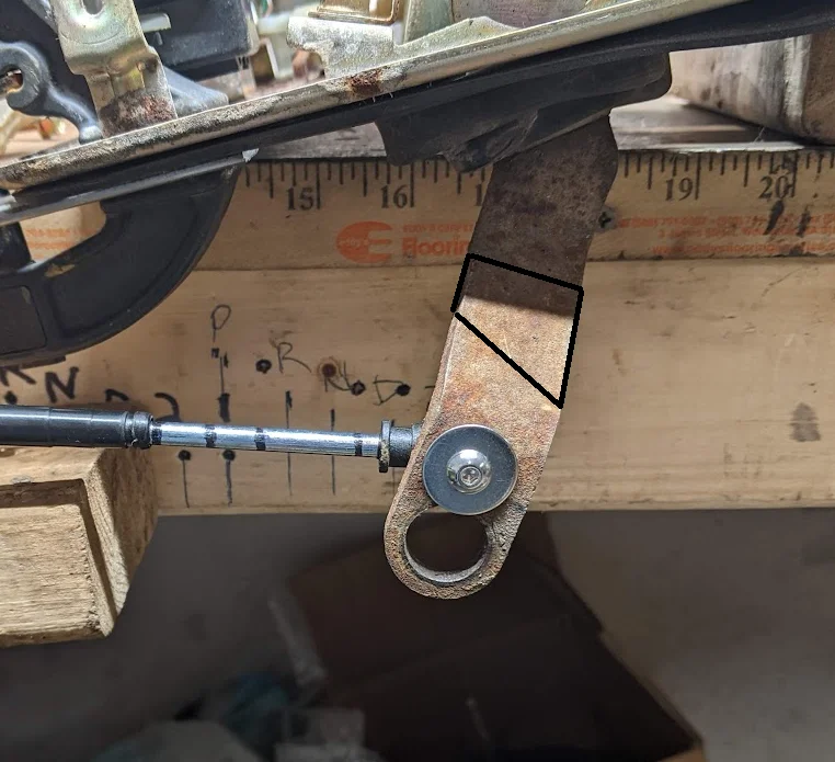

What is odd is that the transmission lights (PRND2L) all go through IH2/IL2, but one: Reverse, which goes through IH1.

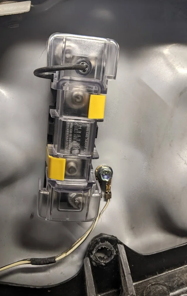

Also, I decided to make the passenger side battery primary. The starter is on the passenger side and it requires the most current draw.
With that in mind, I added a MEGA fuse to passenger side to connect the passenger side battery with the driver's side, where the Toyota fuse box is located.
Moved the ground wire over to make room for the MEGA-Fuse. I used M6 nut inserts.
Here they are from the backside.

Added another MEGA fuse on the passenger side to supply power to the GM Computer/Motor, Fuel Pump, Fuse Box, and the MSD Relay Box. The Starter shouldn't be fused and needs to be connected directly to the battery.

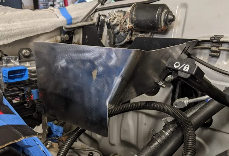

I finally decided on where to mount the remaining electronics: fuse panel/relays/MSD relay...
I made a wrap-around panel that bolts to the DeltaVS washer bottler mount on one end and to the inner fender on the other.

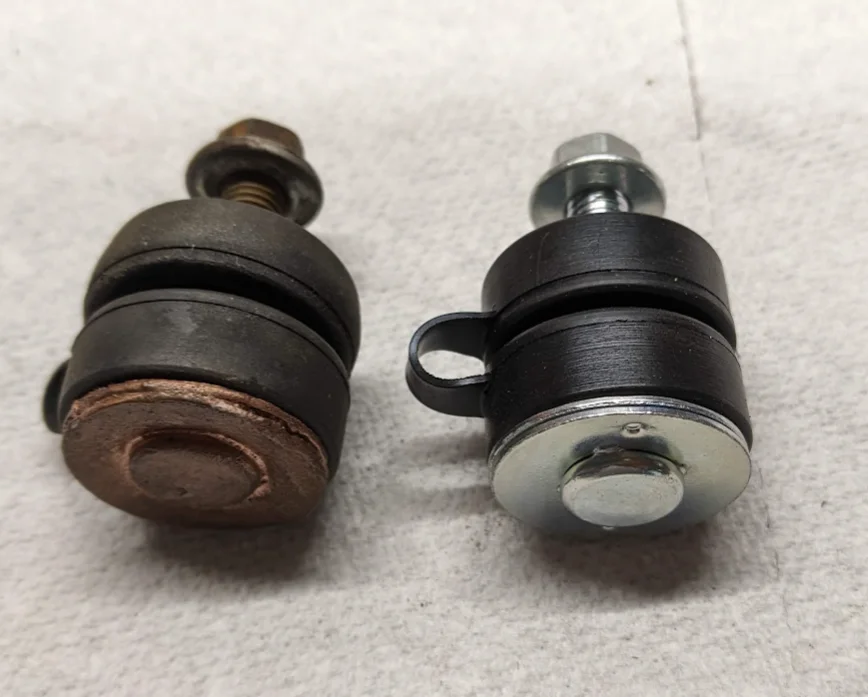

Replaced these transmission things on the radiator. The old ones look like s***, but they aren't too bad after I took a closer look at them.
New radiator support grommets and brackets. Old vs new. The big radiators grommets were also replaced.

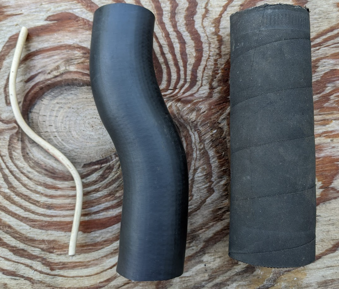

I don't like the 1 3/4" Gates hose that comes with the kit. It is too large, and it is too stiff to make the bend. I am looking for alternative fuel filler hoses. The aux tank sold today from Long Range America uses different components and a custom filler neck.
The wire below is the shape I need for the aux tank filler hose. The middle hose is only 1 1/2" inner diameter, but would have worked otherwise. Close...but not good enough. I need 1 5/8 (or 40mm) inner diameter. The Gates hose on the right is what came in the kit. Ultra stiff and 1 3/4" inner diameter.

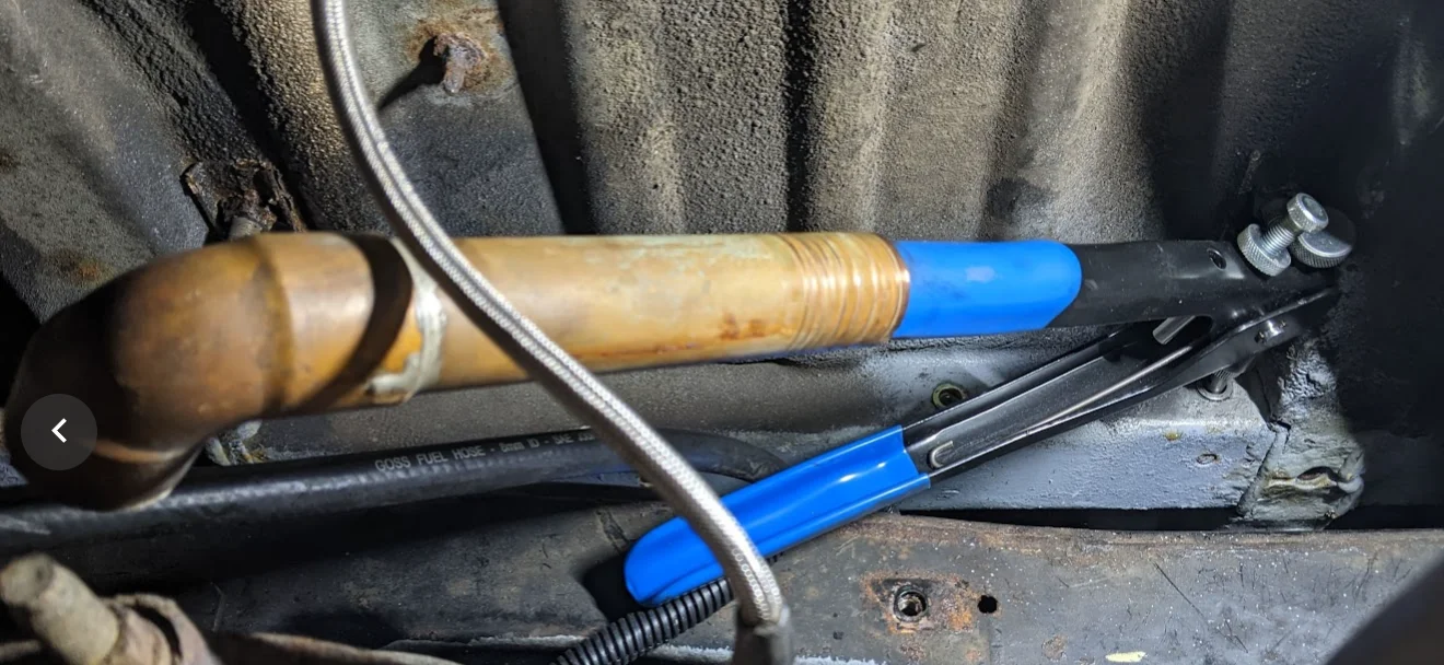

I bought one cheap tool to do one thing...set a rivnut in a corner. My normal rivnut tool is too big.
This rivnut tool is only designed to work with softer aluminum rivnuts rather than the steel. In the photo, I am using 1" copper pipe to gain more leverage. 💪 I didn't break the tool and I was able to set the rivnut. These rivnuts will be used to hold OTRAMM fuel filler neck, which I had to shift forward due to the dual filler neck. The front filler is about 1.5" forward of the stock location.
Plus, I snapped off the two orignal bolts..lol and they would be a pain to remove. You can see the remains in the above photo

BTW, I changed that super stiff gates fuel hose to the aux tank to a Nissan hose that I butchered and shortened.

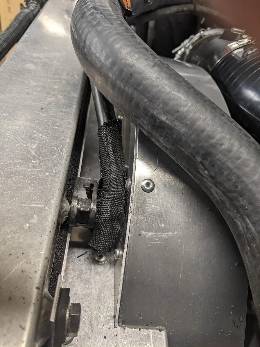

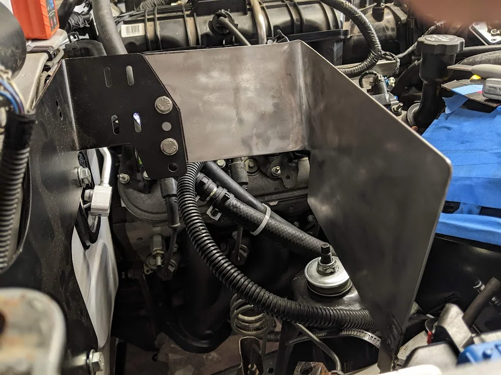

I have been working on my fan shroud. Moving the engine 1.25" forward created a small interference issue. The fan barely rubs the top of the shroud, which means I have to clearance the shroud and recess the circular part into it.

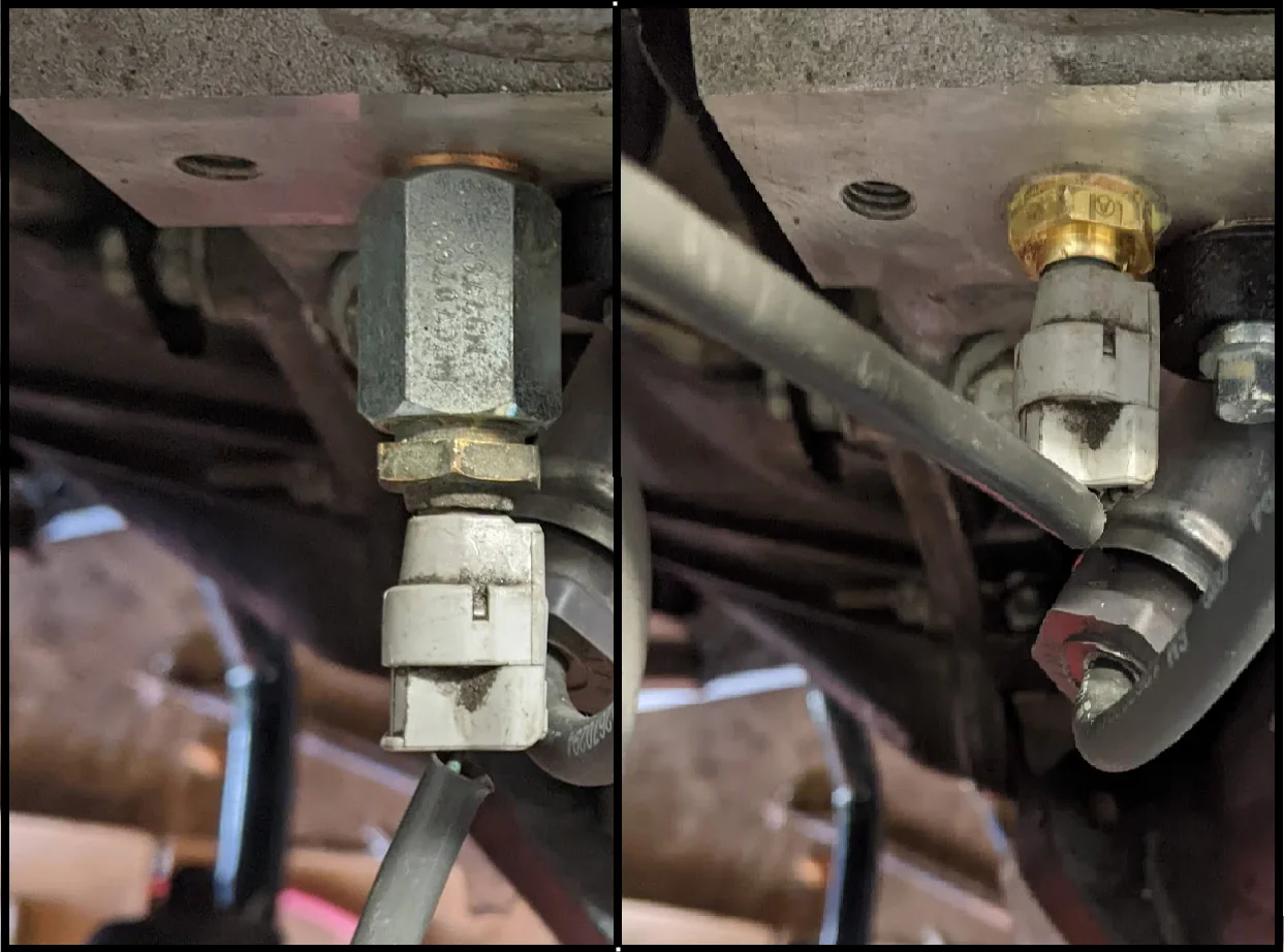

Making a Toyota Oil Pressure sensor work on a LS Motor.
Modified the Oil Pressure Sender pigtail. Removed the AC Clutch wire, and put a 2 pin DTM Deutsch connector on one end.
This allows use the of the original Toyota Oil Pressure Harness (without A/C clutch control).
I am using Mark's 4WD Oil Pressure Sensor Adaptor – to mount the Toyota pressure sender to the back of the GM Engine. This method also keeps the GM oil pressure sensor.
From Mark's 4WD Drive. Bought separately or in a complete kit.
But one can also use Cruiser Matts adapter instead. This method does not keep the GM oil pressure sensor.
The adapted wiring harness now connects to the harness closer to the firewall. Some of the old oil sensor shielding that I removed crumbled when I touched it. I don't think anyone shields wires this way anymore. They now use twisted pair.
The Toyota Oil Pressure Gauge does show oil pressure when the engine runs. 🎉
I discovered that "Starter Diagnostics" has to be disabled in the ECM if you are not using it to start the engine. Everyone knows about VATS, but I never heard of "Starter Diagnostics."
Once done, the engine started! It startled me because I was not expecting it.. 😱 It didn't run long but it did run!
I reconnected the Fuel Relay wire from the ECM to the fuel pump relay. What happens now is the ECM runs the fuel pump for a couple of seconds when you turn the key to On, and then runs when the engine starts. So, the ECM does have power to run the fuel pump relay, it just wasn't because of the "Starter Diagnostic" was enabled.
Modified the GM accelerator pigtail to have a 6 pin Deutsch DTM female connector on one end. There is now a male DTM 6 pin connector on the harness close to the ECM as well. I will make a longer Female DTM to Male DTM extension cable when I finalize the accelerator pedal location.
I decided to figure out why the ABS light wasn't going off when I turned the key to On.
Suspected issue: plug near the center console where the accelerator box is located. Yes, more mouse damage. Speaking of mice, they are attempting to come into the garage now due to the colder weather. I have caught 5 in the last week.
Patched the wires but it was not the right plug for accelerator sensor...🤦did all that work and not the right plug.😆 Found the right plug, and plugged it into the accelerator box and now the ABS light goes off. 🥳

My other big project was working on the fan shroud. Since I moved the engine 1.25" forward, the fan hits the top of the fan shroud. The solution was to recess the ring into the shroud.
Backside of the new shroud, with the ring recessed and trimmed. I used rivets, and rivnuts. The latter was used because I thought I might need to take the ring off, but wasn't needed.
Fan shroud mounted. Not easy to mount the fan and the fan clutch, but it is doable.

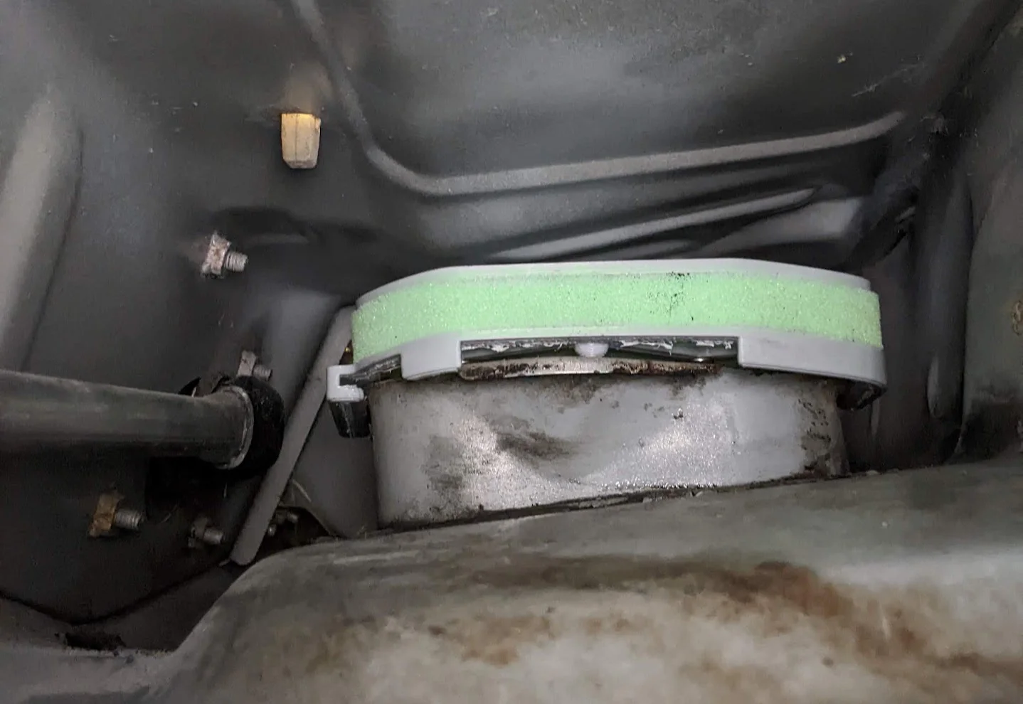

You will notice a cheap air filter in the above photo. I got tired of pulling the big air box in and out and the cheap air filter can stay on until everything is done.
Clearance issues with the nipple, but I think (hope) it will be fine. I could have recessed the ring less, but oh well.

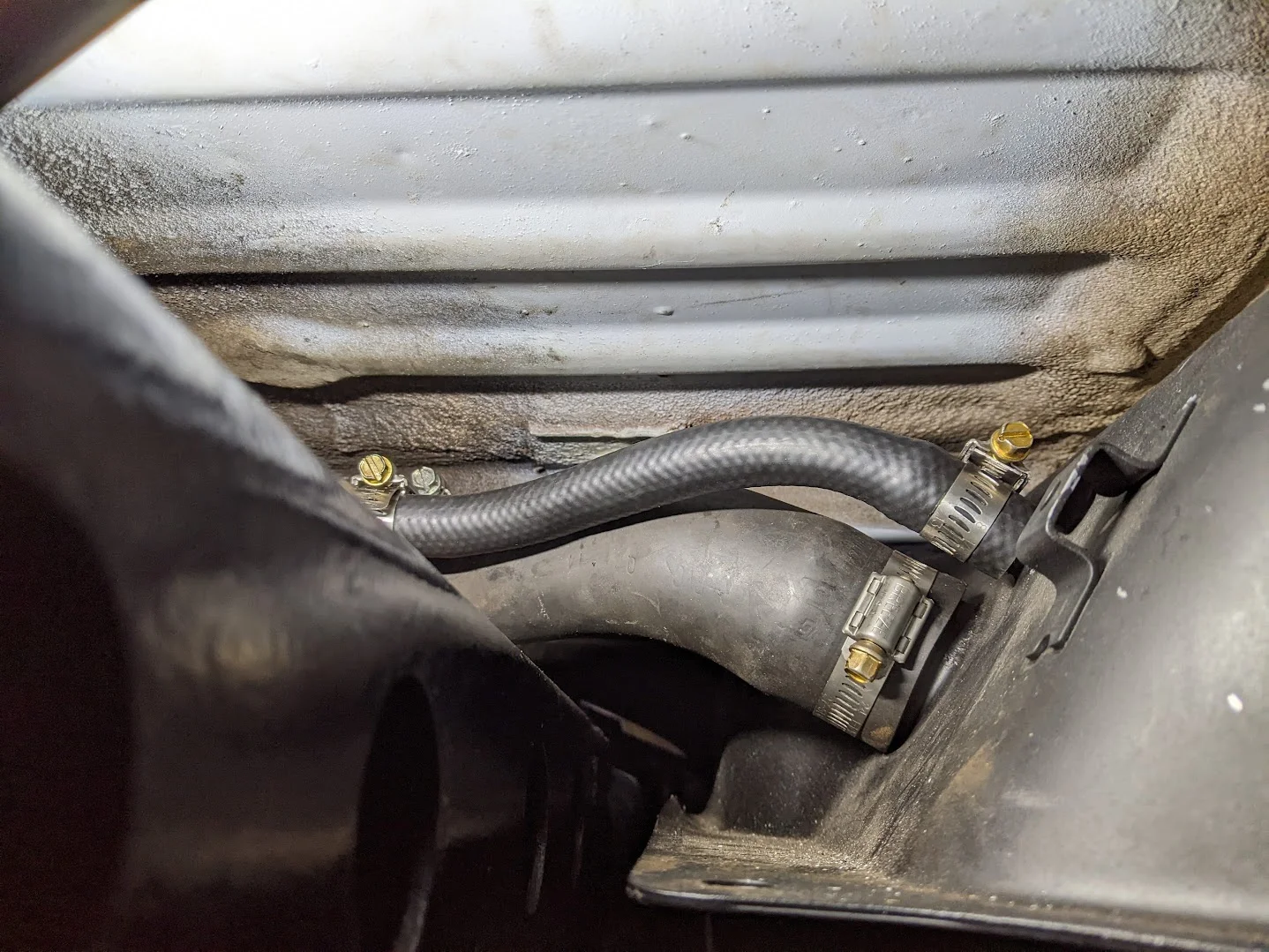

I currently have the heater core at a radiator repair shop to see if they can repair it. It is NLA.
It is something you don't want to repair a second time due to its deep location inside the dash.
This makes me question whether I should be resuscitating an 28 year old vehicle...
*** The transmission stuff is at the bottom of this post ***
The radiator shop repaired the heater core and reinforced some areas. He said it froze at one point and I believe him. With the foam removed, the bend in the top tank is very apparent. The truck had coolant it but who knows how good it was.
It has gotten down to -20°F multiple times over the years and heater core resides deep inside the vehicle. There appears to be no other freezing damage on the truck, including the radiator.
The shop said the heater core is rebuildable and not to throw it out if it fails again but not cheap. Since this is a NLA part, rebuilding it will be the next step.
I have been doing a ton of modelling to get the transmission linkage right.
I determined that the angle which the cable attaches to the lever, and not just the distance from the pivot point, is critical. The problem is that the specific angle required if one attached the cable from the rear would be interference with the floor pan. The lever arm needs to be cut and rotated to fix this issue.
One could also attach the cable from the front and go to a push, rather than a pull configuration. No need to modify the angle of the shifter lever arm but you would need to flip the lever at the transmission if doing it this way. The @thatcabledude came up with this method.
The markings on the transmission cable are the different 6l90e gear positions: PRND2L. When you cycle through the gears via the shifter, the markings should line up with the end of the cable housing if you have the angle and pivot point right.
Edited to add I am using a Dorman 905-612 transmission cable. I would use a shorter version if I did it again,
