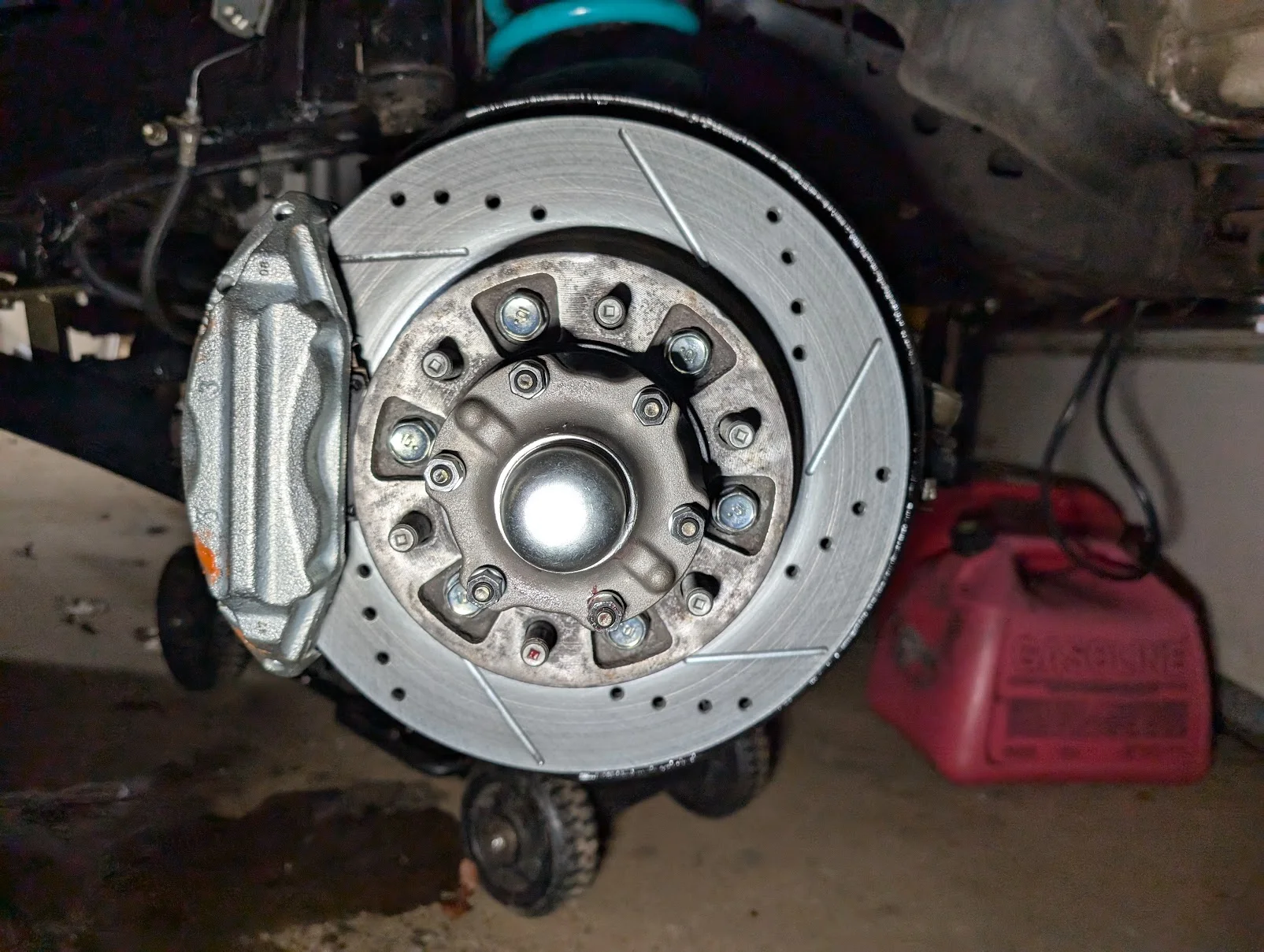

The new front and rear OEM calipers came in. Bad lighting on the front due to working right next to the garage wall.

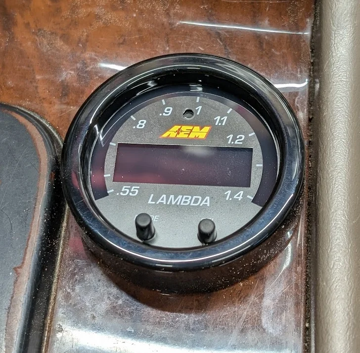

I bought an AEM X-Series OBDII Wideband AFR Gauge kit: 30-0334. This only works on 2008+ engines.
I installed the wide band O2 sensor on the passenger side as there was more room.
I already have gauge hole for a previously used transmission gauge.

I started it today with the wide band and the Lambda was over 1.3, which means it is ultra lean.

What manufacture are those slotted and drilled rotors? They look good. Are you planning on ungraded to bigger brakes for better braking since you are putting more weighs on your LC? I hid one airtag and installed a kill switch. Really wish the battery on the airtag lasts longer (one year). May add a gps tracker and apply for a concealed permit once my engine rebuild is done. Got my car stolen once when I was a poor college student.

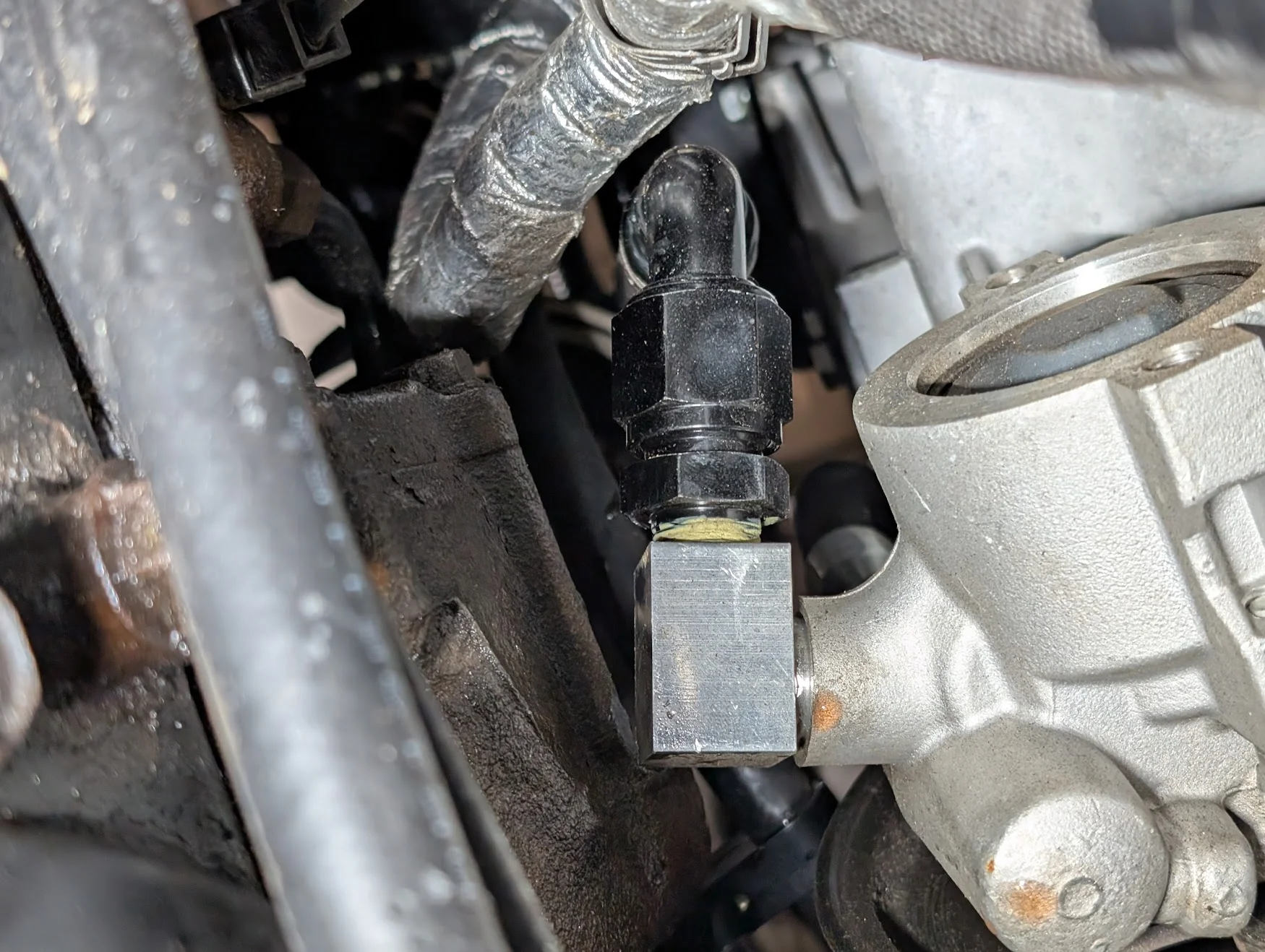

This is looking up at the PS pump from below. That right angle fitting is on the return, and it is the only fitting I could find that helps with clearance and it is still very close to the PS box. I think it has hit actually, and has self-clearanced. Right now, unless a different PS pump could be found, I think one needs to move the motor 0.5" to the passenger side. You could change the layout and go with a top mounted PS pump, then you will need to move the alternator to another location.

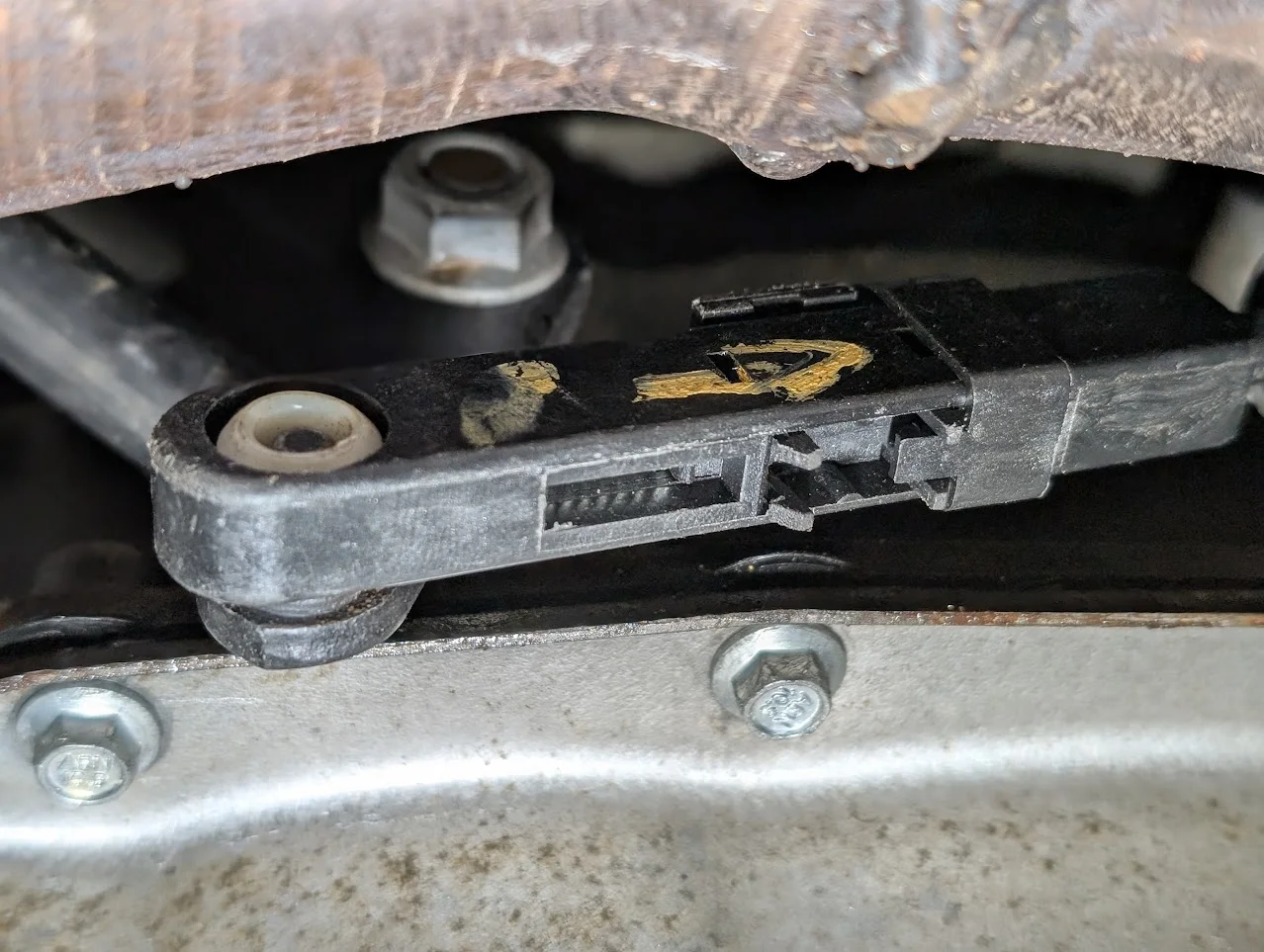

Shifting the transmission into D wasn't ideal as I had to move the Toyota shifter slightly past D to get the transmission into Drive, and then the Toyota shifter could be returned to D. It was like there was extra slop in the transmission control cable.
I did notice that the end of the cable at the transmission was complex and I knew there had to be some adjustment there. It turns out GM did make a way to make slight length adjustments to the cable length.
You pull out a locking clip, which then can be shifted backwards. This allows you to pull out another clip that sets the length of the cable. The end can then be shortened to desired length. Put the two clips back to lock in the new length.
Here is how the transmission cable lined up with the transmission shifter originally. You can see that the cable end was slightly forward of the transmission shifter bushing. This means extra travel at the Toyota shifter was needed to move from Park to Drive, which was the cause of my slight shifting problem.
I was able to take out that extra length, and now the Toyota transmission shifter works perfectly, in all detents.
There is hardly any information online about adjusting the end. Hope this helps.

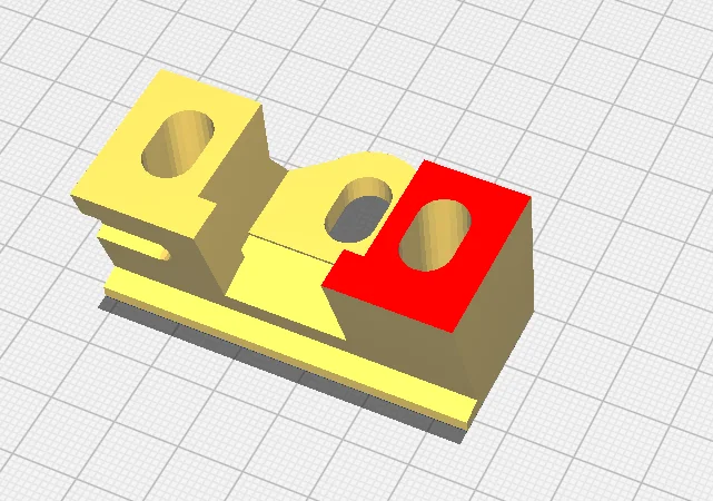

To finish up the transmission cable linkage, I designed a 3D mount to hold the end of the transmission cable. It bolts up to underneath the body, behind the transmission shifter.
I put in slotted holes to allow some adjustment. It puts the transmission cable at the correct angle.
