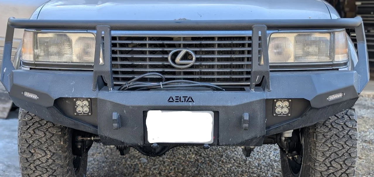

Would love to see some overall pictures of Rex especially the delta bumpers.

I will try to get full body pictures of it out in public.
I parked it in public once, just once, and someone already left me a note...lol

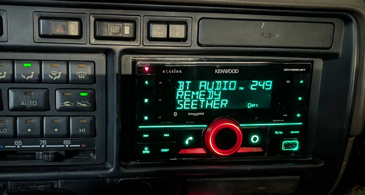

Installed Kenwood DPX395MBT. I need Bluetooth for music streaming. It was a really simple install using the Metra 70-8112 Receiver Wiring Harness. Still using the stock amplifier. Not a great photo, I just a quick snap.
I still have to set the colors to match the aesthetics of 1990s Toyota.. 3 different zones with each having their own custom color.

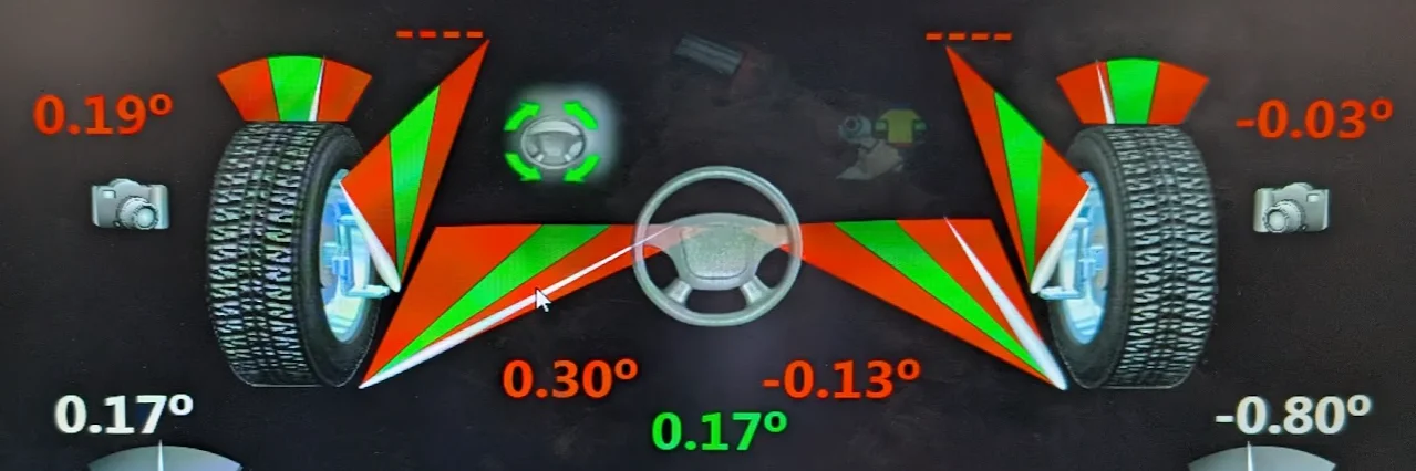

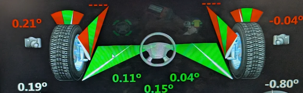

Alignment

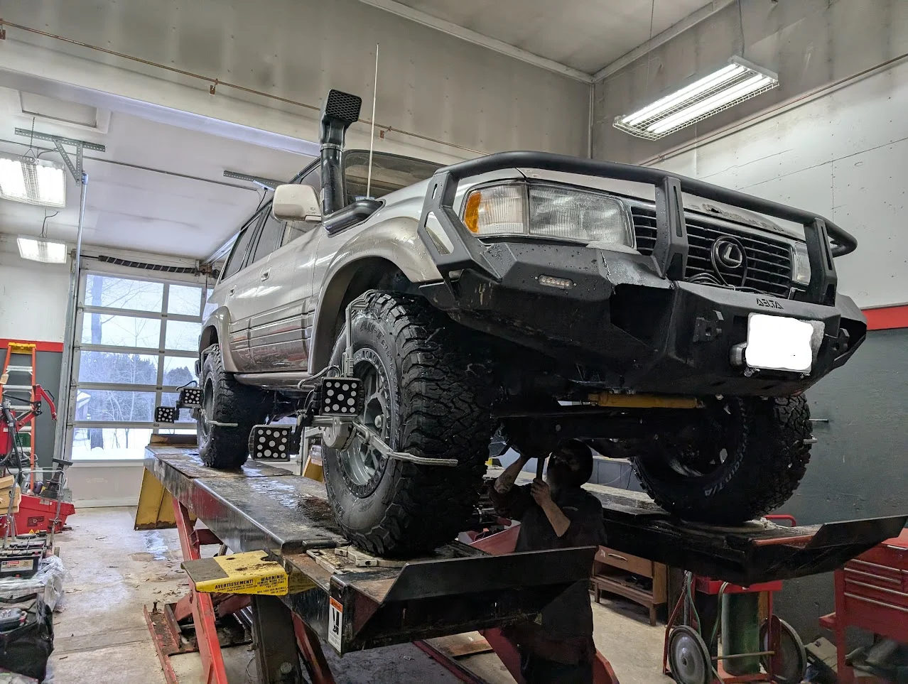

Brought the truck in for alignment. I had used TMR alignment plates to get close.
Before
After
My takeaway? I think I just spent $ to confirm that the TMR alignment tool works...
The steering wheel is now more off center though. 😒 I will fix this, but they were supposed to center it. :(

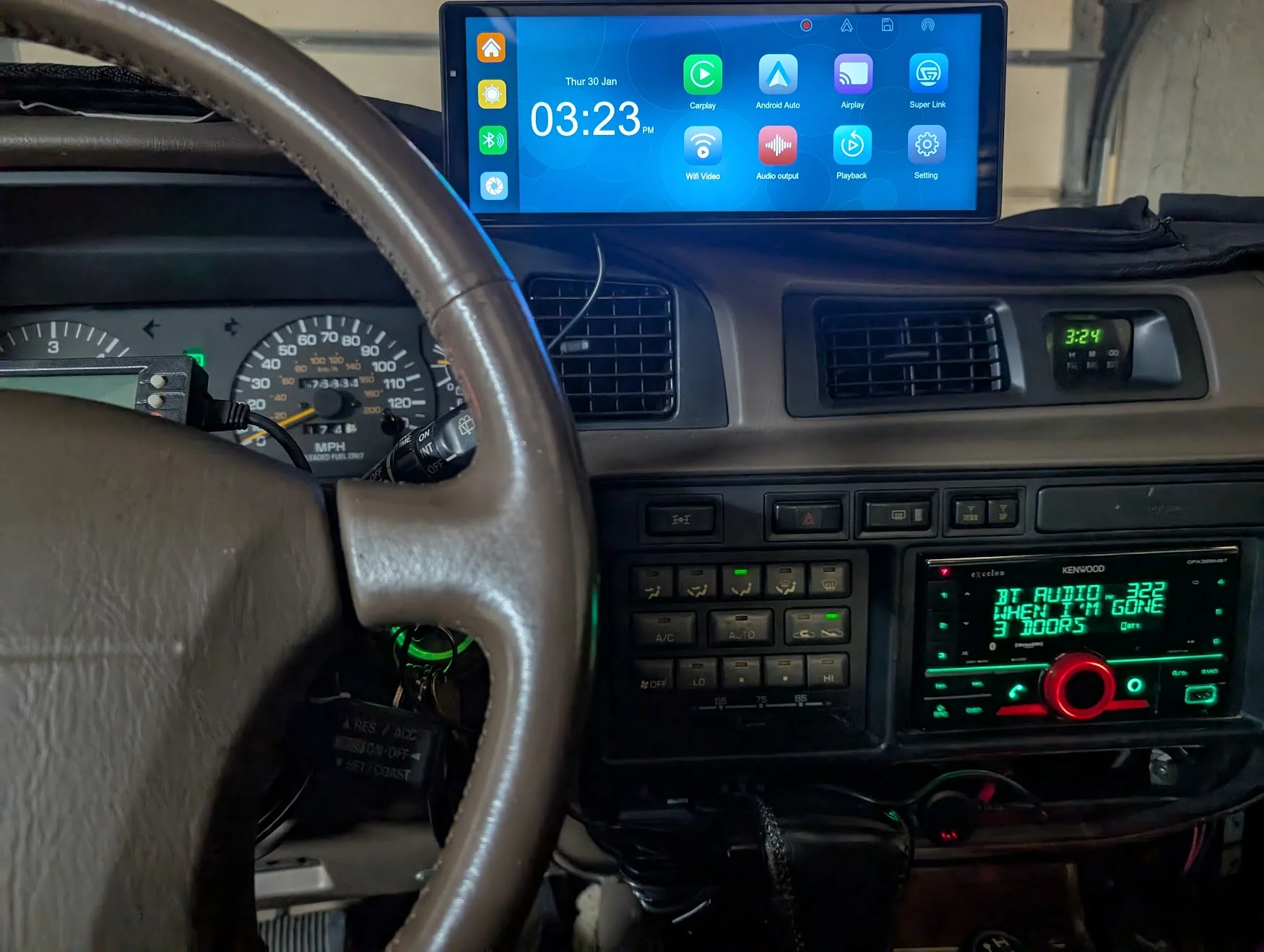

Android Auto
Picked up a cheap low profile android auto display.
It has front and rear cameras.
It doesn't block anything on the dash, or the view through the window. It is also at a good angle for viewing from the driver's seat.

I like it. All it needs to do is play music reasonably well, and be able to take calls.
The cheap android display works great with it. My phone connects to the Kenwood for audio, and sends Android Auto to the display.
I initially had an issue with noise with the Kenwood, but I traced it back to the connection at the amplifier. I had the wiring harness apart, and I may have not connected it fully.
That other radio harness is used if you are bypassing the stock amplifier. I decided not to at this time because the stock amplifier is much more powerful than what is built into the Kenwood. You could wire up another amplifier though, but now you need to locate a spot for it, and then wire it up.
As far as I know, there is no dimmer wire on the Kenwood. You can either manually dim the display. or set the Night vs Day brightness levels at different levels. It is mostly out of eyeview, so its brightness is fine to me.

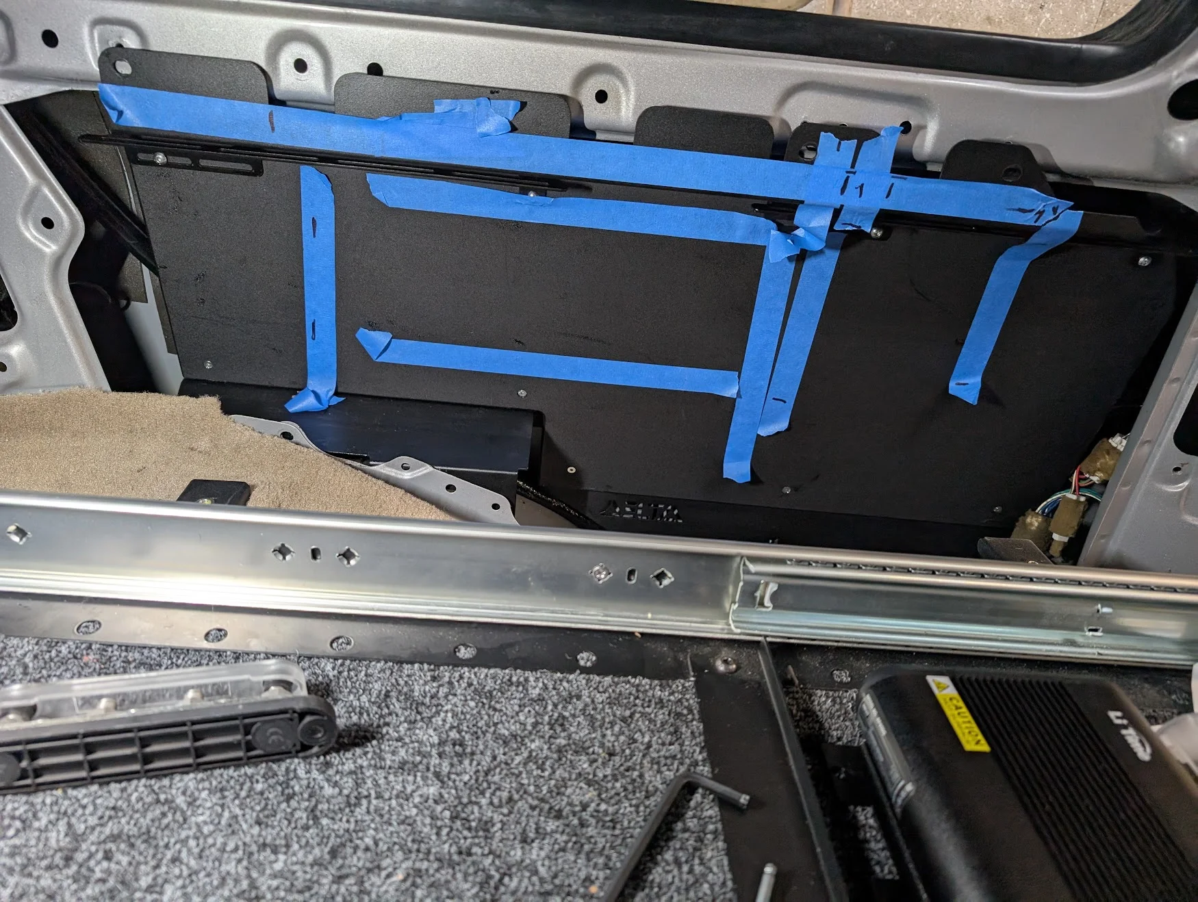

House battery

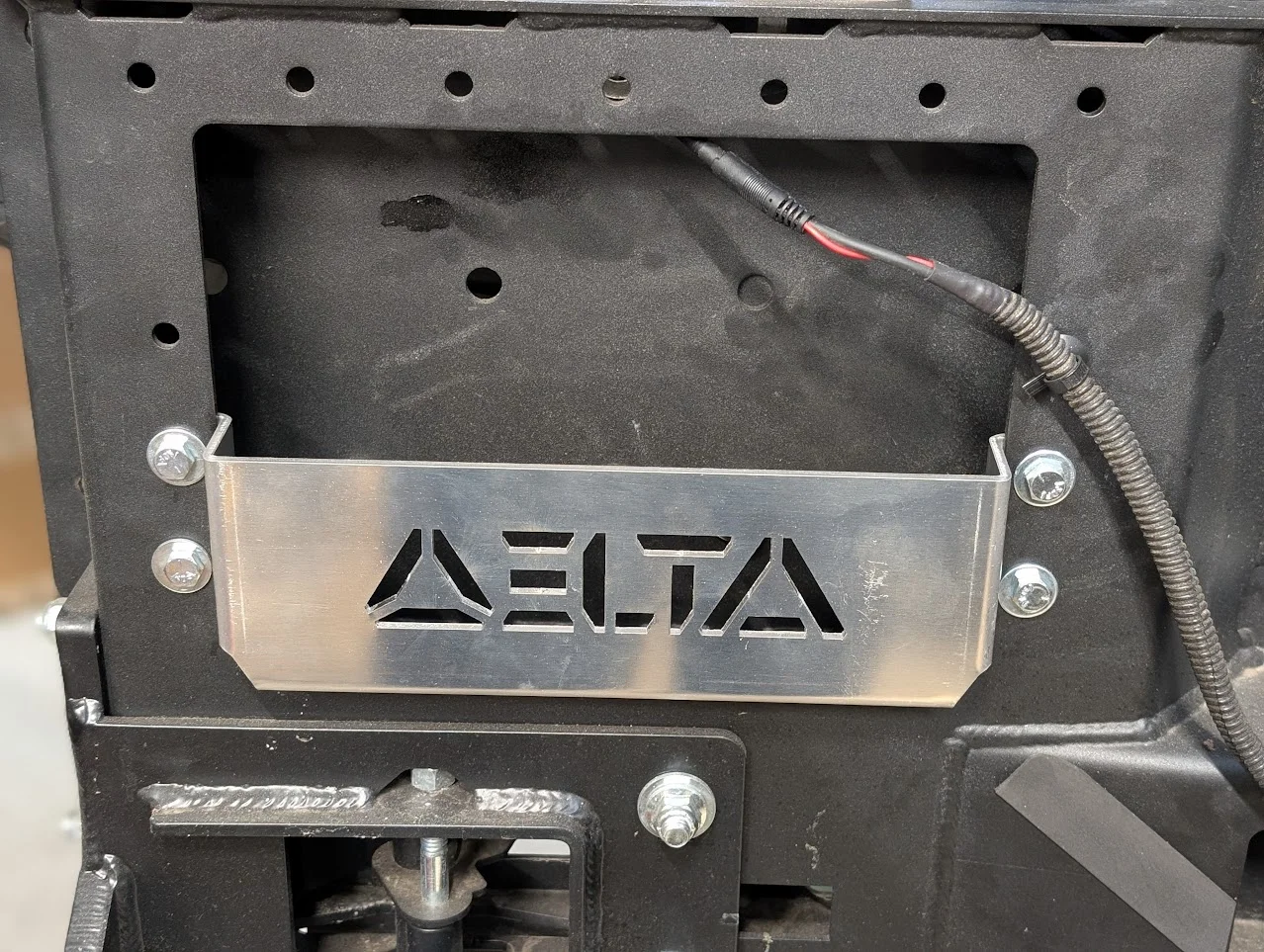

Picked up a DeltaVS QPM.
The blue tape was for locating where I wanted to locate items relative to the trim cubby.

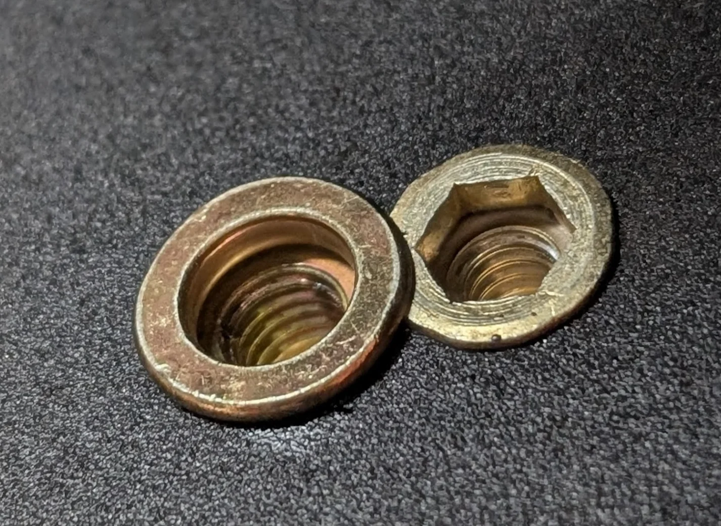

My rivnut vs DeltaVS. Theirs is stamped into the steel, with a hex cut out to prevent rotation.
Coming together. DC to DC convertor on the left. Fuse panel center top. Fused distribution block bottom right.
Test fitting the trim over the QPM. The fuse panel, as well as the buttons on the DC to DC converter are accessible.

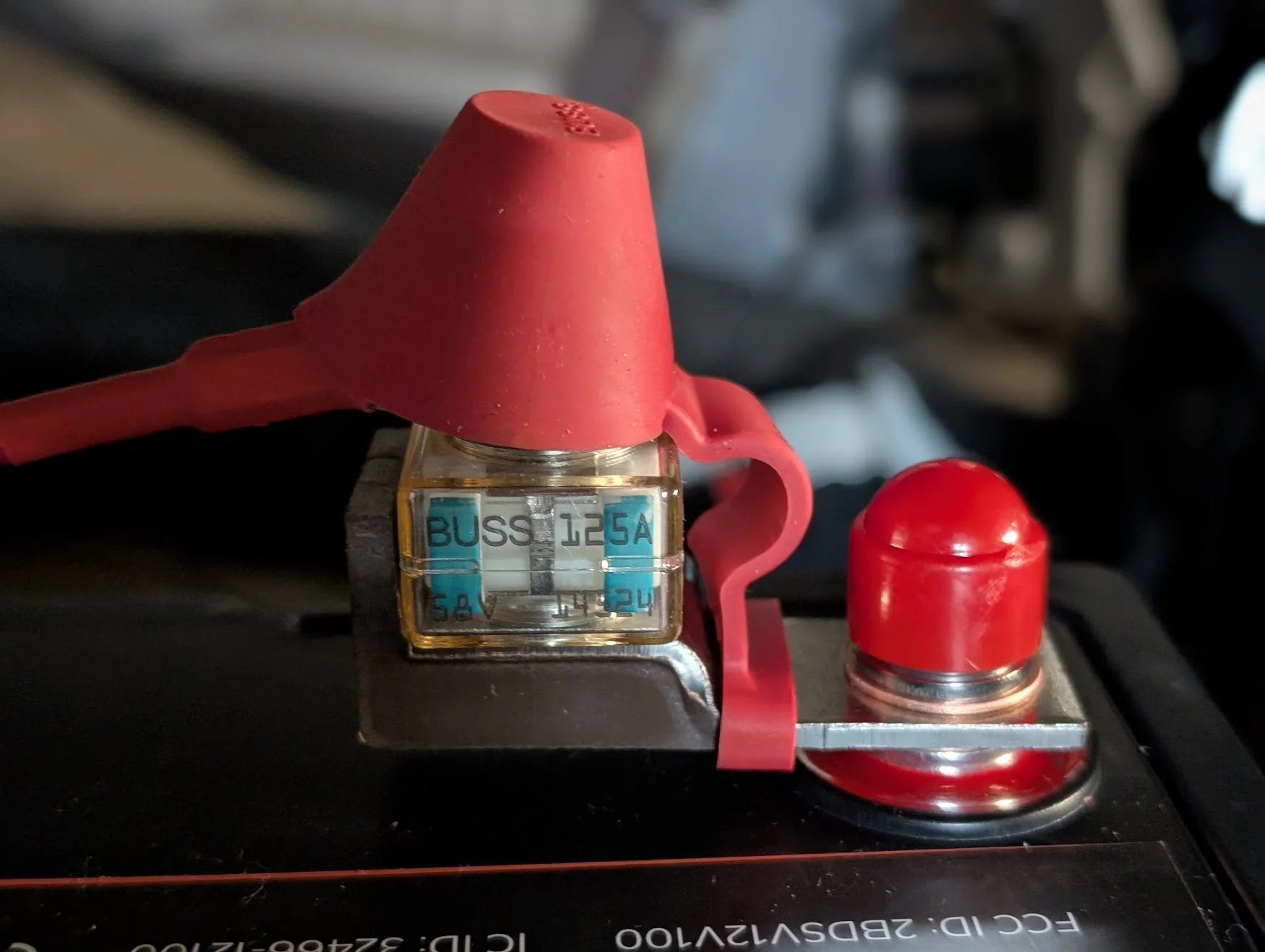

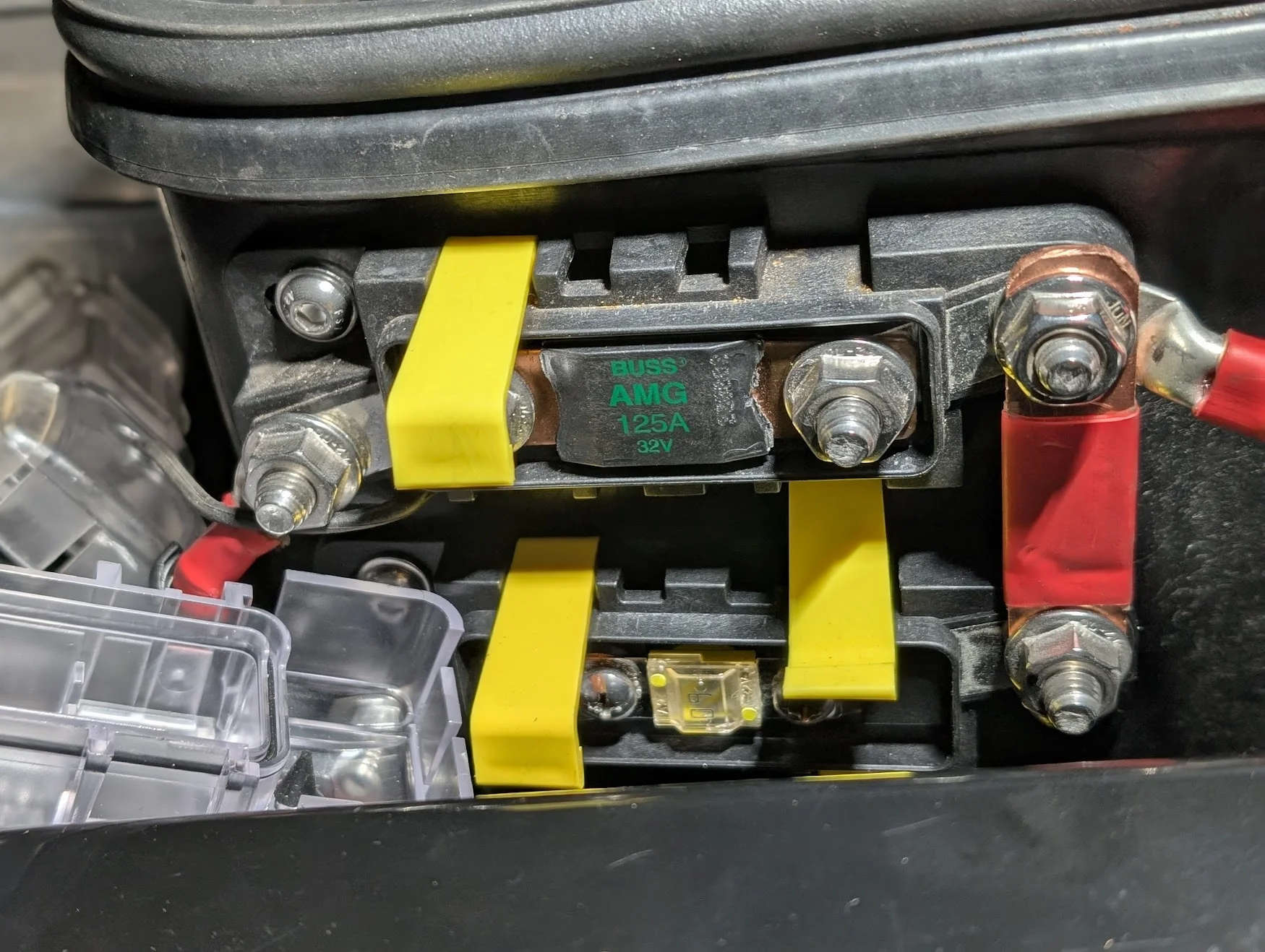

Close up of the 120A Fuse on the 12V 100Ah Lithium battery. The battery BMS should limit output to 100 amps, but I added a fuse at the battery just in case.

60 Amp fuse on both sides of the 6 AWG cable run since power can be sent both ways.
I made a copper bus bar to tie the two fuse holders together, which means I only needed to run one power cable from the starting battery.
Those are two different types of fuse holders. The top one, which I bought early on, can use high amperage fuses (MEGA/AMI), but I like the bottom one because the fuses (AMI/MIDI) are smaller, and the case can hold a spare. I don't think I need a fuse higher than 125 Amps anyway, which the smaller fuse type can easily do.

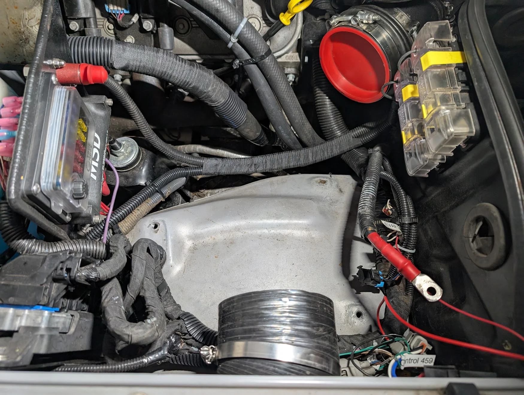

Redid some wiring in the engine bay. Here it is without the air box installed. Not too much space to spare..

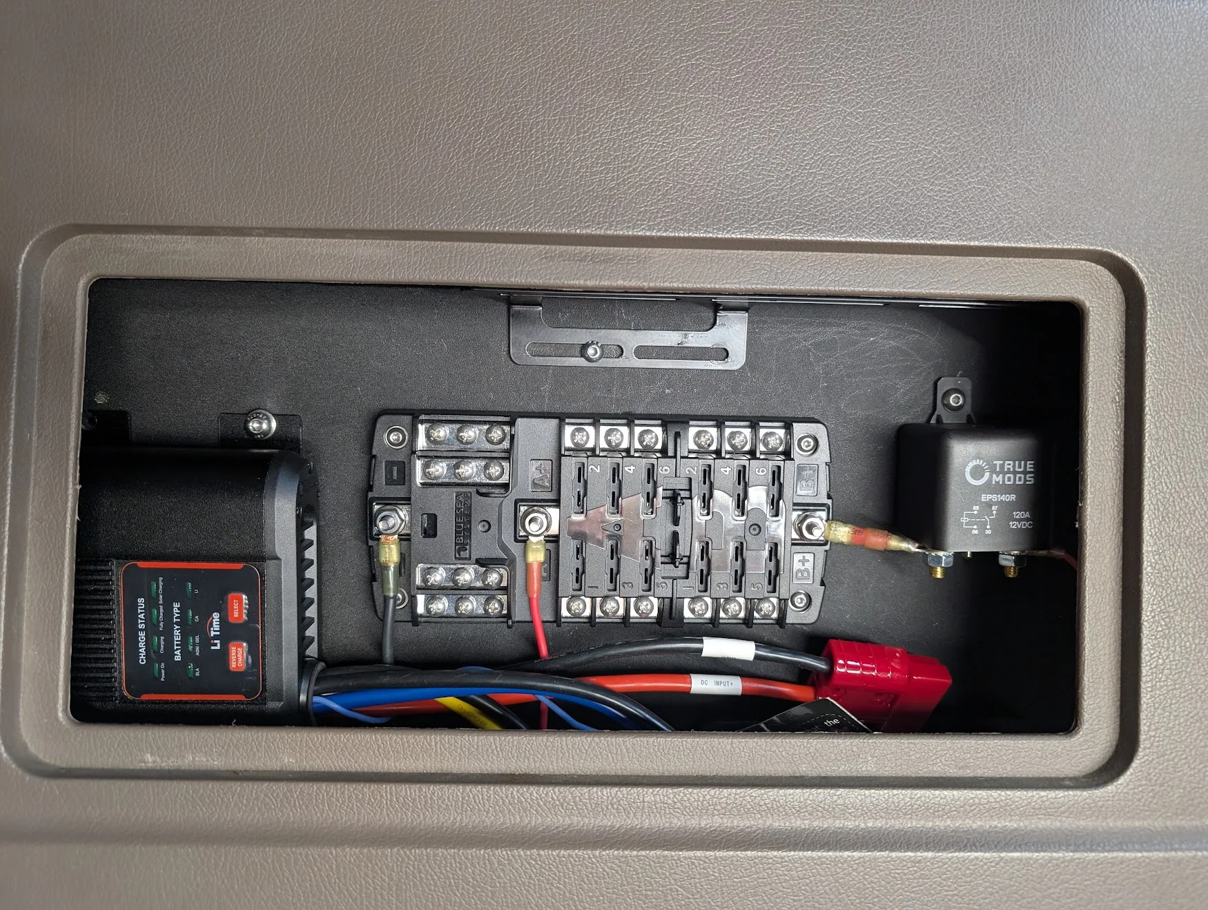

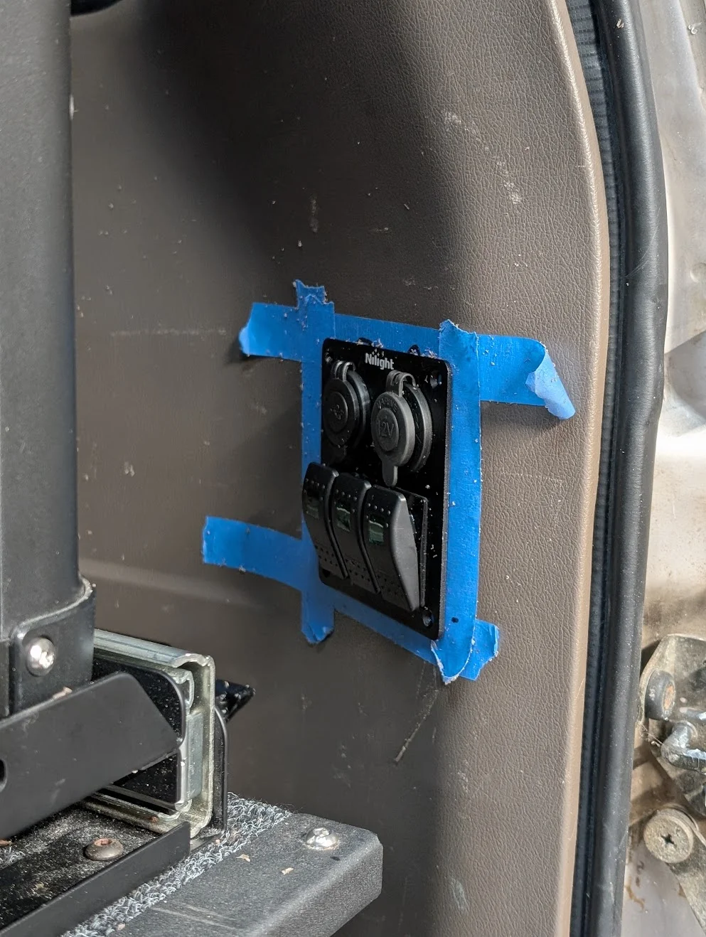

Rear Power

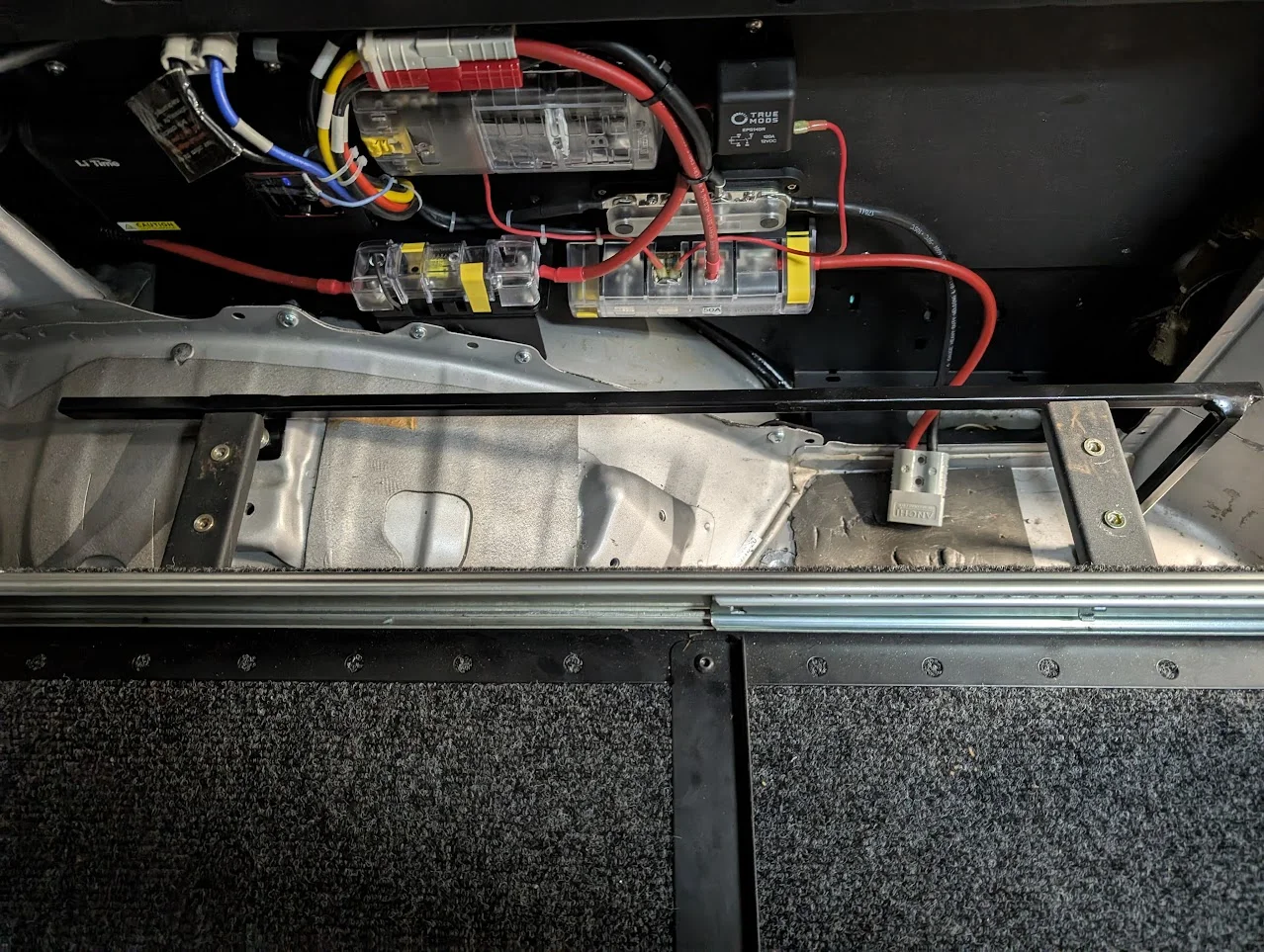

More work on the electrics..
Built a stand off rail to support the battery, otherwise it was just the L brackets from the drawer system.
Not shown but trim does fit and looks stock.
Power/switch panel for the rear. It sits right in front of the hole left by the seat belt mechanism for the 3rd row.

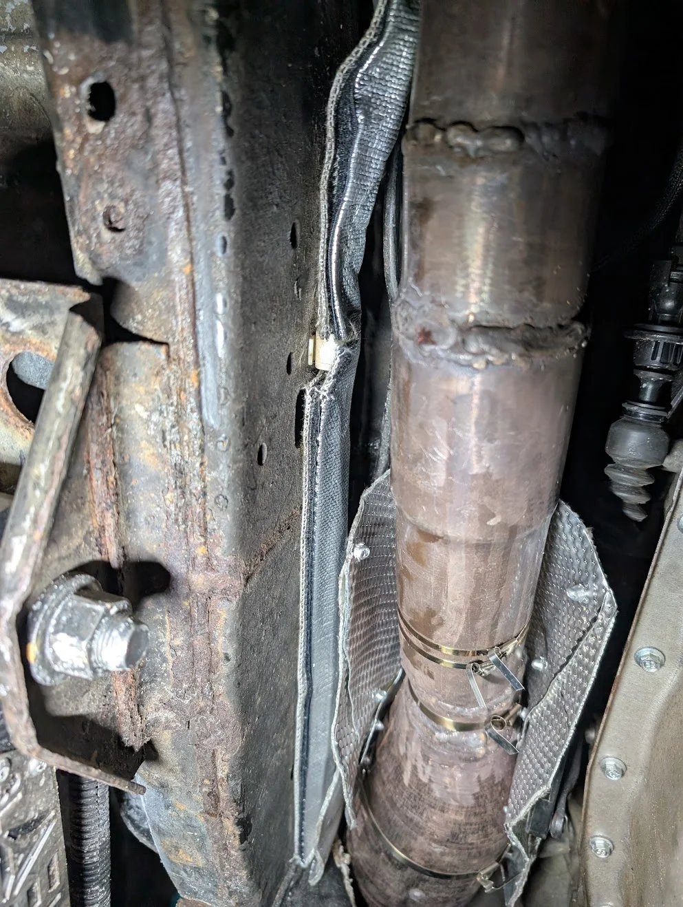

Exhaust heat shields

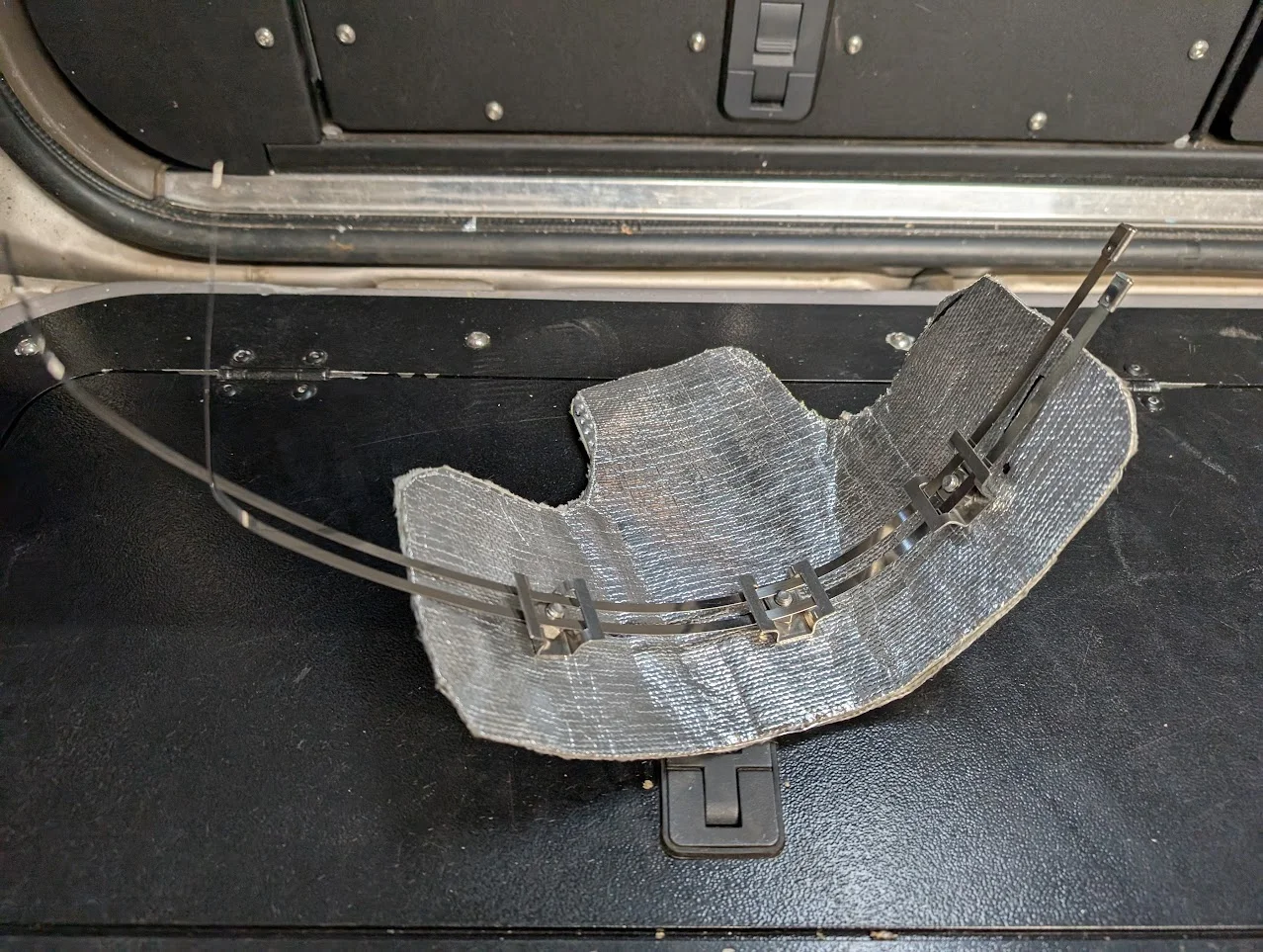

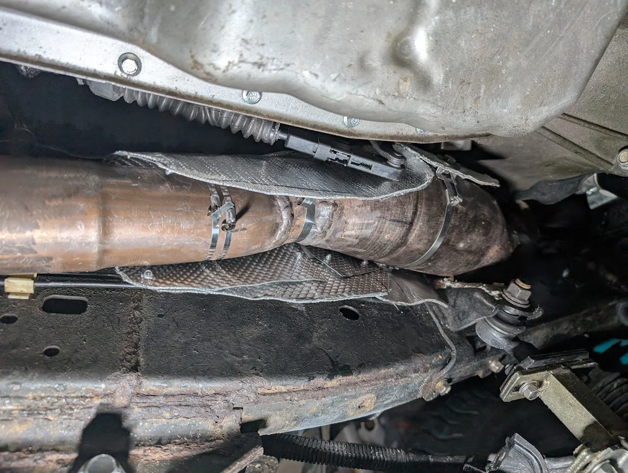

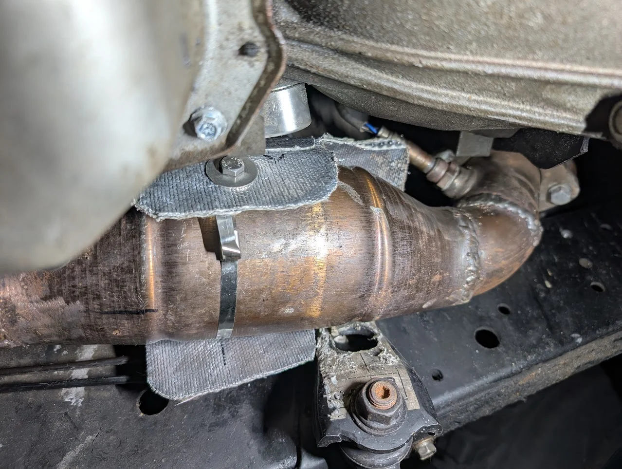

Built a custom, triple layer, heat shield for the driver's catalytic converter, which is extremely close to brake and fuel lines.
Installed
Extended, and by extended, I mean hacked, a longer heat shield. Radius changes and multiple angles = hacked shield.
I didn't want to use exhaust wrap because I prefer that heat escape, I just want it to escape away from the fuel and brake lines and the transmission cable.

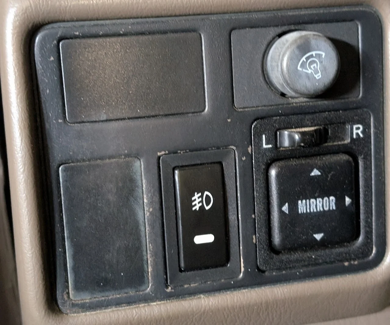

Added a DEI heat shield to the brake lines.

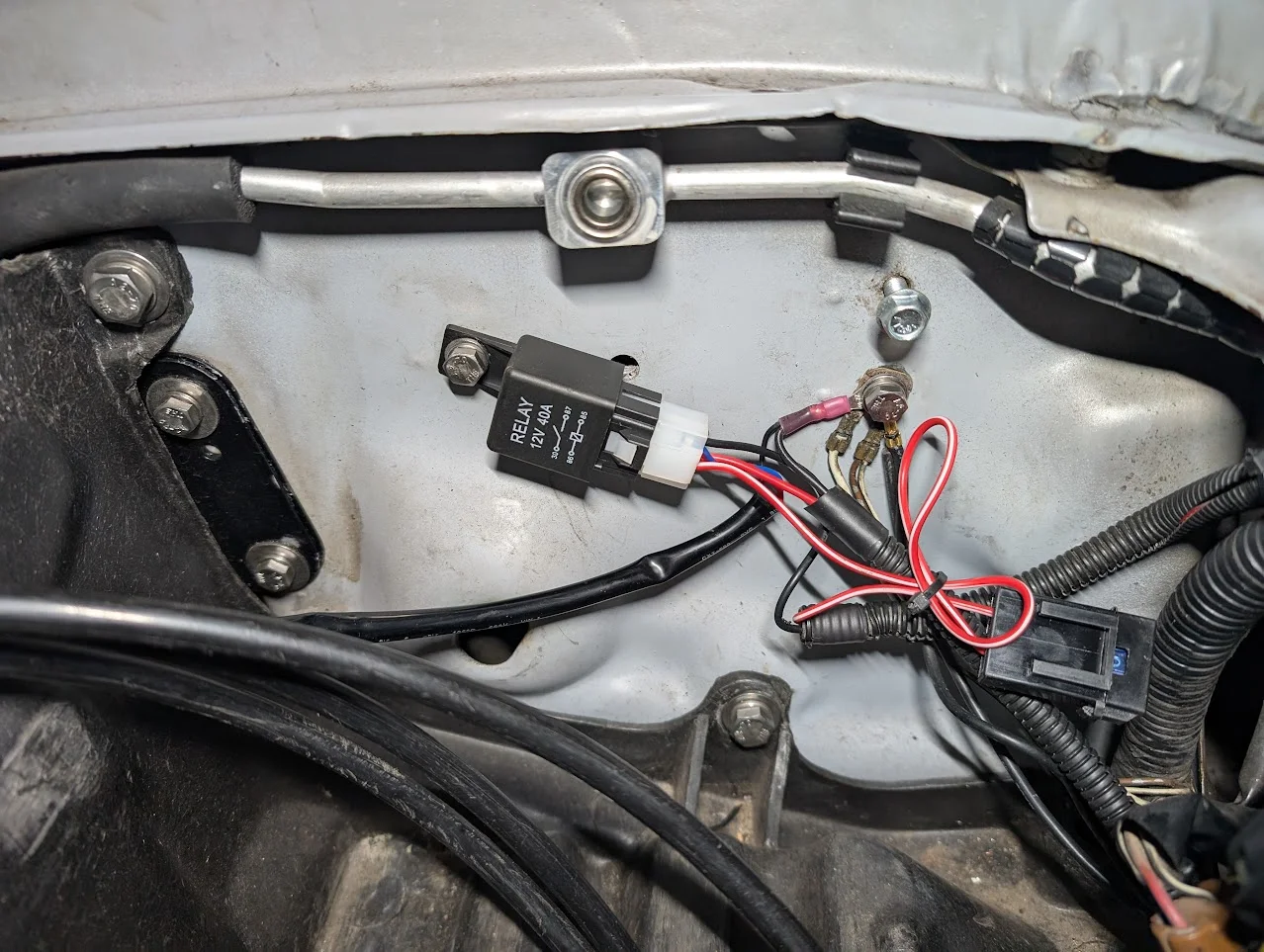

After years of having a @DeltaVS from bumper, I finally bought and installed Baja Design Squadron Lights. The plates that Delta VS designed to mount them is ingenious because it lets you align the lights (up/down, side to side), independent of the bumper.

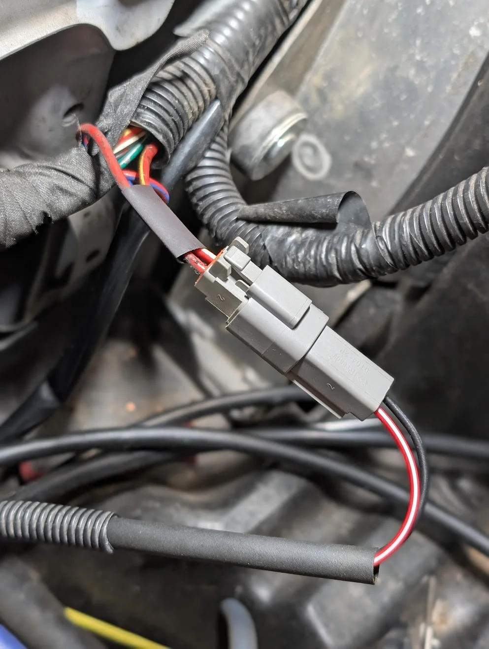

Picked up a cheap AliExpress harness to control them, which included all the wiring, loom, switch, and relay.
I had to wiring the AliExpress relay differently from how it came because Toyota uses a negative grounded switch to turn on the high beams, but the body of the Baja Design lights were grounded to the chassis. I only wanted the Baja Design lights to come on when the high beams were on.
To do this, I cut off two of the grounds to the AliExpress relay, and grounded them directly to the body. The ground still connected to the relay was connected to high beam ground. The AliExpress relay will now only activate if the high beams are on. Power for the relay was also provide by light harness. This makes the switch light up when the lights are on at night.
I use Slee's light harness, which makes the stock high beam light harness available for use on the driver's side because I installed the Slee relays on the passenger side. I replaced the high beam connector with a deutsch connector.
