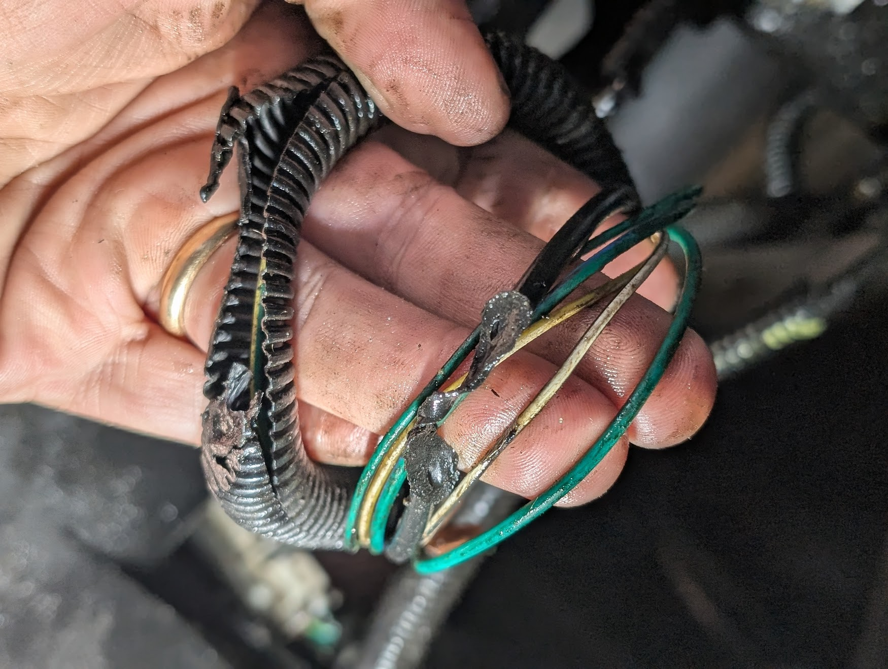

Discovered heat damage on the rear locker harness. The vent tube melted and I need to test the harness.

Found the issue with the rear locker light not going solid, despite being locked.
As shown above, I did have burn damage from the exhaust, but the issue wasn't there. It was a few inches higher and it was the only wire in the area damaged.
I believe this sub harness is NLA. 😔
I prefer crimping over soldering.
The rear locker light now switches to solid once the diff is locked. :clap:

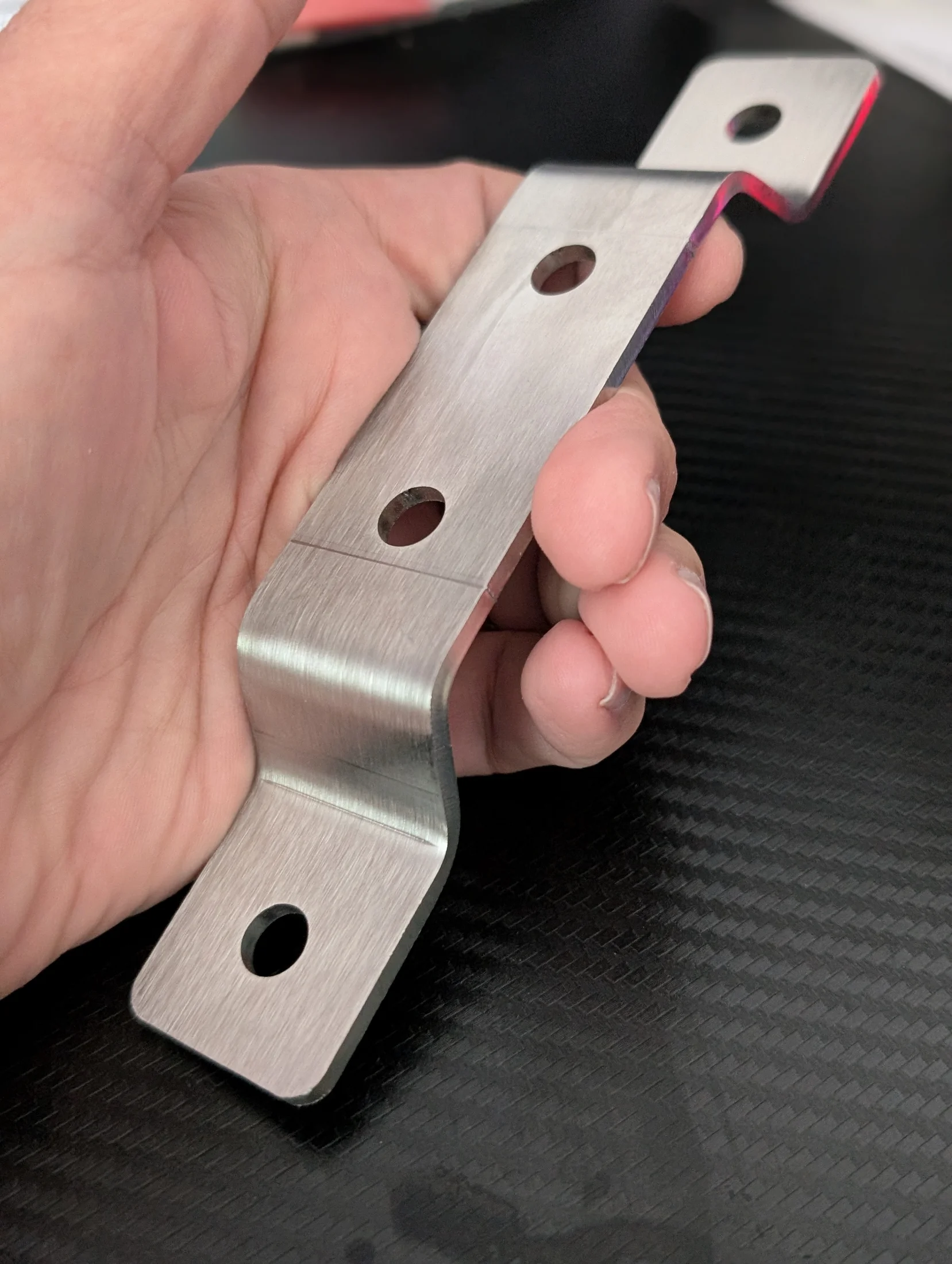

I made a thing...
I couldn't find exactly what I wanted, so I designed this.
It is a Roof Top Tent brackets to lower my Penthouse XL RTT about 1".
These bolt to the load bars and the RTT, making a very secure connection.
They are made out of 304 Stainless.
First time using SendCutSend as well. I am impressed.

I made a thing...

I tried to hand making one RTT bracket, but it ended up looking like crap and I needed 6 of them... I am no hand fabricator. 🤪

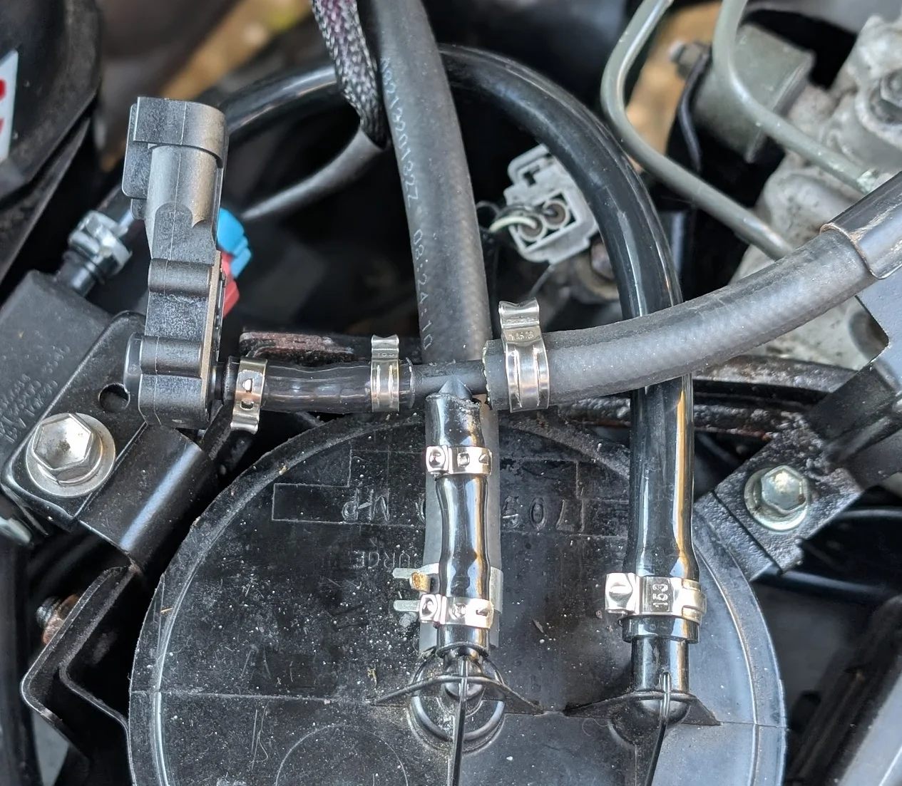

Evap Vent Solenoid
Switched to a different evap vent solenoid (pigtail). The other one had an integrated dust filter on the output, which meant that gas vapors would have been released into the engine bay. Not horrendous, but it does mean you might smell gas if you walked by if the ECM was venting the gas tank. The new one allows running a hose into the frame rail, which is what Toyota does. Plus, it takes up less space in the engine bay.

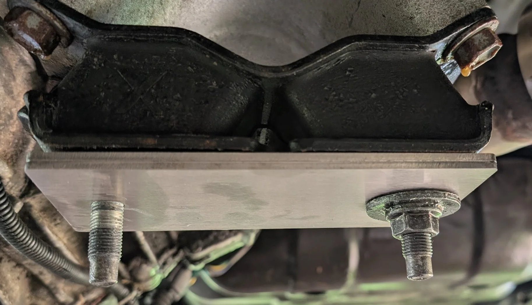

Because I had to drop the cross member, I decided to design transmission mount shims. DeltaVS front skid comes within a hair of the transmission pan and the shims will help with more clearance there as well as solve t-case issue.
These are 0.125" made out of 304 Stainless Steel. There are two in the picture. Got to love SendCutSend!
My engine is at 3° currently, which is a decent angle but it could be less. The shims will let me dial in that angle.
Edited to add that one can only use maybe two 0.125" shims at most as there is very little tunnel clearance at the top of the t-case. I decided to go with one shim and see how that works out.

Working on getting the fuel tank pressure sensor installed.
The GM fuel tank pressure sensor is just tee'd into the tank evap vent line right at the charcoal canister. I still need to wire it to the ECM.
