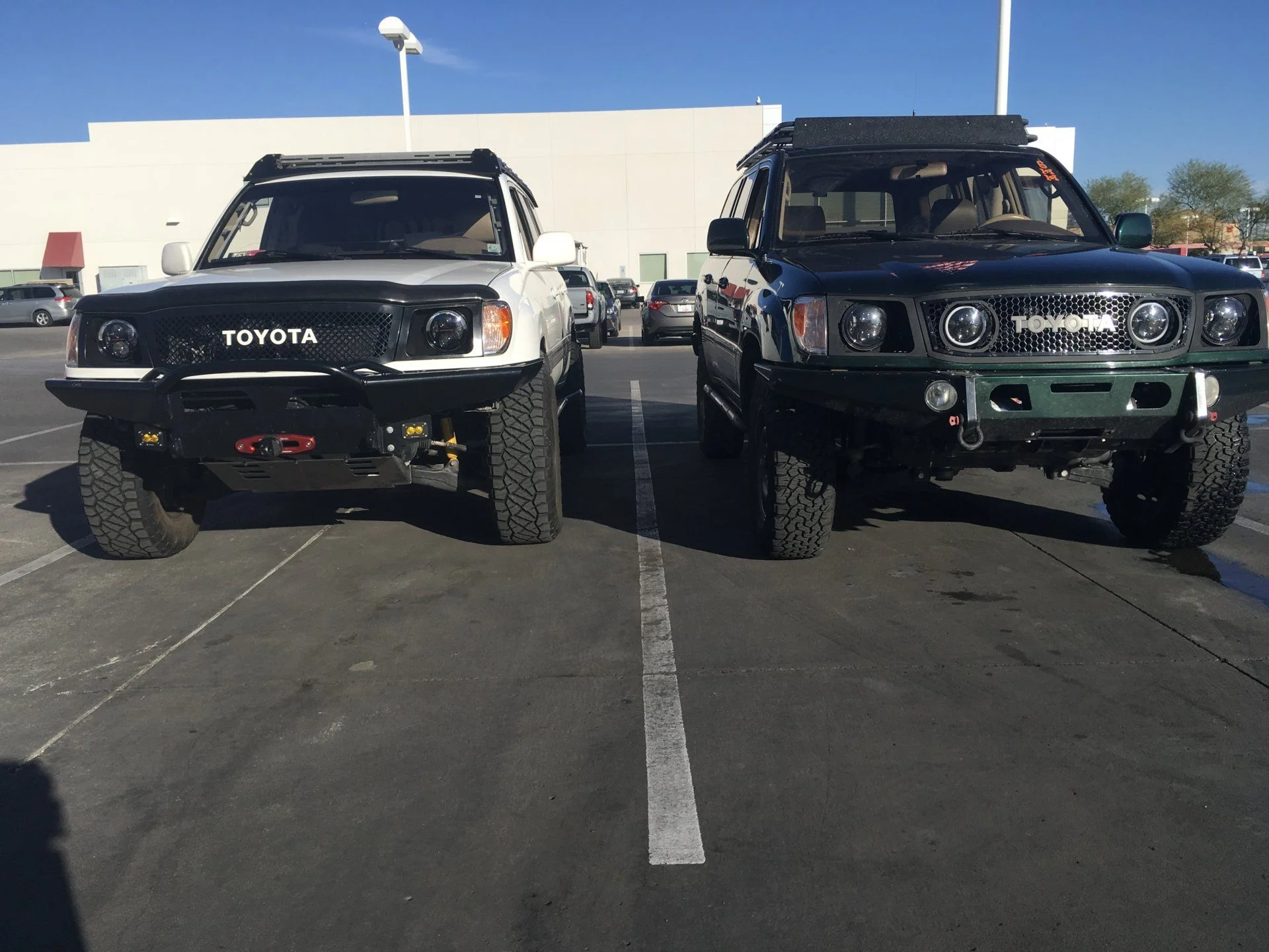

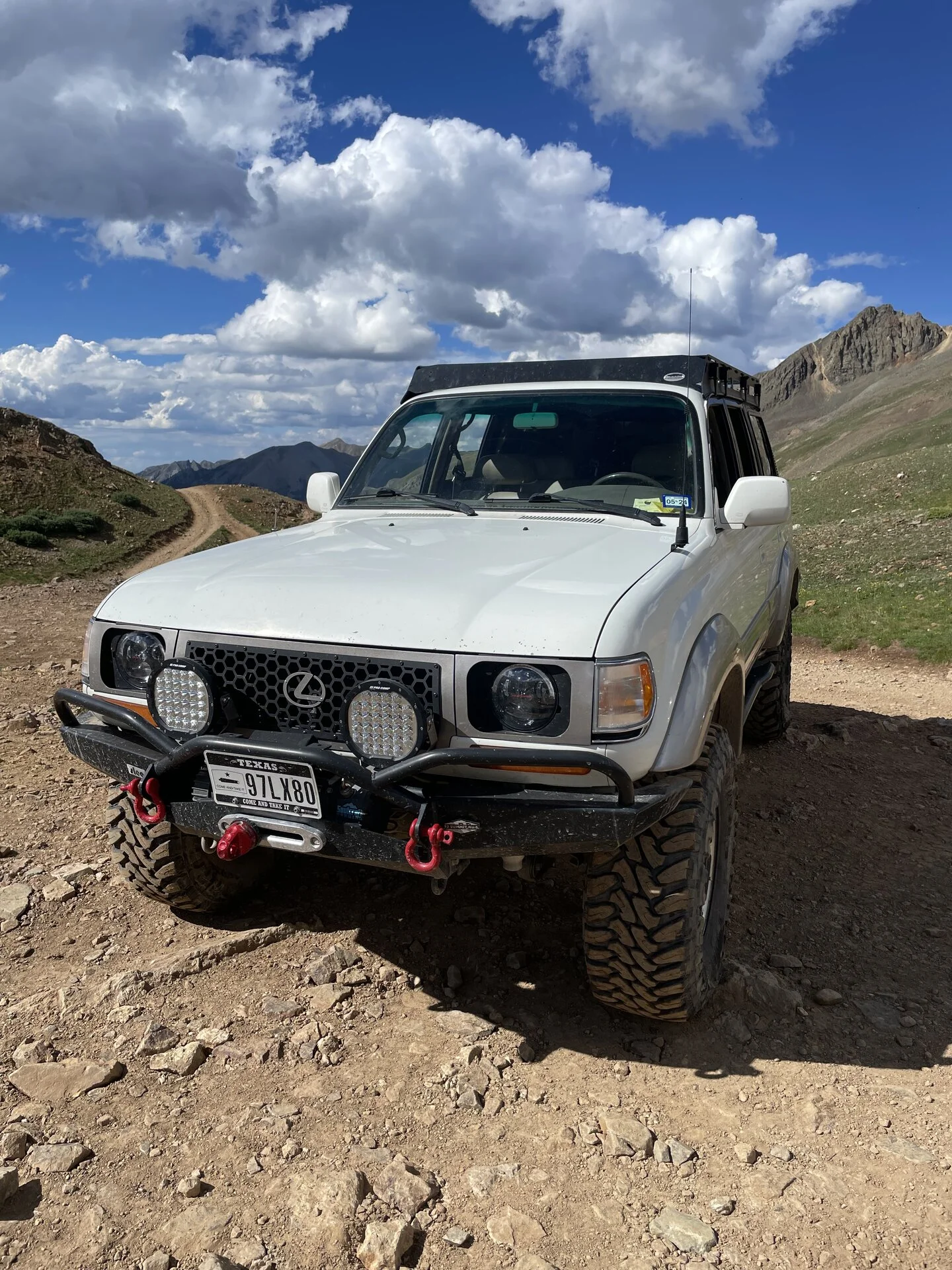

Many ways to skin that cat. Innumerable threads, one just this past week. First takeaway for you is that the Toyota lights won’t fit the LX (at least without modification). Decide how important it is to you to keep it stock. LX lights may still be available at a sticker shock price (others will chime in). Many configurations of Depo boxes, which is a popular option. I fully Lexified mine this year, mainly to have 7” round options…

I’ve looked at this exact same set up. How have you liked it so far compared to the stock set up?

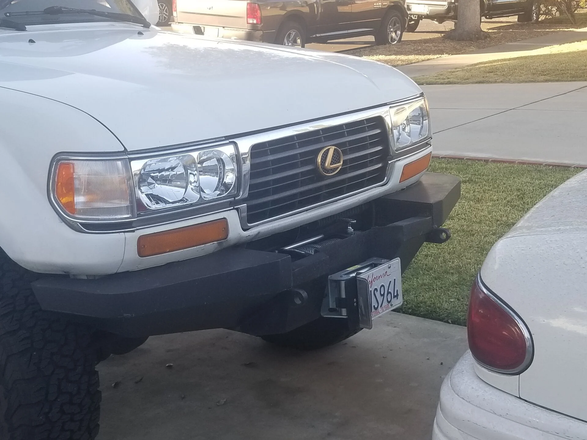

I'm in the same boat. From what I've found so far, it looks as though LX450 headlights are down to NOS. On a better note, we still have options. I've always been a sucker for a round-eye, so I'll likely go with the LC Grilles product.
You could also go to the double square buckets or Depos with a still available 80 series LC grille.

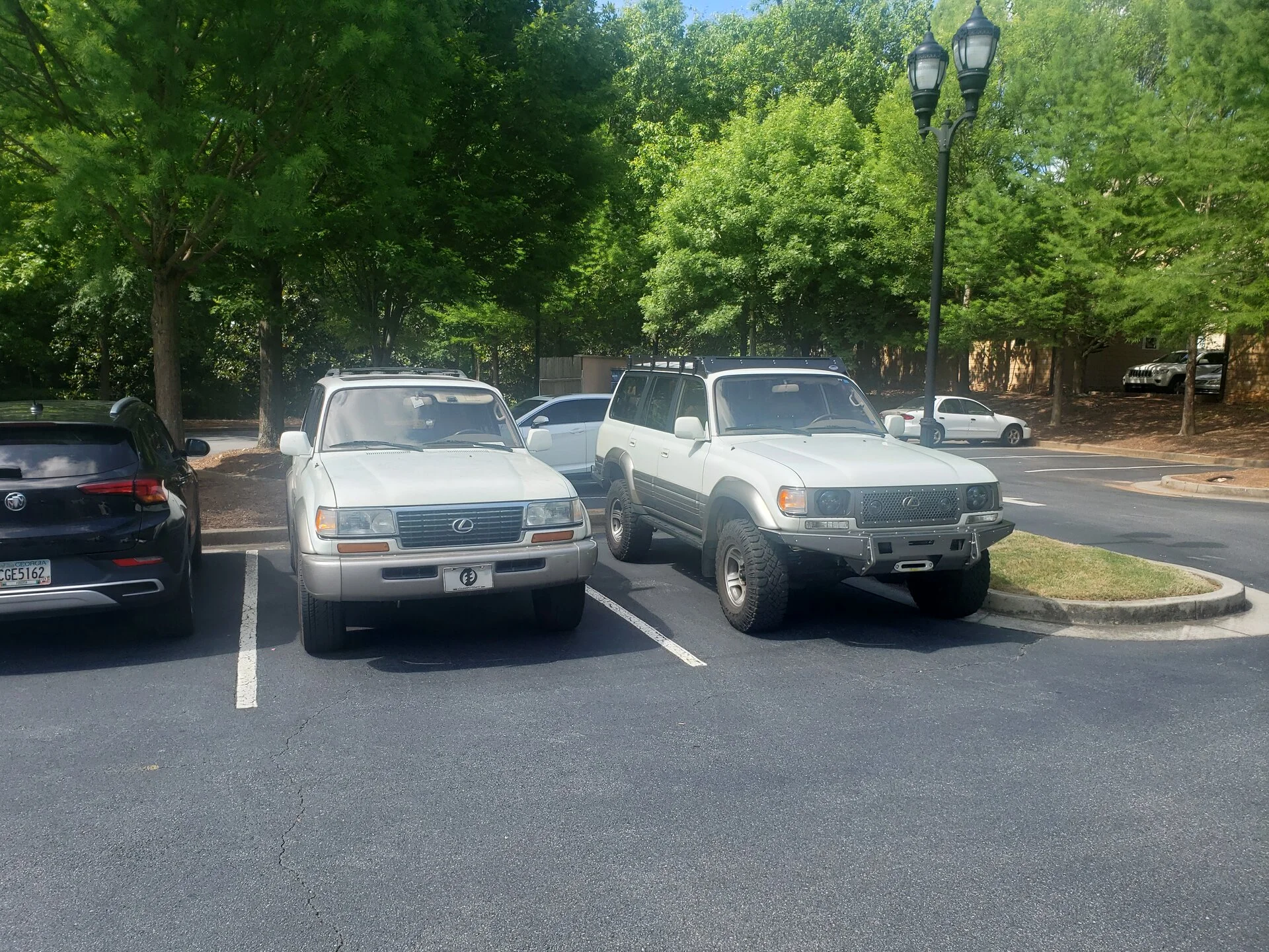

What I'm seeing here is I should source a Toyota grille, swap it in with the Depos sitting in my garage, and sell the LX lights for profit to maybe break even
