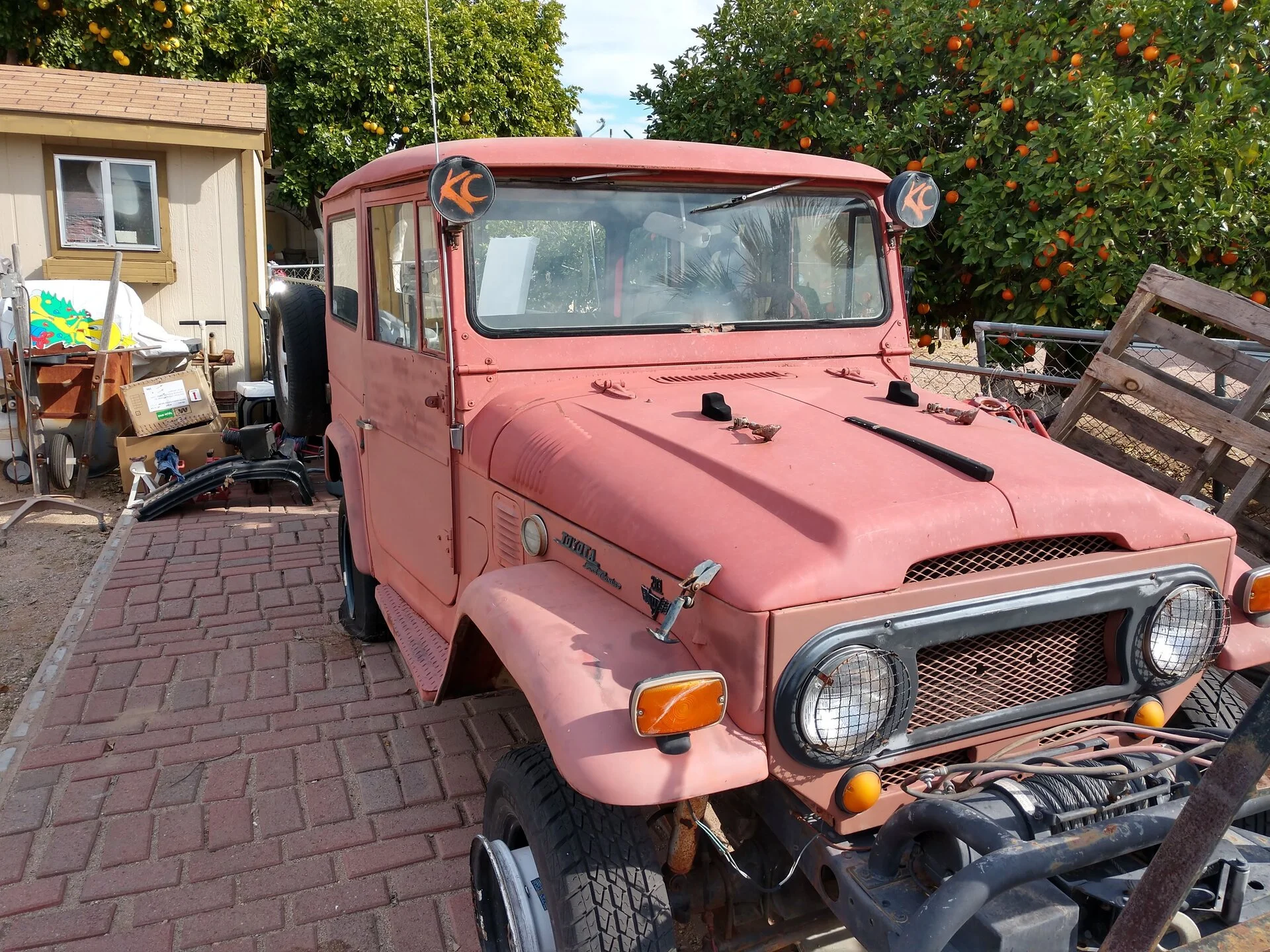

I finally think I'm at a good point to start a build thread. I have a 69 FJ40 that I've been threatening to do something with for about 4 years. It's a really solid AZ truck that I got from the family of the original owner.
Here's the recipe:
• LS1 5.3 from a 2002 Silverado
• H55f 5 spd and FJ60 transfercase
• Wilwood disk brake converted front axle
• Restore rear wheel wells to stock with realsteel patch panels
• Some new paint

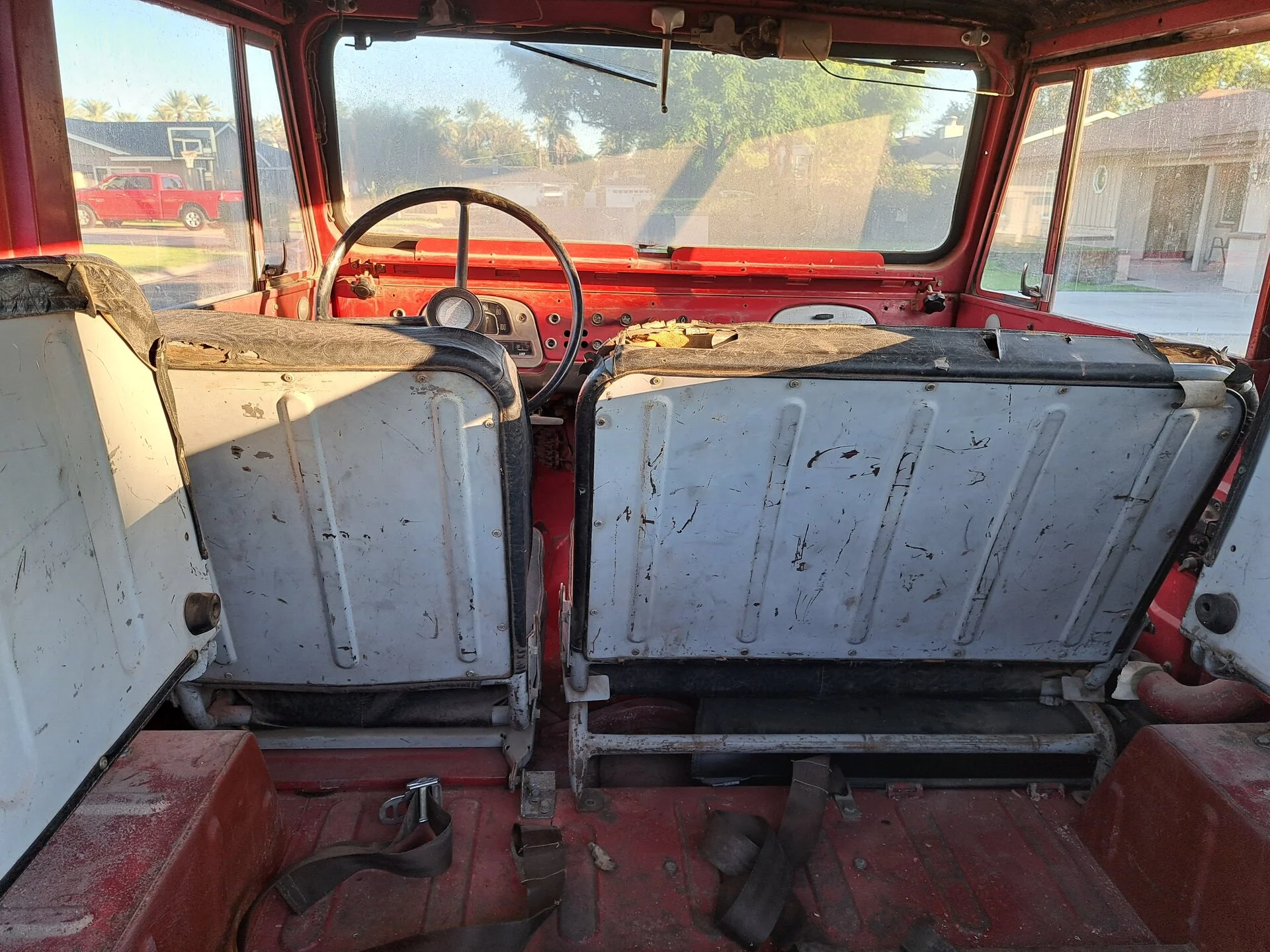

• Reupholstered stock seats
I will put in some cruiser porn here, before the back story...

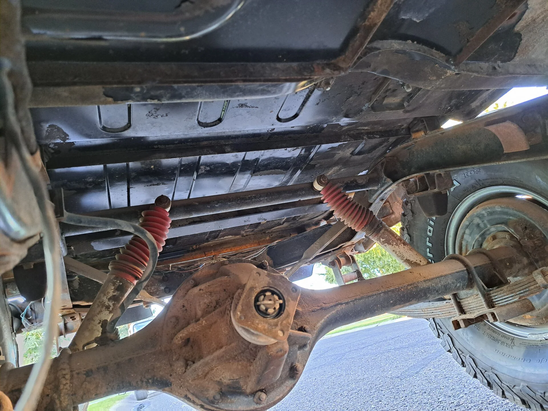

JimLand and Pb4ugo, I bought the axle pre-built by another mud member with all new components and 0 miles on it. I'll try to find a pic before I installed it. I'm not sure what year housing/axles it is. But it will work great for me. I will wheel it, but I'm too practical to beat my stuff up anymore.

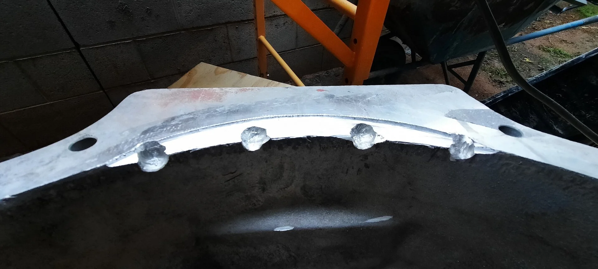

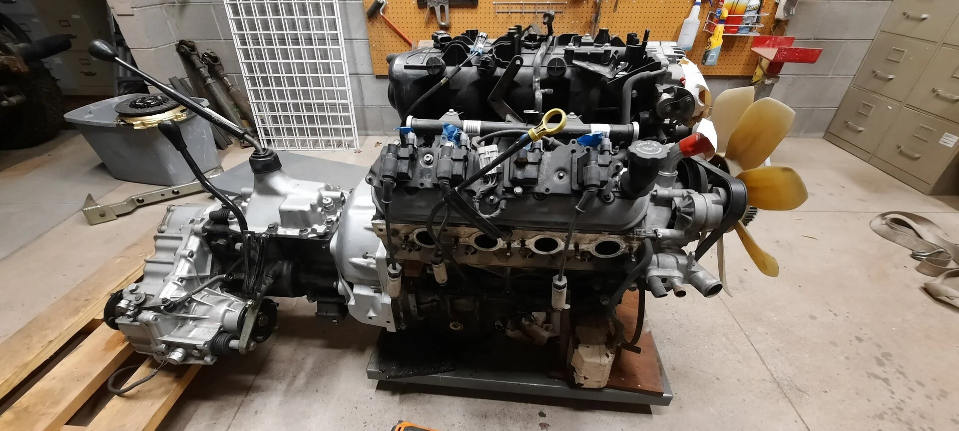

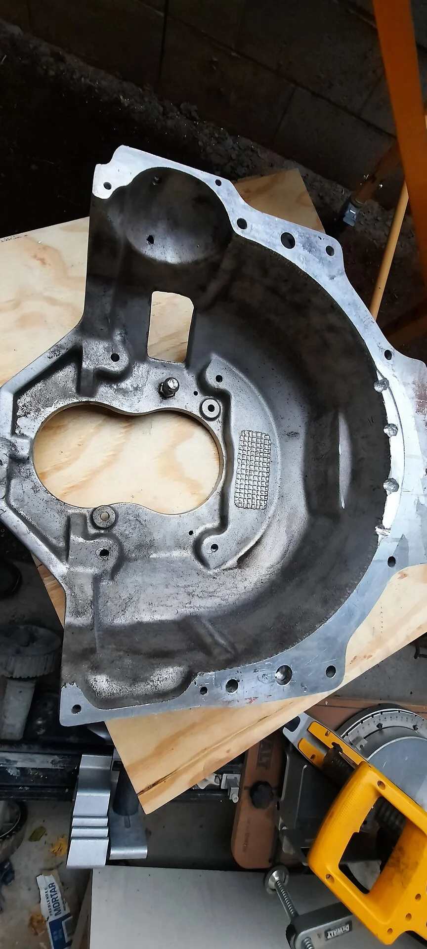

I have the 5.3 mated to the tranny with an older (and slightly modified) advance adapters bellhousing for a regular chevy 350. I believe Mightymes threw that in with my tranny combo ge sold me. And i have the advance adapters special flywheel to mate a manual trans to the LS.
The top bolts of the back of the LS hit the adapter so I did some strategic grinding to get it to seat properly. I mated it up and everything seems just right. Input shafts fits into the pilot bearing and all of the clutch components fit nicely.
I've never heard or seen anyone do this, so I won't recommend it. However I'll give you an update of it's success after this thing is moving on its own.

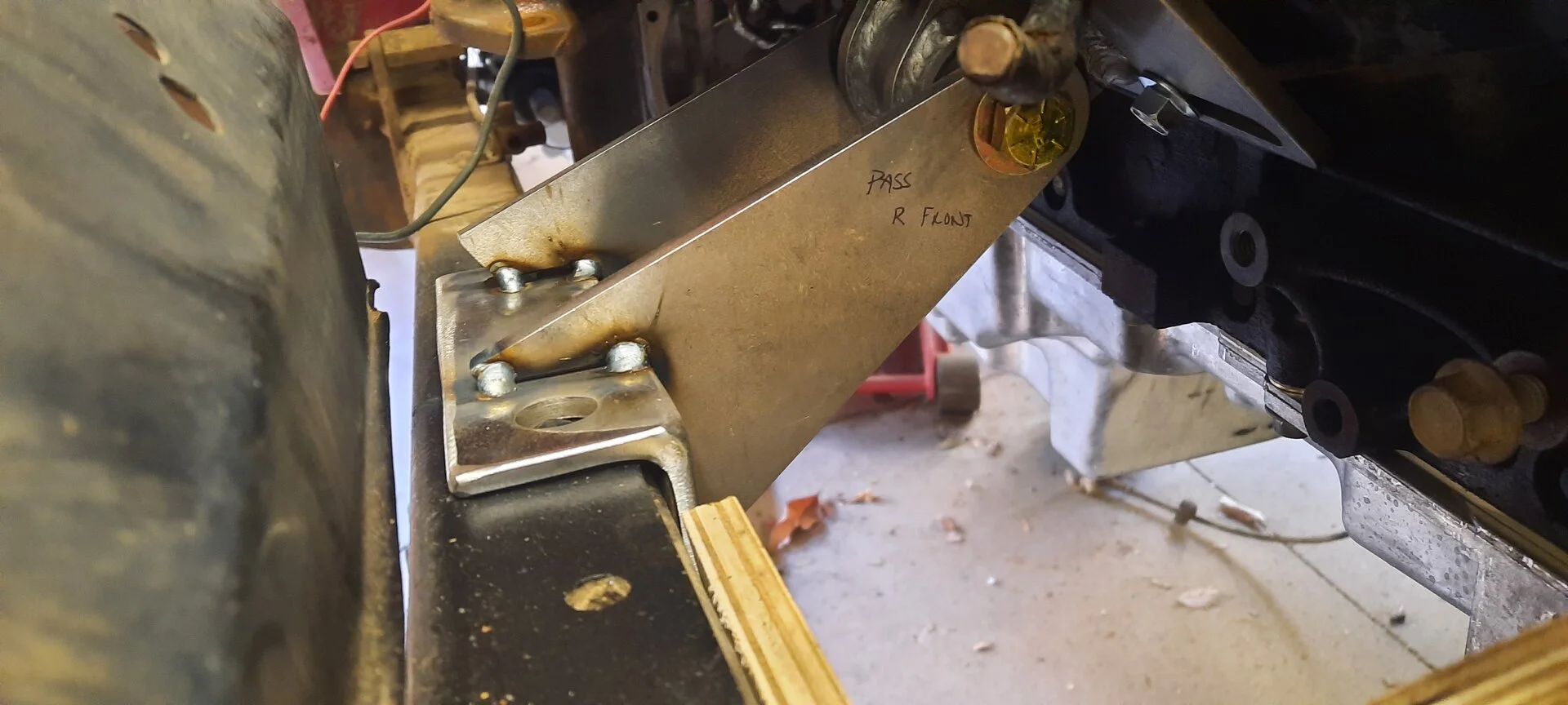

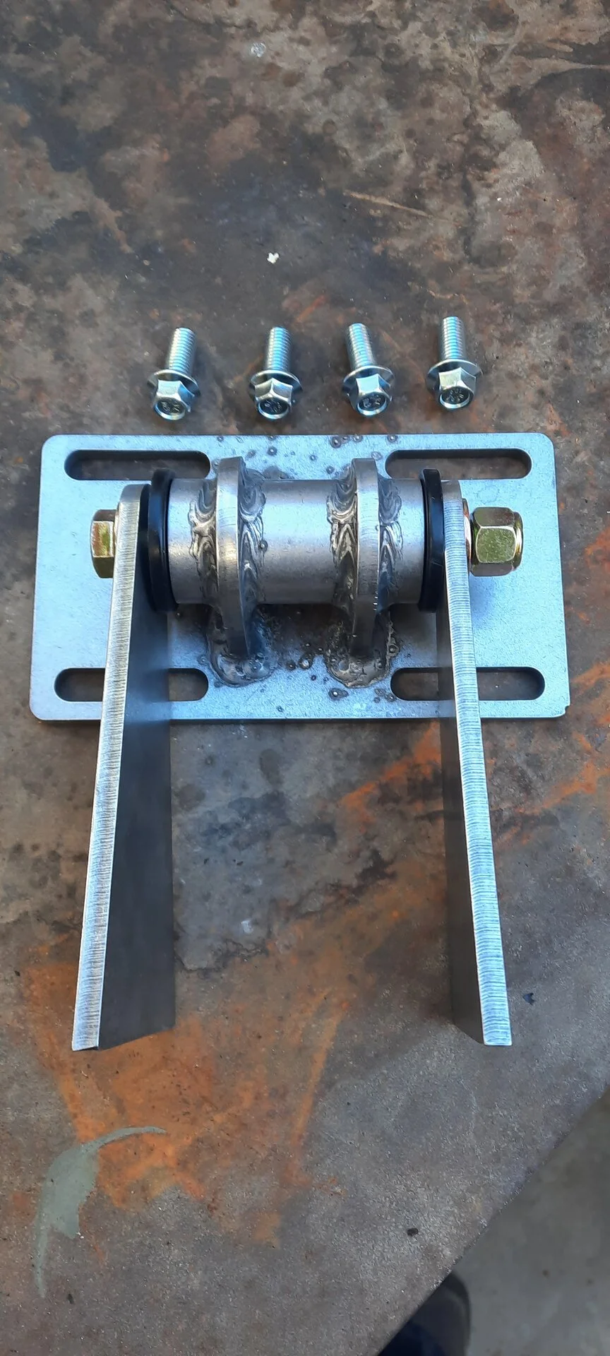

I bought Dirty Dingo adjustable motor mounts and fitted them. I tacked them to some 3" angle iron because I couldn't commit to burning them in yet.... I'm a little chicken. These guys are well built and allow about 2" of forward/back adjustment. I just have it all tacked for right now. I'll burn them in solid soon.
Right now I have about 3/4 inch of clearance to my firewall, and I held the engine as high as practical to keep clearance for the oil pan. I bought the Hummer oil pan for extra clearance. My engine is tilted a few degrees downward in the back, giving me about 2° of difference to my rear pinion. Also, I angled the back an inch or so to the passenger side to line up with the pinion vertically and give more clearance for the front driveshaft. The top of the transfercase is just about 3/4" below the floor pan. I will need to notch slightly into the floor outside of the transmission cover for my tcase levers to come up....but very little and I think I can fabricate the pan decently to make it look good.
Right now I have a adjustable transmission crossmember holding its place. But I'm going to fabricate a new one out of 2x4 1/4" wall tube.
