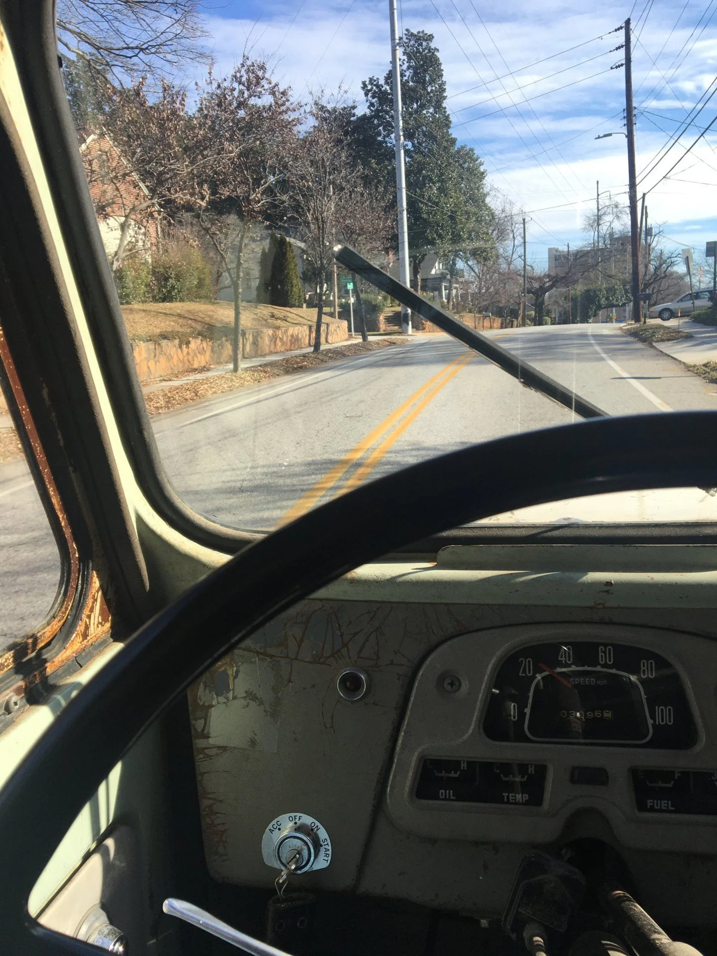

I drive my 1F 3 speed LV throughout Atlanta on a regular bassis. Given that the axles and brakes are FJ60 parts helps but I wouldn't ruin the soul of the truck in exchange for a V8.

They are more fun when you are driving them.

As hot as any tin box without AC. I just don't drive it when it's more than 85 outside.
