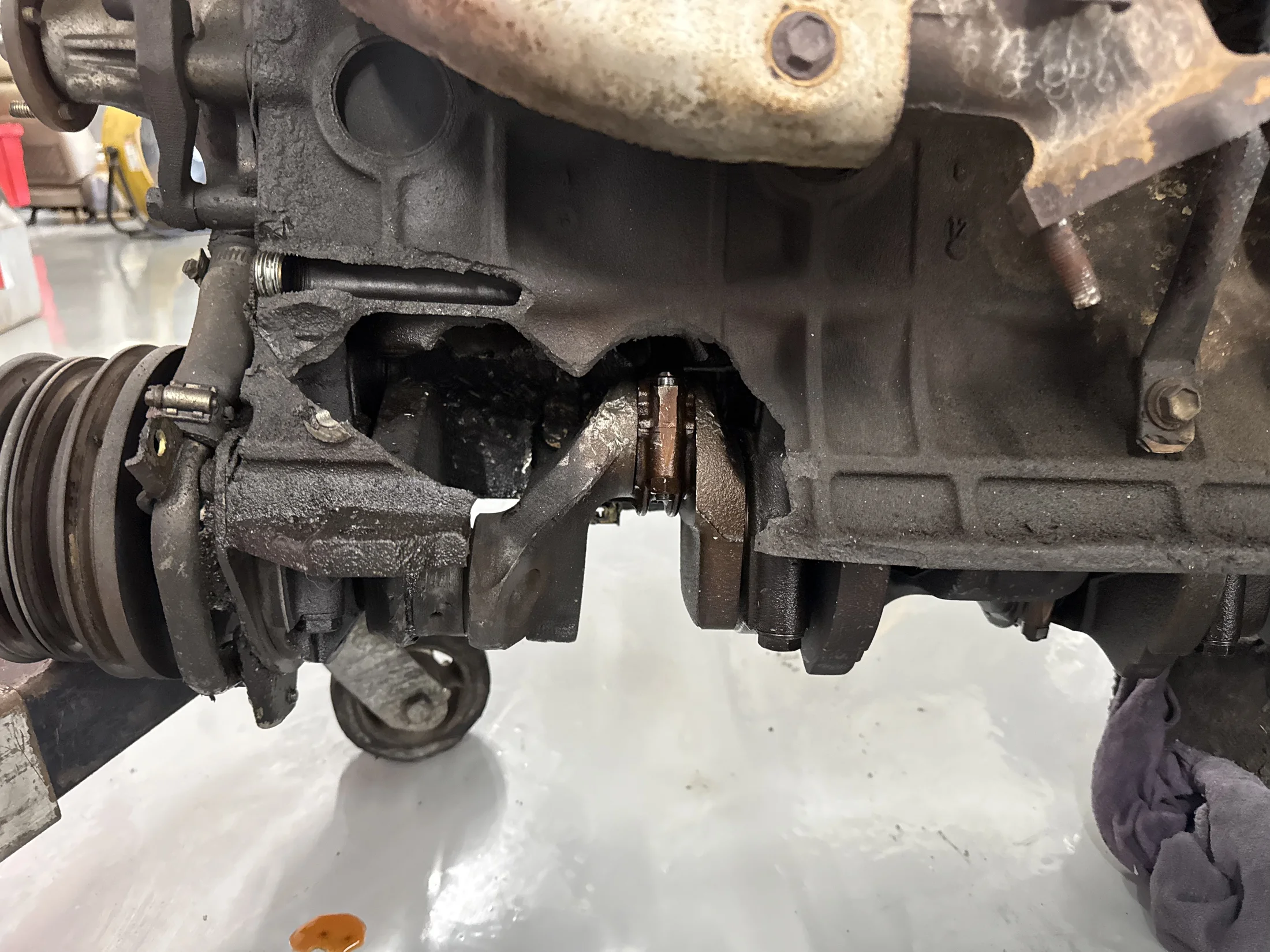

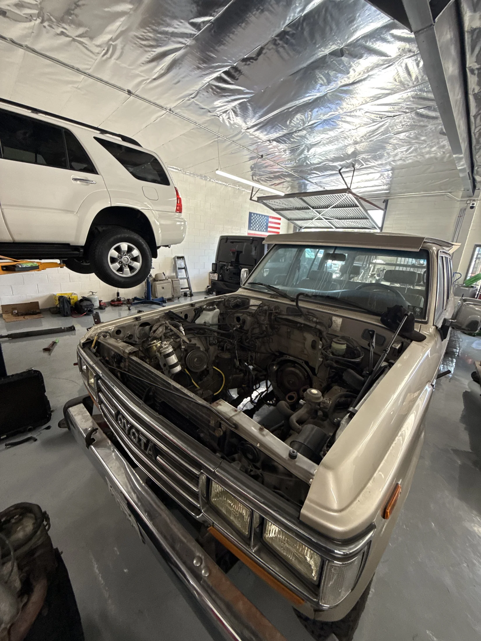

It's in the shop. Got caught up on a long queue but the engine is out. A better view of the damage now too. Hoping progress goes faster here on out.
Holy crackerjacks!
Holy smokes! That's cringe worthy just looking at it! I would had to change my clothes if I went through that explosion!
It's in the shop. Got caught up on a long queue but the engine is out. A better view of the damage now too. Hoping progress goes faster here on out. View attachment 3997742
You win the 60 series carnage award of the year. That is some impressive damage.
Ya I don’t really see a problem. Some jb weld and fresh oil and, well, boom isn’t the right word here but….
Update: Up and running with a used lower mileage 3FE! 160,000 as per mechanic. So far, it's running smoother than ever! Replaced the water pump, some bearings and pulleys, thermostat and replaced all the seals and gaskets since the engine was out. Happy to be back on the road!
Congratulations! Glad to hear you are back on the road! Three words, frequent oil changes!
Happy Trails!
Awesome, glad to hear you are back on the road.
You must have some good friends or you are a TLC mechanic cuz what took me 6 months of almost daily work took you a month! U da man!
