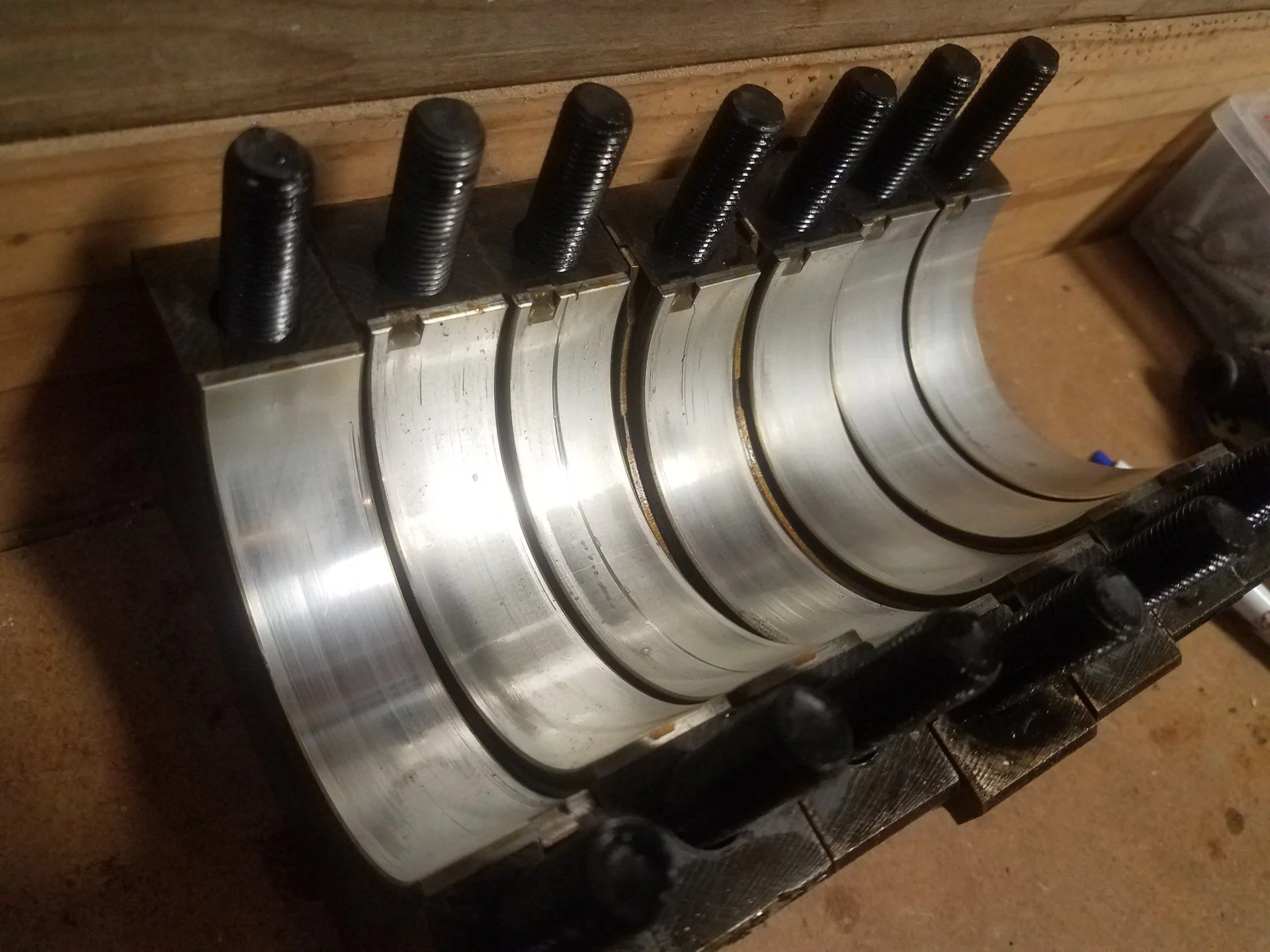

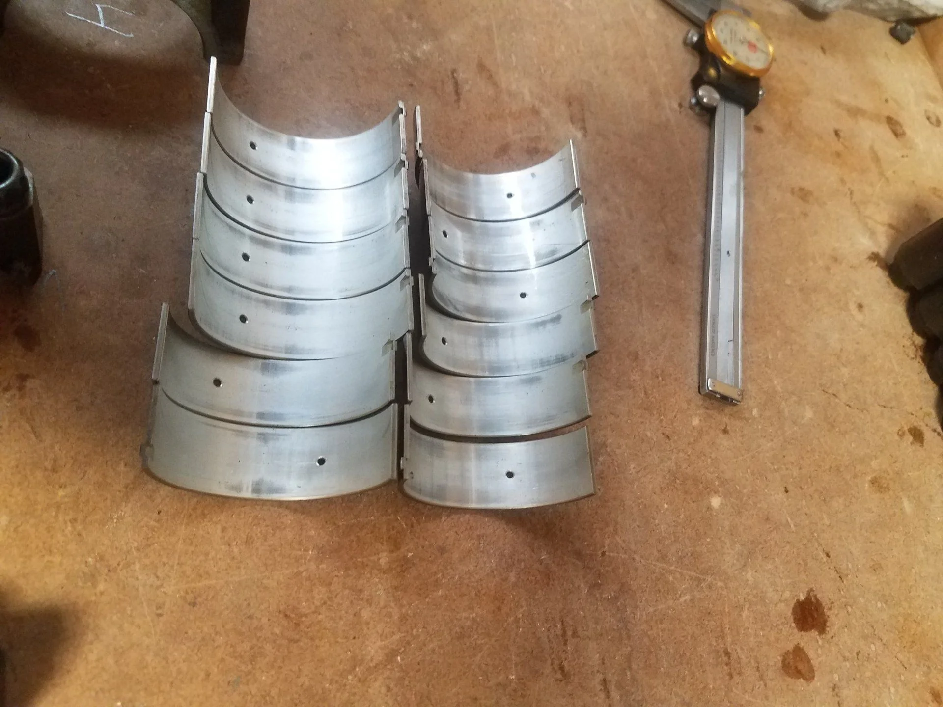

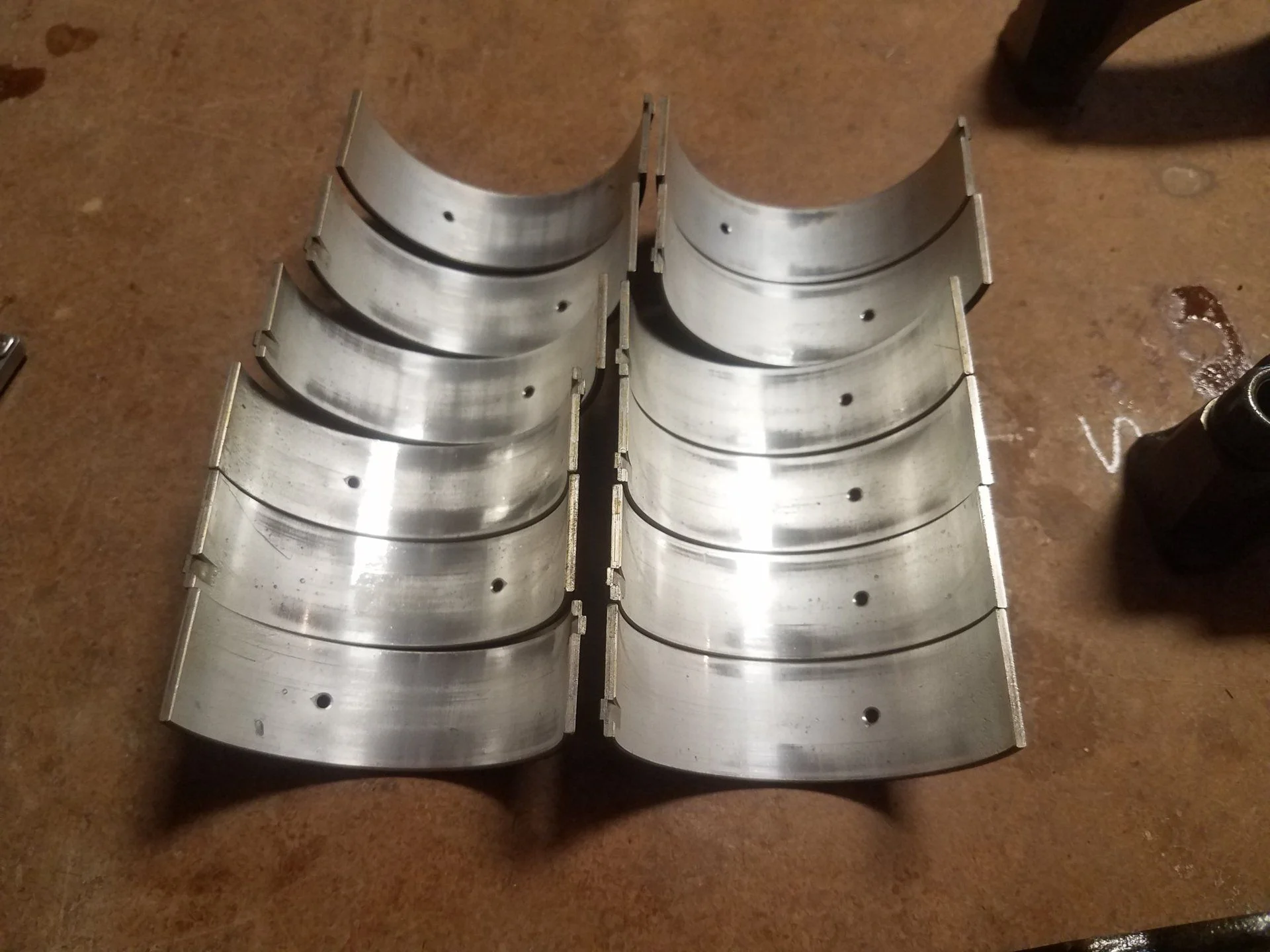

Please see if you can lay out your bearings from 1-6 and get some good pictures. If I remember correctly there is a little cryptic method with Toyota's bearings just make sure your parts guy understands that.

The filter that was on it was a Toyota filter and the one I replaced it with was a NAPA. I have no idea why the nut came loose. It hasn't been touched since I have owned it (3 years). I wasn't aware of the pulley driving the oil pump, and I thought that the steering going out was something related to my adjusting the steering gear about a month ago. I just figured I had over tightened the set screw. After tightening up the pulley, I turned the wheels back and forth with no problem. I can post pictures of the bearings tomorrow.

The interesting part to me is that the knock was gone after tightening the pulley, but came back as soon as I changed the oil. I don't think it has anything to do with the oil filter because a usually use the napa filter and this problem is clearly from loosing oil pressure. One thing that I forgot to mention is that there was about half a dozen metal shavings in the oil pump pickup screen. All of my cylinder walls look good so maybe not the wrist pin. Possibly a lifter?
We can speculate about every part in the engine without helping you. You say you pulled the bearings. Did you pull the pistons? If so what did the rings look like? If not, why not? You already know what a job it is to remove the pans; it's not like you are likely to go back later and check them, without tearing the engine down.
If you've inspected the lower half, and thoroughly cleaned the pans while they were out, you've had the opportunity to verify that everything below the head is intact. If it is, you need to remove the valve cover and inspect the head. You should not have any metal "shavings" in your engine.
It's unwise to restart the engine without finding the root cause of this failure.
Regardless, we can't help without seeing what you're seeing.

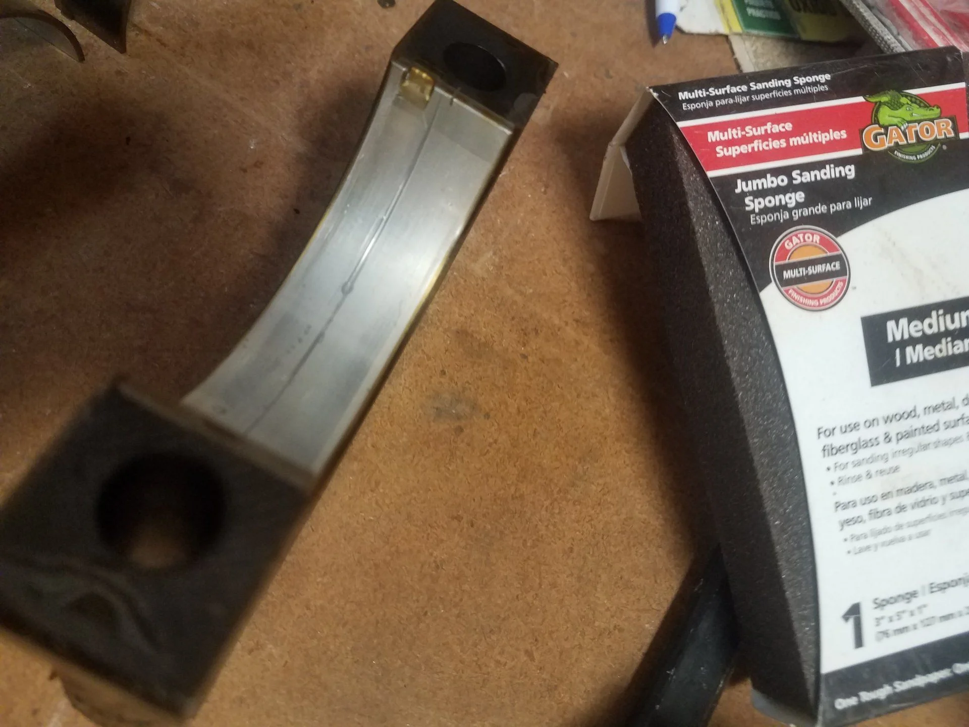

One of my main bearings was groved with a piece of metal stuck to the end of the bearing. The rest look fine and the micrometer on the crank and bearings are all within specs. I think the metal that groved my main bearing came from somewhere else in the motor. At this point I am leaning towards a full rebuild or dropping in a Japanese import. 1800 bucks for one of those with 50k miles.
