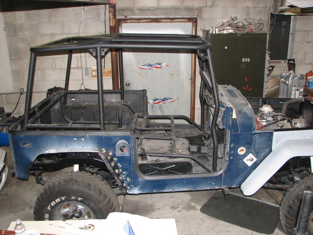

Success!
Not to shabby for a one man job :nuts:

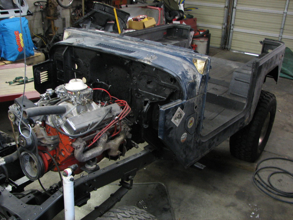

In the last 2 days, I been able to get a few items back in place.

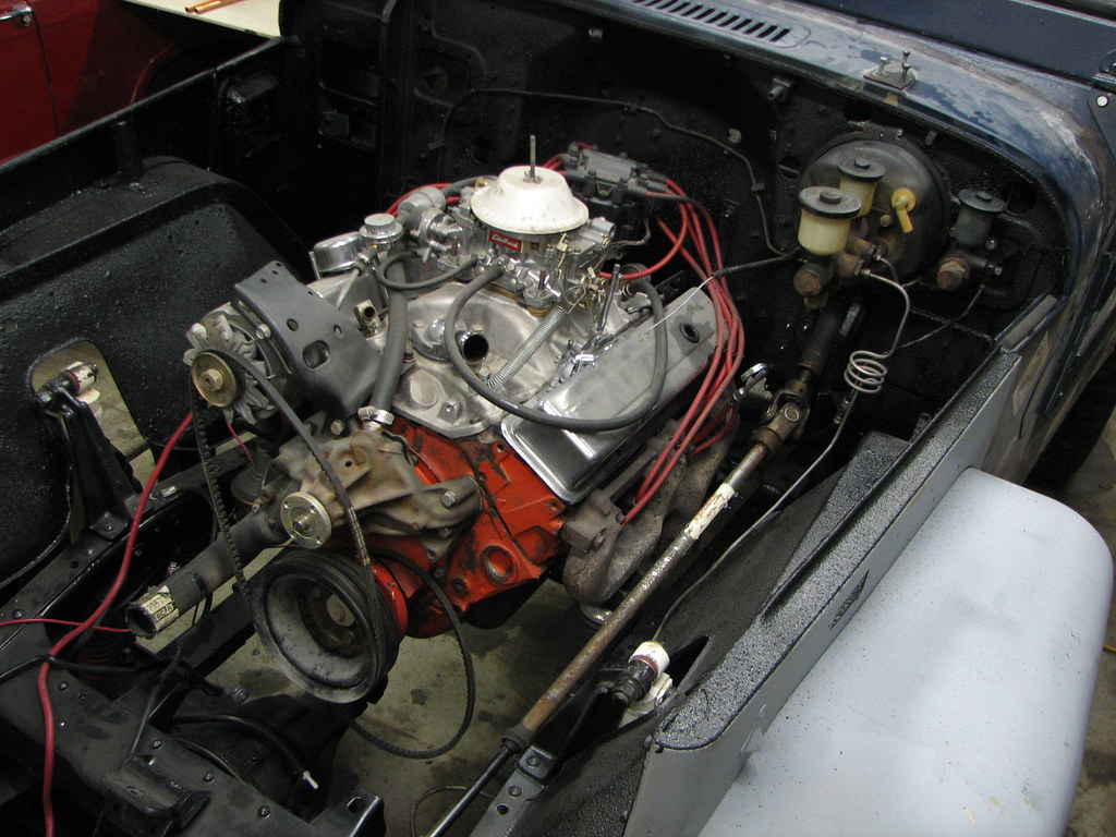

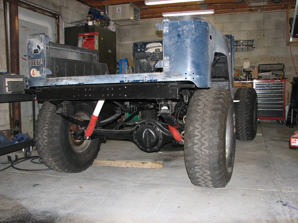

Ive bolted down the cage, Put the Master Cylinder back in as well as the Clutch Cylinder, All the plumbing is done, Moved the shock mounts from the front to the rear of the axle so the angle and binding are fixed, put on the shifter boot, Installed the windshield, I had to drill out 2 screws :rolleyes: Bled the brakes and man were they stubborn, Im sure there were a few other things I cant remember today.

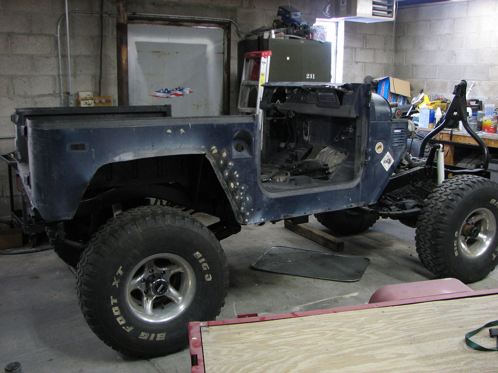

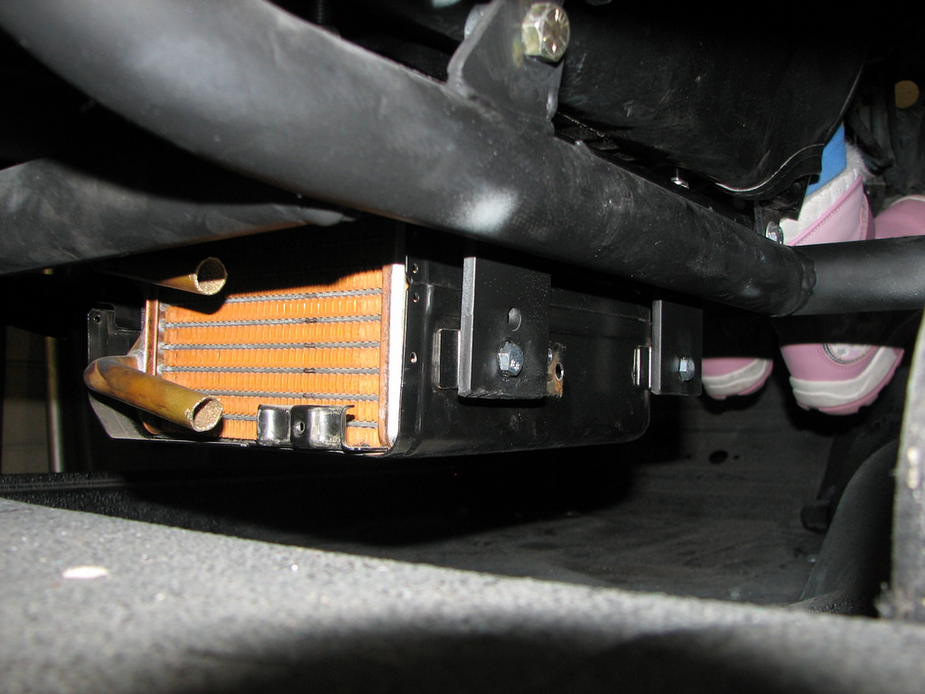

Things are coming together a little here.
Fixing the shock mount was a lot easier than I thought, Angles are looking much better.

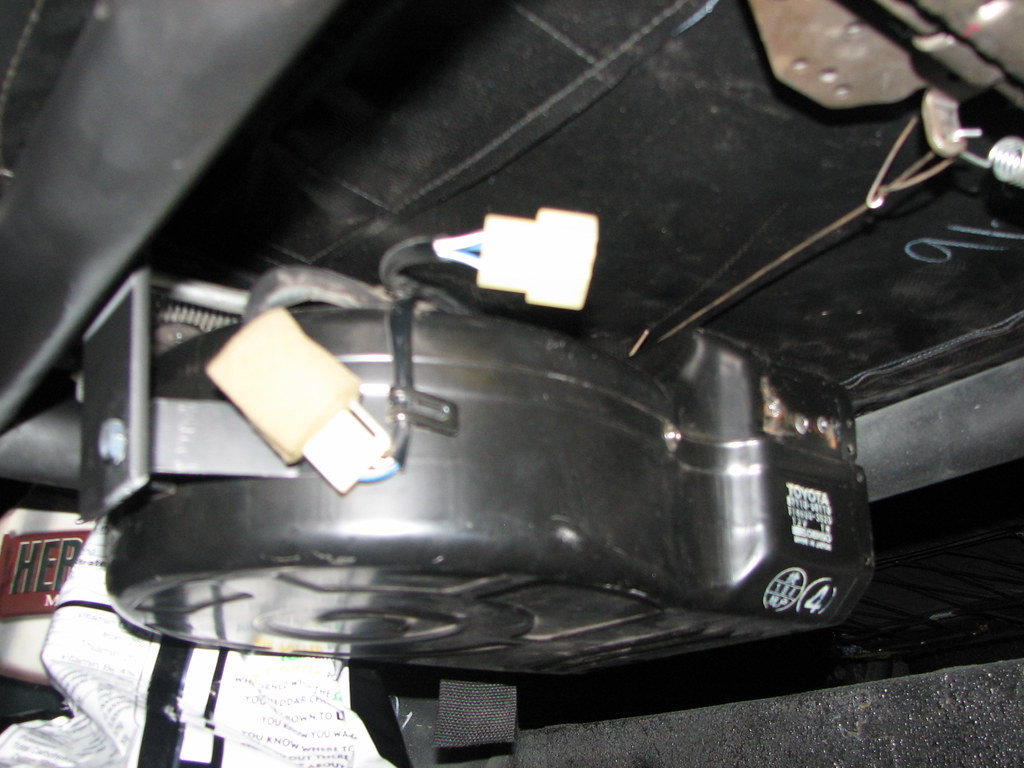

I mounted a rear heater from an 80 series under the driver seat, I need to figure out a good way to direct the air.
Ive been having a little trouble with Brake Master, It wont hold pressure, I have a new hose and Slave on it, But I may need to rebuild the Master.
