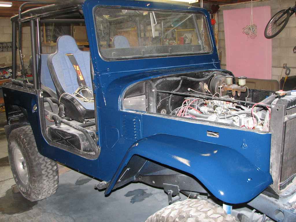

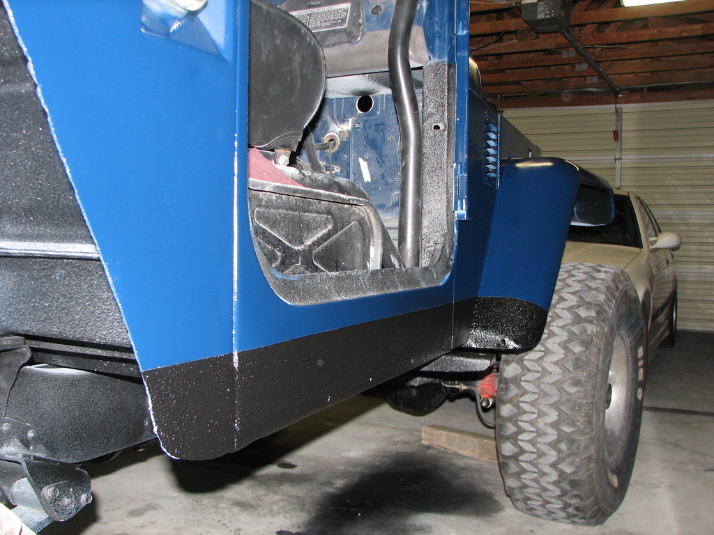

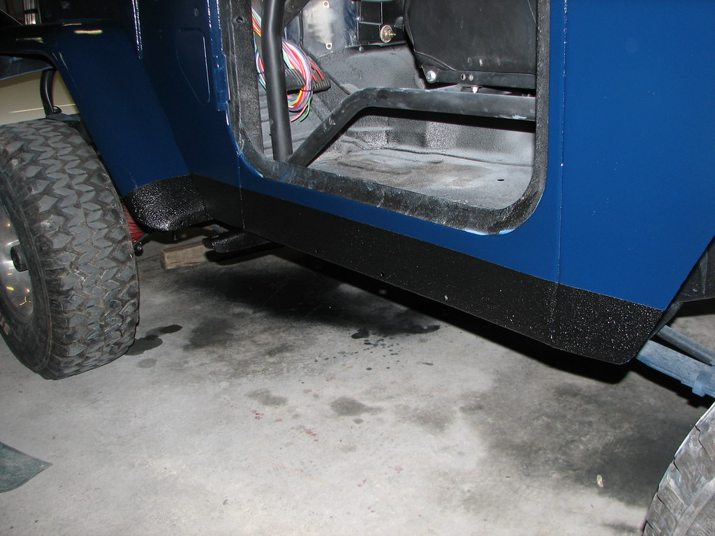

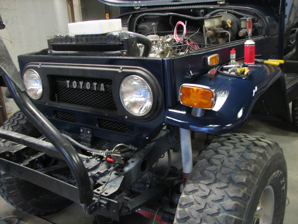

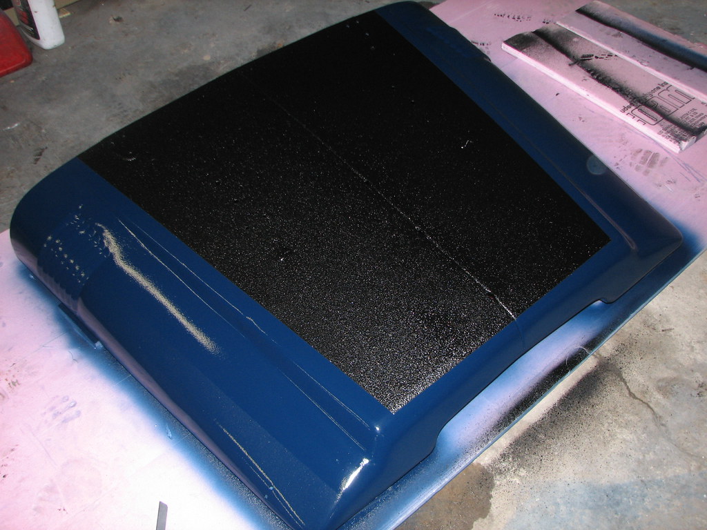

Well, Here it is, Upon further inspection, I got a run on the hood, Only one buy its a drag...
Its an interesting paint so far, You can see what it does with and without a flash.

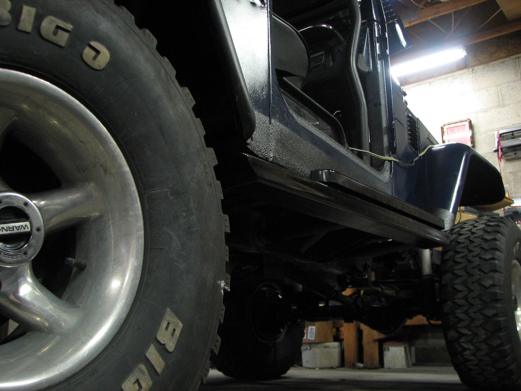

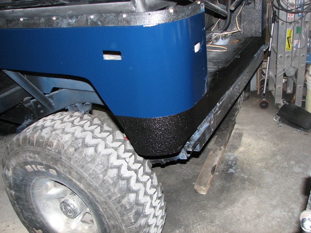

I did not sand after the primer, This may sound odd, But I wanted a little bit of a hammerite texture, Thats what I got, There was a bit more dust in the air as well, I have crap all over it, Oh well, If Im not happy tomorrow, I will see about sanding and adding a clear coat, BTW, The paint I used is a three part paint, It has the Paint, reducer and "wet look" enamel hardener, I did 3 coats of primer and 3 paint.
Looks great to me! Thats what I am looking for. I need to find a paint shop to buy some paint I guess now. :)
Great job and nice blue choice!
Congrats!

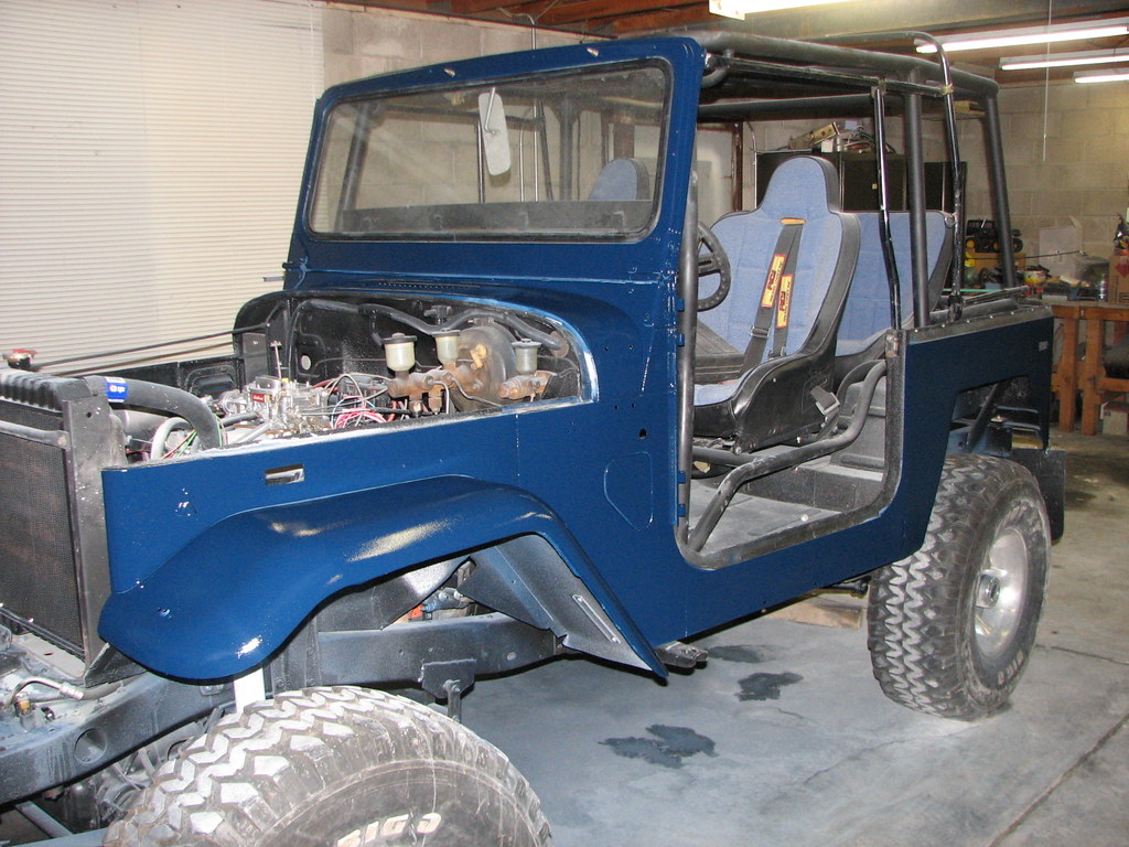

So I decided I was going to repaint it, I asked my friend who use to paint vehicles, He said just give it a wet sand with 1000 grit or higher just to rought it up and give it a good coat, I did so and Im much happier with the turn out, I also did a little research on adjusting my siphon sprayer.
I also decided I would add a little accent to the paint.
I hope you enjoy, cuz I like :) My wife even said Im a bit happier this after noon :cool:

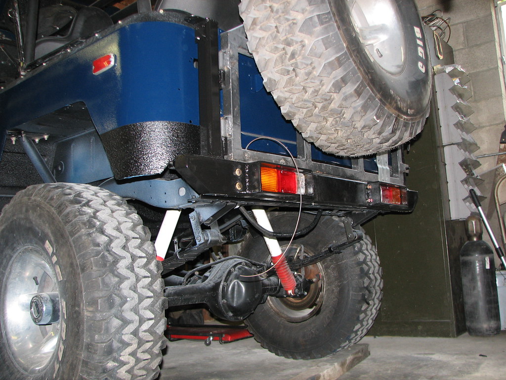

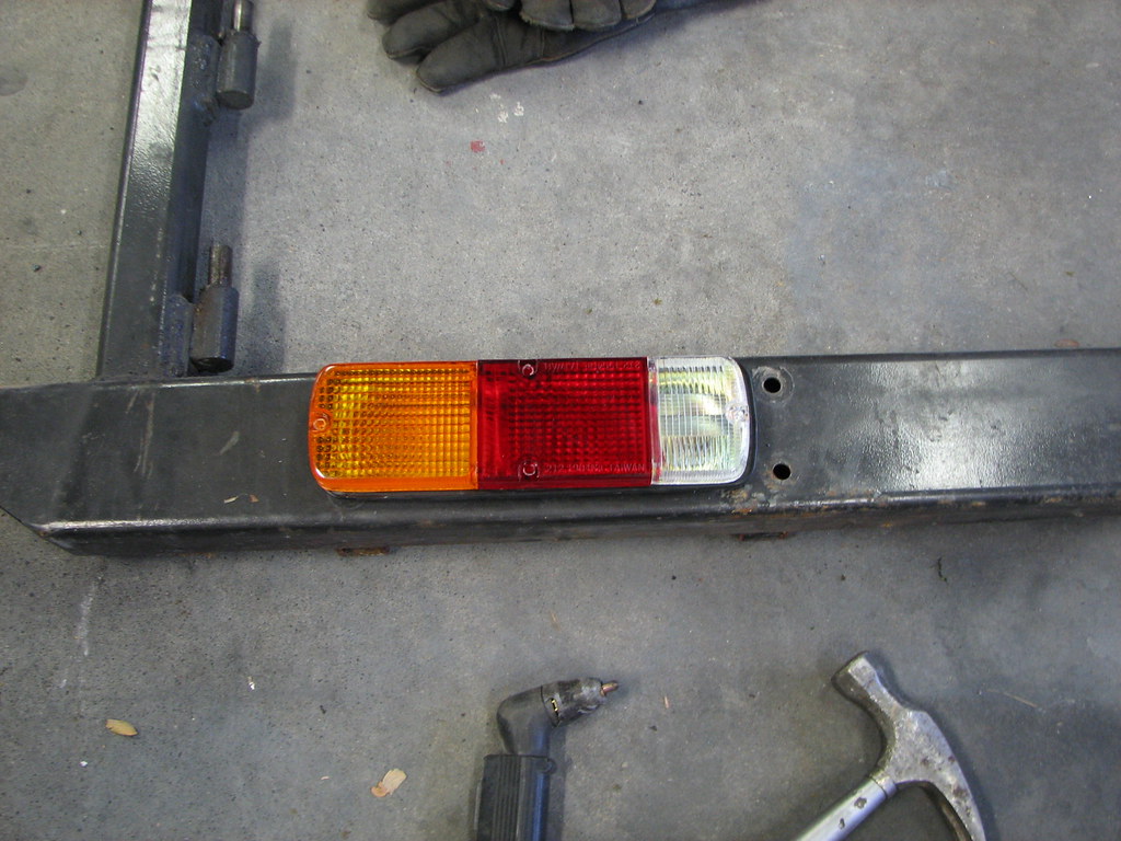

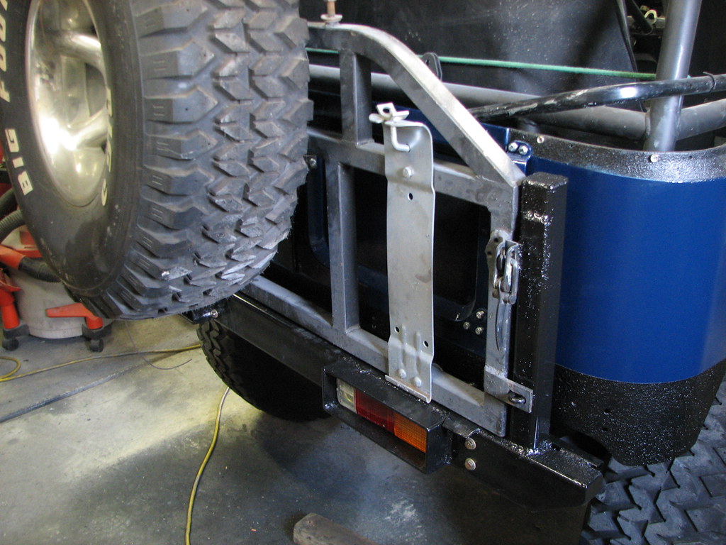

Ive been working on the rear tire carrier and decided to upgrade tail lights from the trailer/Heep lights I was using, I know my 7 year old tire carrier isnt the most beautiful thing to look at, But it works :flipoff2:
Things are coming along, Im hoping for a late July early Aug. finish date...We shall see...

Lights purchased from Kurt, I built the light guards, I still need to repaint the tire rack.
Oh boy! look at all that over spray.... :rolleyes:

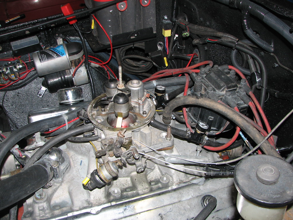

Everyone NEEDs Fuel injection right?!?
I still need to tune it and add a relay or two, But it at least runs :)

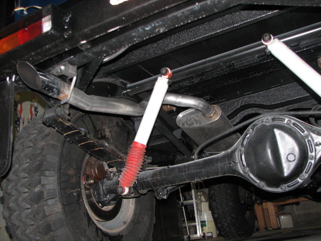

Some new exhaust, I was going to try to build my own, But I am running out of time.

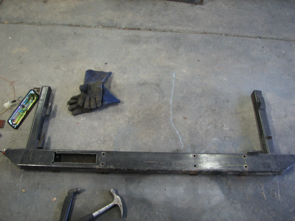

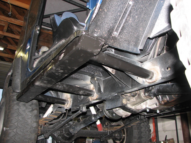

Last bun certainly not least, Sliders! I think I should put a few gussets in there.
More to come :cheers:
