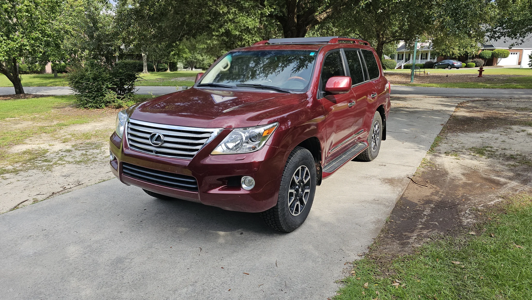

Maybe you experts can help me. I've read through the entire thread but I'm still struggling to make a decision on what parts to get. I just finished a sensor adjustment, fluid flush, and alignment. I love the way the truck sits now but it doesn't drive well. It's bouncy is all get out even after the fluid flush.
Something tells me I have new accumulators in my future and while I was in there I wanted to try to use some of these modifications to make up for the sensor list. If I did a max lift, I believe that puts me at about 1 in of added height. Based on what I'm reading, that means I should be looking for somewhere around a 13 mm spacer. At this point in time, should I just be looking at getting the e&e off-road parts?
There isn't too terribly much extra weight in my machine. Just a Dometic fridge in the back and occasionally some luggage or kids. I'd like to have slightly better than normal performance off-road but most of what I'll be doing is difficult fire trails in the Appalachians. What I'm really after is getting the performance of the car back to stock while on road and keeping my height.

The bouncy ride after sensor lift is a classic symptom of worn accumulators. You're right that accumulators should be in your future. It'll be the best money spent and you'll be surprised how great the ride is after.
E&E Off Road 13mm front spacer and rear shock spacer are the cheat codes to enabling long travel goodness. It brings a new level of slinkiness, downtravel, and articulation that's magic offroad. For the price, capability, and amplifying all the stock qualities with practically zero cons, this mod simply can't be beat.
And if you're so inclined and ready to turn it up another level, a 1" body lift can work wonders to lift up the front and rear bumpers for more approach and departure, gain visual height, while keeping the center of gravity low.

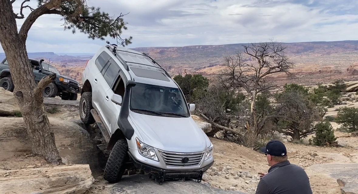

I did the NST 1.5” body lift first and will be adding E&E’s parts front and rear, and going to try to stuff 37’s with minimal trimming to start all without touching the ahc sensors. But we’ll see what happens. Finding the perfect wheel offset might be the challenge.
Chris
Get ready to do a lot of cutting up front. And then get ready to enjoy how awesome 37s on these rigs are

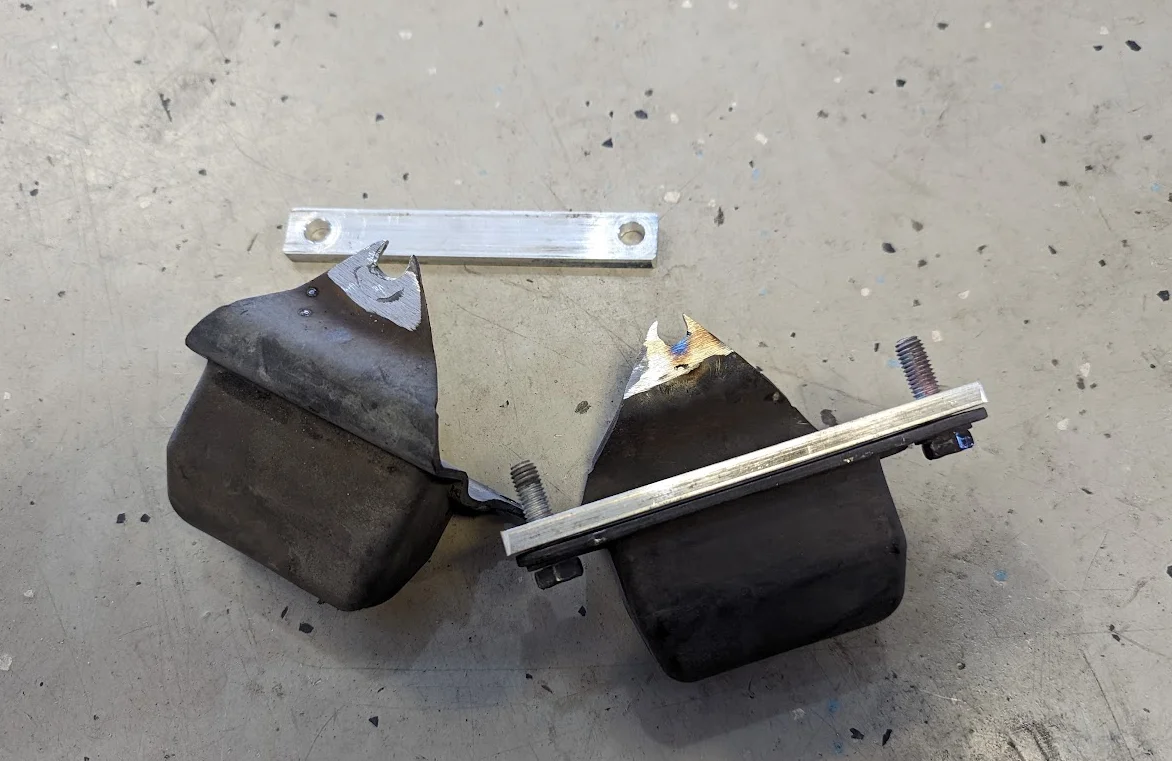

The long travel brackets themselves do not drive the need for rear spring spacers. It's really about the amount of lift relative to stock and that is governed by the sensor lift and/or height offset. So the minimum spring spacer should be that delta of stock ride height to new ride height. That said, AHC adapts rather well to more spring spacer (to a point). For example, I've lifted the rear 30mm. I have 45mm worth or rear spring spacer. I also have about 200lbs of added rear weight.
What’s the right bump stop choice to go with rear spring spacers and E&E shock brackets to prevent bottoming out the read shock/ram?
Maybe 1/4" worth of shimming might be good under the rear frame bump stops, jounce stops, or both. For the spring spacer, I actually have a 40mm coil spring spacer, but 5mm shim packer above the jounce stop and in between the frame. This effectively lowers the jounce stop 5mm. I also modded the frame bump stop with 1/4" aluminum stock.
As I'm driving harder these days, I added Durabumps all around which makes a nice difference in really hard Baja style running. AHC shocks in sport is also useful when running hard to keep things off the stops.

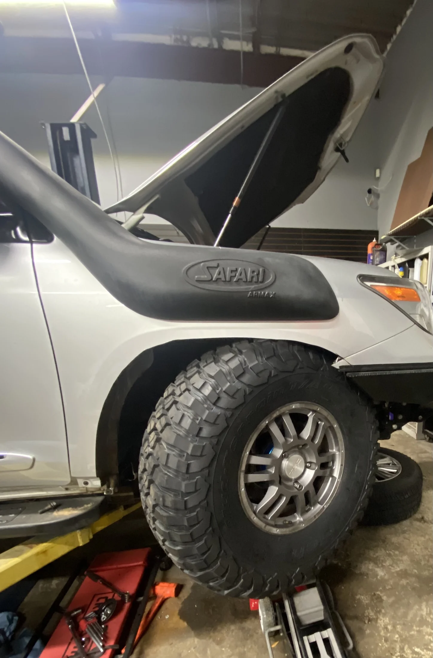

Here’s me early on in the cutting on RW, 1.25” spacer, tundra arms, but no body lift yet. I run billet OTRE though which require the spacer. I probably went a little aggressive but I didn’t rub going downhill
Thanks for the feedback...couple of questions if you don't care:
1) What's the wheel offset you're running with the 1.25" spacers?
2) What is a Billet OTRE exactly?
3) Wheel/tire combo?

Glad to help someone fit 37s!
1) Rock Warriors are +50, but when I sent them off to convert to beadlocks I dropped down to a .75" bora spacer as it widens the wheel by about 1/2-3/4"
2) When switching to tundra arms I wasn't happy with the thread engagement of the stock tundra OTRE, so switched to these. If you call him, he will preset them to the correct distance for tundra arms!
3) I run 37" KM3s on OMF-converted RWs, and then 37" KO2s on regular RWs
