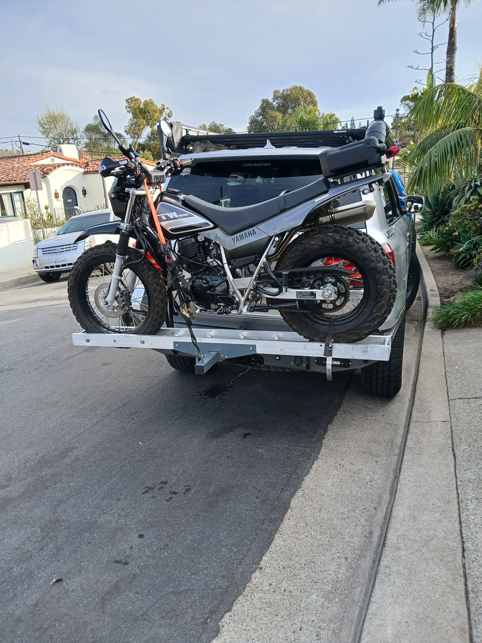

I was wondering what you think about the e&e off road lower rear shock mounts and if it would cause and issues with AHC pressure or spring pre load ?? I have stock rear springs, Wescott spacers and e&e lower shock mounts, max sensor and my AHC struggles to achieve High when I load my rig. Even just with my 300lb Yamaha TW200 on the back.
If anything, your spacer is helping you. But 300lbs that far behind the rear axle is a lot more weight on the axle than 300lbs. That combined with a max sensor lift and you are probably asking too much of the AHC system. Also, just from that picture, i see you have an aftermarket rear bumper and that rack holding the bike are all contributing.

E&Es rear lower shock mounts are the ticket but don't completely help as it's not pre-loading the spring. The Wescott rear spacer (I think 30mm?) is what's doign most of the pre-load help. To @lx200inAR 's point, it's asking a lot from the system and with the cantilevered weight which is transferring a substantial additional amount of weight from the front to rear axle.
New spring could potentially help.
Alternatively, if you can shorten the hitch carrier so it's closer to the vehicle will also help.
I like @teejnut suggestion the best.

Do you carry much more load when you off road and how does it compare loaded and unloaded ? I may add 600-700 lbs when fully loaded for a trip and don't want to be over sprung when not loaded down.

So you think I am better with the TT Springs over air bags as you have done ? I carry 400-700 added pounds on a trip and was thinking new springs and air bags may be the ticket.

I removed third row and have drawers loaded w tools, recovery and jack, roof rack, awning, water, rear dissent bumper w/no swings etc.. When I do a trip I carry everything you do and sometimes add my bike (275 lbs). Sounds like similar to you without the Moto and works well.
