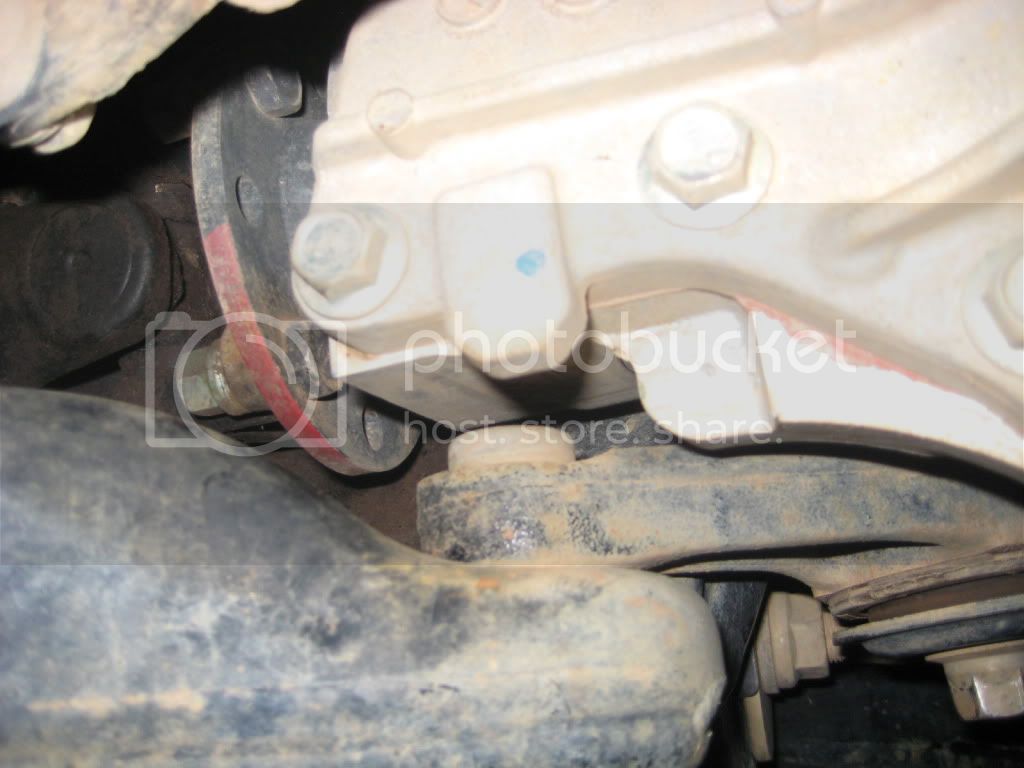

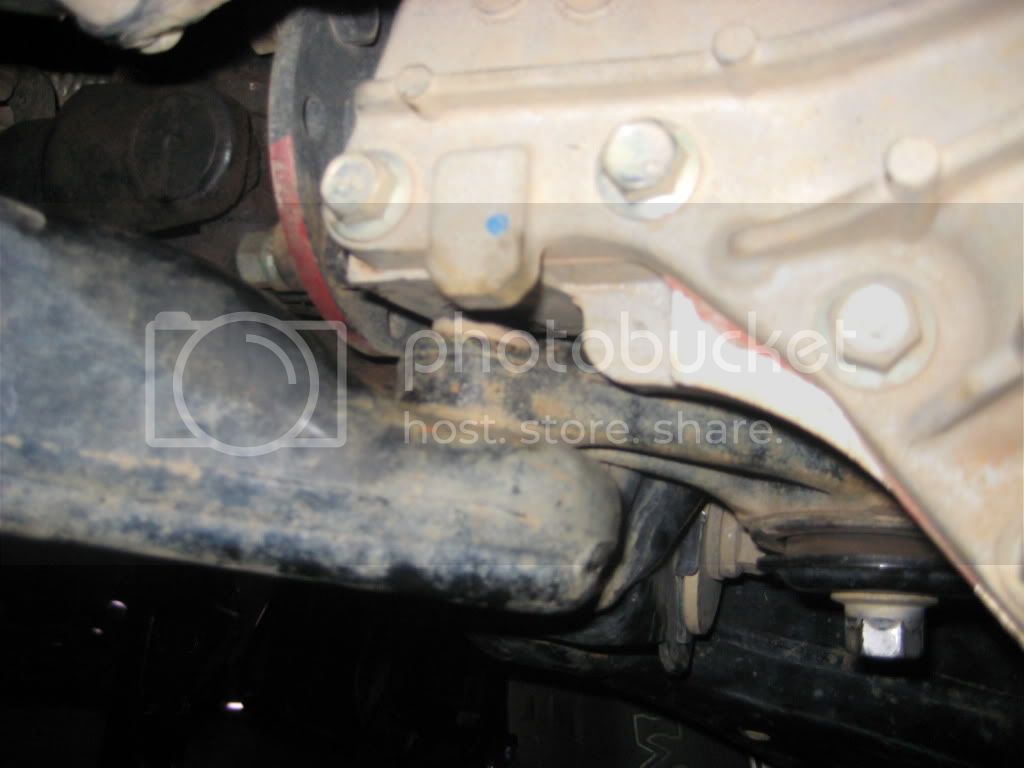

Very happy with the results, have lost 5-7 degrees on the CV's
Pre drop
WOW (weight on wheels) 6.5-8.5 degrees (slight side to side difference due floor and KDSS??), full ext 26-28.5 degrees.
Post drop
WOW 1-2.5 degrees, full ext 19-21 degrees.

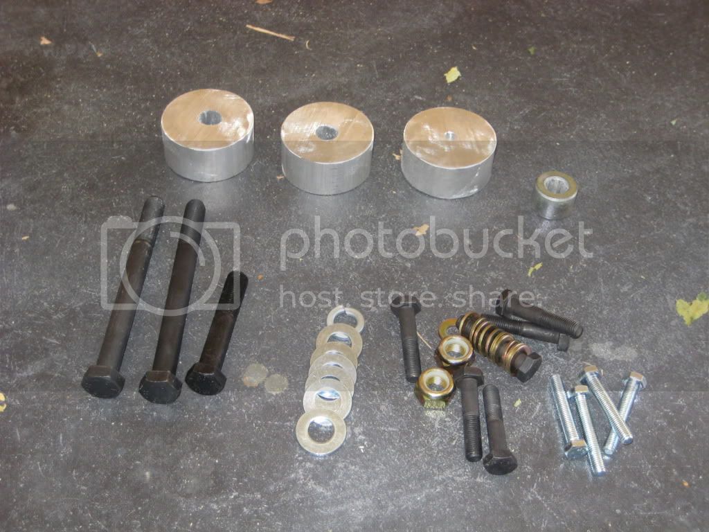

You will need, should you want same:
2x 14mm x 150mm (1.5 thread) and nylock (fwd mounts) ($6-$18 each, most expensive item)
1x 14mm x 80mm (1.5 thread) (aft mount, O/B)
6 x 10mm x 50mm (1.25 thread) (fwd mount bash plates).
3x spacers (2x fwd mounts and 1x bash panel aft backbone support). I used 65mm x 30mm Ali Bar. $4 each inc cut
6x spacers (3x each fwd mount bash cover). 25mm x 20mm high, Ali bar. Not shown below (had not cut them yet (worst part of the job!!)
1x spacer O/B aft mount attach (25-30mm x 18mm high).
I got longer bolts for the bash panels, but they were not required, the backbone spacer and mount covers (which have attach points for panels integeral on them) works perfectly.

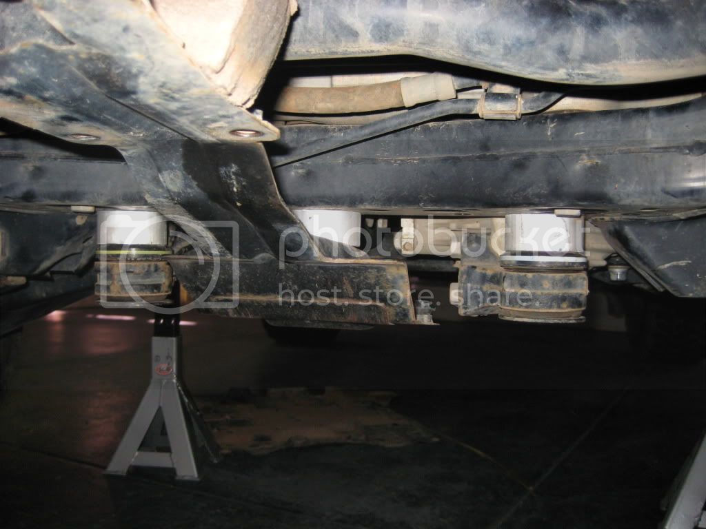

Above both fwd mount spacers with centre back bone spacer (for lack of the correct term??). Solid enough to still allow me to jack the front off it.

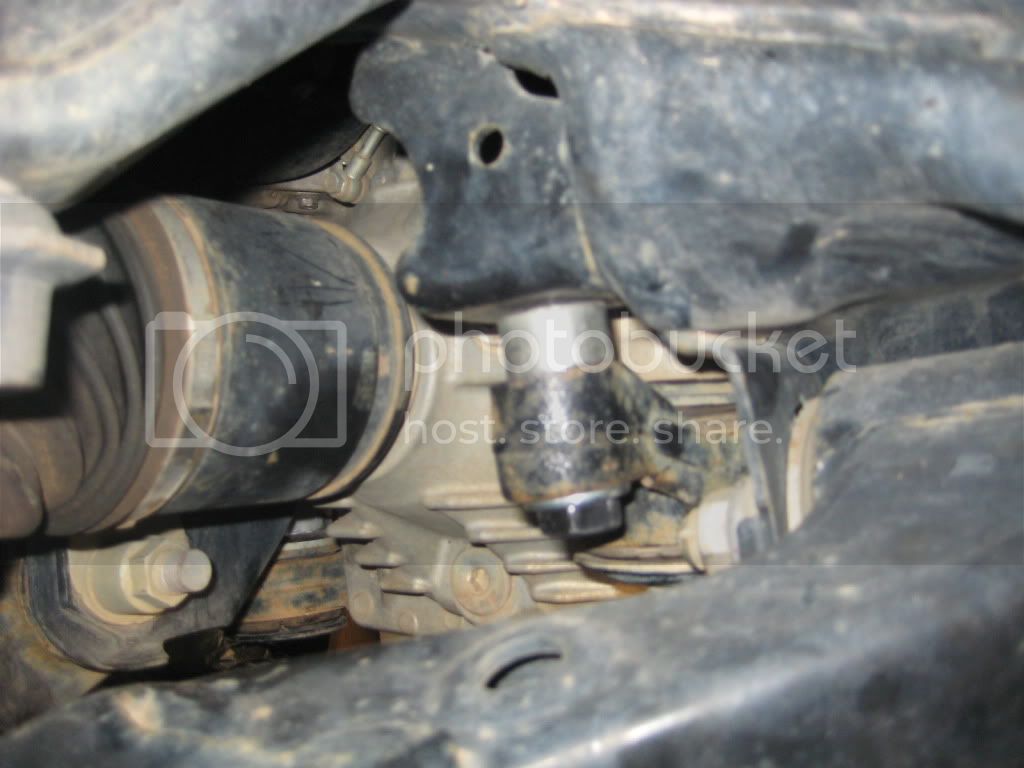

Aft mount (O/B attach point) spacer. When the fwd spacers are fitted the diff "twists" giving more clearance for the drive shaft and allowing the back to be dropped also (for a real drop).

This is the aft mount I/B side, pre drop there was about 10-15mm between the top of stud in the bracket on the chassis and the Diff. I took this bracket off and ground the stud to what you see now (half it's size) and due to the O/B spacer this has dropped 15+mm (still giving clearance for shock mount movement and Drive shaft).

Obviously (well almost from my poor shots) C and D got the 65mm x 30mm spacers, B got the 18mm spacer (it also has a chassis mounted nut), the "nut" holds the other side of the stud I ground. E, F (and the other 2x bolts holding bracket at D) were all removed to locktight (just to be sure). I fully removed the Bracket around C to check top composition and best size for spacer (also pulled it apart to look over Rubber internal shock mount).
These mounts bolt solidly to and form part of the "diff", full diff weights about 40-50kg's, each mount takes very little load, more shock/vibration mounting only in the attach points (where they are spaced). Using the below shot again, it does look like the bracket leverages off the mount, it in fact only imparts a load directly down and absorbs lateral loads and vibration (note the rubber top and bottom of the cast bracket)
