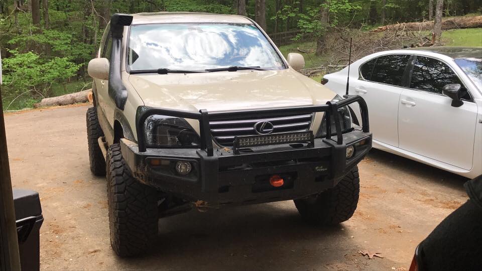

That look good? 8" wheel. 35x12.50

You can run a 12.5" (315) wide tire on an 8" wheel (see Dan's post above). It's a lot different than the car world (my MR2 has 255's on 9.25" wheels).
If you really want to go wide, look at the Total Chaos long travel kits with McQueen fiberglass fenders. You'll spend a LOT of money, but it'll put you about 8 inches wider than stock.
Dude that is so sick!
What offset are your wheels?
Could I do a similar fit with 33” tires?
That would be perfect for me
These are 255/75R17's (basically 32x10's) on 17x8 0mm wheels:
I think @GXO has the same wheel specs (17x8 0mm 4.5 BS) but am not 100% sure.
You are correct sir!!! Go to a -10 offset and it will stick out more. Also keep in mind I don't have flares
