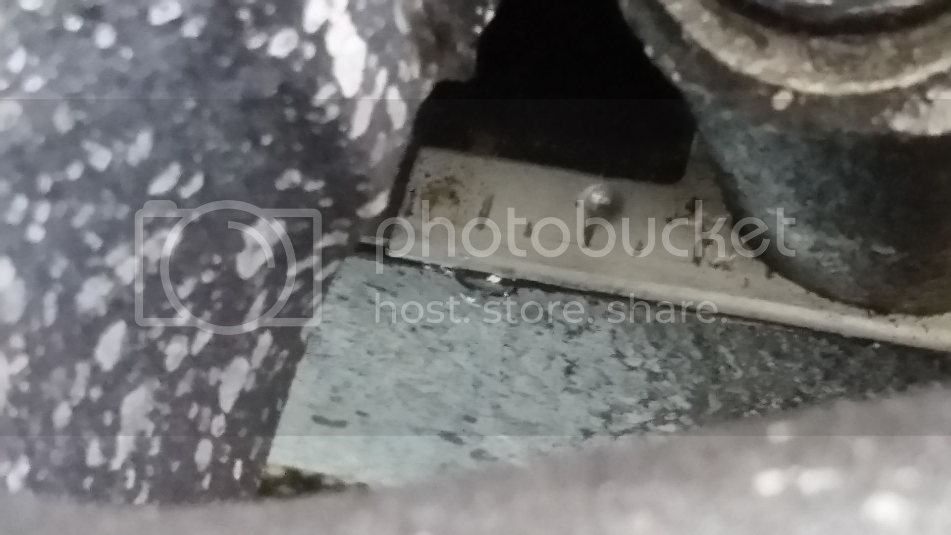

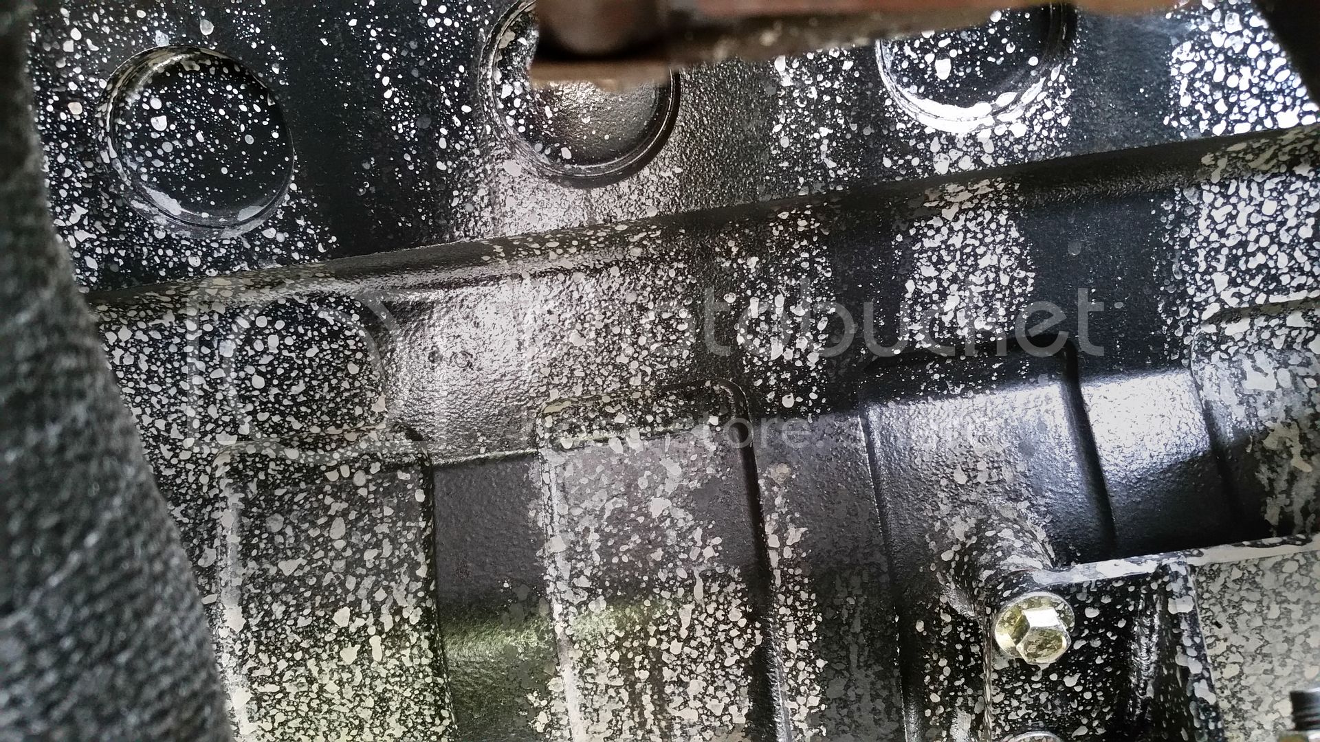

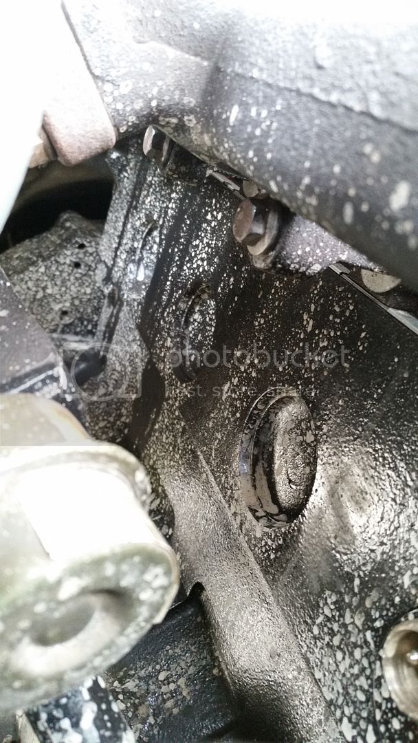

Here are a few pictures from yesterday.
Clean water markings.
Getting tired of pictures like this....
Post head stud retorque......bubbles between the HG and block/head. Only one bubble I think but none the less.
Just to clarify it's not leaking out the studs it's just and the seam of the head gasket and block/head.

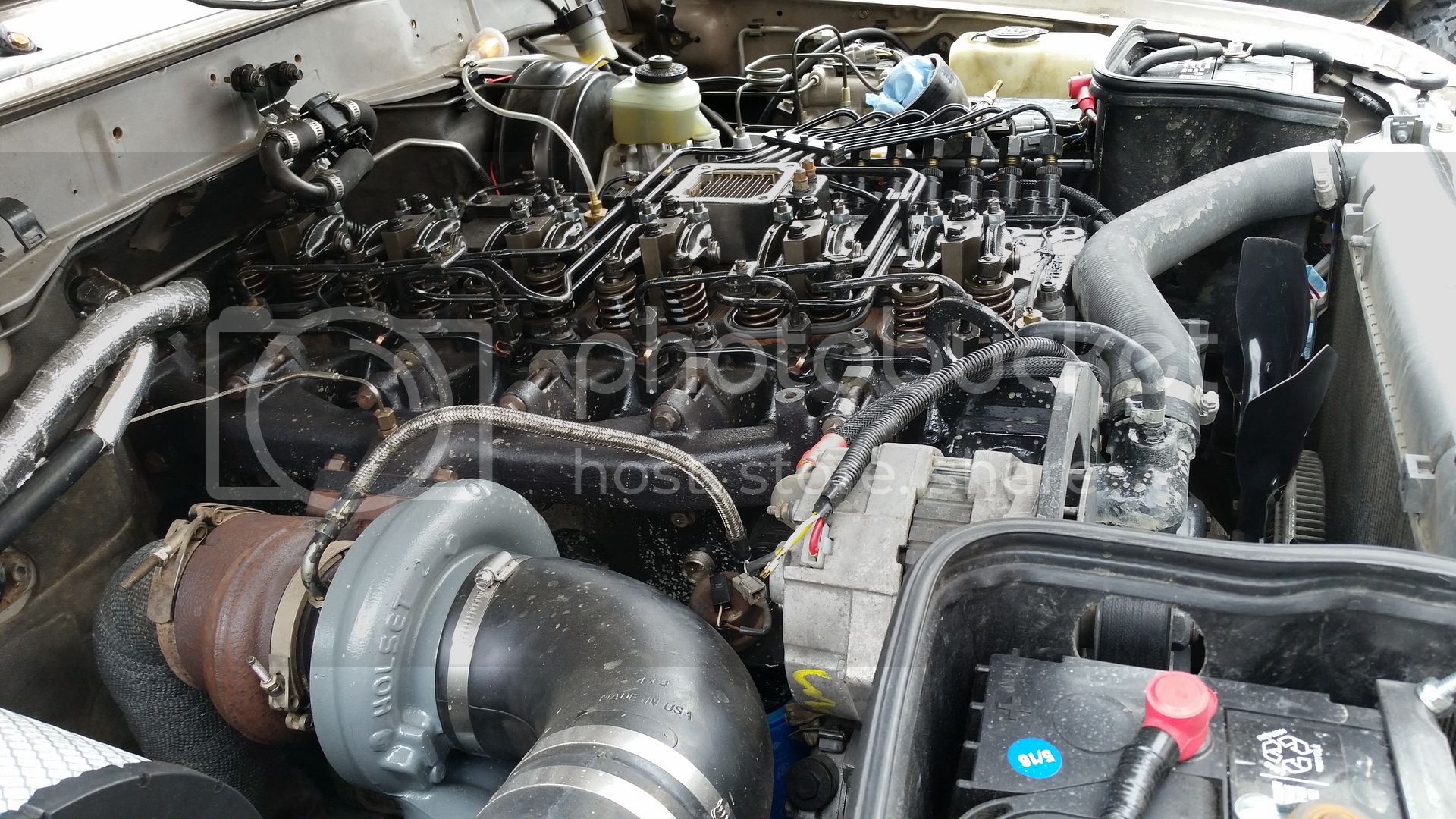

Fingers crossed for you Noob, and man that Holset looks so GD sexy in there!
