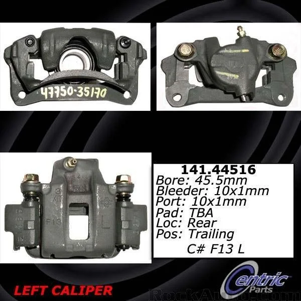

J Mack, I have no idea, they are 95 4 Runner calipers and rotors. The back are 2007 4 Runner calipers and rotors.
So do you know if you have less piston surface area on the rear calipers then the fronts?
Poking around on the enterwebs it looks like they're 46mm. I believe them to be the same front and rear.

Please explain, seems ok for toyota to use on the 4runners.
I looked up 95 4 Runner “Front” calipers.
Casting S12WF had 4 EA 43mm pistons
Casting S13WM had 4 EA 45mm pistons
So let’s assume you have one of those.
Do you know if you’re using front or rear 2007 4 runner caliper in the rear of your pig?
2007 4 Runner “Front” calipers.
Casting 13WM had 4 EA 45.5mm pistons and will look similar to your fronts.
2007 4 Runner "Rear" calipers have a single 45.5 piston and should look similar to the one below.
OK, I see what you're getting at. Yes the rears are single piston and the front is dual piston.
