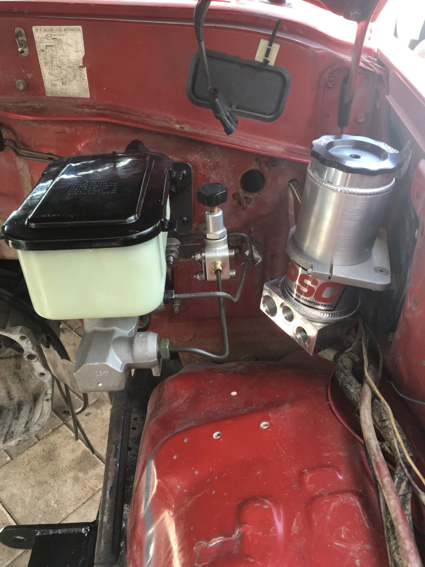

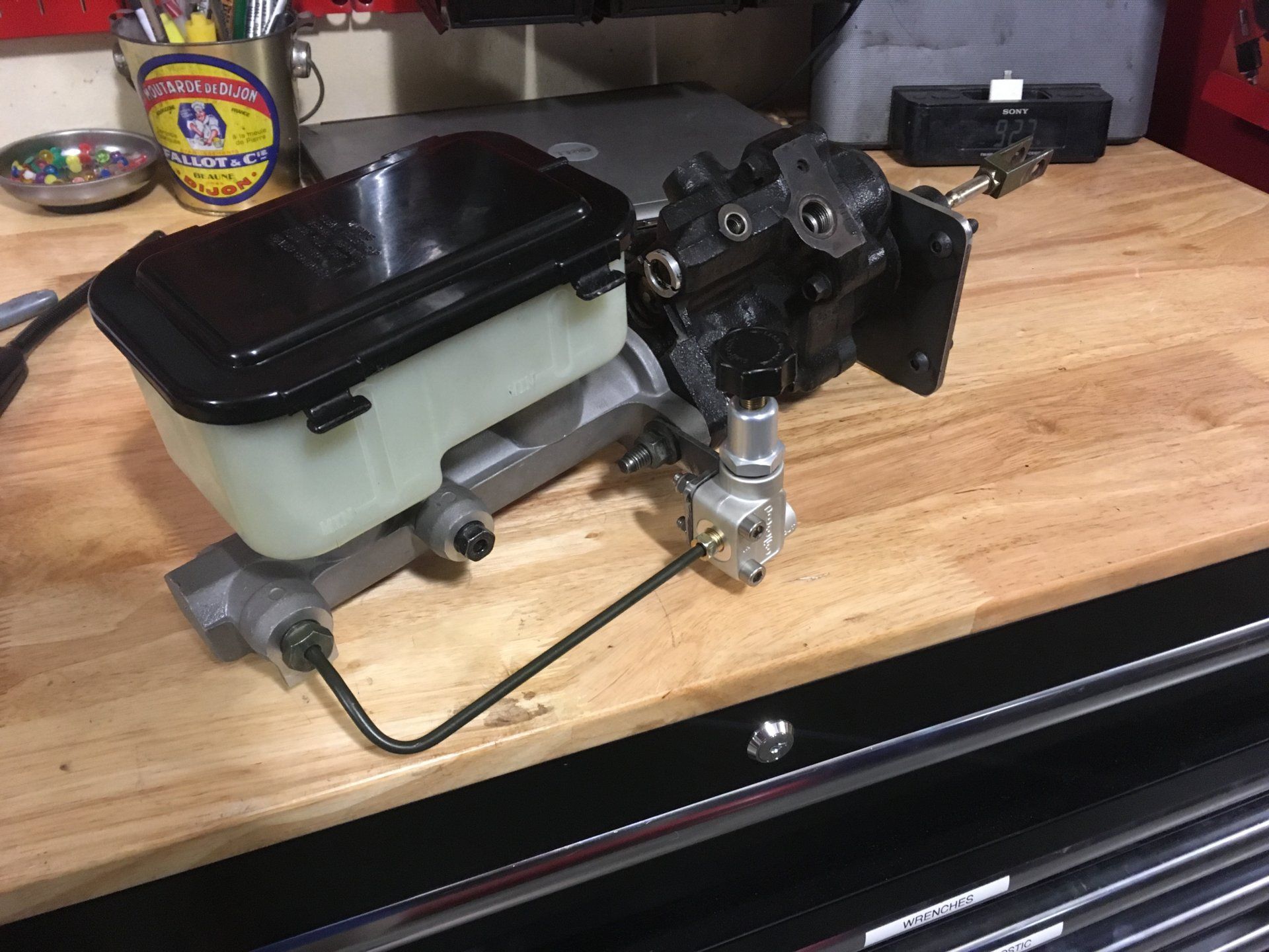

I just finished up putting GM hydroboost in my FJ62. It’s not a 55, but conceptually it’s the same. Get any booster from any GM anything from 1980-2012 or so. Also, the booster in my Cruiser and the one in my F350 look identical, but I don’t know what years Ford did what.
I can dig up the part number for this master cylinder if you’d like, it’s a 2500 Express van IIRC but it’s a 1.125” bore where they are normally a 1.25” bore (too big). I haven’t driven it yet but from everyone I’ve talked to 1.125” works well with Cruiser brakes.
I am working on an LS conversion, so GM pump with PSC housing, and PSC remote reservoir setup.
There’s a guy who sells a universal mount plate on EBay for $25, definitely worth using rather then trying to use the original mount bracket. Way cleaner and easier.
I don’t know what a 55 pedal conection looks like but you will probably have to modify the pushrod. I had to cut mine and rethread it for M10x1.25.
Let me know if you have any other questions.

One of those links had a tidbit I didn't know. Originally I was looking for an Astrovan HB because I already had the Astro PS. When I went to the yard they had a few vans with the unit still in the car and 1) I didn't want to wait to take it off. 2) the mounting plate on the van angles down off the firewall. I ended up looking on a shelf with 50+ HB/MCs of various vehicles and decided on the GM 3500 unit.
That article mentioned that the astro HB would not run front and rear discs as well as what I ended up getting. So if that is your route, I would pull off a full size pickup.
Im telling you, $100 for the HB/MC and $30 for the proportioning valve. Almost free and it works like it was meant to be in my pig.
