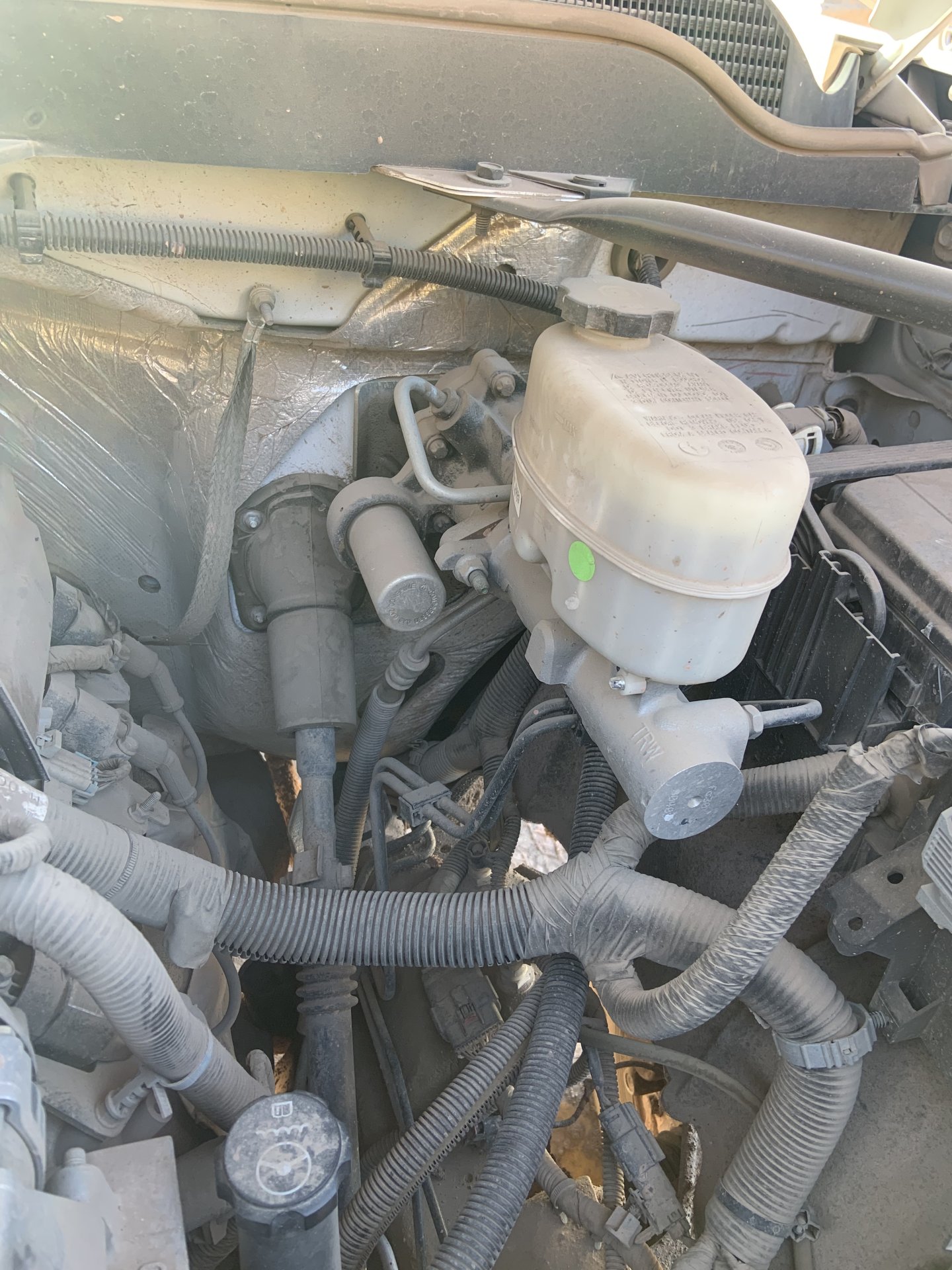

It’s been a couple days since we’ve hashed out on this. One piece of the Hydroboost puzzle that hasn’t seen much coverage is the steering pump.

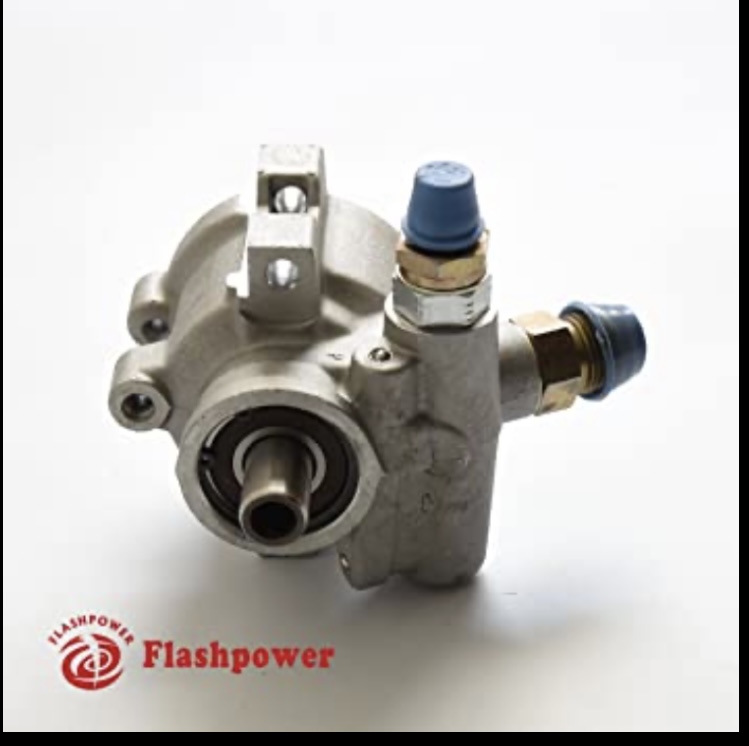

I picked up a complete setup from a salvage yard that included the factory teardrop Saginaw P-style pump with two return ports. As some of you might know, the factory PS pump placement on a “garden variety” LM7 LS engine makes for a tight fit on the frame rail, especially in conjunction with a retrofitted PS box like a 60/80 series or Scout. There’s another style of steering pump and that’s the Saginaw Type II, which is a more compact unit used with a remote reservoir. What I’m not sure about yet is if the mounting bolt patterns are the same.(?)
On the PSC website you can get either for a hydroboost application, but for some reason, they give you a list of choices for pulleys in the Type II (ranging in diameters from 6” down to 4.5”), and no pulley choices for the P-Pump. I can think of a couple advantages of having a smaller than OEM pulley -
a. More clearance between the frame for fitting into an FJ55
b. More pressure at idle with the increased pulley speed (?)
P-style
Type II

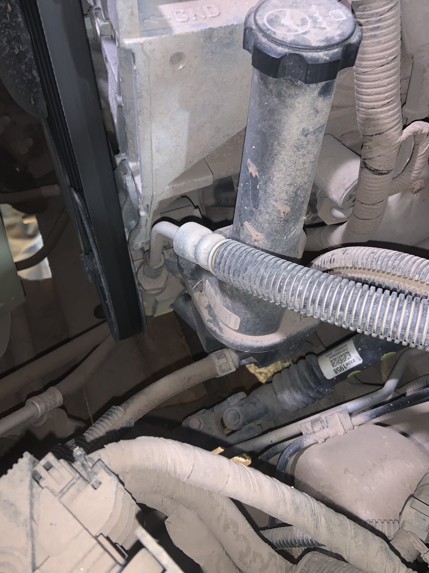

I used the pump and remote reservoir from a Express van.
Not sure why you would want less volume if you are also using hydroboost.
The express van pump was specifically recommended to me by my local steering box guru.
Not sure what makes it superior?
