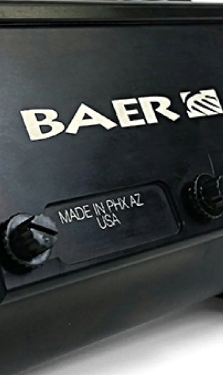

Made in Phoenix, AZ?? Well now I have to!

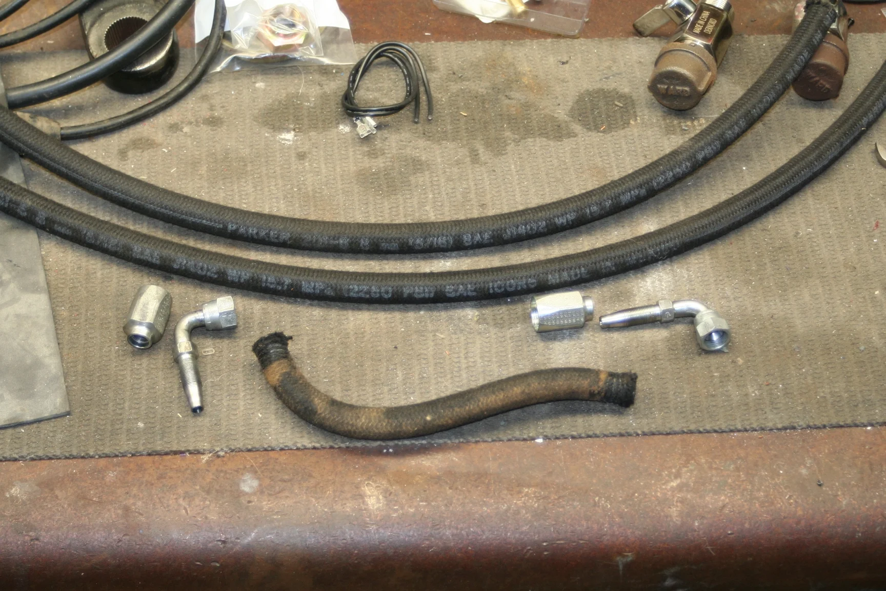

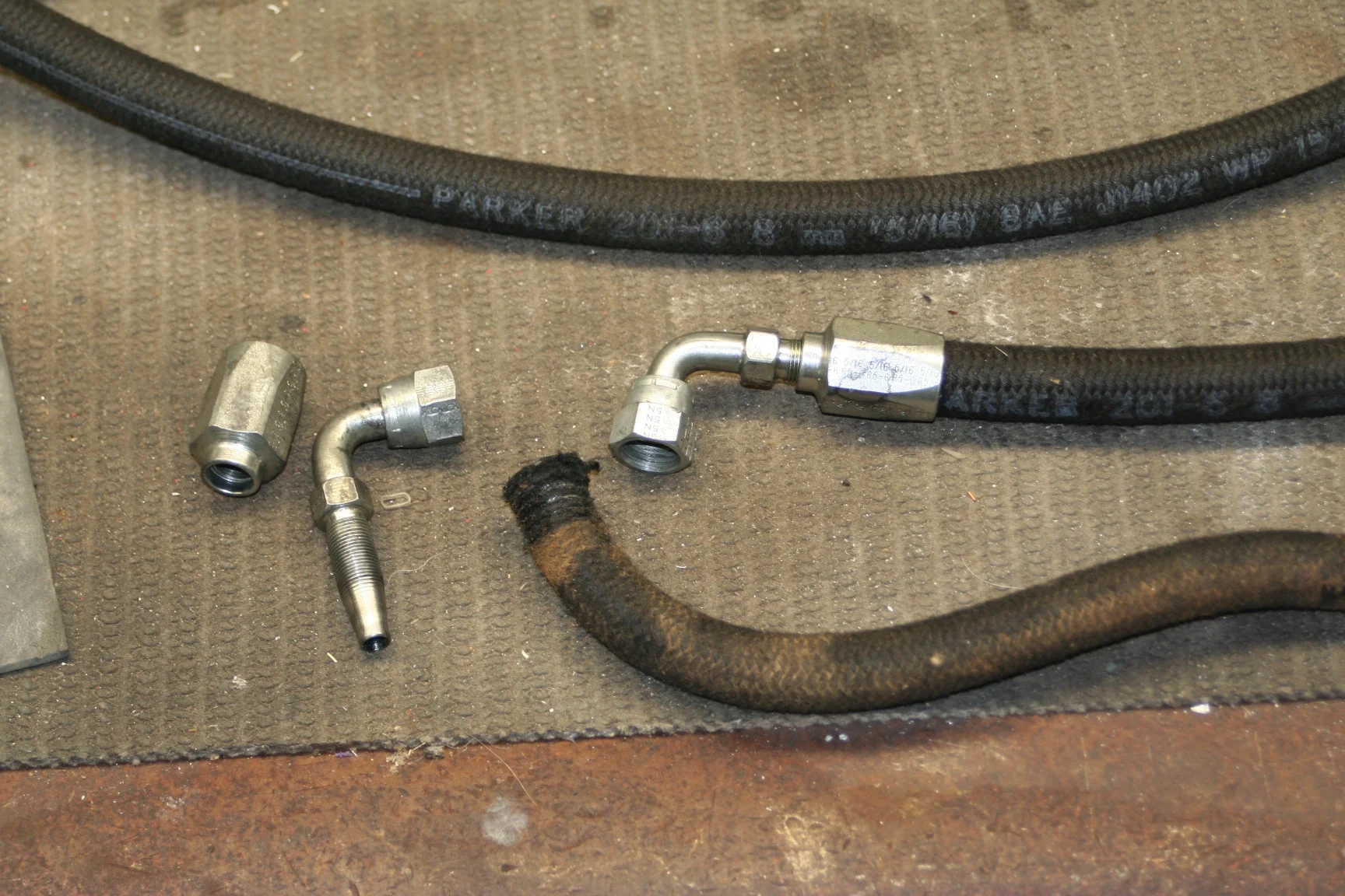

Here's some cool fittings. Thanks again to J Mack and friends I bought into the Parker field repairable fittings, they are great. It's been five years or so since making my first power steering hoses and all I had to do was unscrew them, cut new length hoses and screw together with same fittings. Spendy, $36 bucks a fitting, but can be used over and over. 👍 I've got a few hoses to contend with having a pump, remote reservoir, hydroboost unit, steering box and a cooler. I would hate to run back and forth to Napa to get hoses crimped.

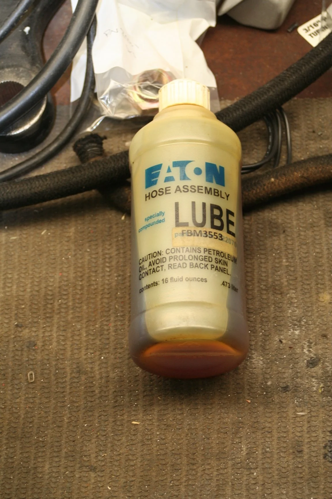

I use this lube, it helps assembly.
