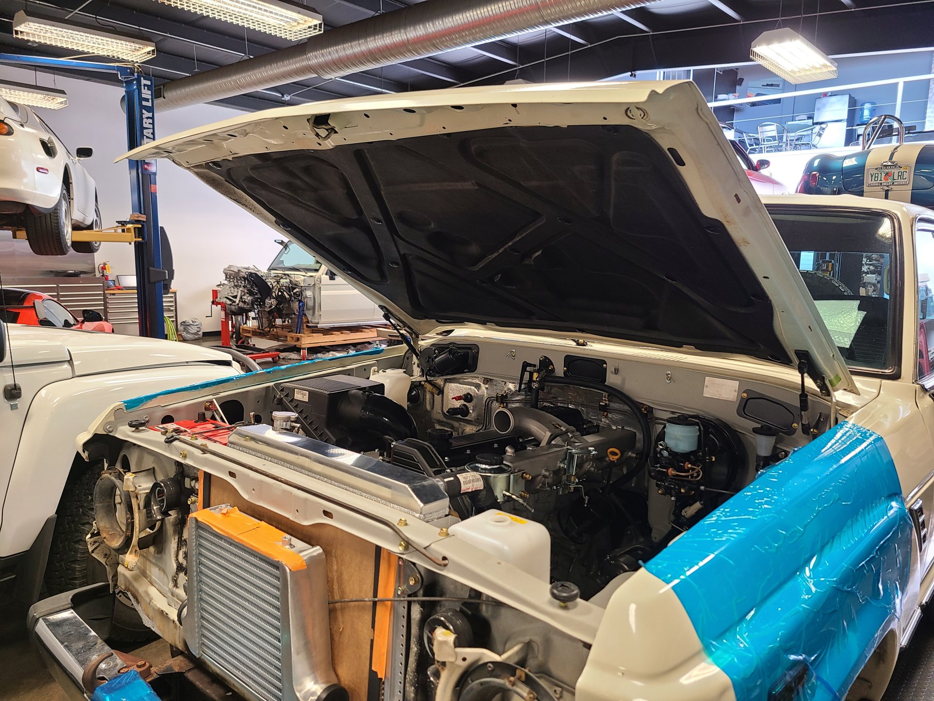

Didn't get nearly enough done today but I was able to get my intake into some couplers and tubing to get it set in place. Looks like it will fit pretty well. We'll make some mounts on Monday so it's secure and we can move on to some other stuff. Kind of a bummer with the sensor port on top of the intake outlet. Not sure what I'll do there. Maybe a nice block off plate. A lot of little stuff came in....silicone couplers for the intercooler and the piping for it. I want to get the radiator installed, get the coolant hoses on, get the shroud installed and then start with intercooler piping.
Put my new hood insulator on....so nice. Glad these are still available. I probably should have painted the underside of the exposed metal on the hood. Could have sprayed some Raptor on it too I suppose. Not sure it bothers me that much. Maybe if the truck gets painted one day I'll make it all pretty.

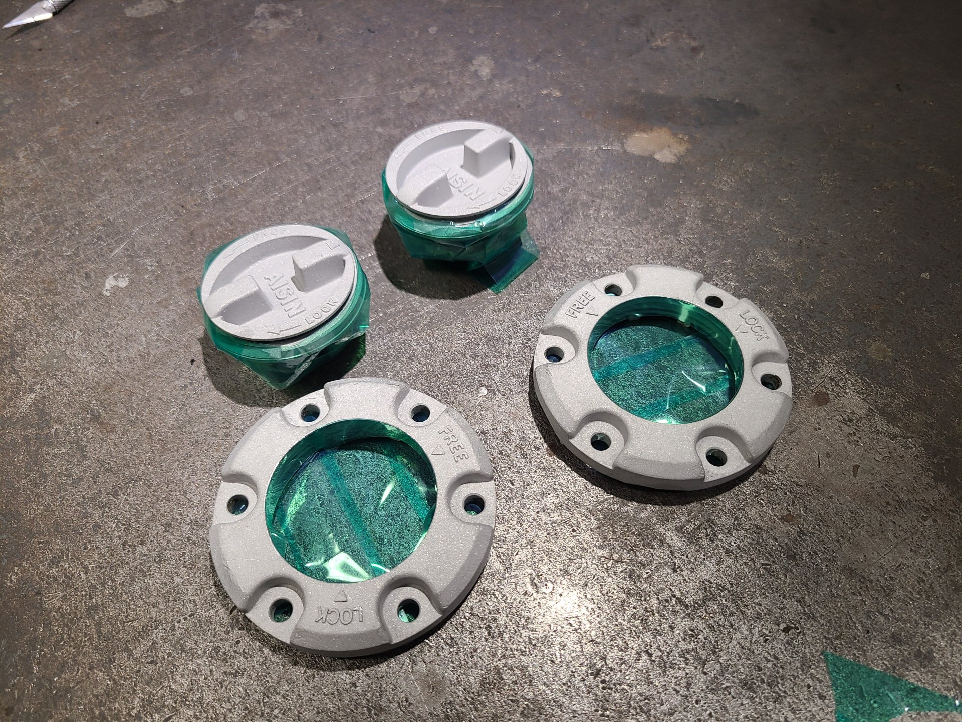

Good day today for the most part....kind of got bogged down with a few things. Started by powder coating this stuff....
Went with gold for the centers and somehow the outers were black chrome. The gold was awful and the black chrome looked dumb. Finished with this which looks really cool. Satin black outer, black chrome center.

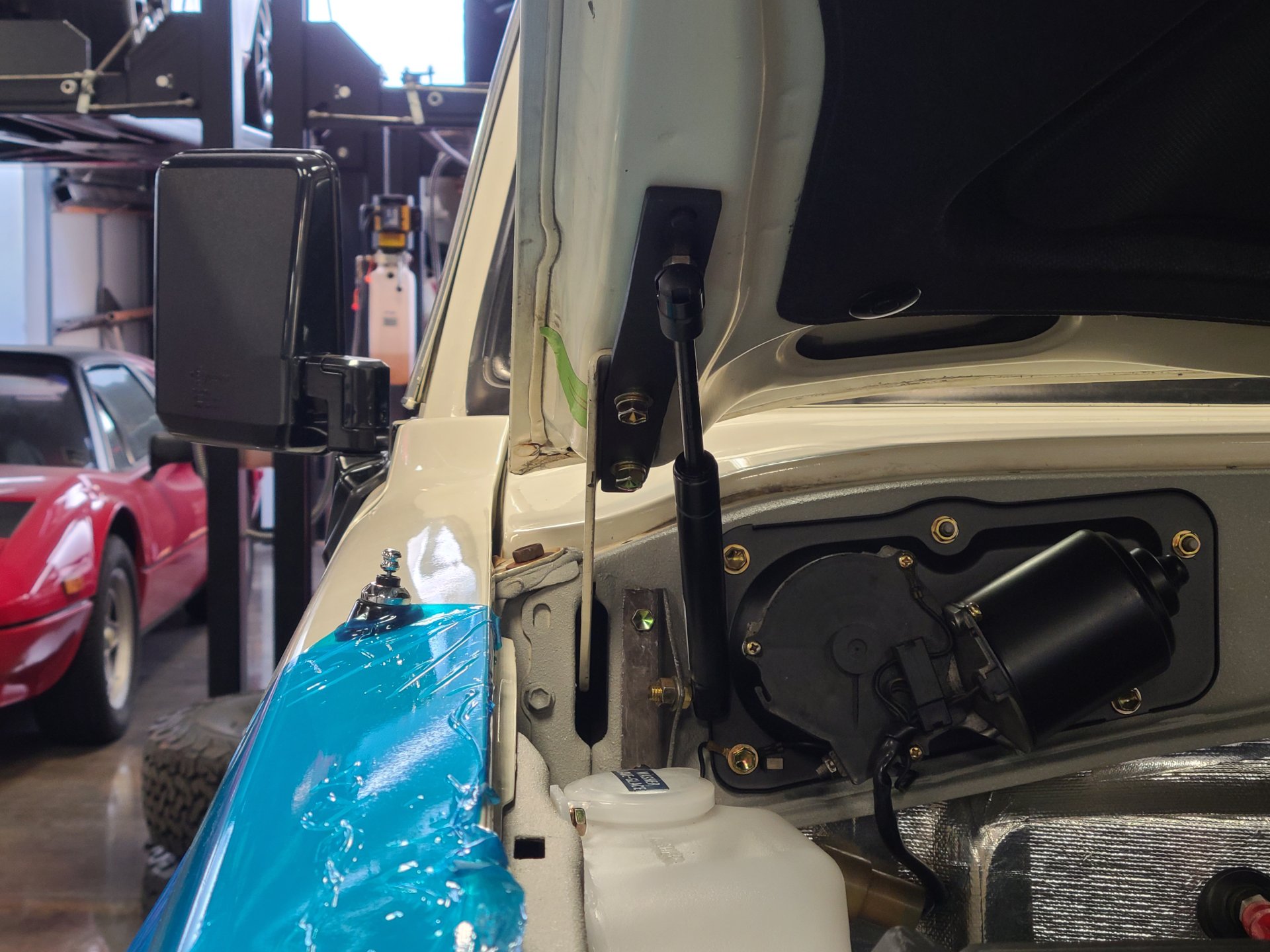

Dialing in my hood strut kit(well, will be a kit at some point).....I'm making some adjustments on where the ball stud is mounted to get max opening without hitting the wipers. Need to adjust the weight of the struts as well....these are 120# and I think they're a bit light for how these are mounted.
No clearance issues, completely bolt on. Should be a nice setup.

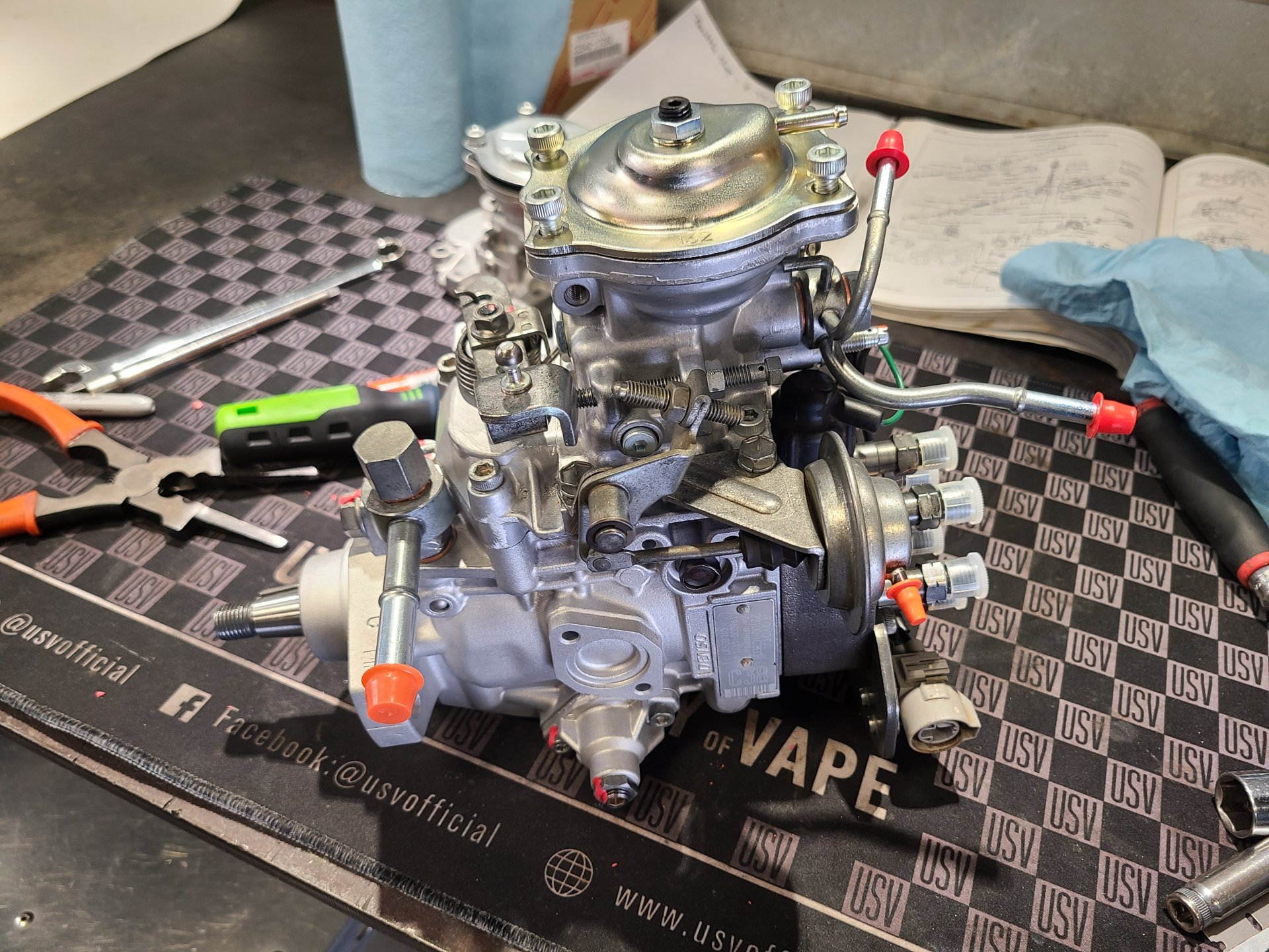

Started the morning off by installing a boost compensator on our injection pump.....pretty straightforward job. These injection pumps are such a cool piece of work.

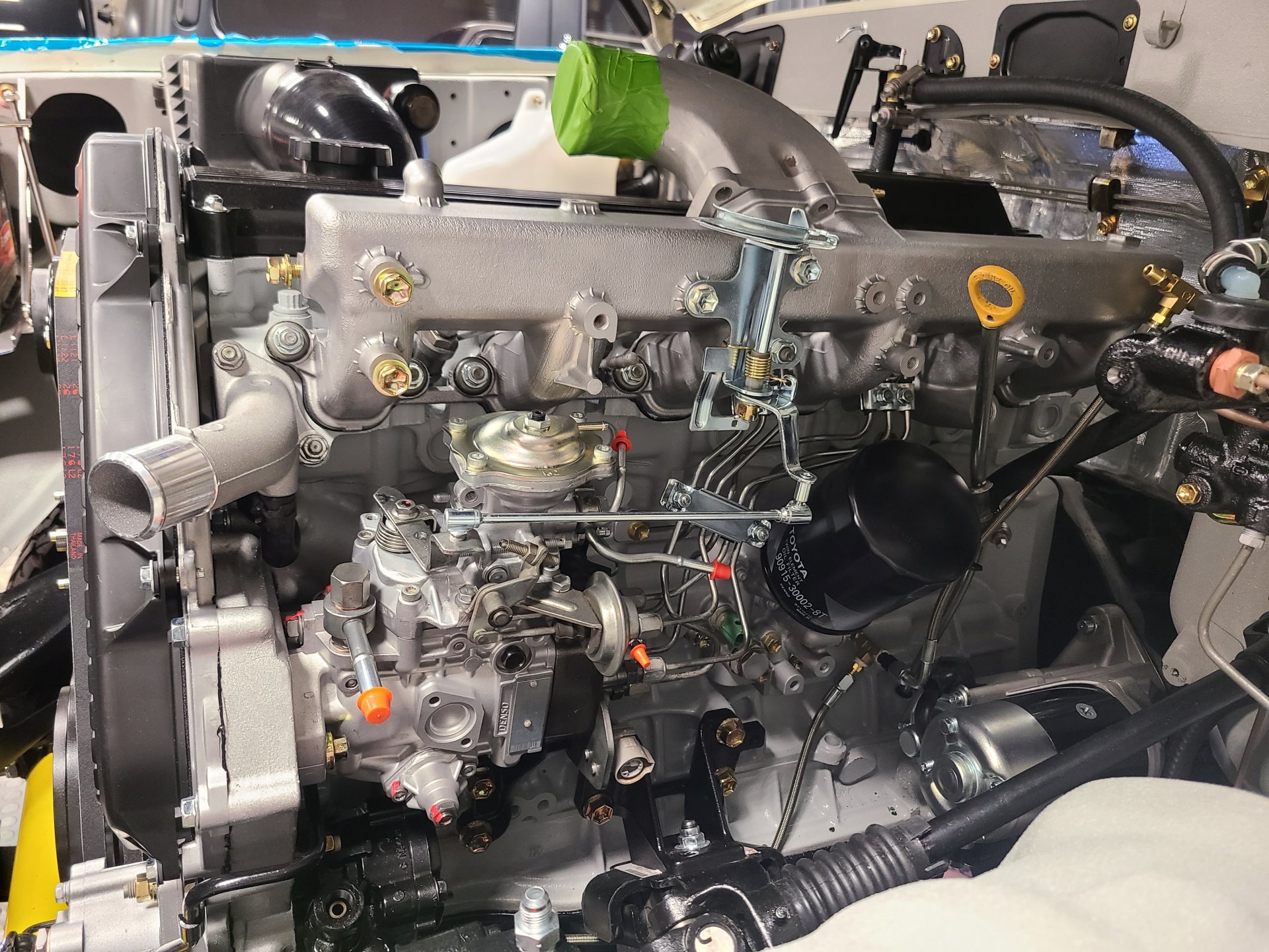

With the boost compensator on the injection pump, we were able to set timing and start the assembly process of the lines and all that good stuff.
All buttoned up.....even the belts are on for the alt and AC.
Started the morning off by installing a boost compensator on our injection pump.....pretty straightforward job. These injection pumps are such a cool piece of work. View attachment 2960152View attachment 2960153
View attachment 2960154View attachment 2960155

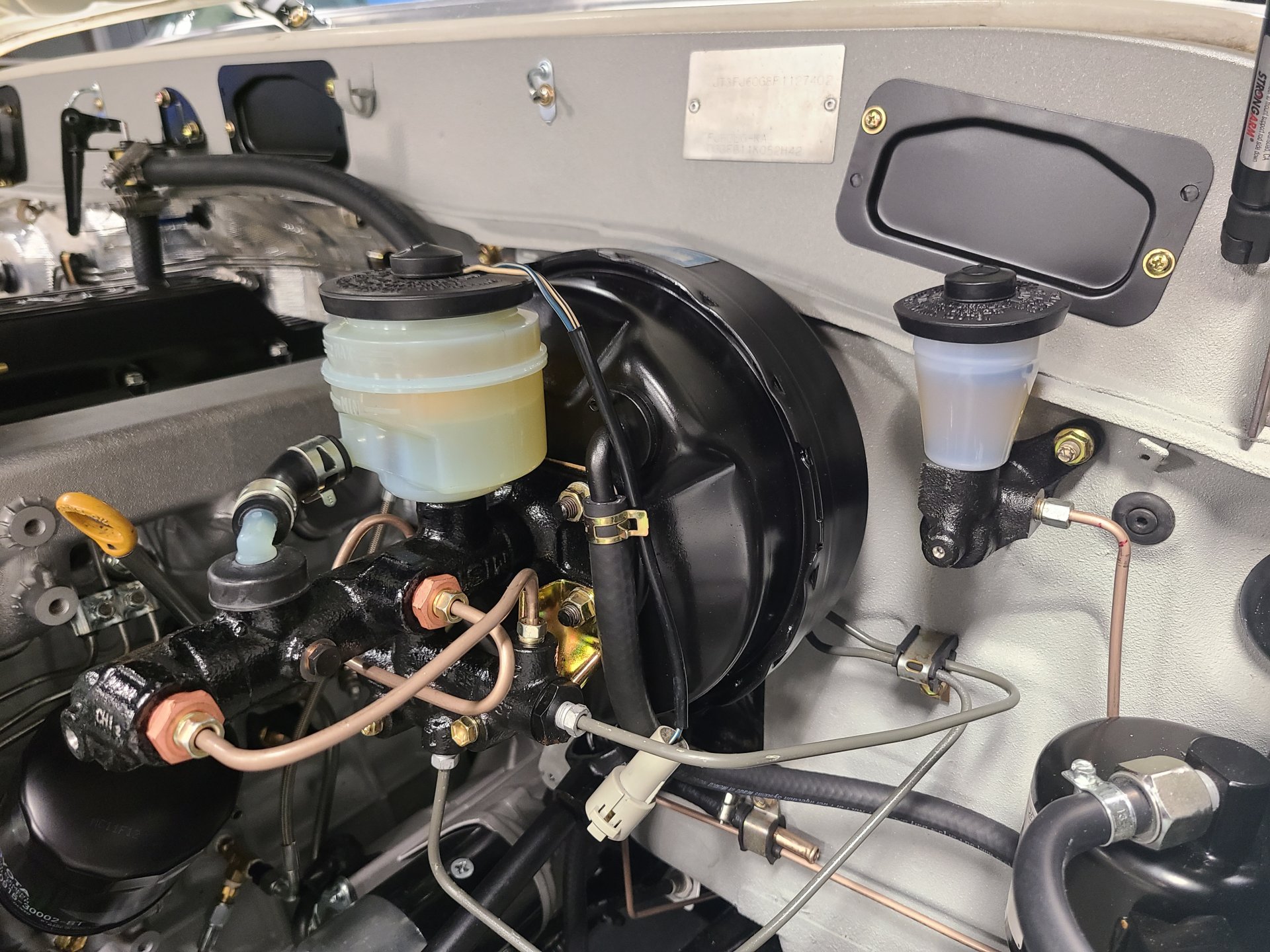

That's fluid in those......we've got brakes and a clutch. Still a ways to go though before we get to use them :(

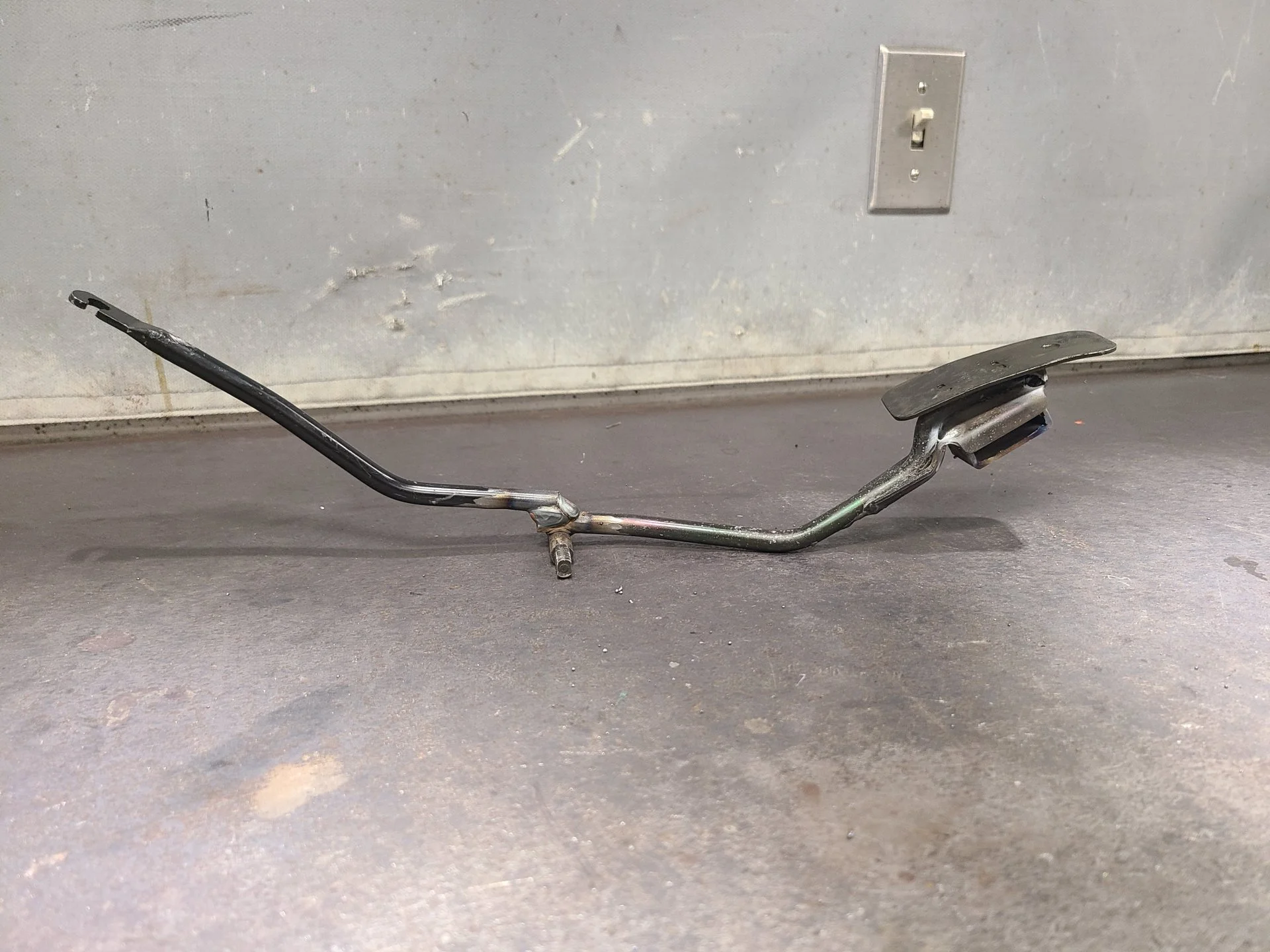

Tomorrow is going to be gas pedal day. Not looking forward to it. Going to use a pedal from a 70 series I think. I have a 62 pedal, a 70 series pedal and probably an 80 pedal. 70 series pedal will take a little work to get in there but I like it.
I cut the 90* end off the 60 pedal to see how things looked....maybe I'll add the upper part on from another pedal. Anyway you slice it up, it will take some work.

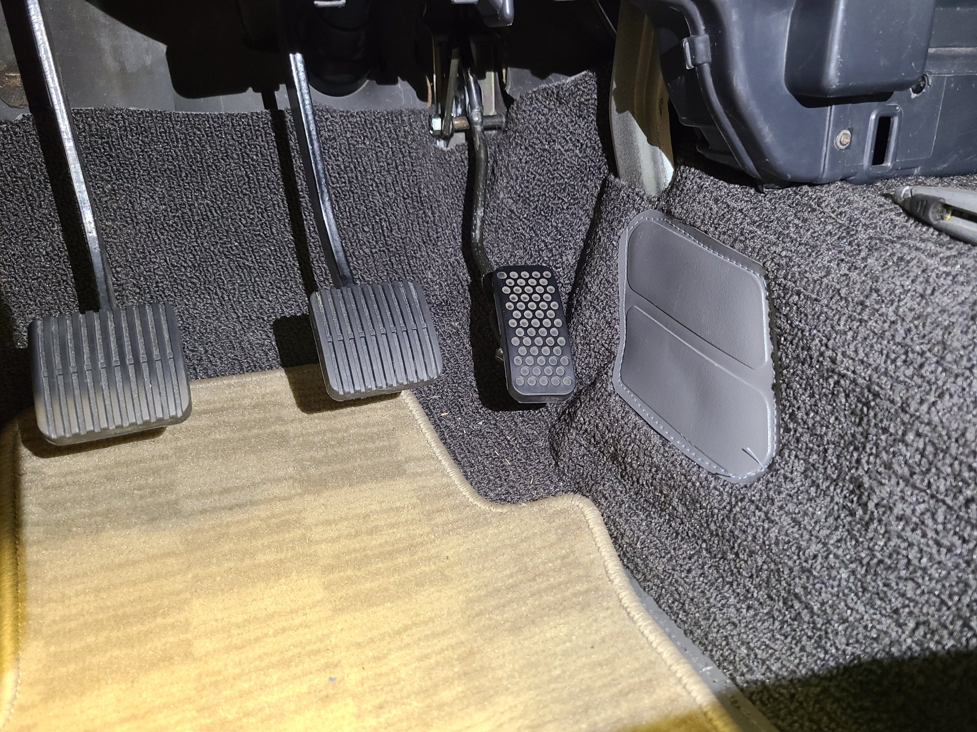

I've built plenty of pedals and I don't look forward to any of it. Sometimes it's an hour, sometimes it's a day. Or more. Been pretty lucky lately with the ones I've done and today this one ended up being pretty straightforward. I used the bottom half of the 60 pedal and combined that with the top of an 80 pedal we had from another project(looks like I stole the hand throttle bracket from it). It's not as pretty as I usually like them to be but it works, it's strong and it will do the job and will look fine once it's black.
Underside of the dash where the throttle goes and the bracket gets placed...
I had to stack the 80 pedal's top half on the 60's base...I would have preferred to butt them together with a sleeve and weld but it wasn't in the cards and I ran out of interest in crawling around under the dash. This will be plenty strong.
I'm sure there is some kind of science or engineering to designing pedals, none of which I know much about, but in order to get the throw of the pedal where I wanted it, I ended up adding this pedal stop on the underside of the pedal pad area....this will contact the pedal stop bolt. Looks like there was about 1/2" of space between the bolt and the bottom of the stock pedal. Pedal height is nice, full travel on the injection pump.....all looks good.
And now we have 3 working pedals.......and no more crawling around under the dash.
