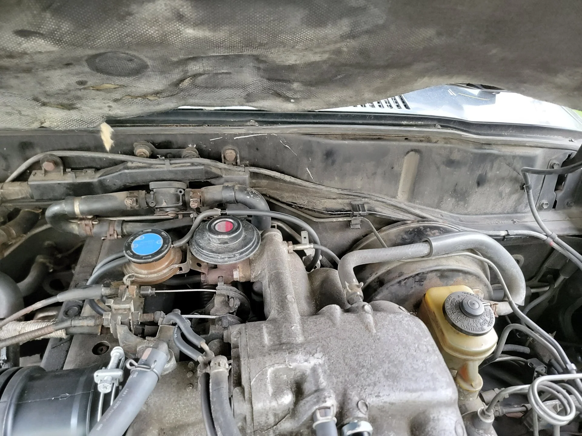

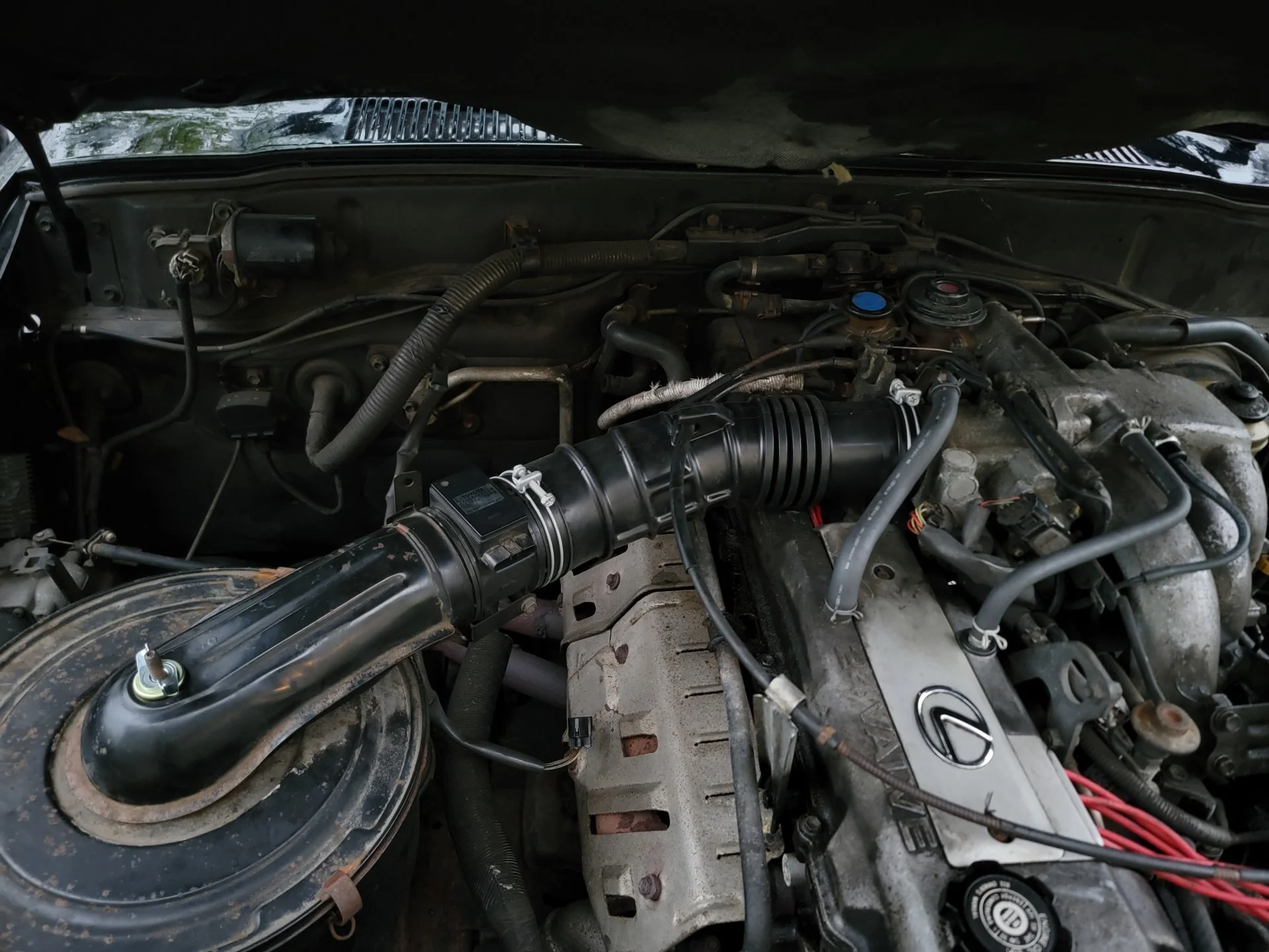

Any ideas on how to clean the engine of gunk in this video?

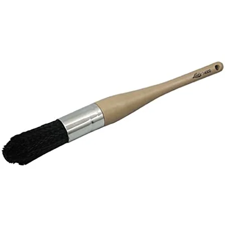

and a parts cleaning brush
For really heavy buildup, I've had decent success with a Harbor Freight steam cleaner. I've put Simple Green or Purple Power (gross) in with the water for nasty areas.
I've pressure washed my engine compartment many times. Only with a WIDE FAN setting, though, and I use an electric pressure washer which is nowhere near as powerful as the gas ones. I actually prefer the pressure washer since it's a smaller volume of water than a straight hose, and the wide fan allows you to really direct where the runoff goes. Just avoid the distributor cap and you will probably be fine. Obviously, wait until you have the new intake tube, so that you don't flood your intake with water.

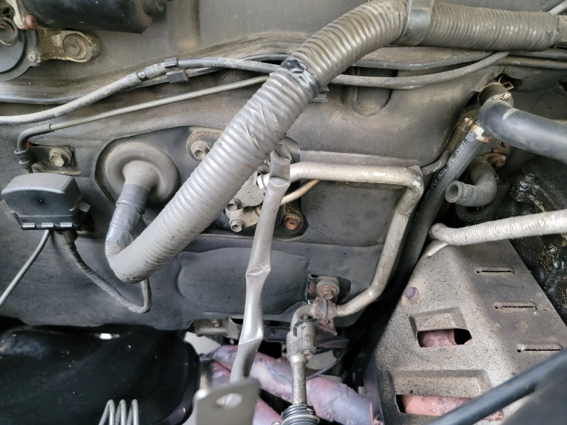

I just got my undercarriage sprayed with layers of woolwax. The guys took the time to give a courtesy inspection of the engine bay and drivetrain and for the most part everything is all right. The only things I have to add to my list are to replace the rear shocks because they're rusted off and the boot is already gone. There is a hose along the firewall that's not even connected to anything. The frame is still in good condition; no holes anywhere. Still solid frame. 🥲
I'll take pictures when it gets dry outside. It's been raining this weekend.

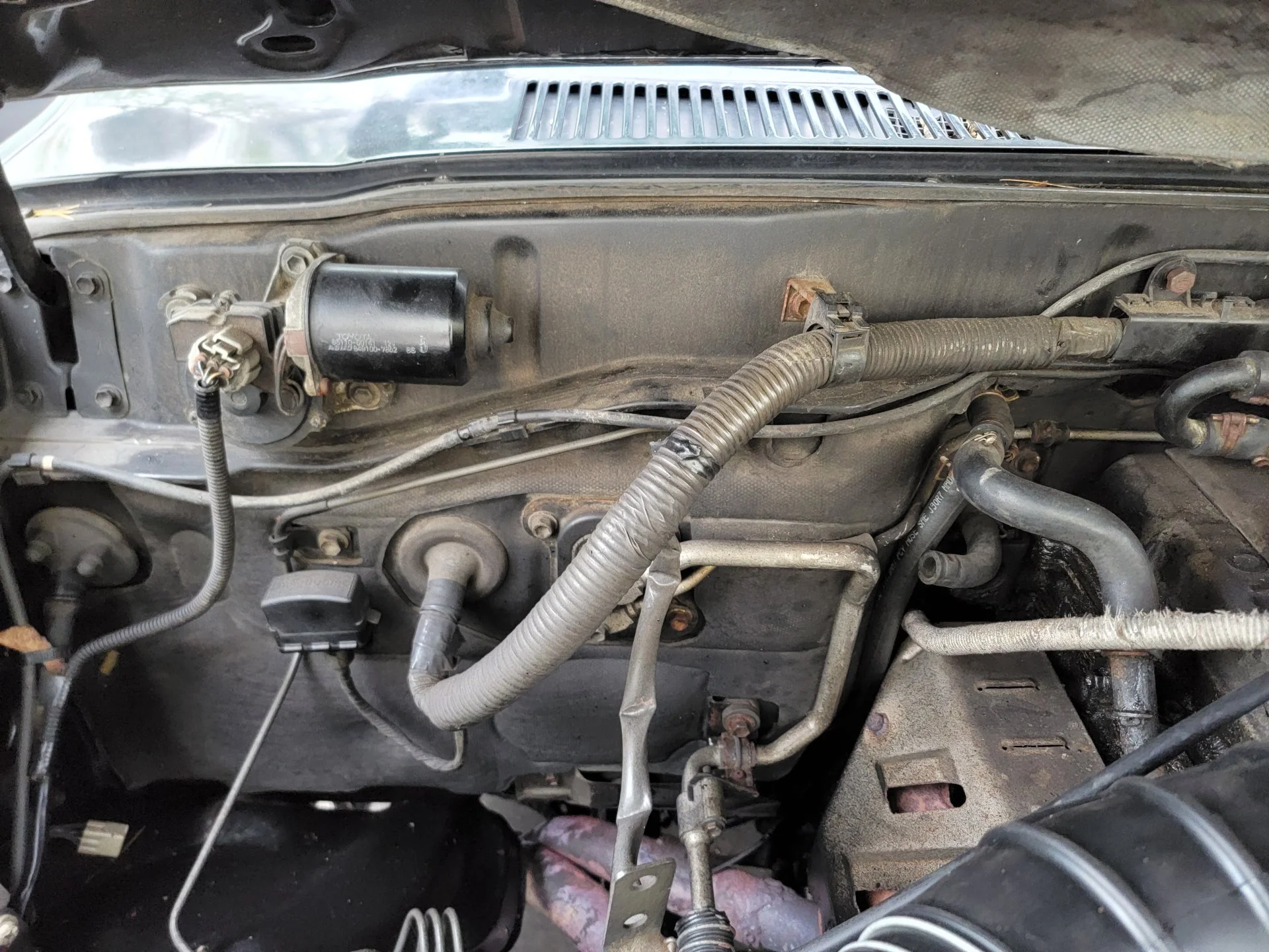

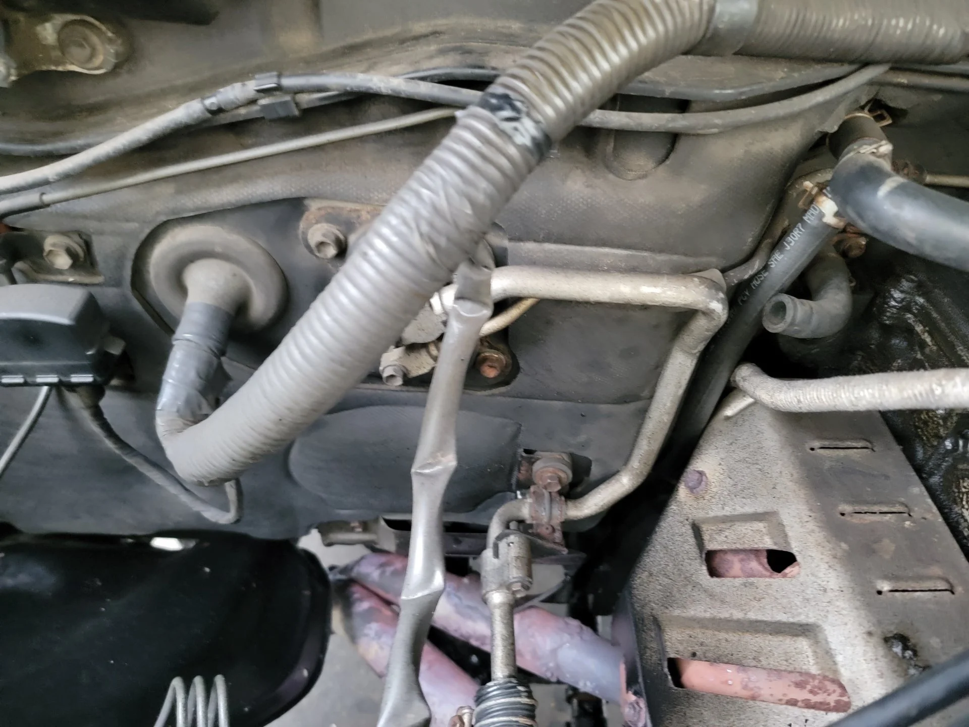

So the mechanic pointed out to me this hose and we noticed that there's a hose that isn't connected anywhere. The AC still works so what is this supposed to connect to? I have the FSM flipped to air conditioner section. I don't see this line here.

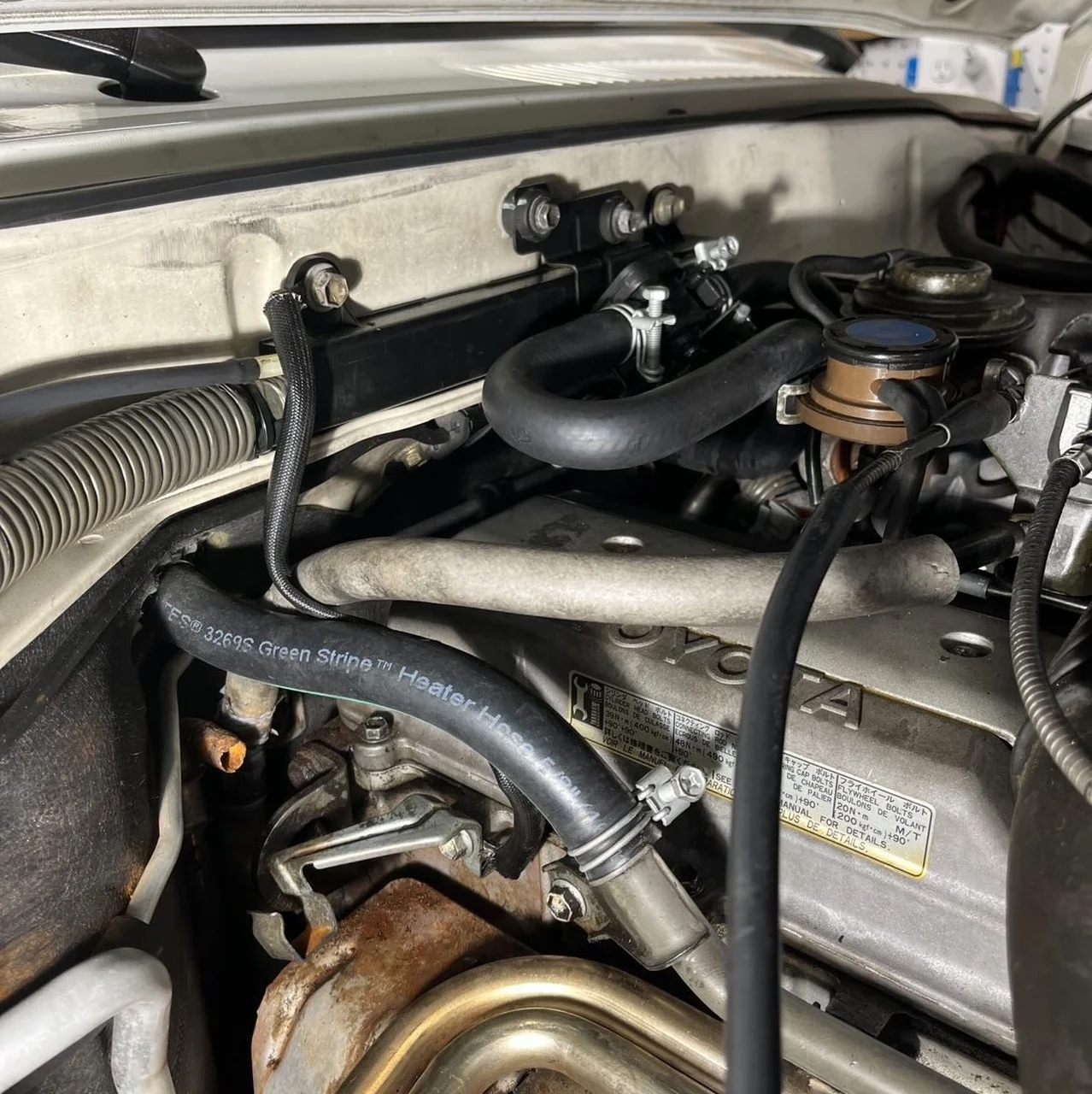

This is a pic from @NLXTACY's site of a rear heater delete.
hmm I guess it does look like a delete on mine given yours also has that port opening. The U hose on mine looks different though so maybe it's not a complete deletion?

When you delete the rear heater, you could either leave that port open, or plug it (I plugged mine). On yours is just an open right angle hose. Above that hose, you have another hose (off what looks like a "t") that I don't know where its going?
For the "U hose" your referring too is is just a simpler application. It does the same thing you already have just with one piece.

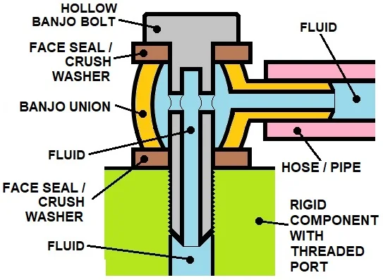

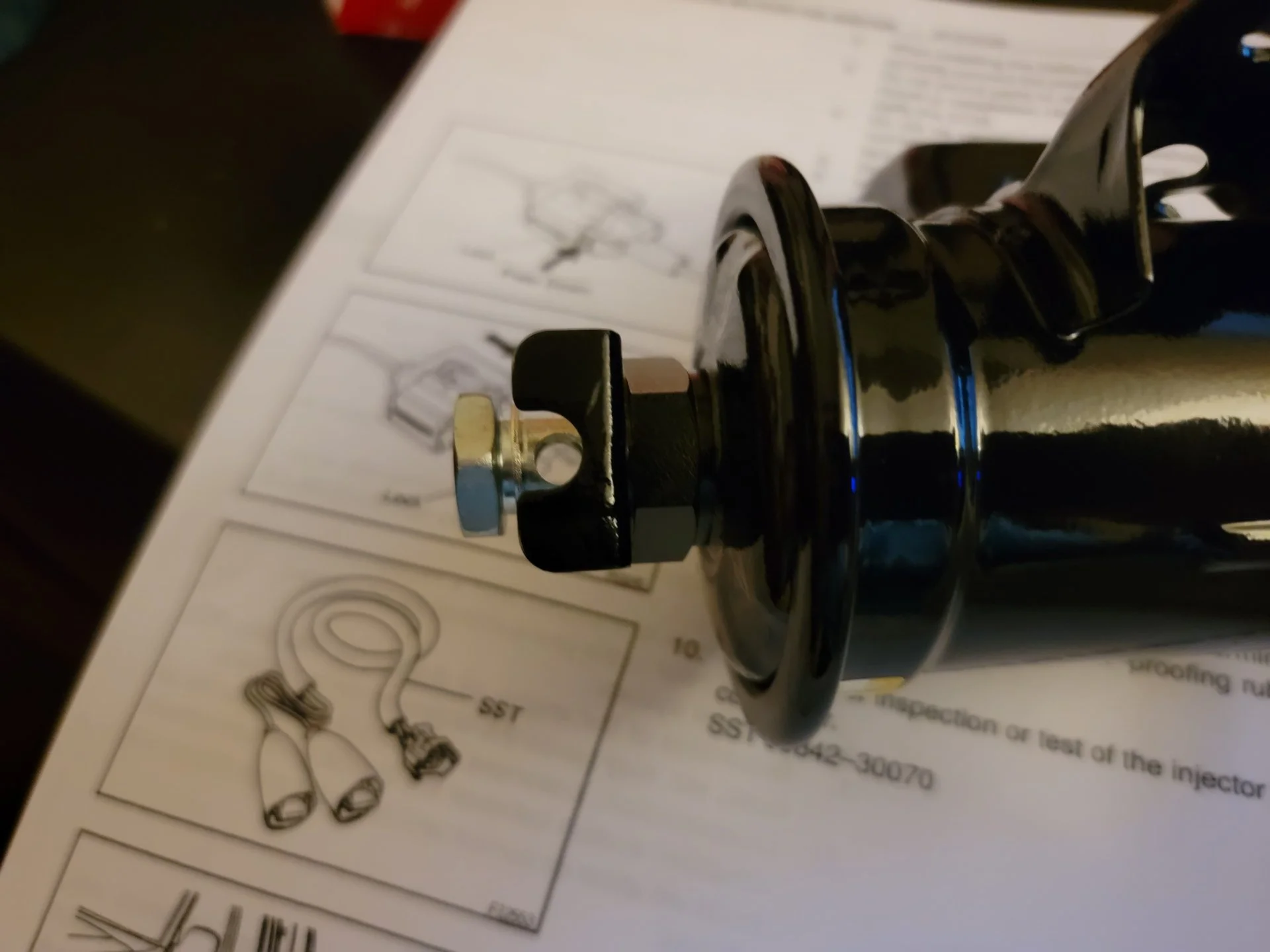

is there a difference between the two union bolts that screw into the fuel filter? the dealer sent me two of the same. One of them screws tightly at the spot where the hole aligns with the fuel line but the other one doesn't. I would expect that even if I torque one side to spec, the line would be obstructed?
