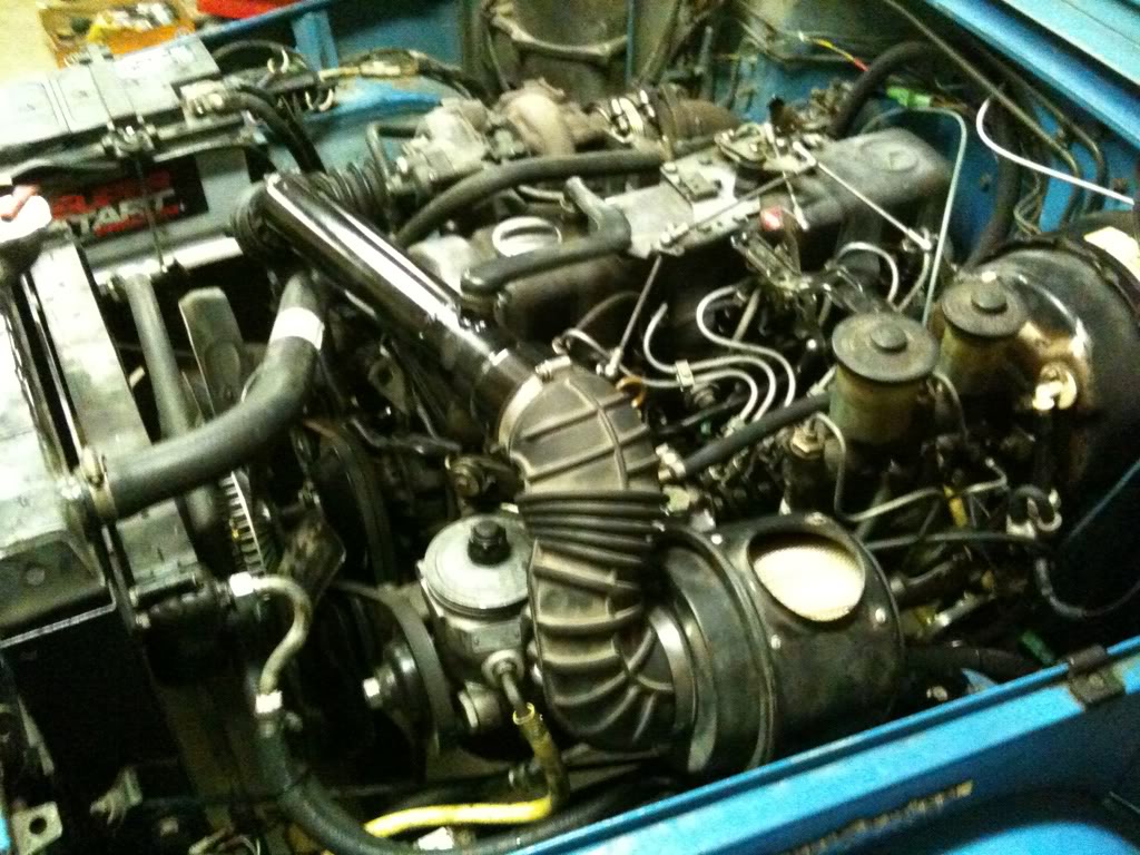

Ended up going to upull it today for this housing and built the tube this evening. The filter that I ordered from filter systems turned out to be to long to fit, and I am trying to avoid the generic cone filter. This should work with a snorkel if I come across one some day
