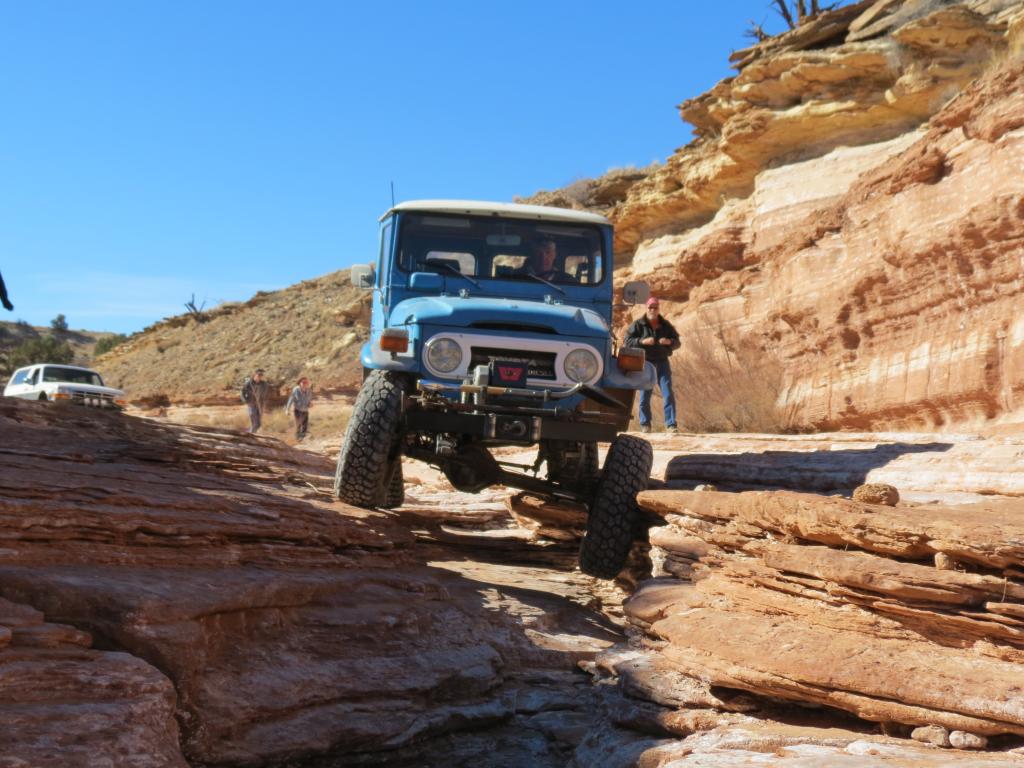

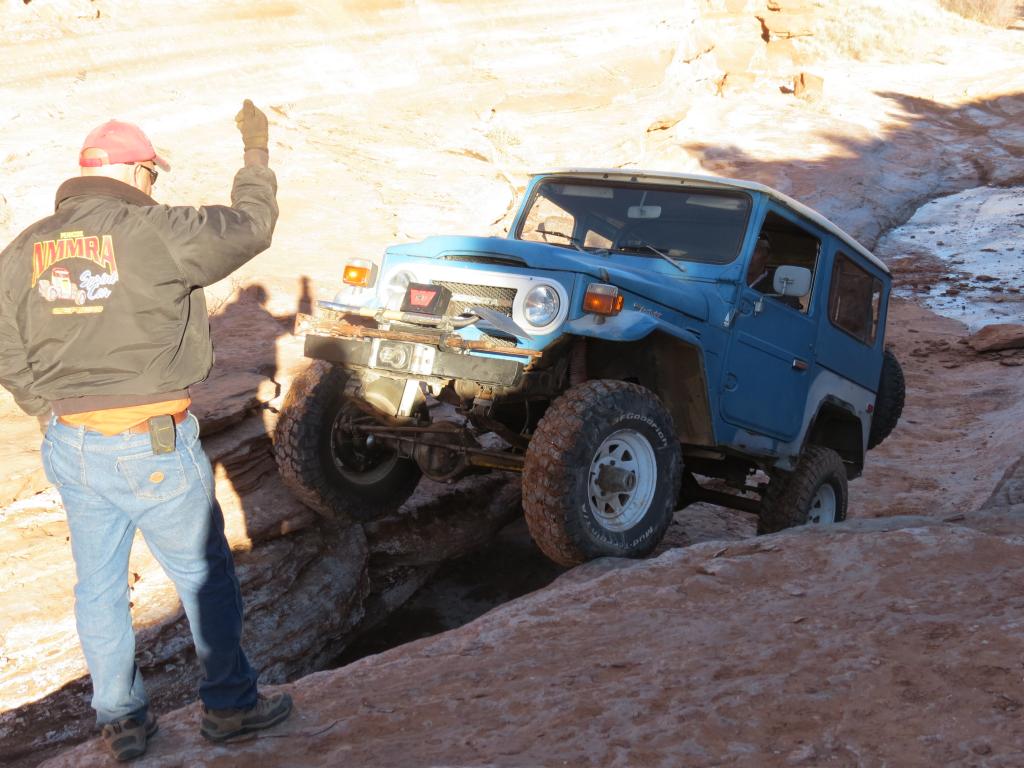

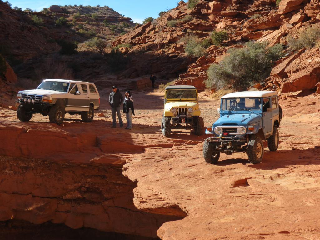

My FJ40 on the Jaws of Death
sweet! when did you get out there?
Yesterday.
It sure isn't an easy trail to get to. I spent weeks researching everything I could find on it, GPS'd every turn using Google Earth and every bit of information I could find and it still took us 3 hours to get to the corral and about 1/2 hour to the canyon.
Sceep's postings from back in 2005 with you and your 40 were great. We didn't have enough daylight to try the extreme part of the trail after that 20' waterfall but I want to go back in the spring or fall and try it again.
was the gate off hwy 6 open or gone? that's what usually keeps us from running it. or did you find a way around it?
