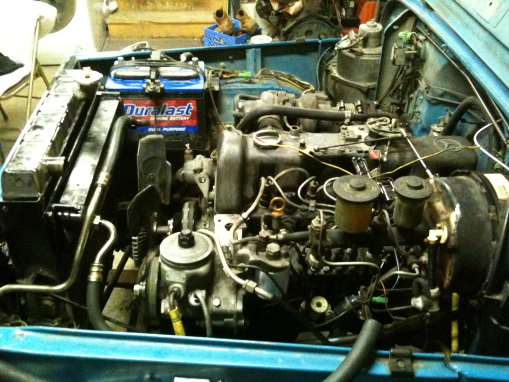

Let me call this "my official build thread OM617 mercedes"
It's getting kinda crowded in the engine compartment
Well other than the lift to clear the oil pan during articulation and the adapters to fit the tranny, its all basic engine swap stuff. Working on the wiring now, should be able to start it up in a couple of days if all goes well.
In that last shot , you have the power steering reservoir there, are you going to use it as well?
