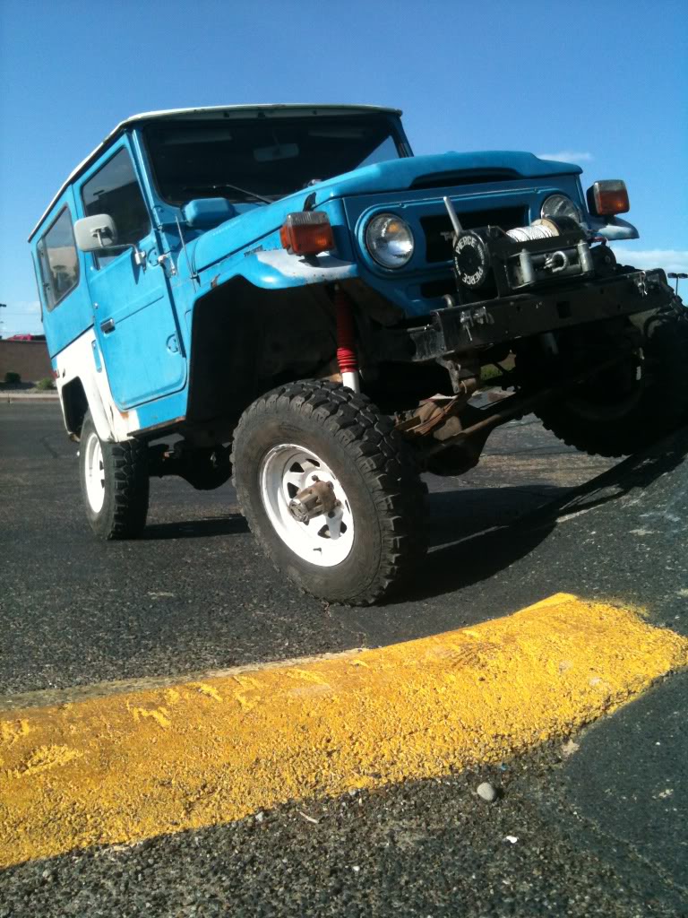

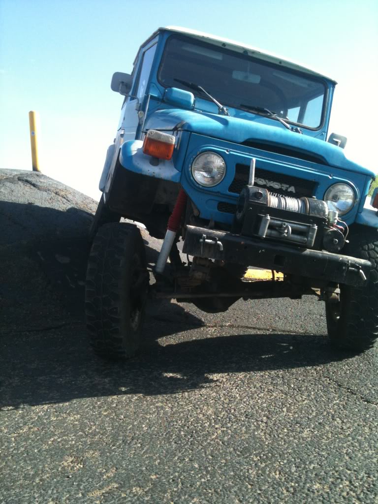

These pictures have nothing to do with how this diesel runs.
I was just checking to see if anything was going to fall off.
well... did it? :p :flipoff2:
