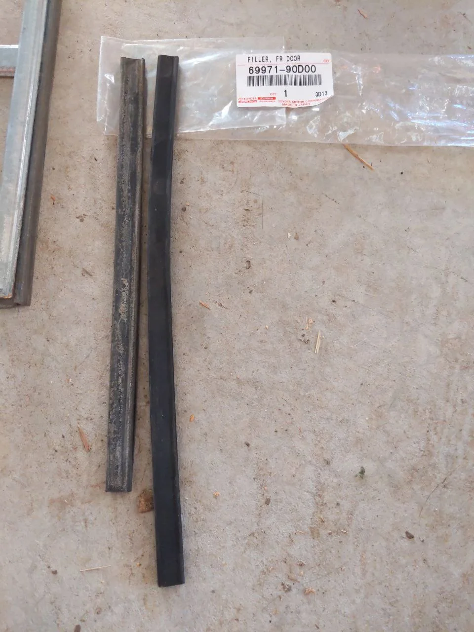

I appreciate the info on this. I ordered them, but they don't match up exactly. The channels seem fine, but 69971-90D00 is a couple inches larger. Not sure if that's a problem, if I should trim it, or if there's a couple variations in the track holder. It seems like a wider track holder might be an improvement.

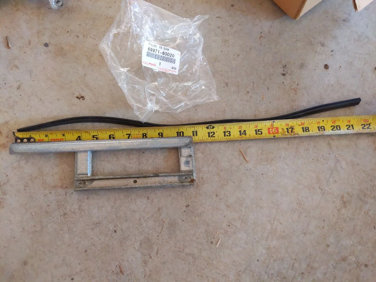

This one should be for the front. Way too big, but not the right application.

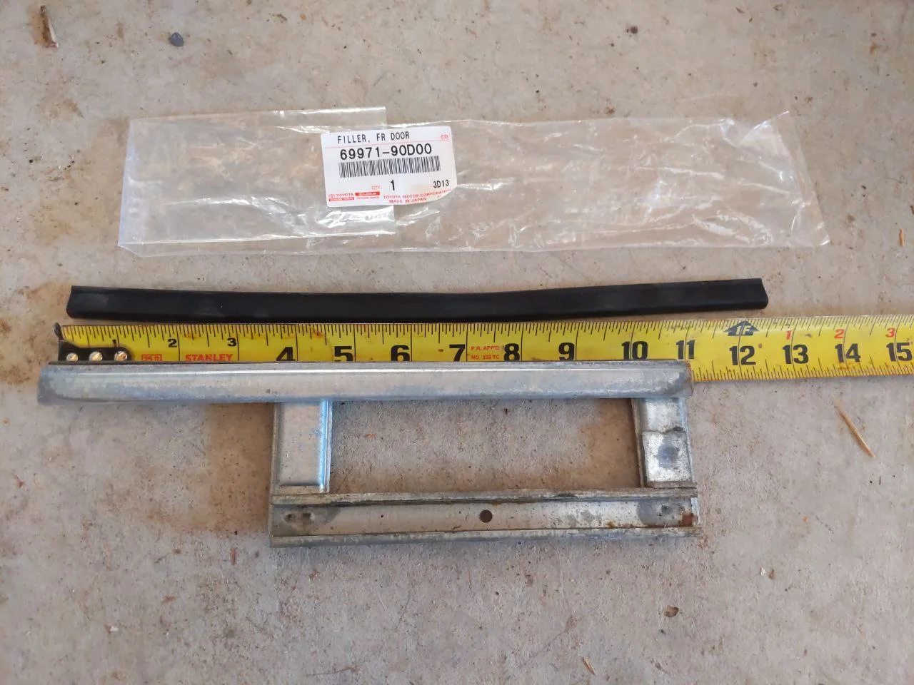

69971-90D00 for the rear window, compared to the window holder I've got.

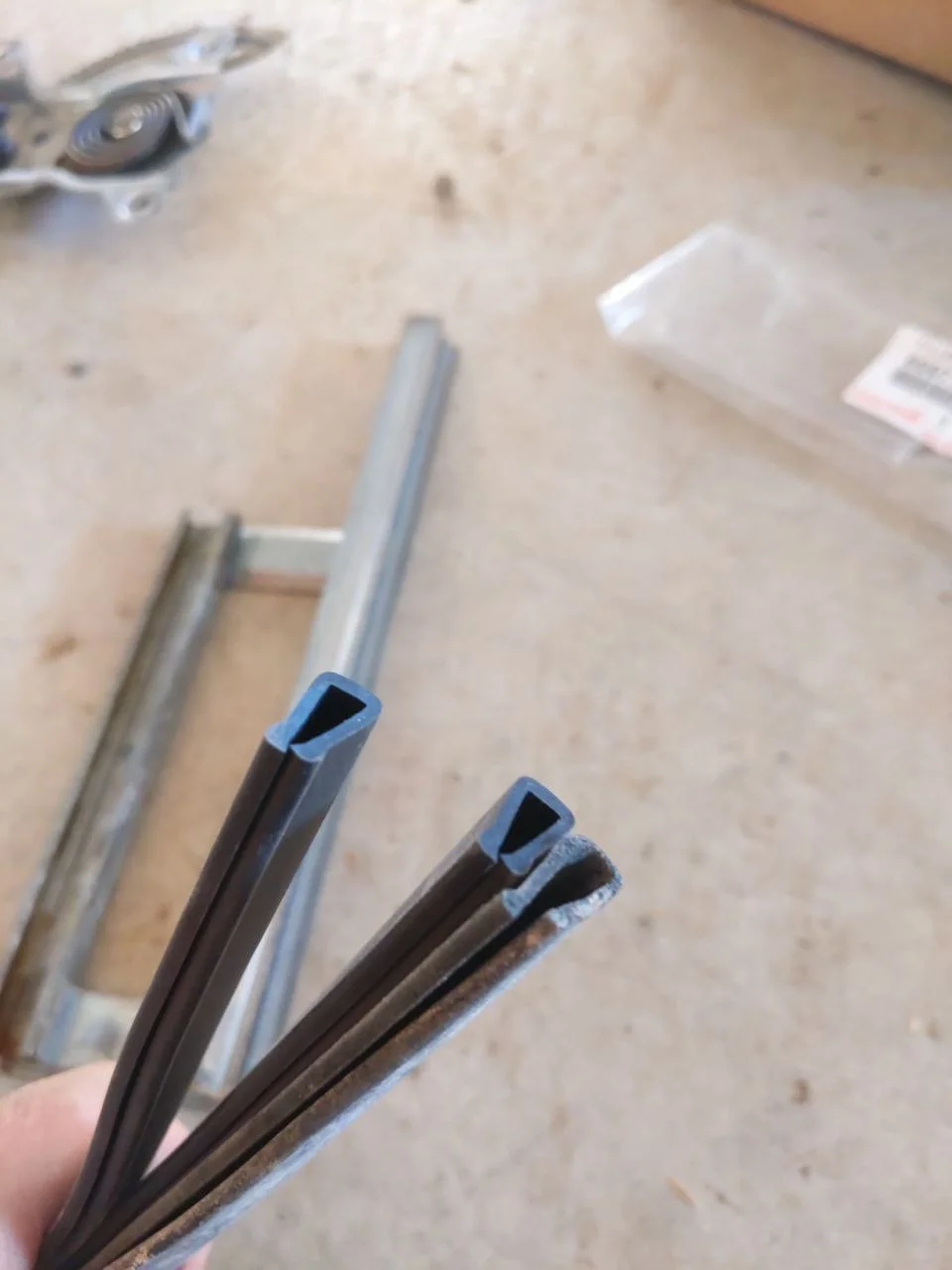

Thickness/shapes of all three (new front, new rear, and original) look to be the same.
Length comparison of 69971-90D00 and the original.

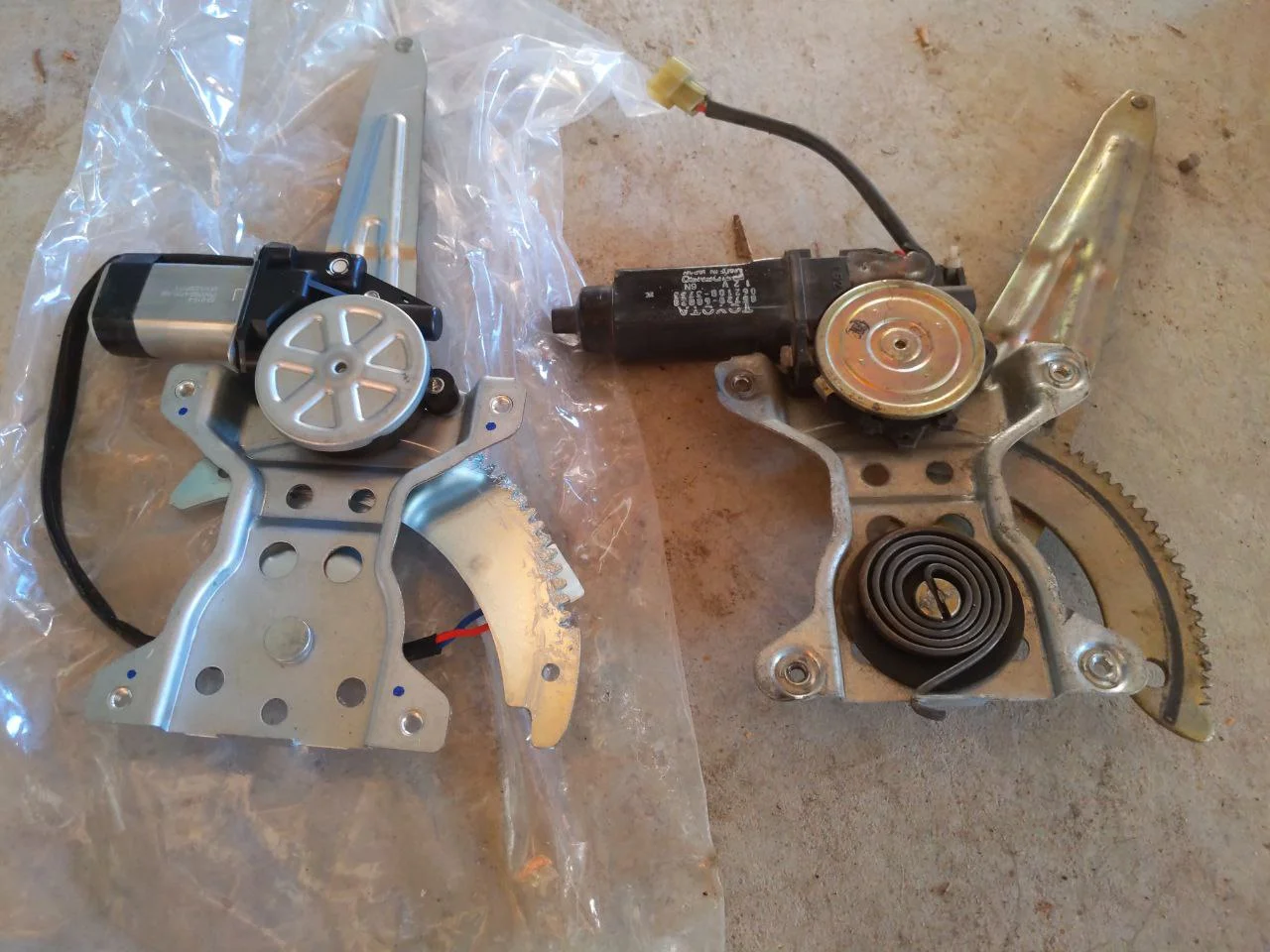

Finally, a bonus comparison of the Dorman and OEM regulator. Interestingly, there's a beefy spring on OEM, but not on Dorman. Does anyone have any opinions on that?
Anyway, should I take a 69971-90D00 and trim it to size? Or should I let it overhang? Is it possible my window holder is not OEM, or that they changed throughout the years?

It's a piece of rubber. Cut it to size.
Its job is to hold the window to the regulator track.

I put the rubber on, then the steel holder piece. It seemed easiest to me that way. I do think the rubber "shrinks" a little bit as you install it, so a little overhang might not be a problem. I don't know what it would catch on, either.
