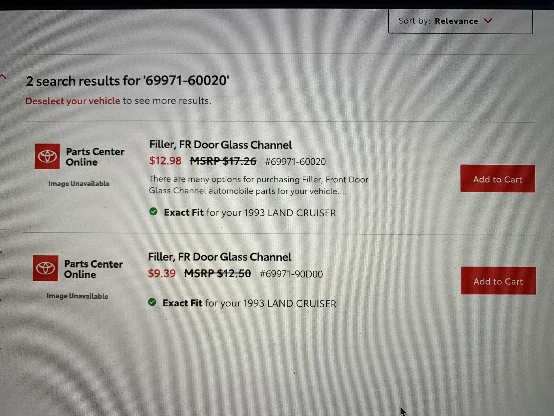

69971-90D00

I gave you the Toyota part number.I tried to find one of those and could not find it. Where do you suggest finding one of those.
It's even in stock at the first place the came up...I gave you the Toyota part number.

Toyota acknowledged they listed the part wrong in their catalog. The part # I ordered should have said for rear windows instead of front windows.Appears you got the wrong part
69971-60010 was the original number, it's been superceded
to 69971-60020.
One way to find part numbers is to go to Partsouq.com, enter your VIN, then search for the Group or Category where the part is found, or do a general search using the name of the part:
ToyotaPartsDeal also is fairly easy to find part numbers:
69971-60010 Genuine Toyota Filler Front Door Glass Channel
