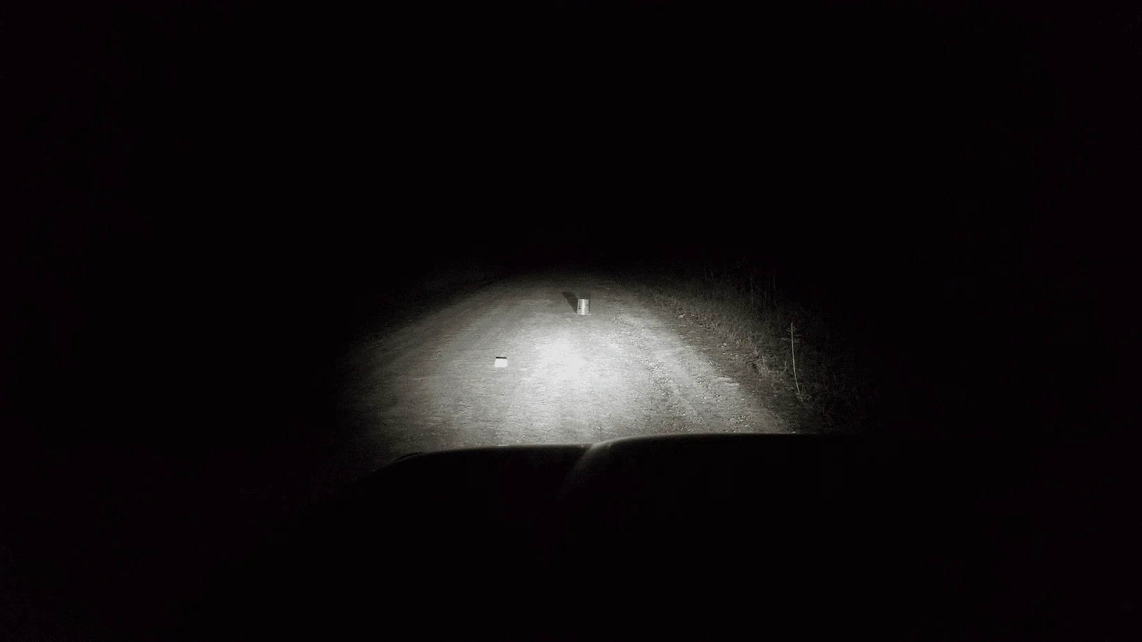

Anyways, shake down ride tonight for the lights, suspension, and brakes. The LED lights on road are phenomenal. They do a great job of lighting the area right in front the truck without blinding oncoming drivers. The light is crisp, clean, and very bright. The lights were fully adjusted down and then adjusted up slightly for my safety seeing distance down the road. Some additional adjustment up needs to be done to get more distance without offending oncoming drivers. Both the color and throw of the LED's is far better than OEM. I replaced my OEM housings due to broken tabs and performance at night in the rain and the DEPO led combination easily beats expectations.
There are some drawbacks. The LEDs may be too bright. Again the hotspot is right in front of the truck and VERY bright to the point of begin blinding for the driver. In addition, there isn't much side spill like the OEM lights. This becomes very noticeable offroad and I had a little bit of tunnel vision and needed to enable my wide angle lightbar. I am hoping that adjusting both lights away from each other will help with the spread.
I've got some ideas for limiting spill after the beams hotspots have been moved further up. Testing should start soon. I'm also considering upgrading the corner lights to brighter amber LED's for more light.

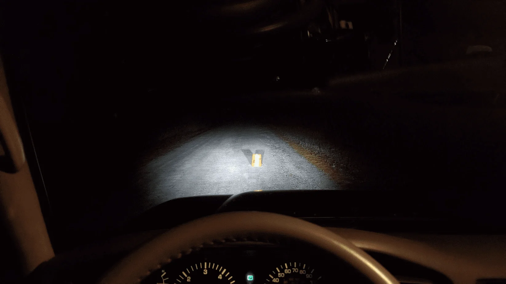

Captured on a Samsung Note8. The Note8 did a good job of capturing what I was seeing otherwise I wouldn't have posted the images.

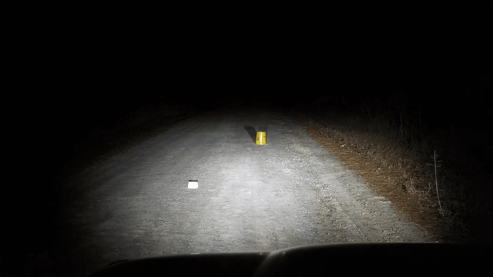

Paper at 31 feet, bucket at 62 feet. In all honesty, there is some spill above the hotspot not captured in the image. It isn't much but it's there for sure.
Bucket at 31 feet. In the previous photo I found the paper on the side of the road and backed the truck up to an additional 31 feet.

I don't know about compliance but my low beams do need to be adjusted out further. The OEM low beams certainly didn't throw 160 feet. With the Depos and LED's, the cutoff isn't very defined and there is some light spill that could possibly interfere with oncoming drivers.
I will try to get some more pictures with the lights adjusted and some more buckets. I need my wife to come with me next time since the Cruiser is sitting in the road when I'm setting all this up.

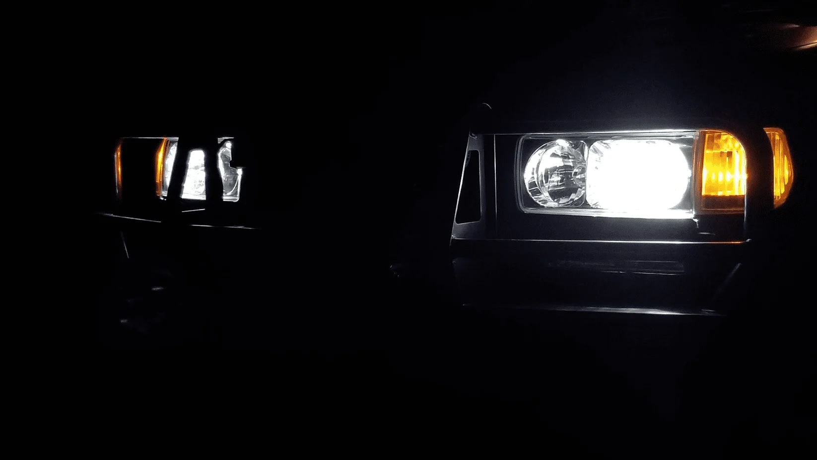

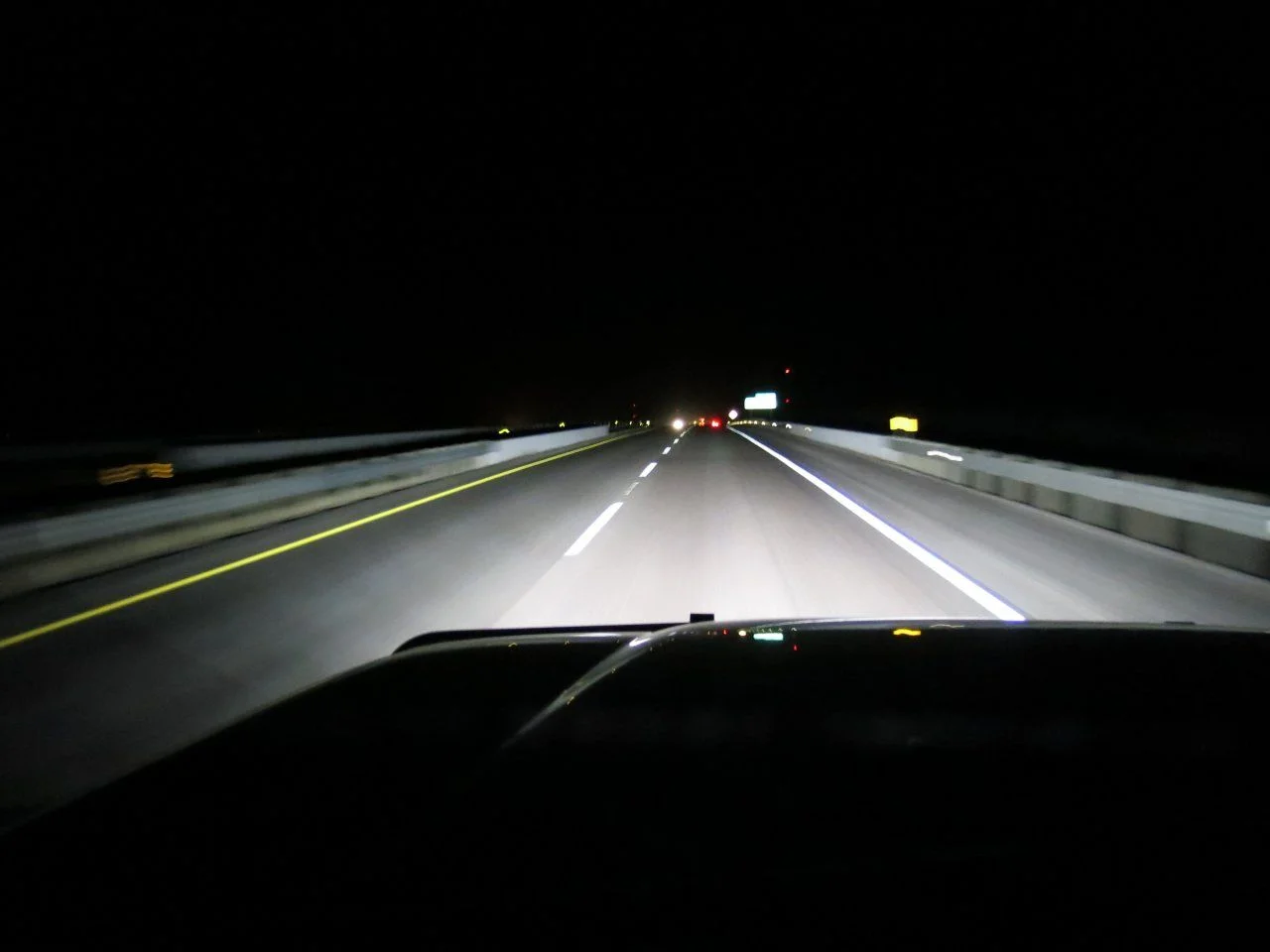

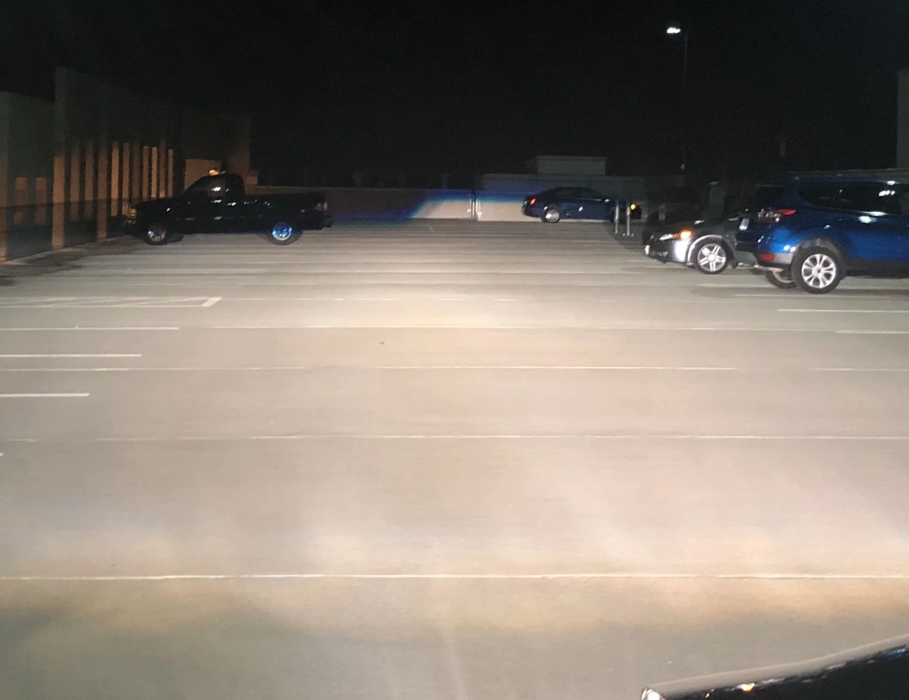

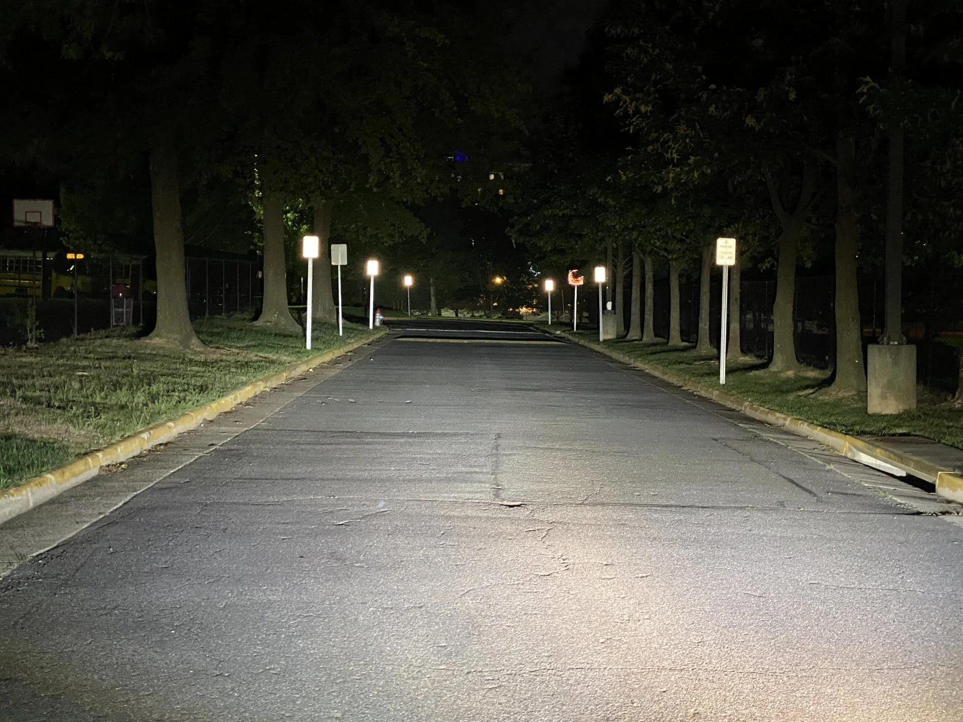

Running LED’s in a headlights designed to run halogens is not compliant either is retrofitting HIDs.. and I do understand the price difference $39.00 VS $300-$400 but based on your output shots you are getting $39.00 of output. If there was a deer in the road at 50 feet I doubt you’d see it. I rate the ability to see at night and not blinding on coming traffic extremely important. Here are a few output shots
The first shot is the GTR LED’s running them in OEM projectors of my 2011 Prius so the have a cutoff
Second is HID Mini H1 and D2S
I have an 80 that I’ve dumped a ton of money into.. and I installed the SLEE harness tried a ton of bulbs and finally I paid a mud member to retrofit a set of DEPO’s .. and the result are the first HID picture. All the pictures are low beam output. Spend the money ... you’ll never regret it.

Running LED’s in a headlights designed to run halogens is not compliant either is retrofitting HIDs.. and I do understand the price difference $39.00 VS $300-$400 but based on your output shots you are getting $39.00 of output. If there was a deer in the road at 50 feet I doubt you’d see it. The rate the ability to see at night and not blind on coming traffic extremely important. Here a few output shots
Second is HID D2S
I agree and the Depo housings with LED bulbs are no comparison to my VW GTI HID projectors or my wife's MDX jewel eye LED headlights. However, Depos and LED's are possible and significantly brighter than H4 halogens without blinding oncoming drivers. My experiment has never deviated away from the requirement that the lights must be safe for street use and not be an annoyance to others. That's the primary reason why I've adjusted the LED's throw down and still need to adjust them up.

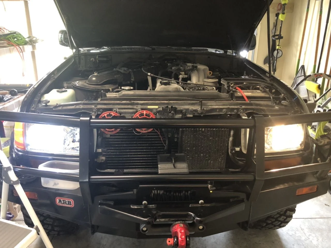

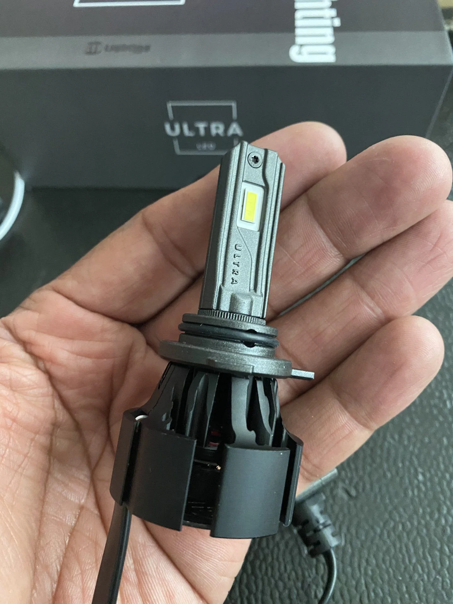

What did you do for the rubber boots around the headlight housing and bulbs? I was hoping the LEDs would split at the heat sink so I could slip the boot over, but short of potentially breaking it, I don’t see how?
EDIT: Disregard, I’m a klutz. Here I am trying to separate when they TWIST:rofl:
Also, new Silverstars in driver’s and Auxito adjustable in passenger...
