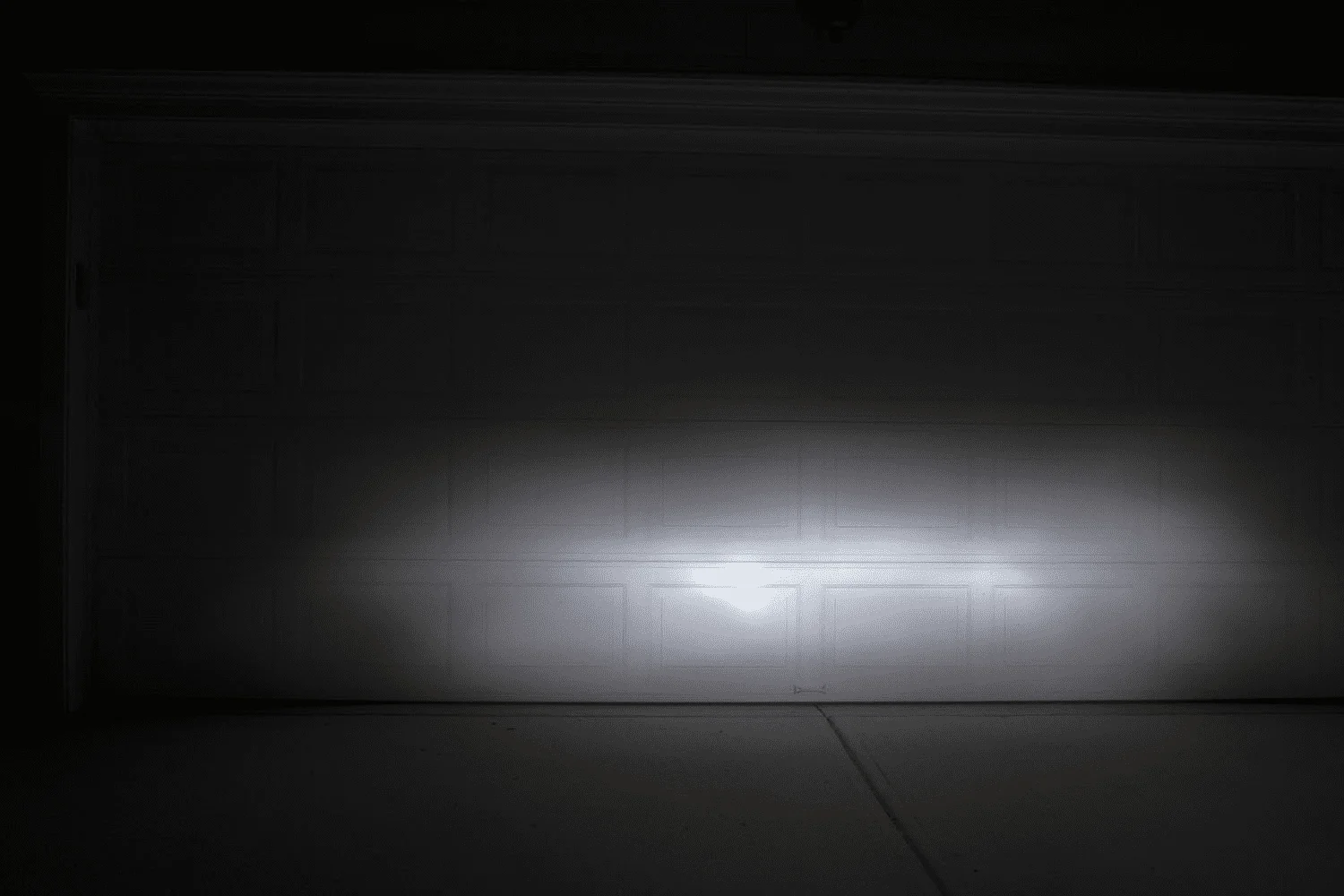

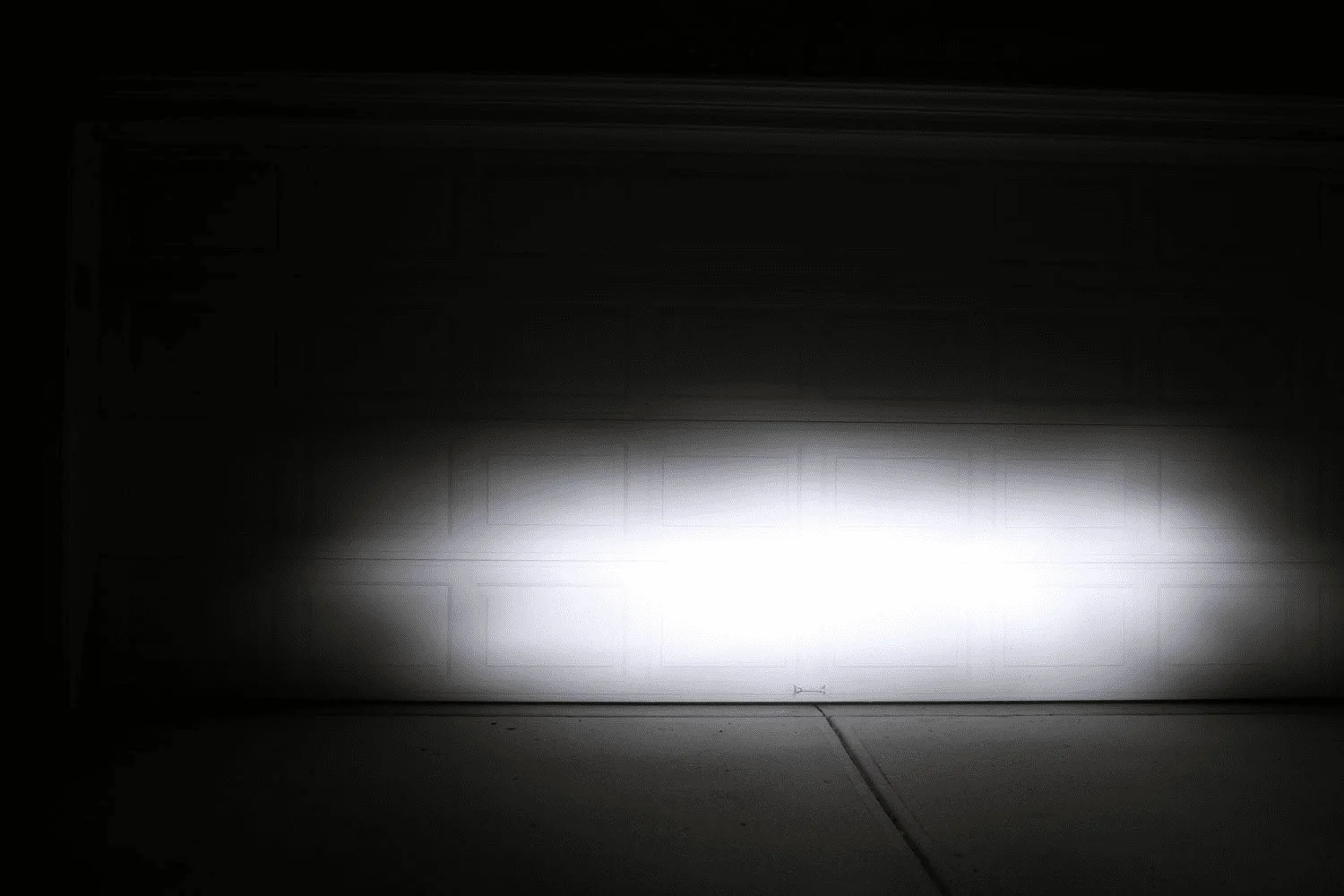

AUXITO H4 9003 LED Headlight Bulb Fanless 9000 Lumens Adjustable Beam 6500K in both driver and passenger side headlight assemblies.
Exposure -2.0. Contrast -100

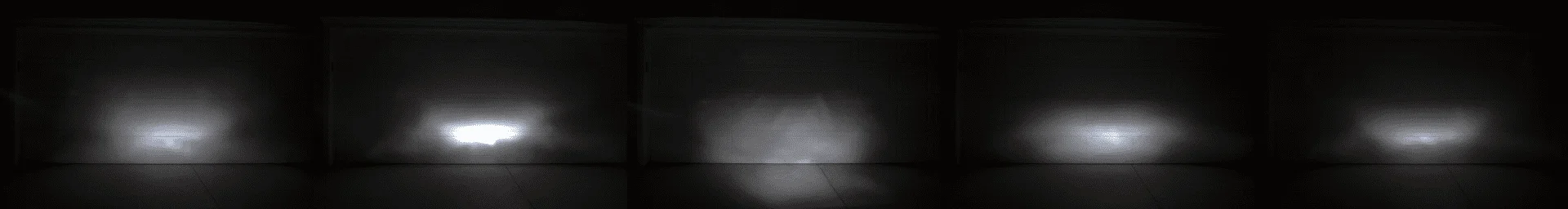

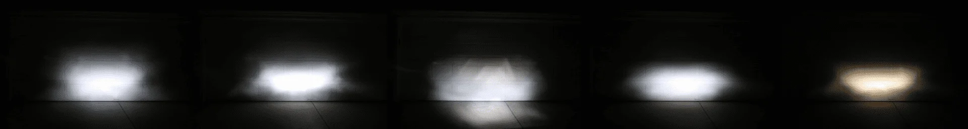

The full lineup in the same order as above.
This is a great post thats was a lot of work. shout out to you sir....I would pick number one I think. I do have a question I think is related. Why are the fog lights on my 2014 j200 yellow, whilst the headlights are bluish white? I do not like the contrast and are there blue white higher quality Fog lights which I can purchase and where? Thanks in advance. Rob

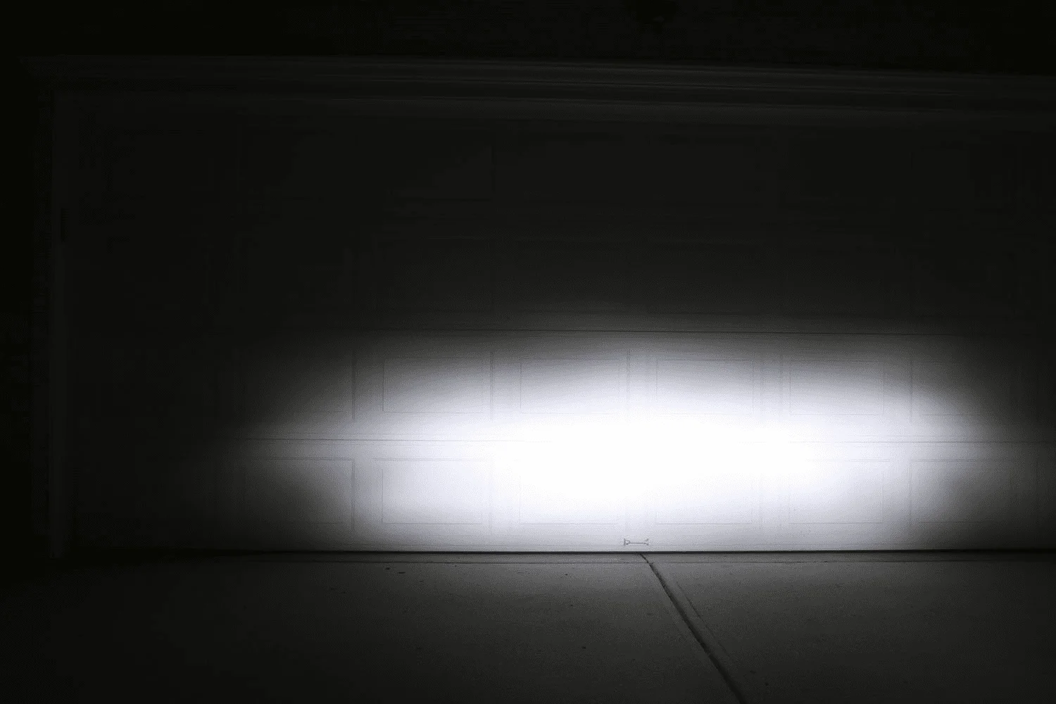

Same as above but rotated to notch 6.

The primary purpose of my experiment was to show the WIDE variation in LED output and demonstrate that there are LED's out there that are safe to install in Depo headlight assemblies that will not blind oncoming drivers.
