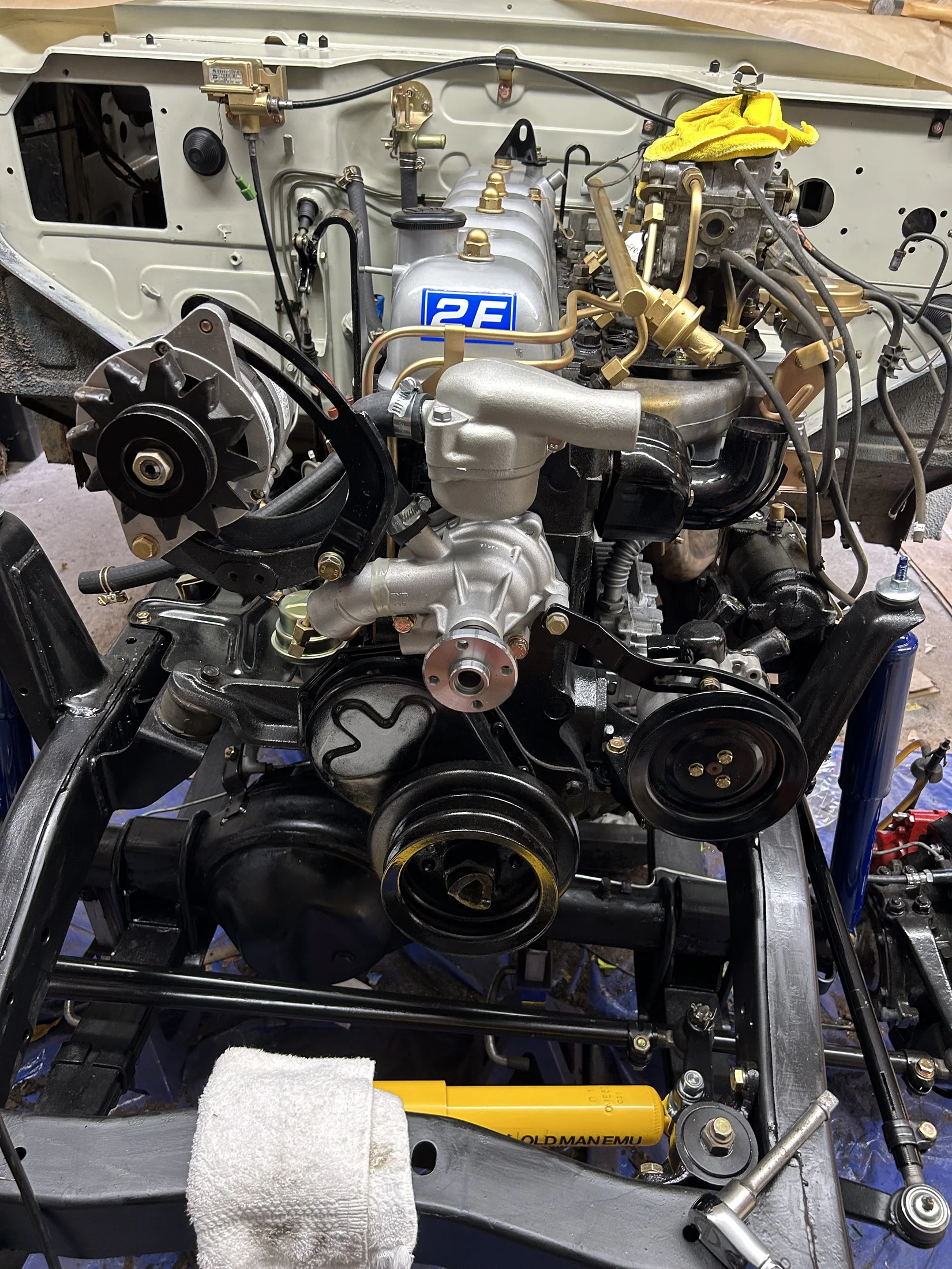

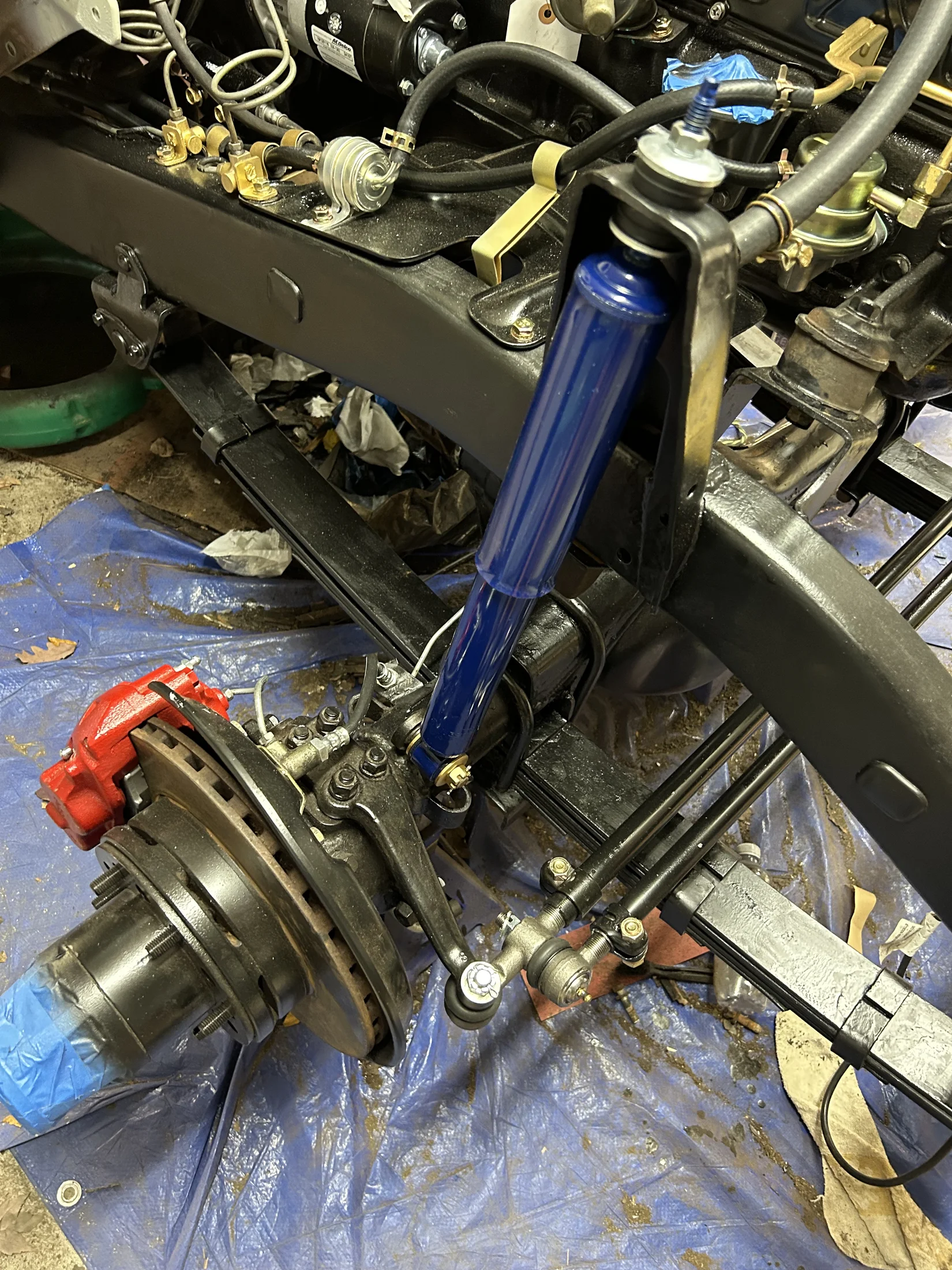

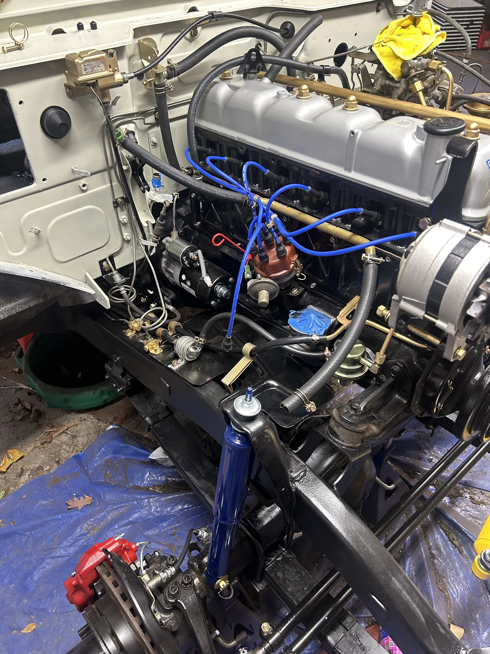

More updates on the Pig--was a productive few couple of weeks working on the cruiser. We started putting the engine and brakes/steering back together (putting the new parts on feels like it goes MUCH faster than removing everything) and we cleaned and POR'd the frame, which was in great shape, just caked in desert dirt. We were going to try to tackle a carb rebuild or get a new one, but instead decided to just clean up the original since everything was in good shape and running great before we pulled it. Next on the list is to pull the rear wheels, inspect and most likely rebuild the drums and get the rest of the interior stripped.

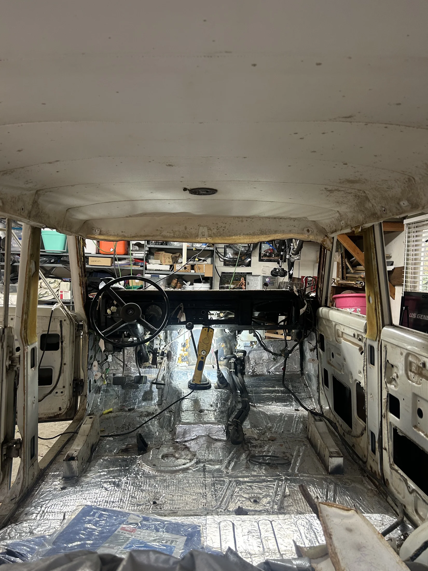

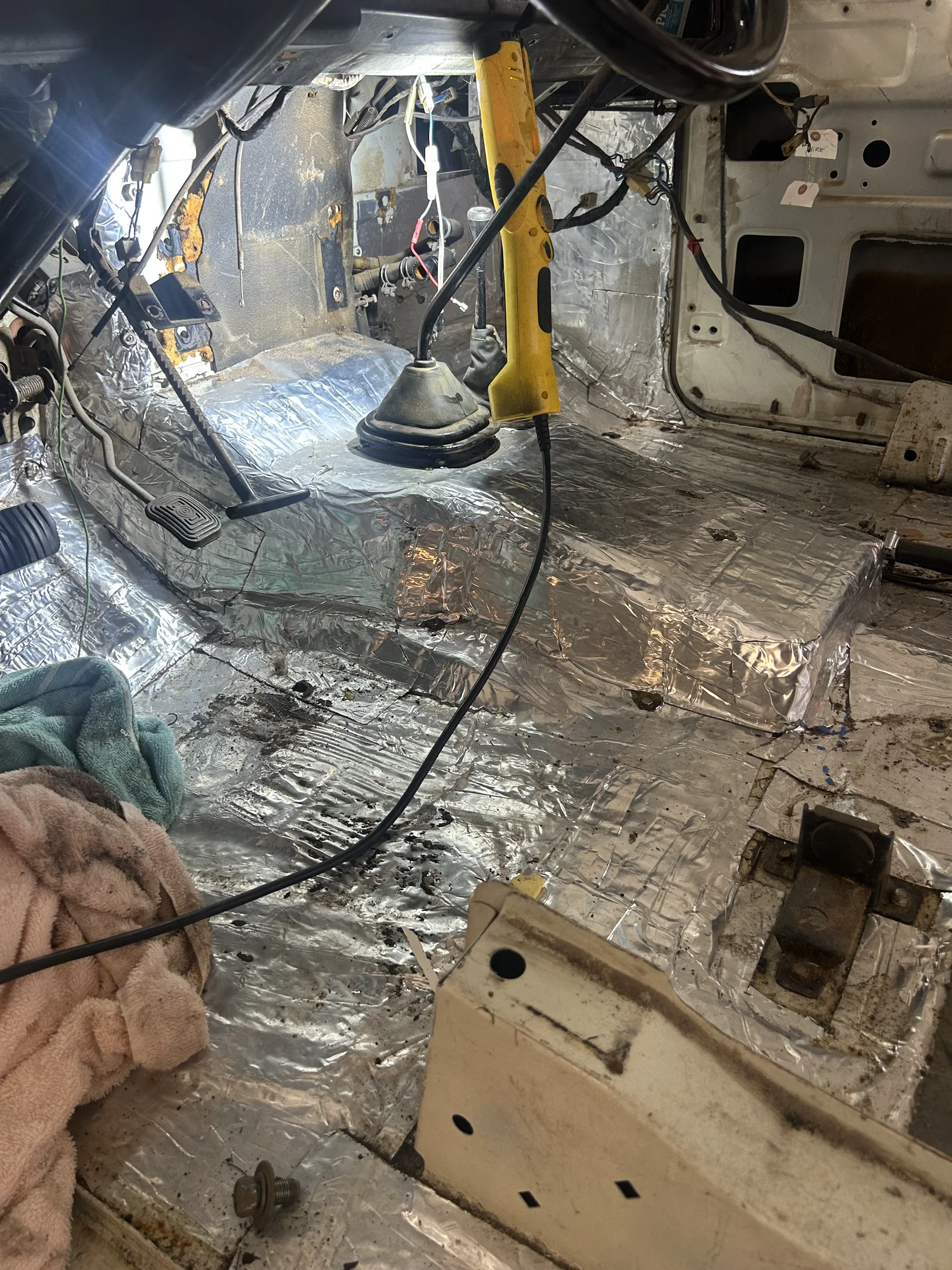

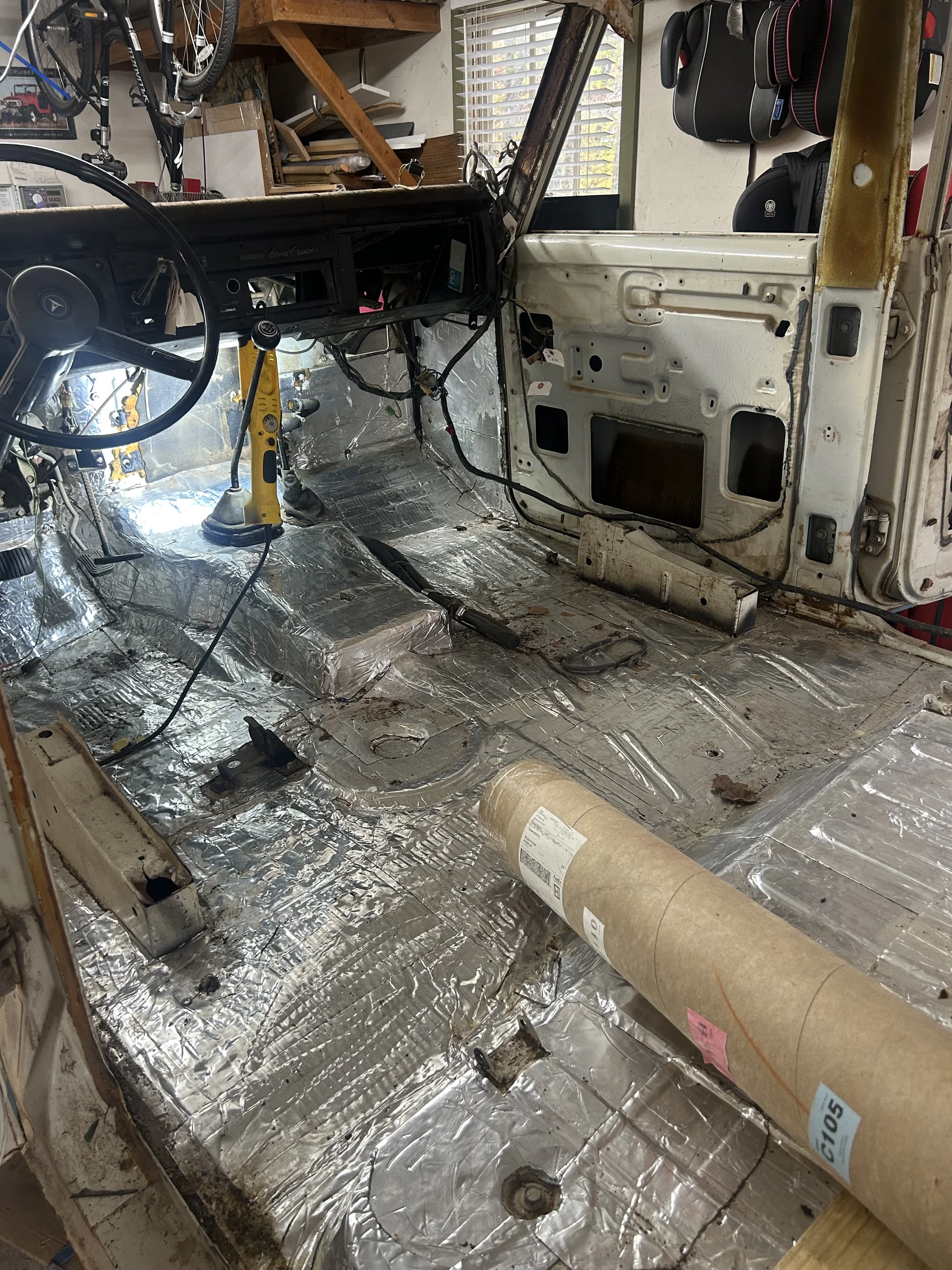

Started stripping down the rest of the interior and taking apart the dash. The PO had put down some sound deadening material so no way to check the floorboards, but they seem solid and I checked under the car and looks to be in great shape with no holes and only minor surface rust.

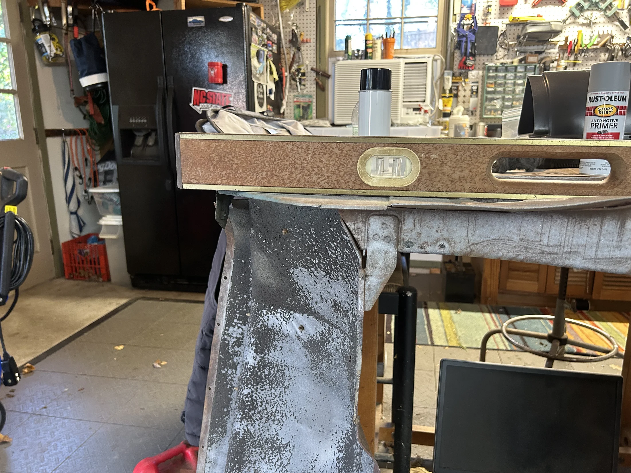

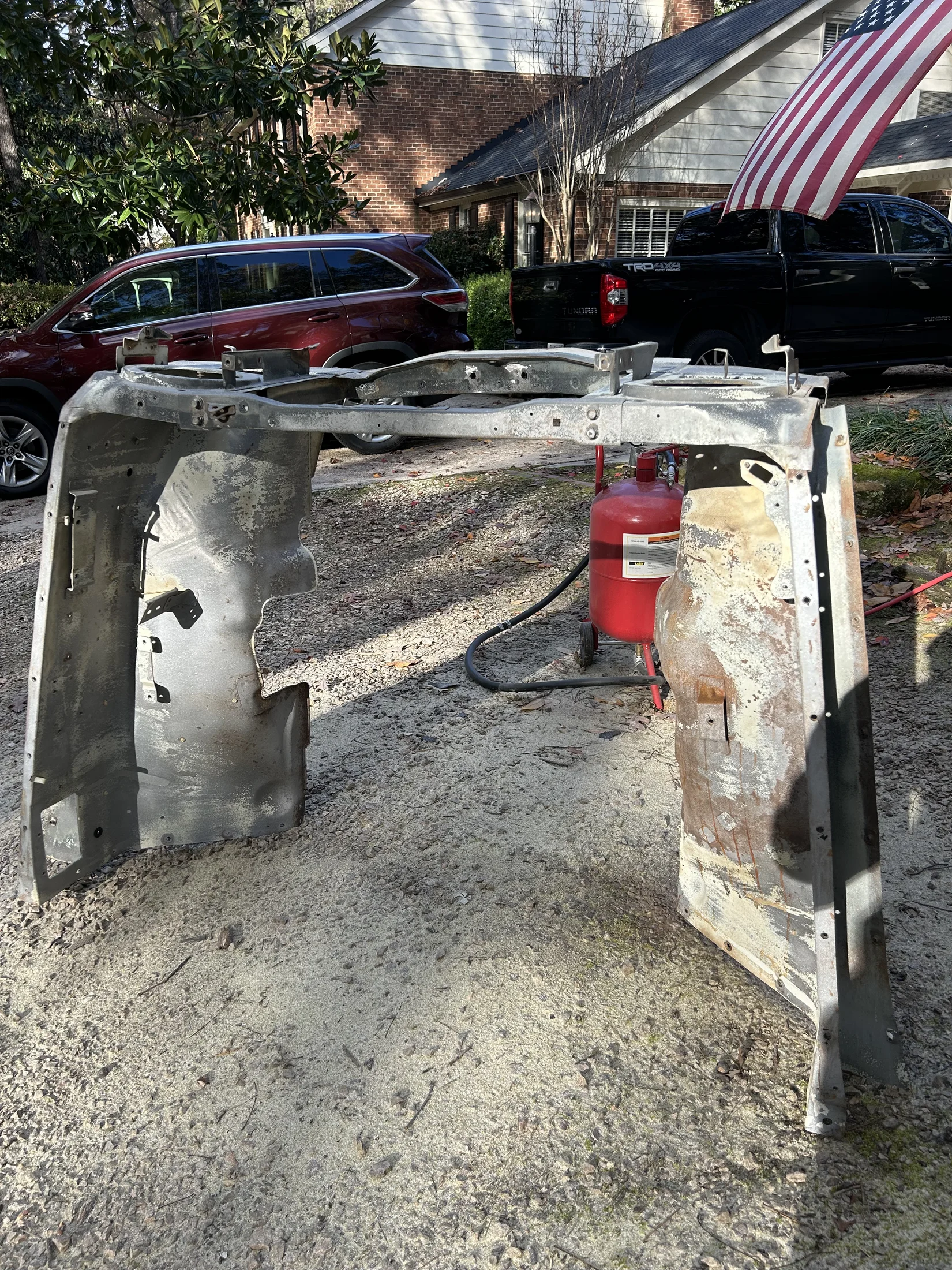

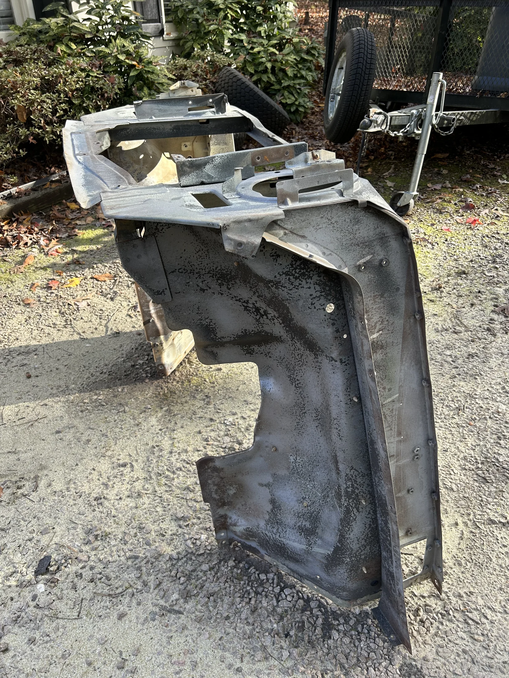

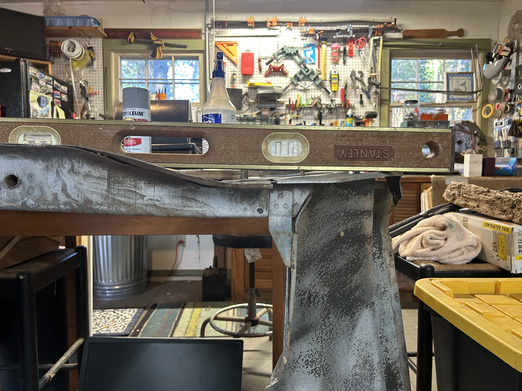

Spent the day yesterday sandblasting the front end and trying to figure out what to do with what looks to be a bend caused by a fender bender at one point. You can see it is off about an inch on the bottom crossmember on the front drivers side. I think we should be able to make a cut underneath in a V and pull it back out to make it even, but you can see from the pictures it is noticeably bent (the frame is fine, this looks to be the only area that was affected). I remember feeling like it was a little off years back when I was driving it and the headlight was pointing more to the right--we found out the PO tried to bend the headlight housing a little to fix it but just made it look like a pig with a lazy eye.

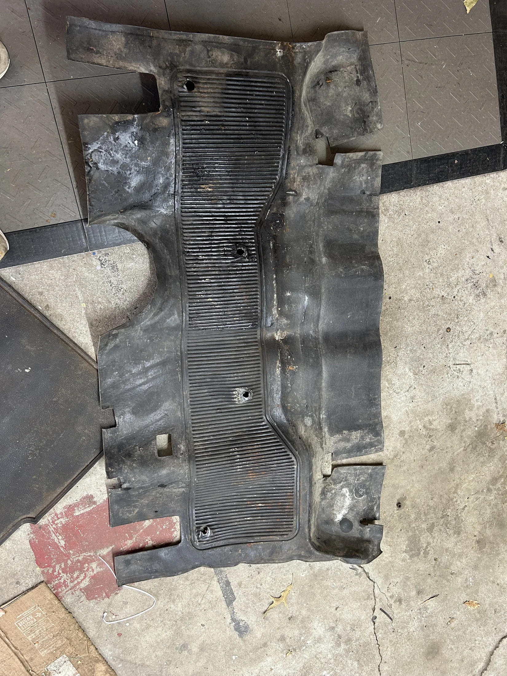

I found the front and rear vinyl and cargo mat in the attic and will most likely reuse the original cargo mat (sorry @WarDamnEagle), but not the front and rear vinyl if the carpet kit works out. The original front vinyl mat is in pretty rough shape but the rear could be cleaned up and reused. Also, according to tracking, the carpet kit should be here next week--we are still in the process of stripping down the interior so once we have everything out, I will lay it out and take some photos of the quality and how it looks/fits.
