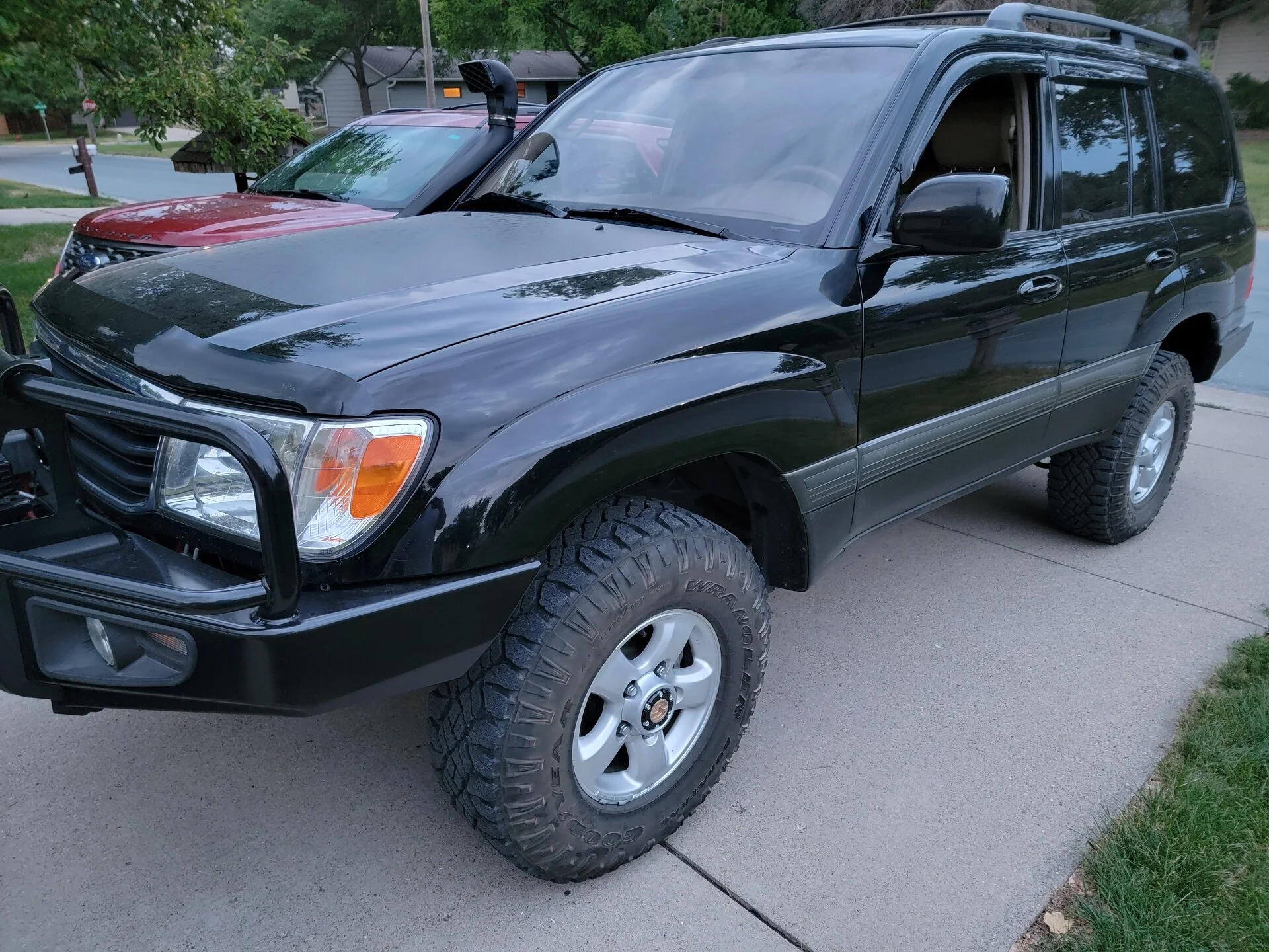

I had the part time kit on the shelf for quite a while. Finally put it in. I am pretty picky about how it drives and tracks down the highway.
Wow. Lightened up the steering feel a lot which is very welcome. Tracks on the freeway very nice (about 3.5 caster) and coasts when you let off the gas. Acceleration in 2wd is really brisk compared to AWD. I did not realized what a drag the AWD is for both speeding up and slowing down. I loved driving this rig before but now, oh yeah. One tank of fuel so far. Looks like 1 mpg increase but not enough data/too many variables in mixed driving.
Even without the mpg improvement, I would do it again. Mostly stock rig. Nice work CruiserOutfittters!
