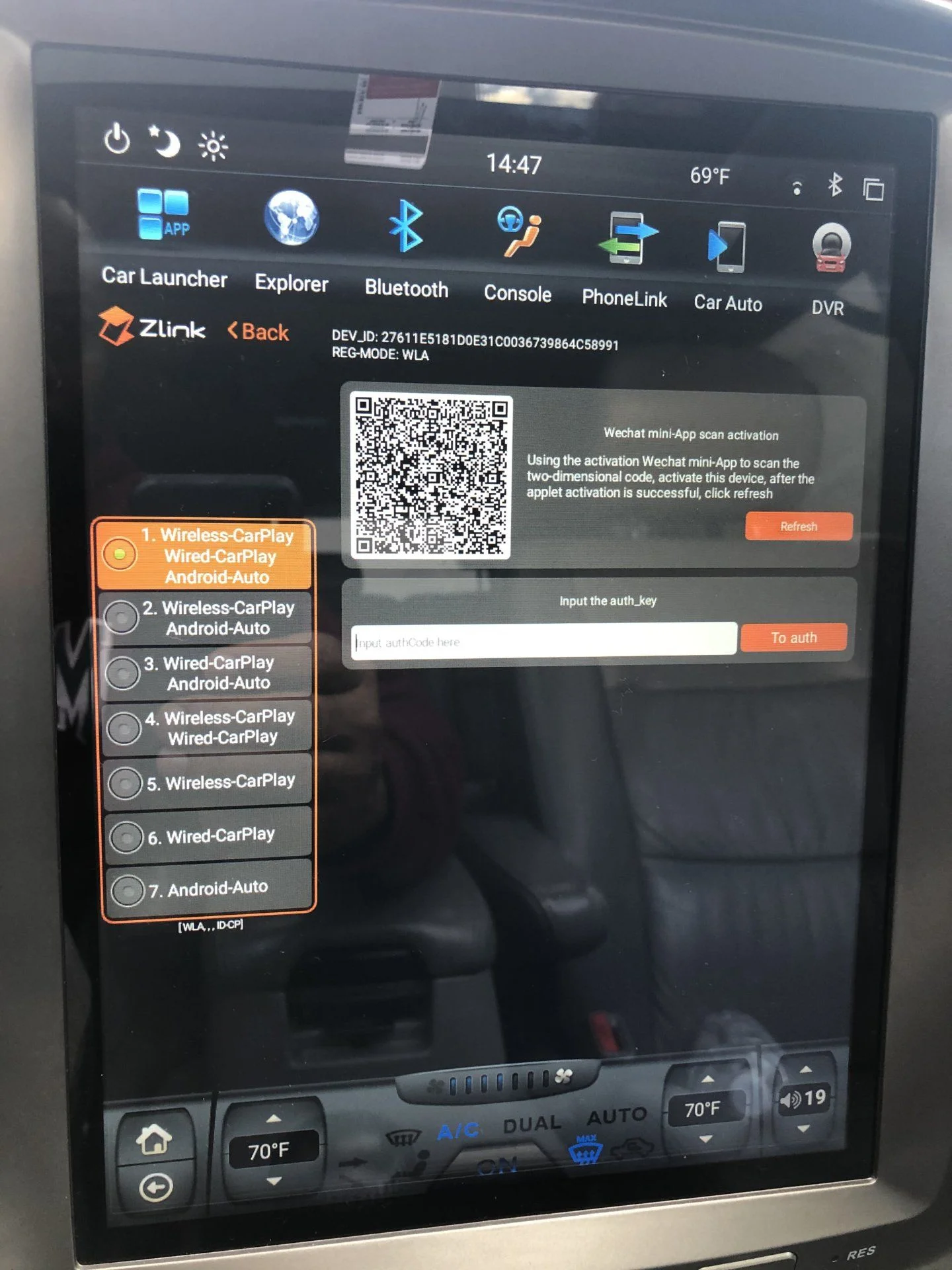

Has anyone seen this screen?
car auto is the android auto or car play if I’m not mistaken. When I plug in my phone it takes me to this page. Today the tablet asked me to connect to the internet. Then this page came up. I don’t know what we are missing here in order to get wireless android/apple connectivity. Anyone ??
it appears to be a few steps away from this page but what is the QR code doing? My phone doesn’t make sense when I scan it and I’d hate to download some bugs or crap that gives the manufacturer access to my digital privacy.
Still working on this. Maybe rhino or some knows how to navigate??

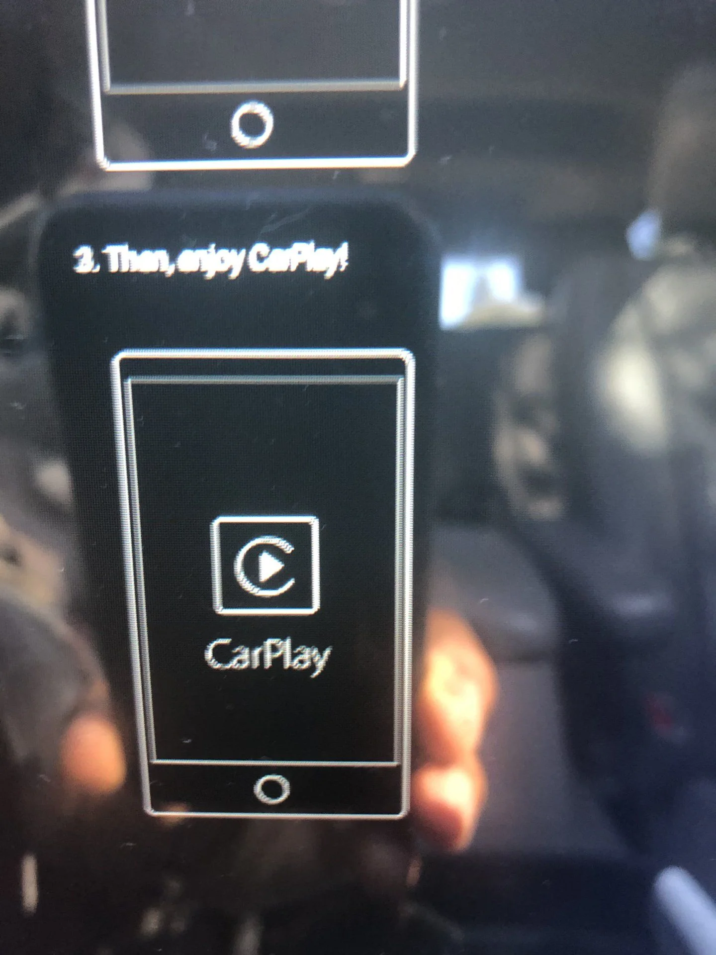

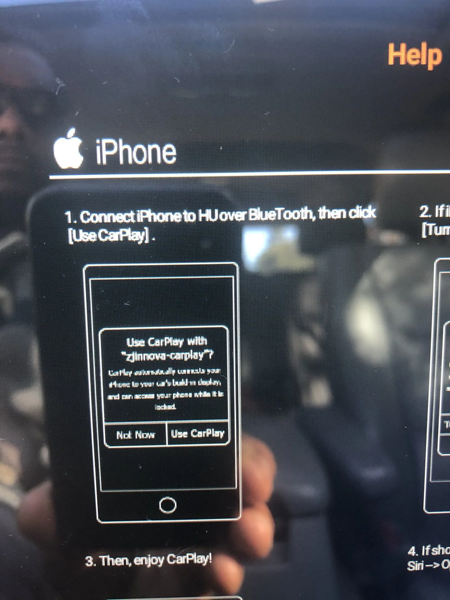

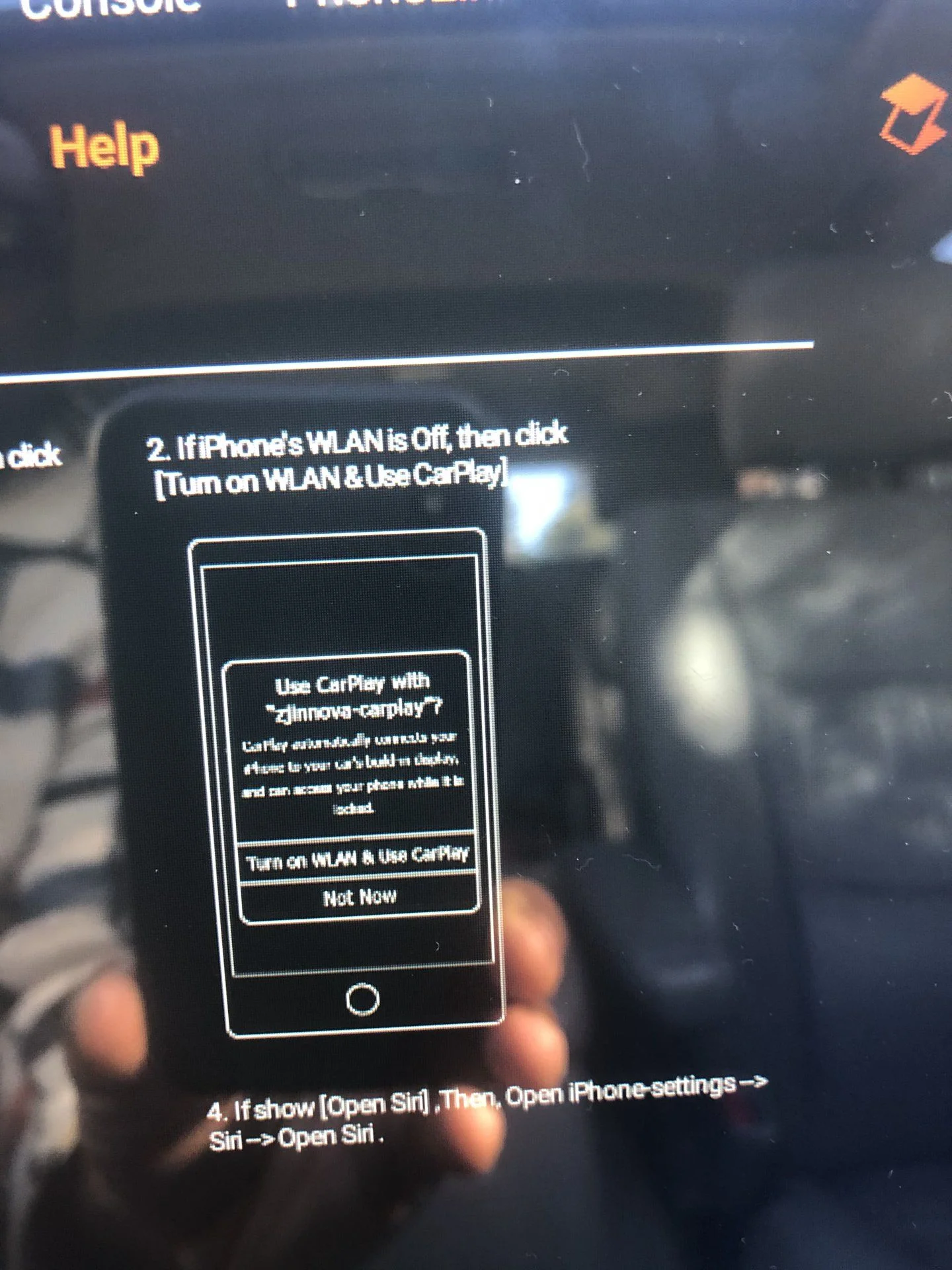

When I’m connected via usb there is no problem with CarPlay. When I unplug the cable from my phone it’s waiting for connection. When I click the help button this screen comes up with instructions about using Bluetooth but the name “HU” that’s supposed to show up in my Bluetooth list never appears so I can’t connect CarPlay wirelessly.

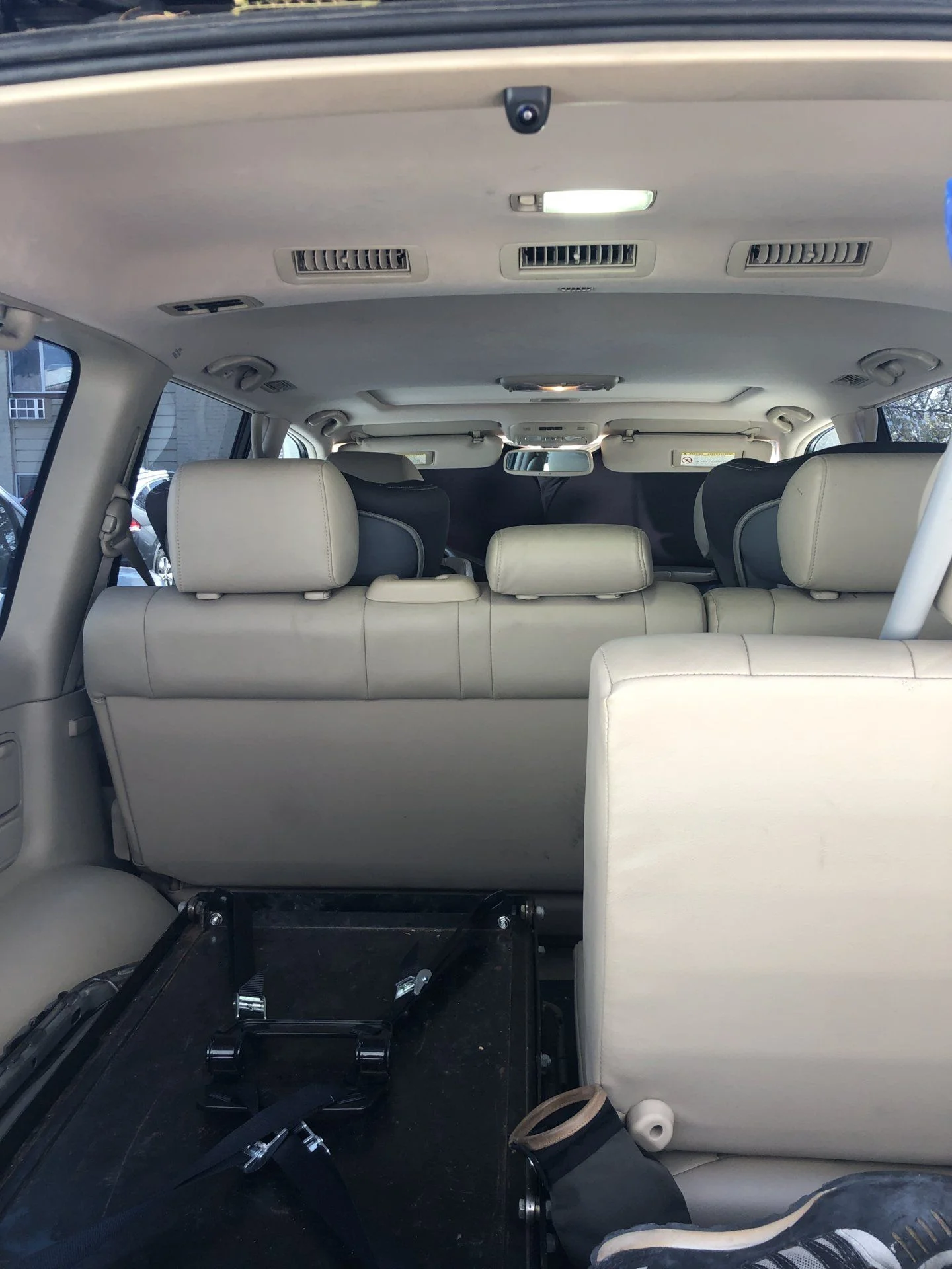

Late response here, but I did this. Mounting the camera on the inside of the car. On the top center of the rear window - there's a piece of moulding that runs across the whole back. Drilled right in the middle and ran wires down and to the head unit. It isn't messed up by snow/dirt and have full viewing access to whats outside - even above my bike rack.
Recommend for easy installation and weather resistance. Also, no holes in the body itself.
genius!!
I'm pretty sure that "HU" is just an acronym for Head Unit -- the instruction is telling you to "Connect iPhone to Head Unit over Bluetooth, then click [Use CarPlay]"
