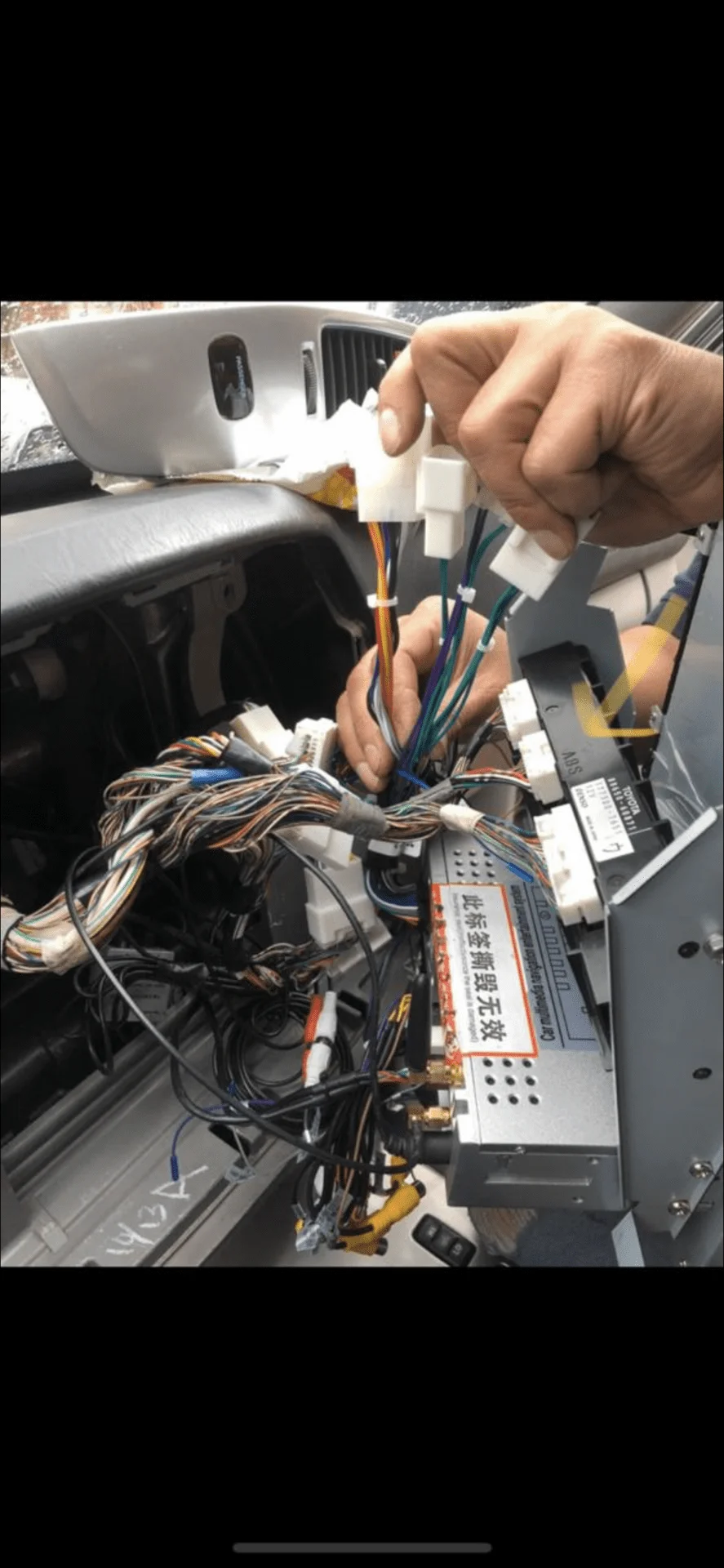

Successfully installed a Tesla Style headunit into a 2005 LX470

Ell Ex has done a successful full install of the PX6 (6 core) units with Android in a 2006 LX470 with ML amp and custom apps. I'm in the middle of a full amp and speaker replacement with a 2004 LX470 and the PX6 unit. A few others have been working on 2003 and older installs. I've heard of a few people wanting to try these with non-nav (dedicated AC control version) 100 series trucks, but have not seen one yet.
The 2004 and newer seem to be plug and play for cables (once you figure out where they all go). There seem to still be a few extra plugs left over (3 in my case) that may have been part of the factory test.
The 2003 and older units are needing either another harness from the manufacturer or a few wire splices to work. There was a request for the "Top Model" wire harness for these truck to avoid splicing, but I cannot confirm its the final solution.

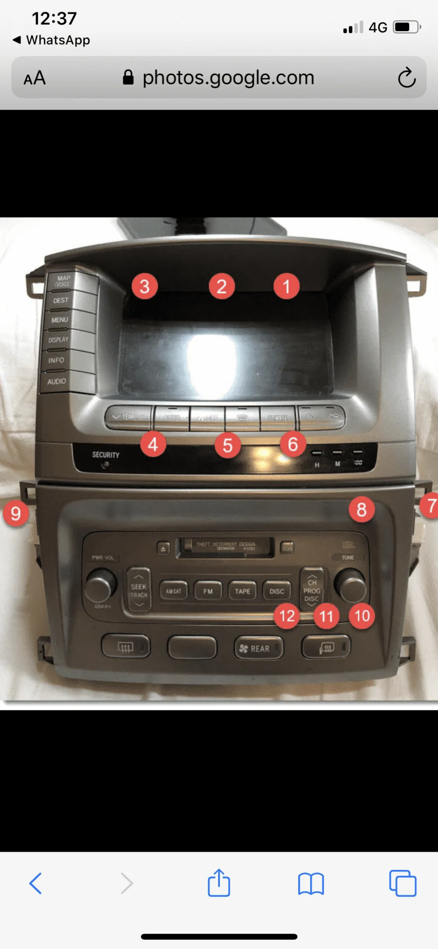

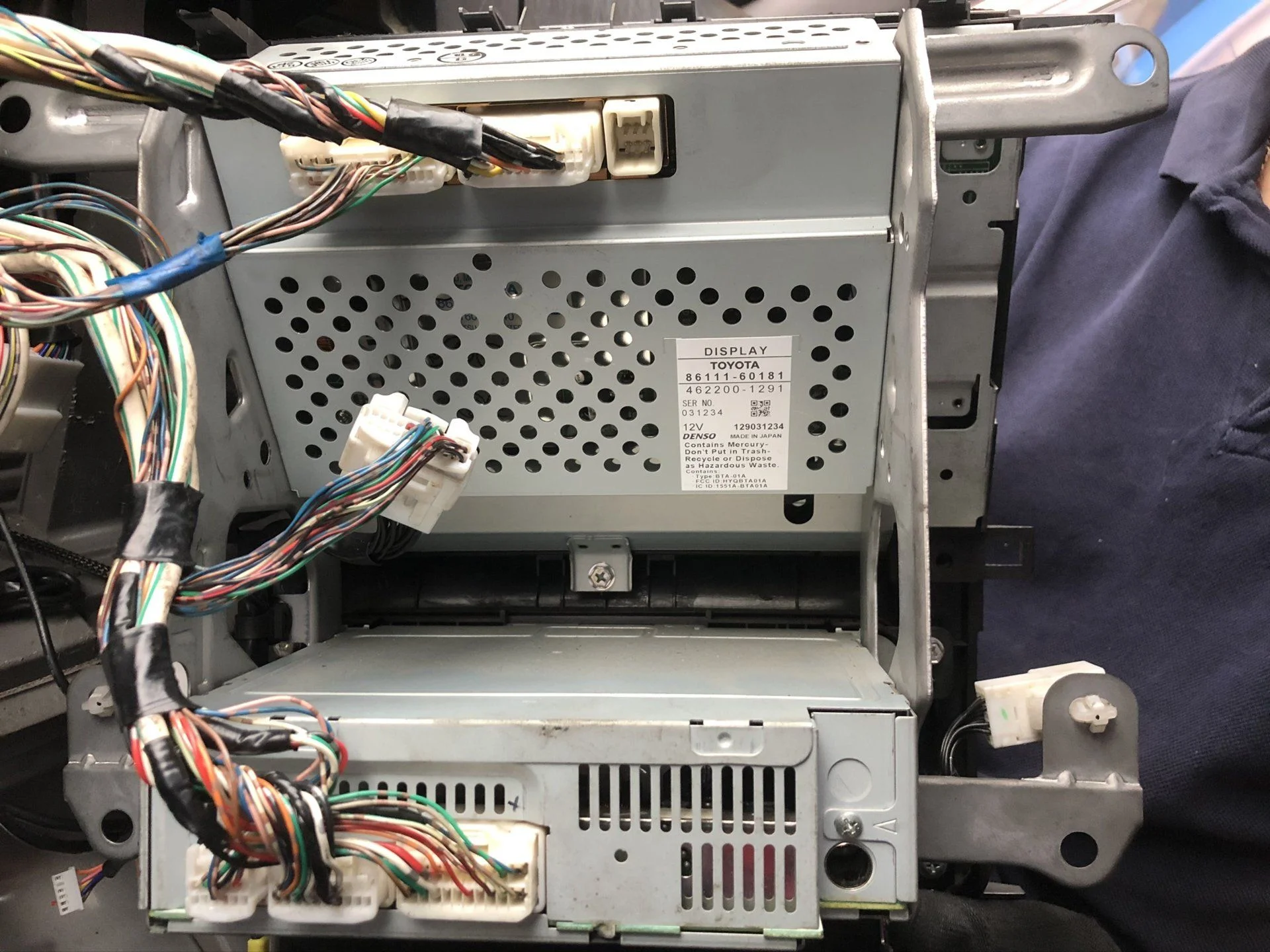

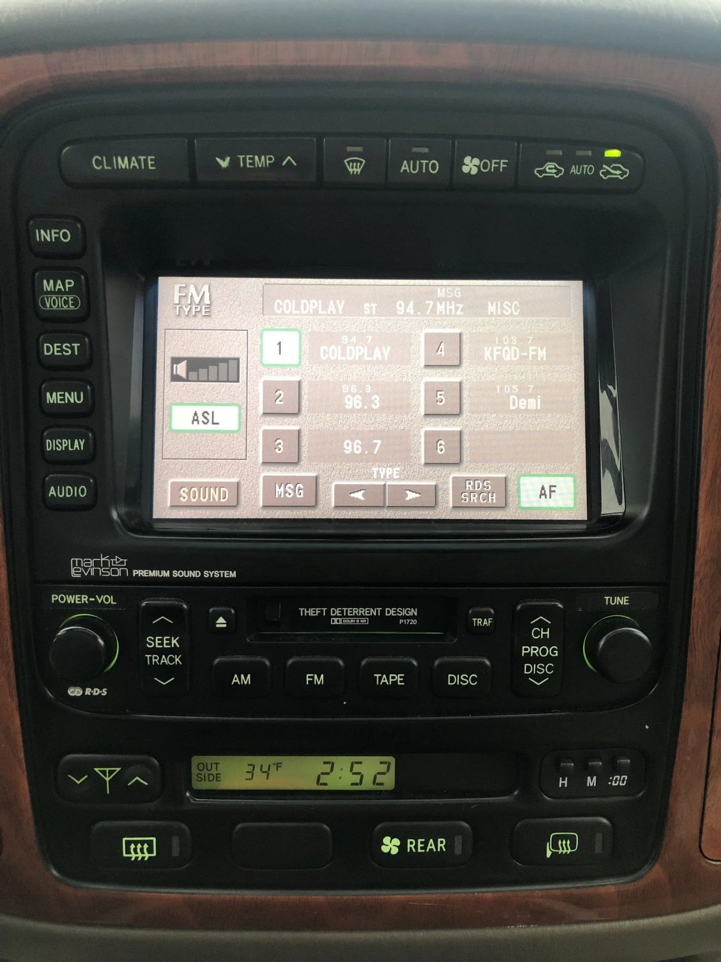

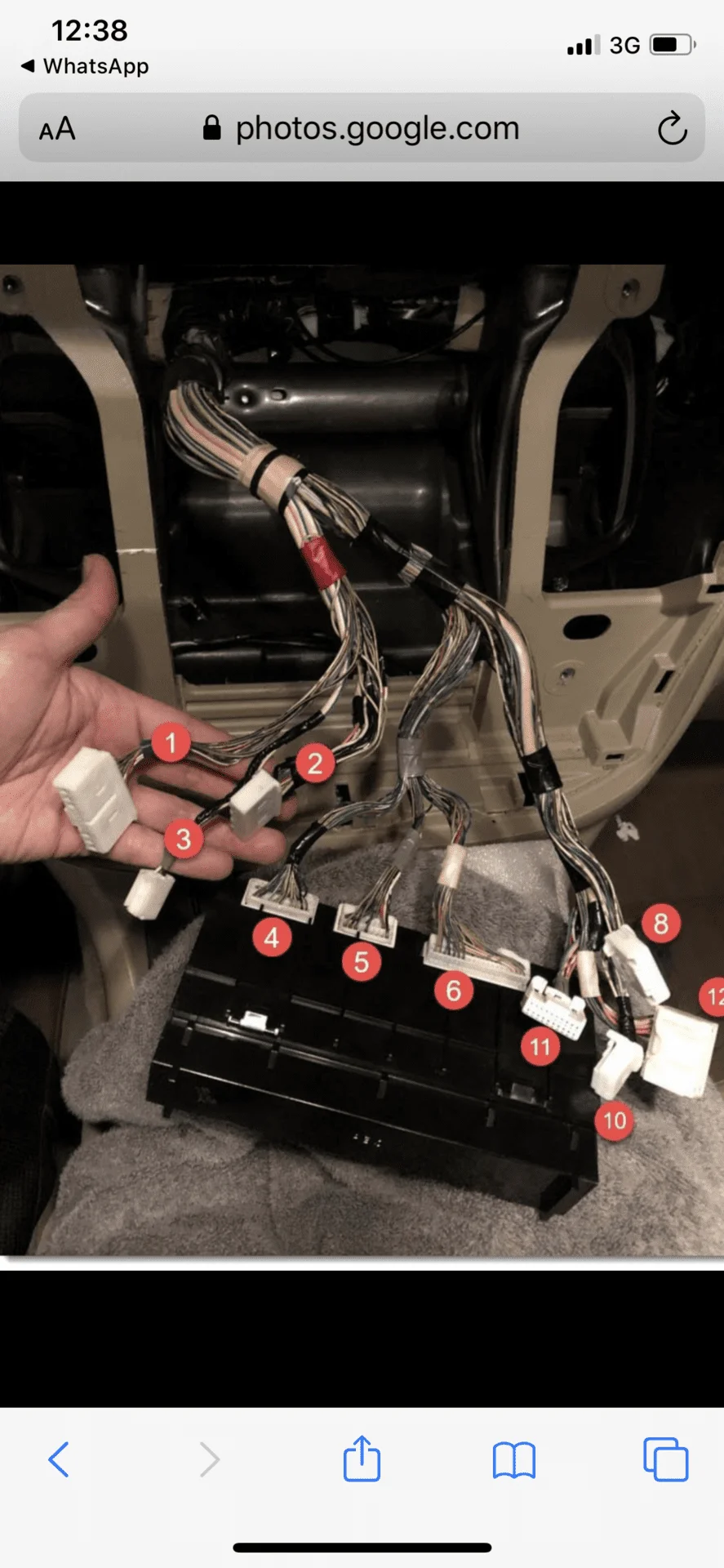

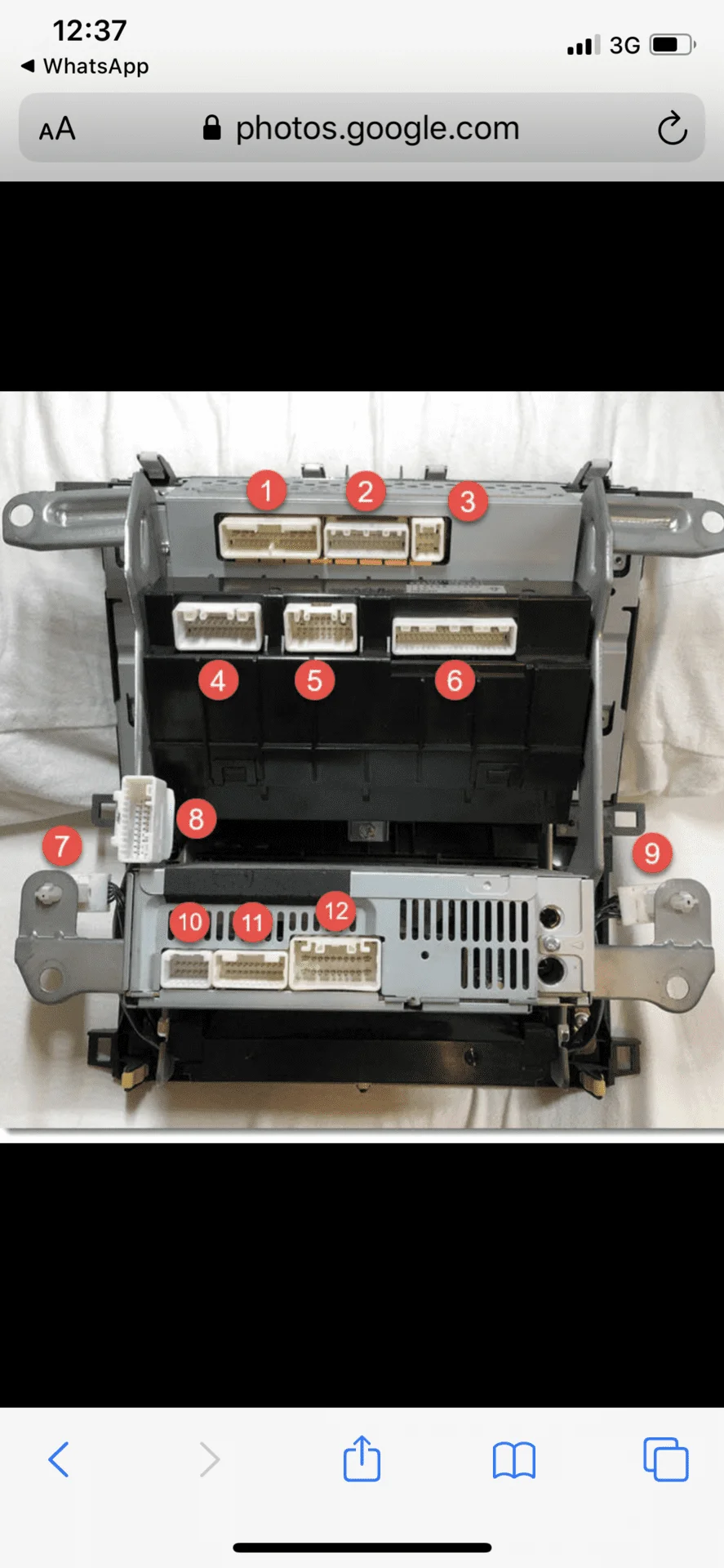

I own a 2006 LC with factory navigation and auto A/C. Attached are the pictures of how the front and rear of my OEM radio and A/C look (Picture 1 and 2).

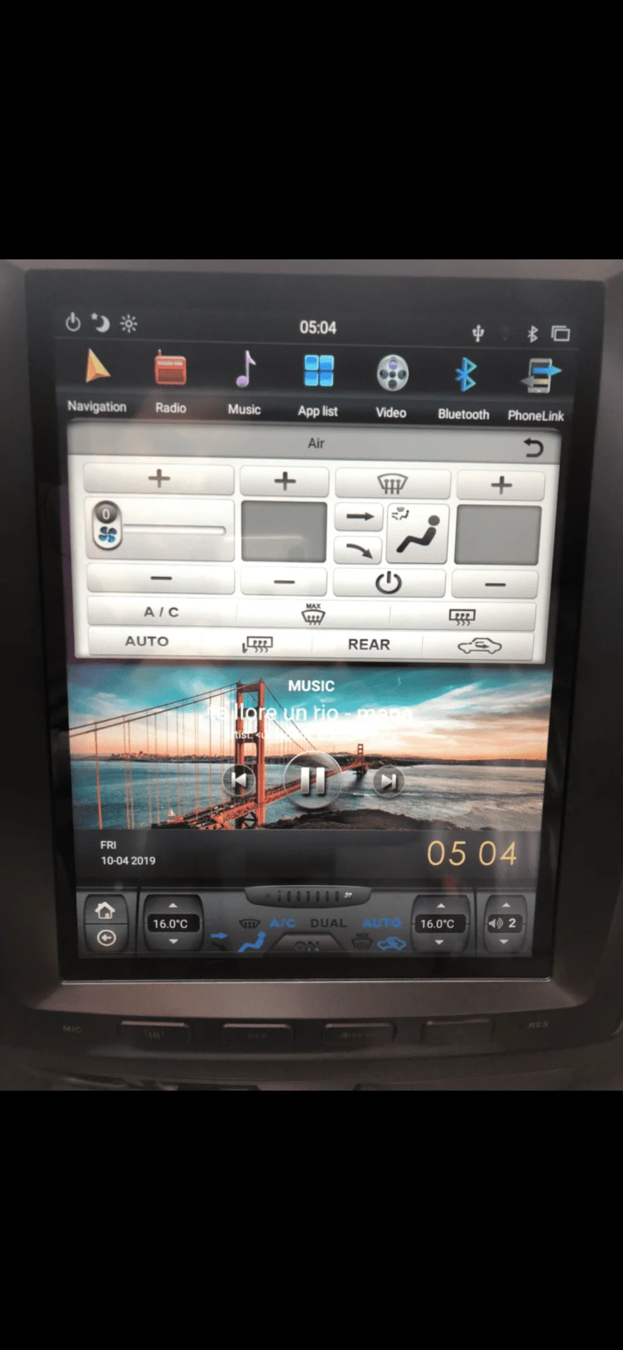

I bought a PX3 screen with the specs showed in (Picture 3).
After installing the screen everything works except A/C control, it just shows the configuration it was left in the OEM system before removing it but nothing can be changed. (Picture 4)

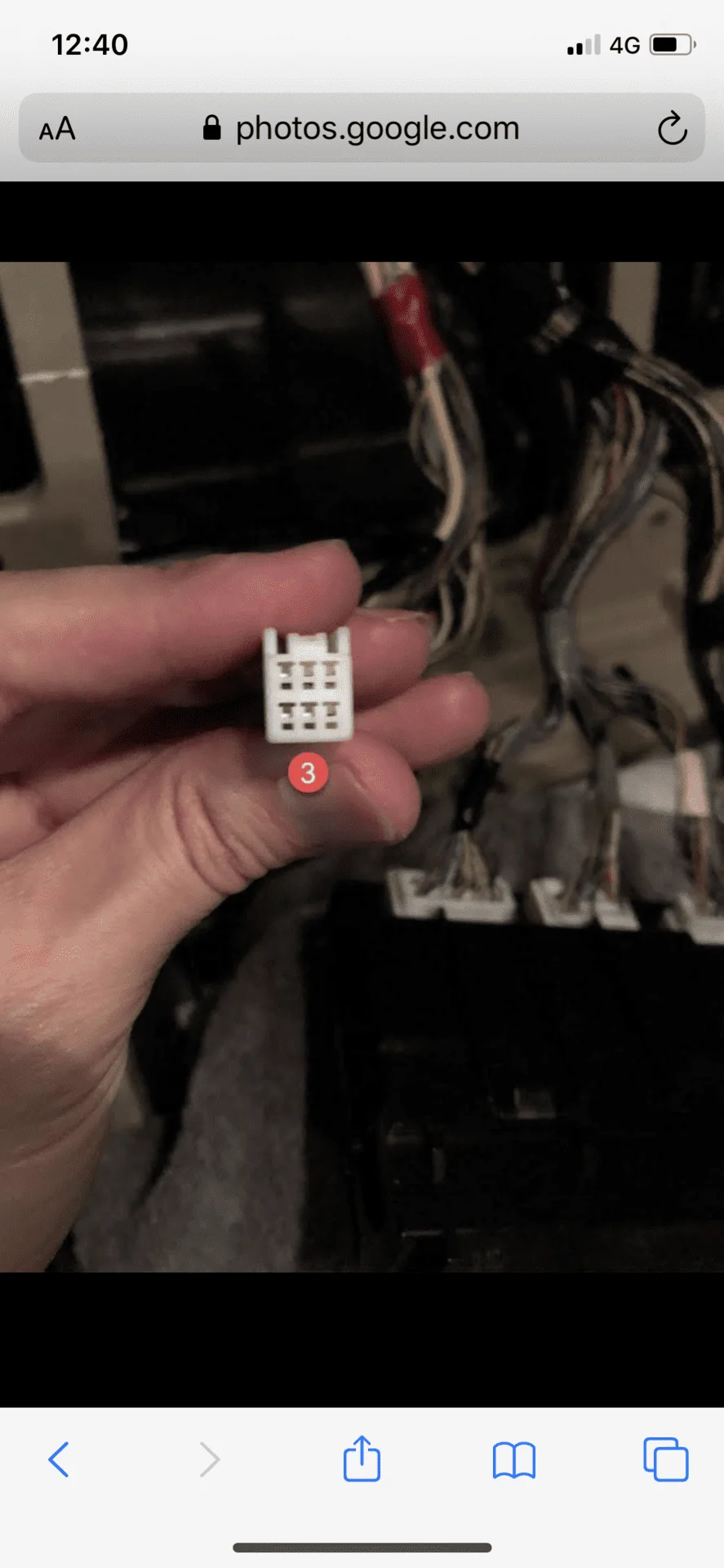

1- They told me I had the wrong harness so I bought the “Premium Harness” with the green cables but still it does not work. (Picture 9)
2- Besides the cables for the A/C box (Picture 5), in (Picture 6) is how the OEM vehicle harness are connected to the OEM vehicle radio.
3- The vehicle OEM harness does not have the cable that goes connected in position 3 on (Picture 2).
The cable is supposed to look like this (Picture 7) but my car’s harness does not have it.
4- My car’s OEM harness has all the cables in (Picture 8) except cable 3.

1- Is this cable 3 the one that controls the A/C?
2- If my car’s OEM harness does not have this cable how can A/C work?

Yes the air conditioning works. People are having issues with the 1998-2002 non-nav air conditioning, so I can only speak for the 2006 (my year). What is your year?
The 2001-2002 nav with a/c top buttons are different from the 2003-2007. I’m not sure if the 2003 nav is slightly different (connections) or if it’s the same as 2004-2007 nav.
1. Transfer the black OEM HVAC part with the three plugs to the Tesla 12.1. I have a picture (2nd screenshot) of it above.
2. Connections: You would have to take a picture of your connections for us to troubleshoot it. Sorry my picture is a mess, but I’ll take more detailed pictures at a later time.
