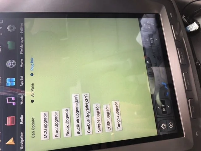

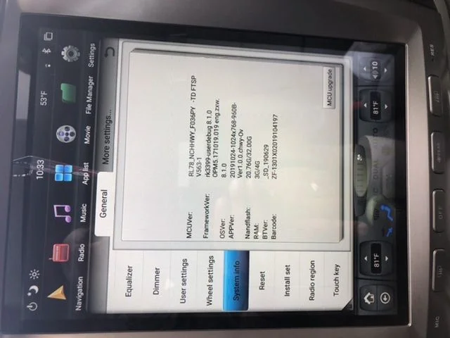

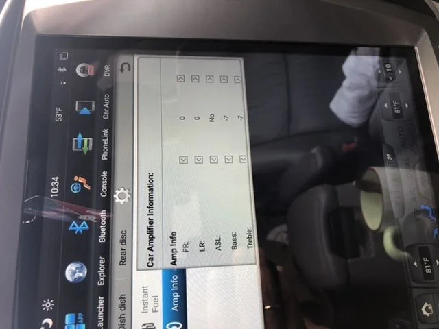

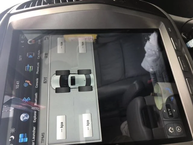

I’ve been looking for some of the settings I’ve seen people talk about. I found these in:
system info
User settings
console
Tpms
I’m not certain what they do or if they should adjusted at all.
From what I can tell LC 100 Hi is the correct choice but there are other LC 100 choices.
Still can’t get rid of the yellow Lamborghini on start up.
any insights on these pages would be helpful.
I think the tpms will function after I install the sensors.

Since you went with an aftermarket amplifier, the "Amp Info" settings under Console will no longer work. Those settings interfaced directly with the Levinson amp, so now that it's gone they won't have any effect. Use the Equalizer under Settings instead of the Amp Info under Console for sound adjustments.
Did you connect yours directly to the Levinson amp? Have you noticed any drop in sound quality like @martianluther ?
