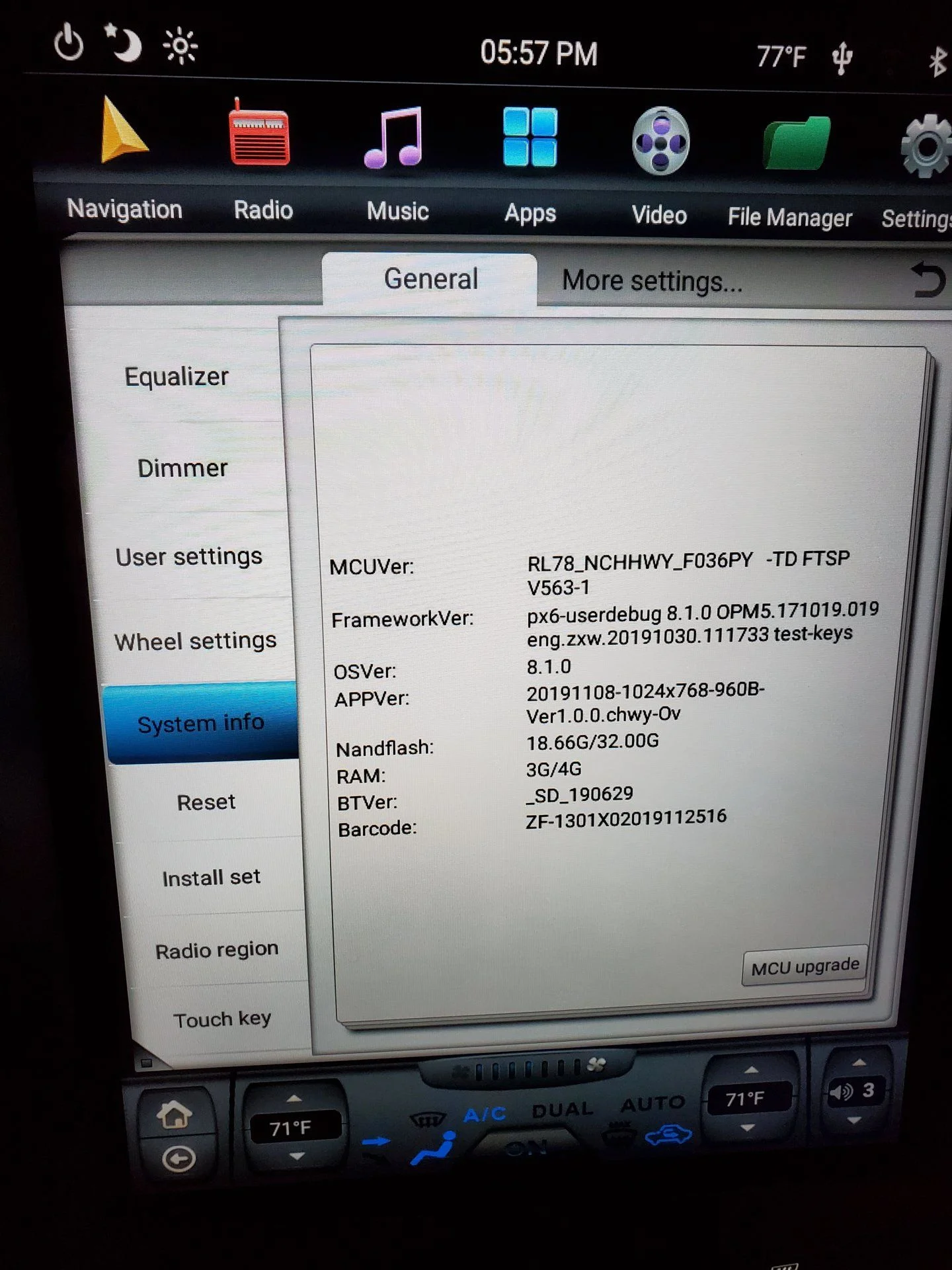

Hey guys I got mine installed. I saw a thread about this but I'm not tech savvy - is there a way to change that yellow lambo on boot up to a landcruiser? can the car on the on inclinometer be changed to a landcruiser? do you have the patience to explain it to a tech moron like me? thanks
also have issues with engine interference, buzzing etc. The volume, even at 1, is pretty loud. I read the thread that advised to reinstall old unit, turn volume down all the way, then reinstall PX6. Has anyone tried this fix? thanks again
I'll post details when I get home...
Short description... Go to System Info and select the LC picture.

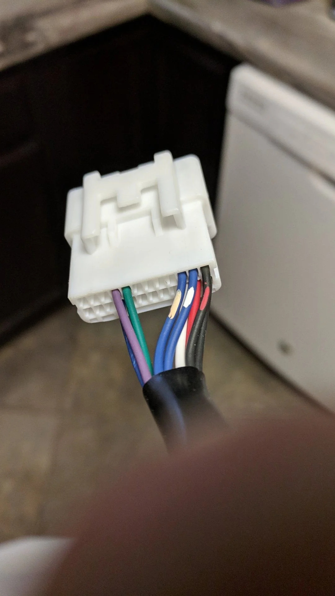

I wish I could fix the airbag thing for you folks with post Jan 2006 production trucks. I doubt they planned or even thought about the srs system check. It's different for 06 and 07 and only in the usa, and I think one other country.
Without knowing exactly what is retained as far as the circuit boards and wiring in the lower climate control part of it I can't speculate too much. searching Prius, Lexus GS and ls from the same years and see if they fixed theirs might be worthwhile.
I thought someone on mud had this not be a problem for 2006 and 07, but I can't find it anywhere.
The quick and dirty fix is going to be a resistor either at the center airbag controller or at the point where the lower pcb got removed.
Center airbag controller is a pain to get to.
The c28 plug is where I'd try.
If anyone has good pictures of the back with all the climate control part of things exposed I could venture a guess.
What happens to the c28 connector in the LC when you install this thing?
The purple and blue wires in this connector to the left. Purple on top and a blue one directly below it. That is where I would start looking . IF --the new Tesla thing has no provisions for these two in the c28 to connect to anything then that is why the srs code is triggered.
this worked and I got the menu, but when I select any of the LC options, I get a pop up saying " can't find any logo file" and nothing changes. I'm connected to wifi, if that matters
That worked! Problem was there's about 8 different LC options and I tried everyone. On mine its Cruiser 100 HI. If you load the wrong one, you get that error message and HVAC stops working. But I guess we're still stuck with that little white Audi on the incline meter. Thanks for your help.

If you have factory nav you def select LC/LX470 HI.
I'm going to try and determine the folder where the logo files need to be placed as I'd like to replace with my own images.
