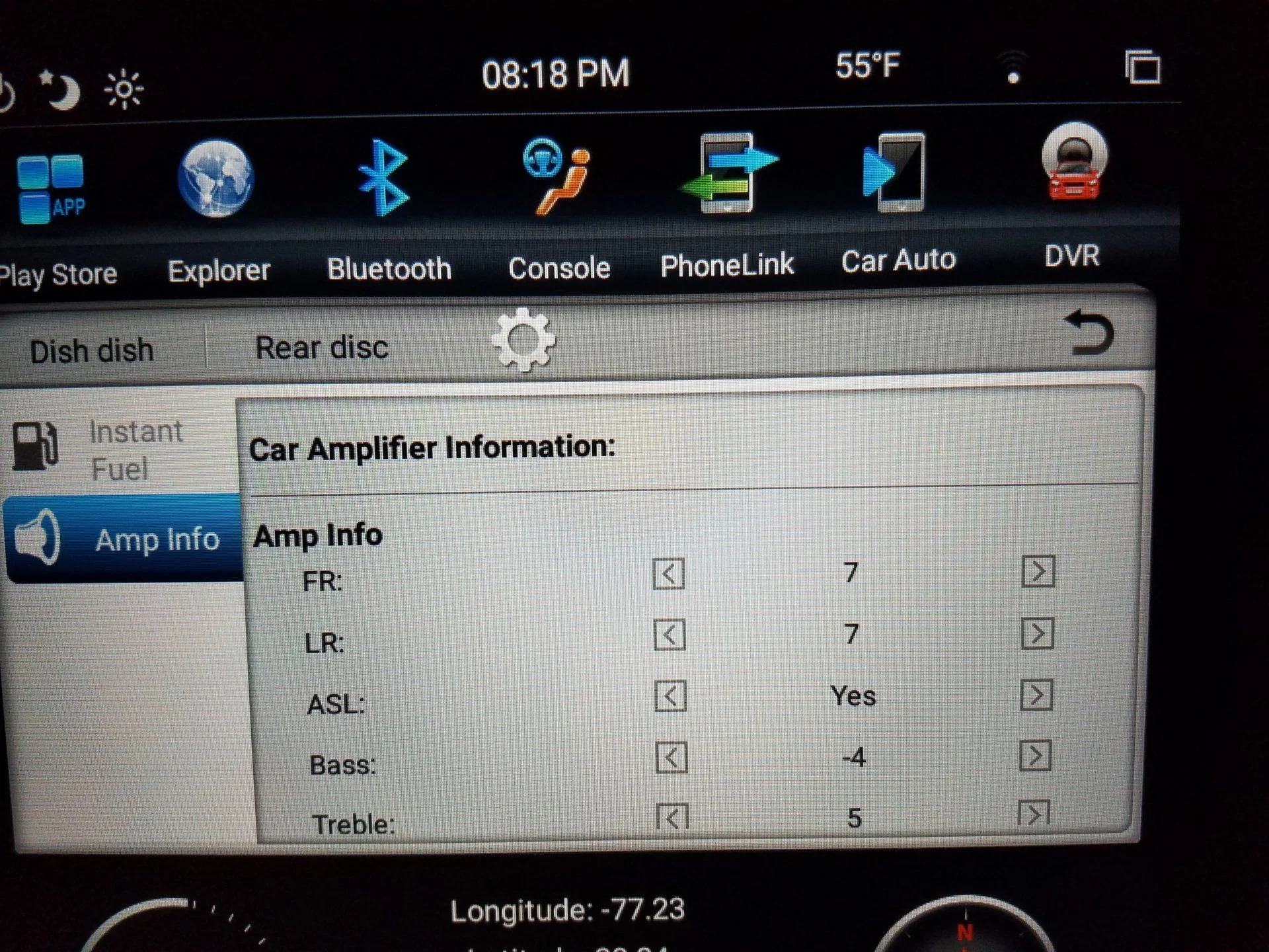

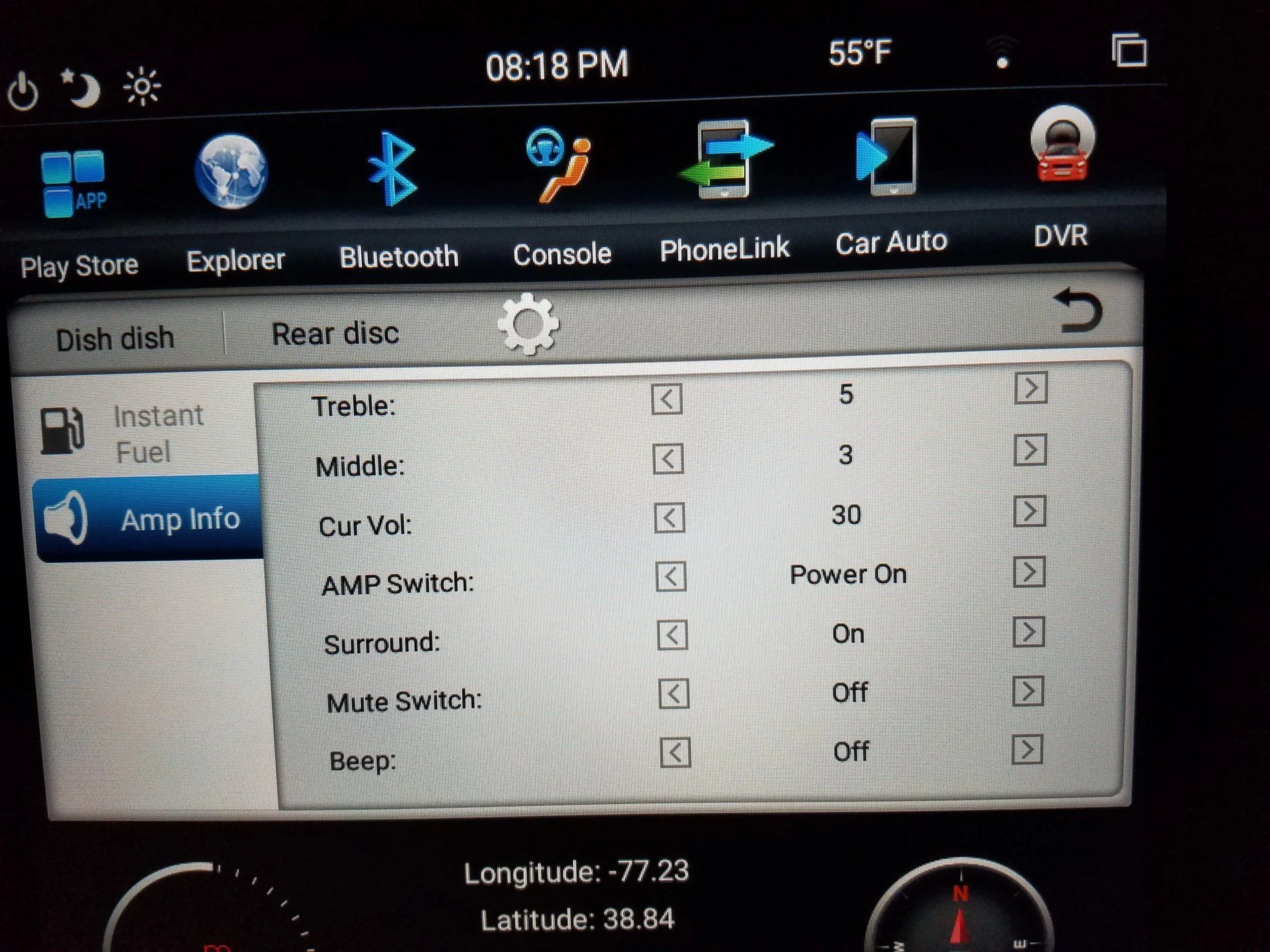

While I was toying around with the radio... I found this buried in the system:
If you go to Console... Select Amp Info... Scroll down to Cur Vol.
Mine was set to 30... while the "real" volume was on 9.
I was able to control the volume gain with this.
See if this helps with the low volume issue.
