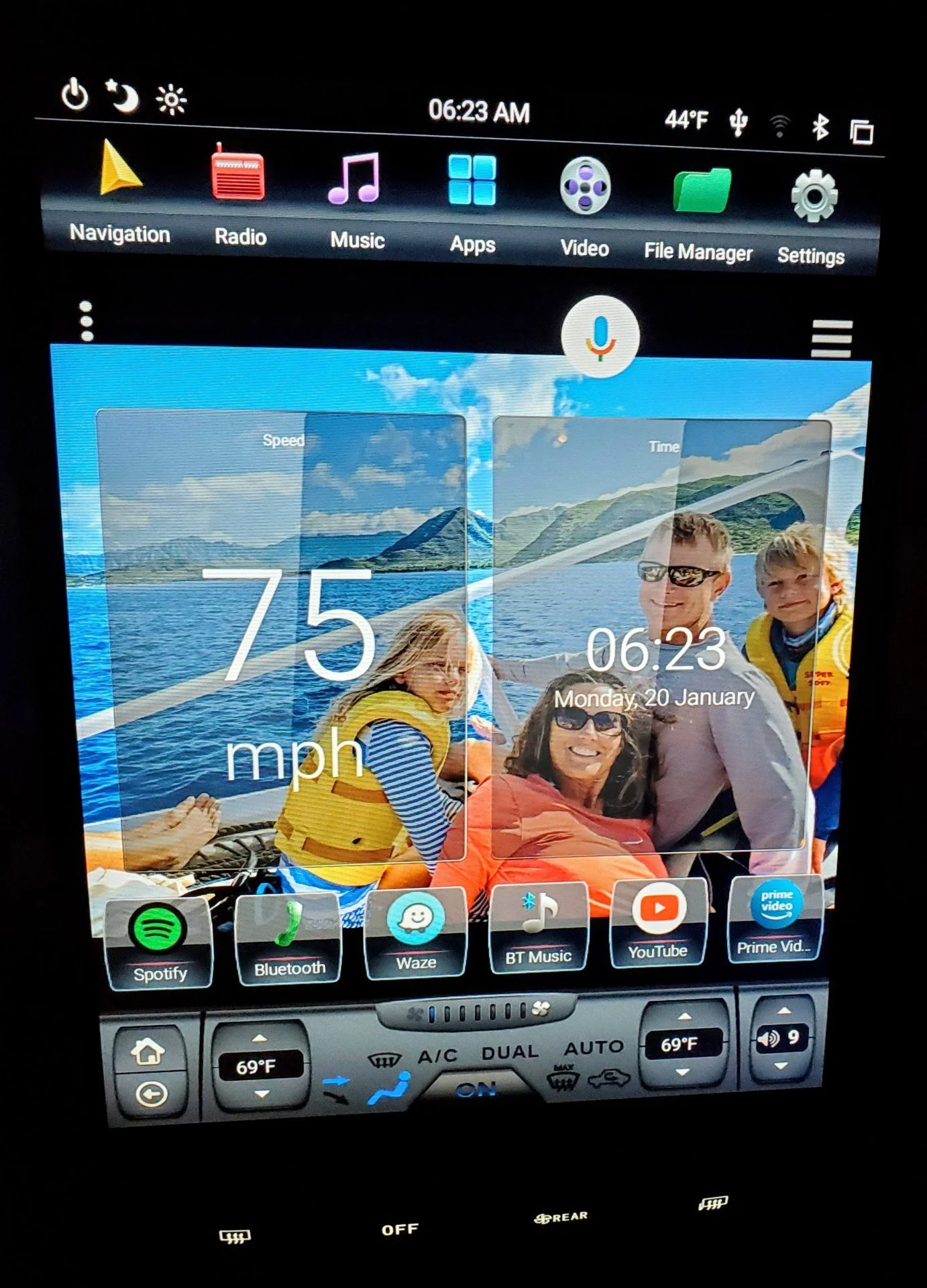

For those who have questions about my install and experience to this point with the PX6 unit in an '06 LX, feel free to leave them here and I'll do my best to answer them or capture photos/video. I've also had plenty of time to assemble what I consider to be a "core" set of apps that improve the unit significantly from the factory setup.
@Ell Ex I'm very interested in the core set of apps you've been using. Been running the PX6 for a few months now and am curious what apps could help streamline things a bit.
@21jacob21 First and foremost, if you don't already use Car Launcher Pro as the interface, that's my top recommendation -- it completely changes the way you interact with the unit, and all for the better.
For my local music and video files, I've settled on VLC for Android. It works perfectly with the vertical screen orientation and has the best media file organization and sound adjustment of any other media app I've tried (and I've tried them all). I also like that it eliminates the need for separate music and video apps. I also use Spotify and Google Play Music for streaming, and Stitcher for podcasts.
One issue to note: if you have a large hard drive connected like I do, the first time you run VLC it will take a long time to index all of the files into the library -- like really, really long. My 500GB SSD is filled near capacity with around 15,000 music files and a couple dozen concert videos, and the indexing process took upwards of 30 minutes. Once it's done, you won't have to go through it again, but prepare to sit in the car for a bit if you have a large collection because if you turn the unit off before it completely finishes indexing, you'll have to go through the whole process again next time you turn it on (ask me how I know).
For OBDII monitoring, I use an app called Car Scanner ELM OBD2. I used to use Torque Pro, but the app doesn't work with the PX6 unit for some reason -- no response to any screen touches. Not a huge loss since the Torque developers haven't made any meaningful updates in several years.

For anyone who has purchased one of these head units and has no intention of installing an aftermarket amplifier: I somehow managed to lose my RCA output plugs during installation -- must've somehow thrown them away, because I'm fairly sure they were in the box when it arrived. So, if anyone here has a spare set or a set you don't intend to use, I'd love to throw you a few bucks for them. I'm running an aftermarket amp right now by tapping into the low-level front speaker outputs from the head unit, but I lose subwoofer level adjustment and front/rear fading doing it that way.

Disregard my previous question @Ell Ex. I realize now that the app optimizes the home screen for the orientation of the device. Pretty cool!
I stumbled upon this, but Torque does work in "split app" mode. Apparently, the app doesn't work with our screen resolution and so the touch targets are about 2-3 inches above where they should be. Splitting the screen with Navigation and Torque gets things working correctly. You just need to enable the split screen option in the system settings I believe.
Thanks for letting me know. I suspected it had something to do with how the responsive areas were mapped to the screen, but there were so many other similar apps to choose from that I didn't spend much time trying to figure out what it was. Nice troubleshooting.
I'm not tech savvy, but I'm going to try these suggestions...thanks! I downloaded car launcher pro. The old altimeter/compass keeps showing up overlayed on top of the new display(the little white car). Is there something I need to delete so these programs don't conflict? Same for the VLC for android - do I need to delete an existing program? thank you in advance
I'm not in the truck at the moment, but if I recall correctly, there's a small square-shaped button in the bottom corner of one of the split screen windows that should activate whether you get full-screen or split screen.
Thanks! Remarkably, when I rebooted the system the altimeter went away. Love this new setup - thank you
If you figure out a way to replace the white car on the incline meter, please post it. I really, really don't like it. Thanks for the input.
If I can add two cents.. consider downloading and installing car launcher pro if you haven’t. Tweak all the settings and download themes and even install your own photos but it might make for a more enjoyable experience of having a tablet. Check Youtube for more info
