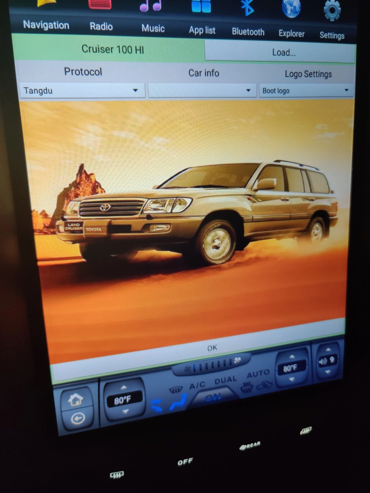

Anyone help me set the vehicle type settings back to default for a lx470

I had the PX6 version maybe there is a difference. Mine also had none of the 100 series artwork like yours has, it just has a yellow Lamborghini and a white sedan graphics. I tried to get support from Rhino through both Facebook and their email but it took them over 24 hours to reply on each, then I replied back and didn't hear anything for another 24 hours. After doing that for a few days I just decided to return it for a refund. Maybe I'll try again when they fix some bugs.

I have a PX6 as well. Been using it for about 3 months now. The startup picture on mine is the yellow Lambo as well. I think that is non-adjustable as this is an image defined by the software programmer during boot sequences (hard coded). Not really an issue for me.
