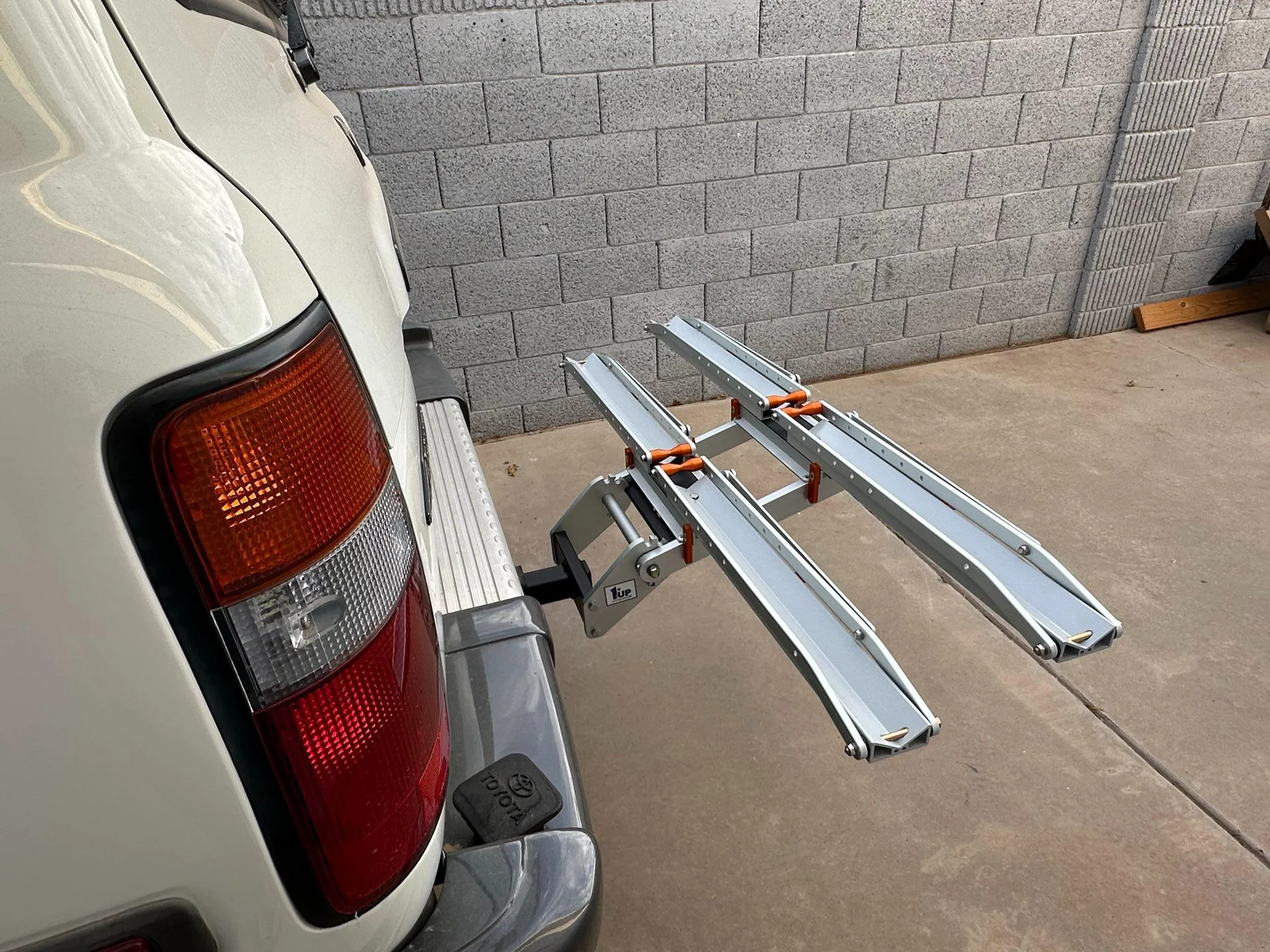

New rack came in today, for those that ride bikes you know that 1upUSA is the Toyota of the bike rack world. I've had the 1x for almost a decade now and it's still going strong. No fiber reinforced plastic to fall apart in the sun, just made in the USA of aluminum that probably came from china. These come in a 1x and a 2x option, each has the ability to bolt on two more trays. This means that the 1x base can have a max of 3 bikes, and the 2x base can have a max of 4 bikes. Now I need to find more friends to ride bikes with :)
Yeah, I swapped orange anodized parts onto it :grinpimp:

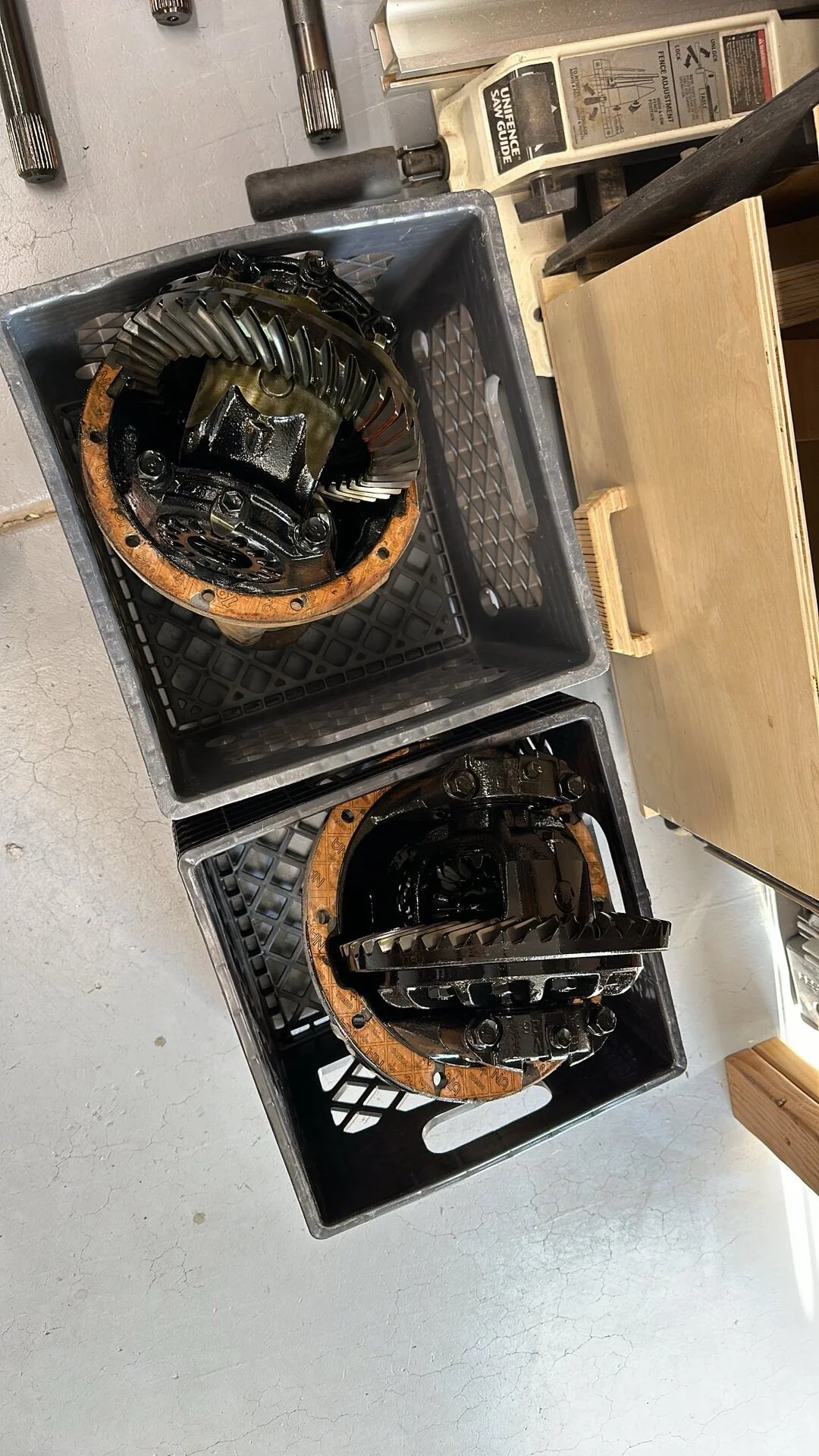

Nitro 4.88’s are at Ayer’s machine shop in Phx getting the REM treatment per Zuk’s recommendation

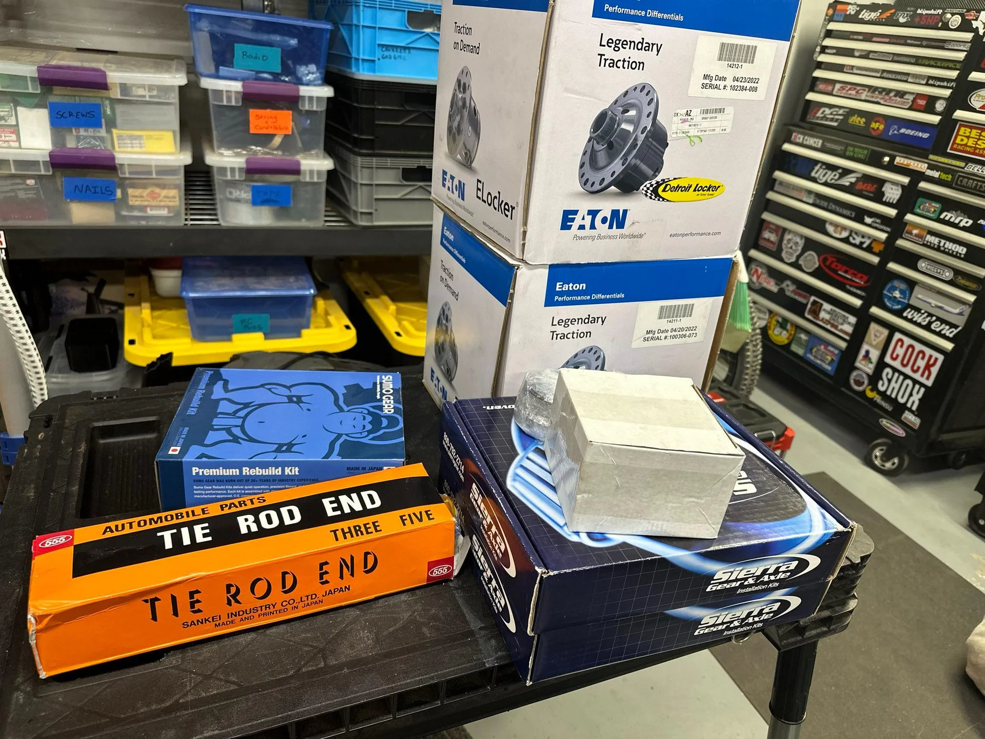

Thirds are out:

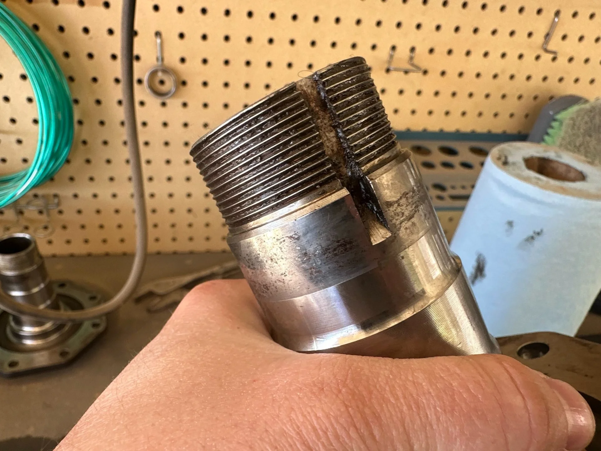

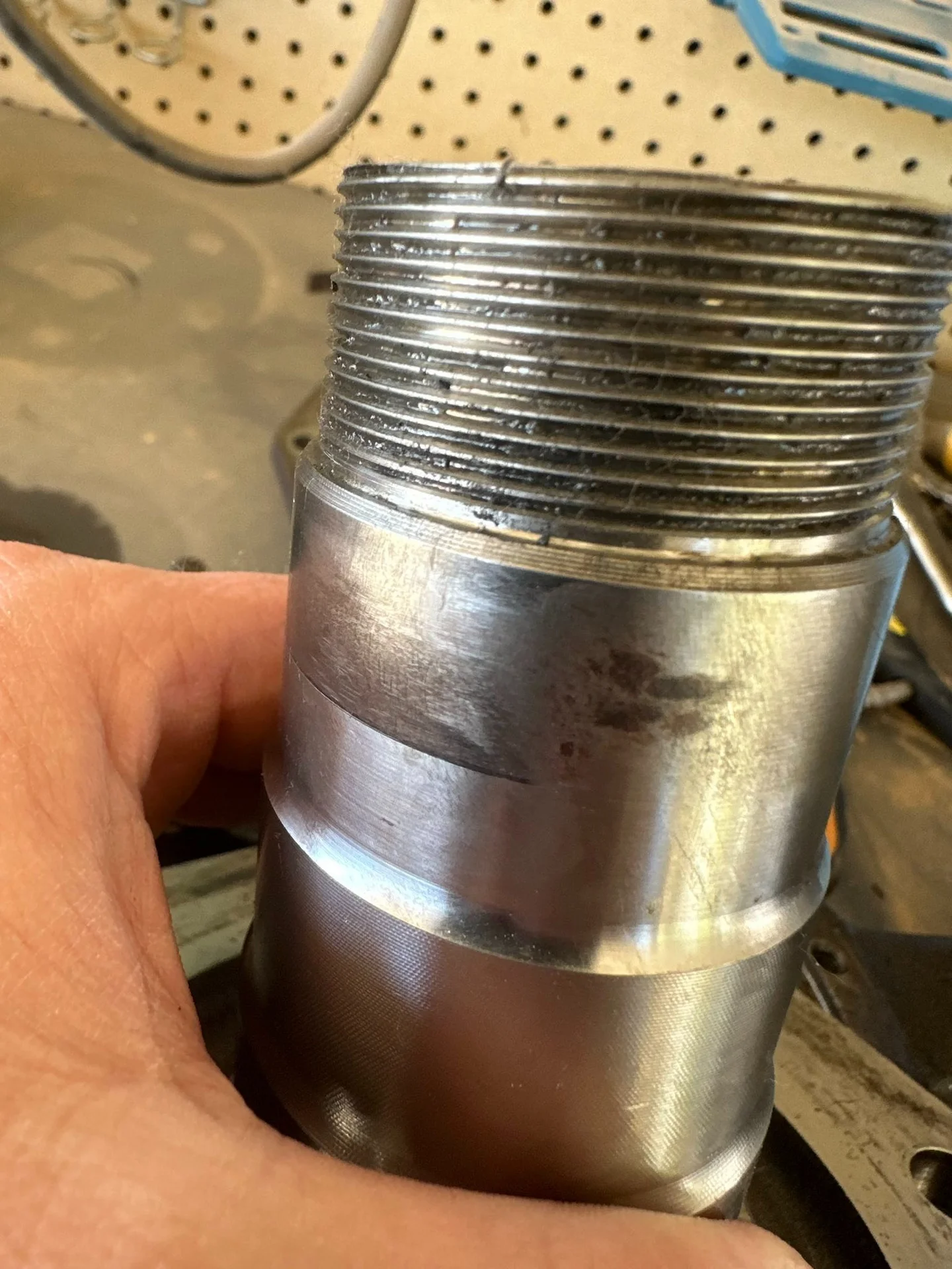

Cleaning up all the parts while the 3rds are getting gear + eatons installed. Looks like the inner ring of the outer bearing spun on the spindle.
Two new spindles (P/N 43401-60081) are on their way from the UAE. These new ones should have the updated spindle bushing with the integrated needle roller bearing

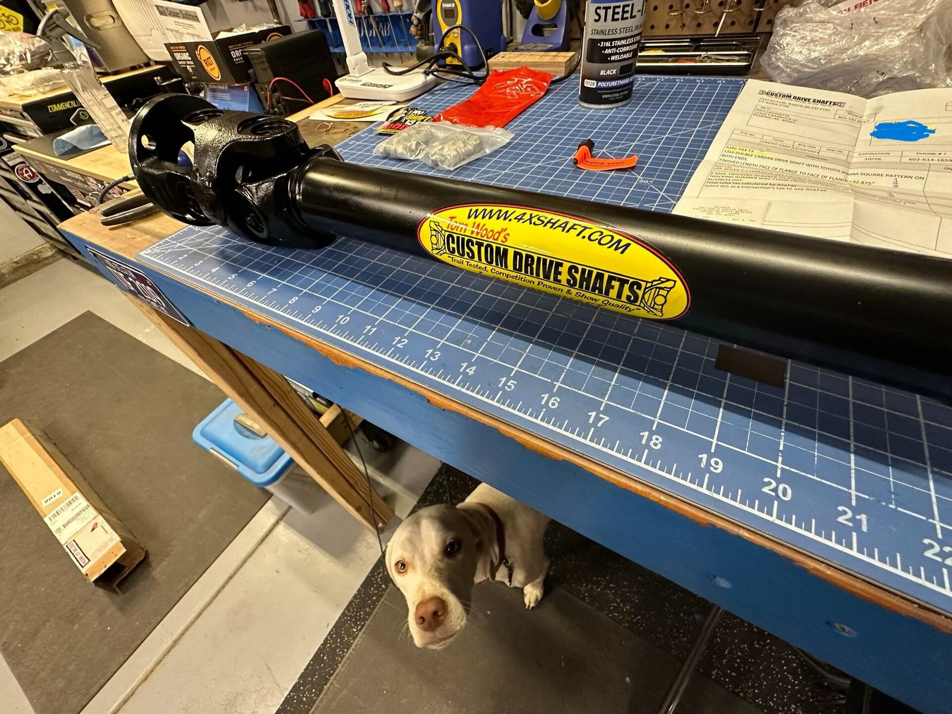

My Double Cardan shaft from Tom Woods arrived today as well. Those guys are FAST. I ordered this on Thursday morning last week, arrived FedEx on Sunday (today).
*Dog Approved* Passed full sniffspection upon receipt
