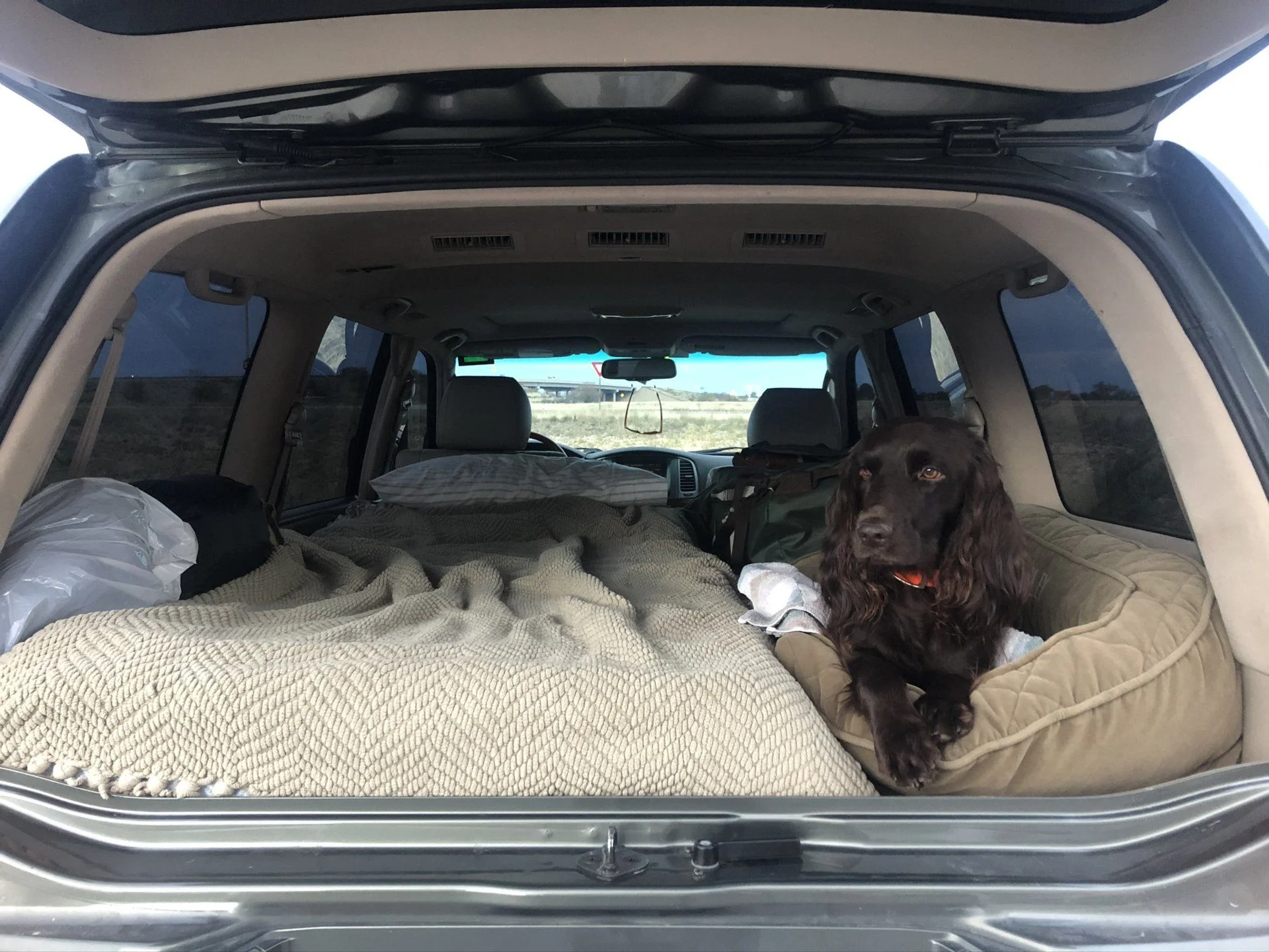

I’ve only slept in there solo, but I didn’t have any issues. I slept with my head toward the front and partially opened both second row windows for ventilation.
To keep the bugs out I ordered mesh window coverings. They worked alright, but definitely cut down on airflow. I was okay with temps 35-50 degrees, but I bet it would be pretty uncomfortable if it was hot outside. I also bought a cheap roll of reflectix and used that on the back window and furthest back side windows - mainly for privacy.

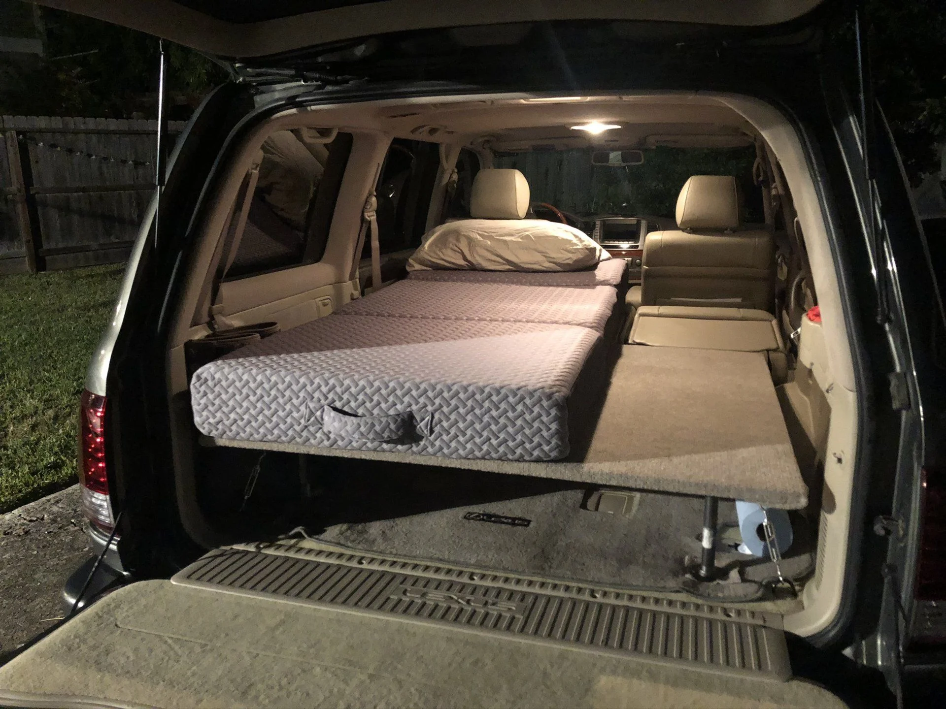

How'd you make that shelving?
The platform is pretty basic. Some 8” threaded steel pipe segments with flanges on either side supporting a 2x4 frame with some plywood on top. I put tan carpet on top and bolted it down with turnbuckles. I bought everything from Home Depot other than the turnbuckles. I just based it off of some pictures I saw in threads about sleeping platforms. It turned out okay, but I’m definitely getting a set of the KISS drawers when they are back in production.
