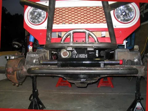

Made the mount/guard for the front steering ram.. It's plated with a piece of 1/4".. Also visible is the shaved down pinion flange, which is needed because of how close the ram is to the chunk in order to get good steering link angles. Damn thing looks like a serving tray... :bounce:

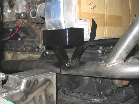

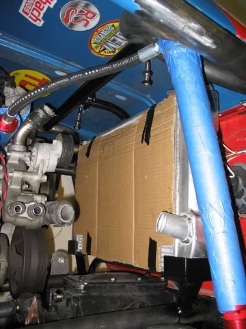

Also got the radiator mount made. Didn't want to hard-mount it.. you see what happens to aluminum fuel cells when they're hard mounted. This cradles the rad without stressing it. I used some dense foam I've had laying around as padding inside the mounts.
And just a shot from the side.. The lower links are now drilled & tapped.. DAMN that's alot of work! Uppers next week.
