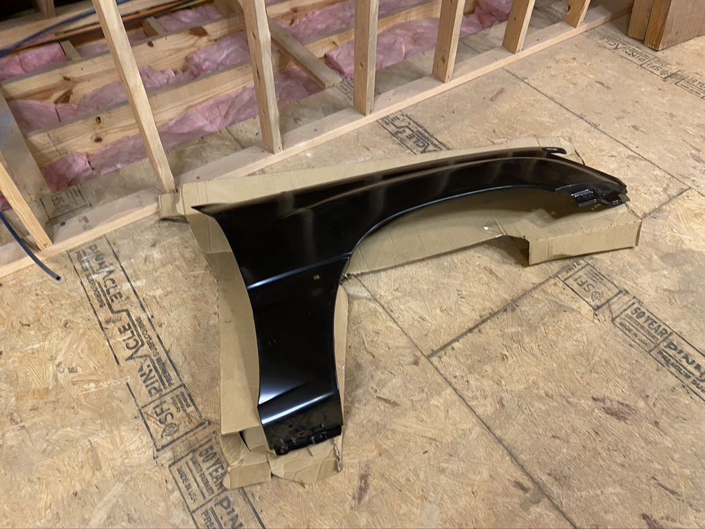

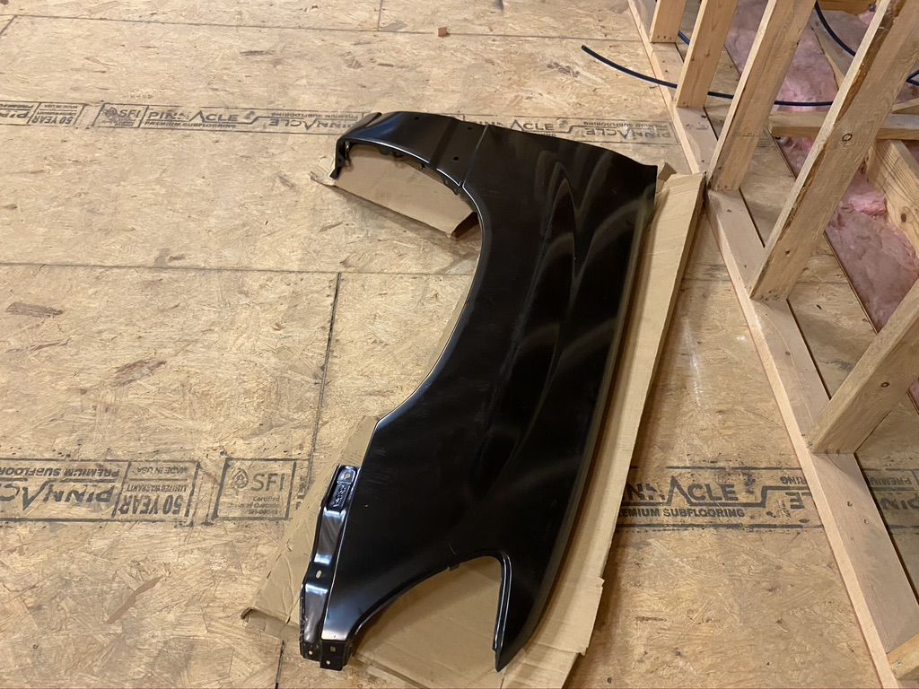

Just spent more on an OEM fender than I did my E30. $450. Cheapest I could find.
Not sure when I can spray it, but at least I have the dang thing. Next, I need some glass OEM headlights.

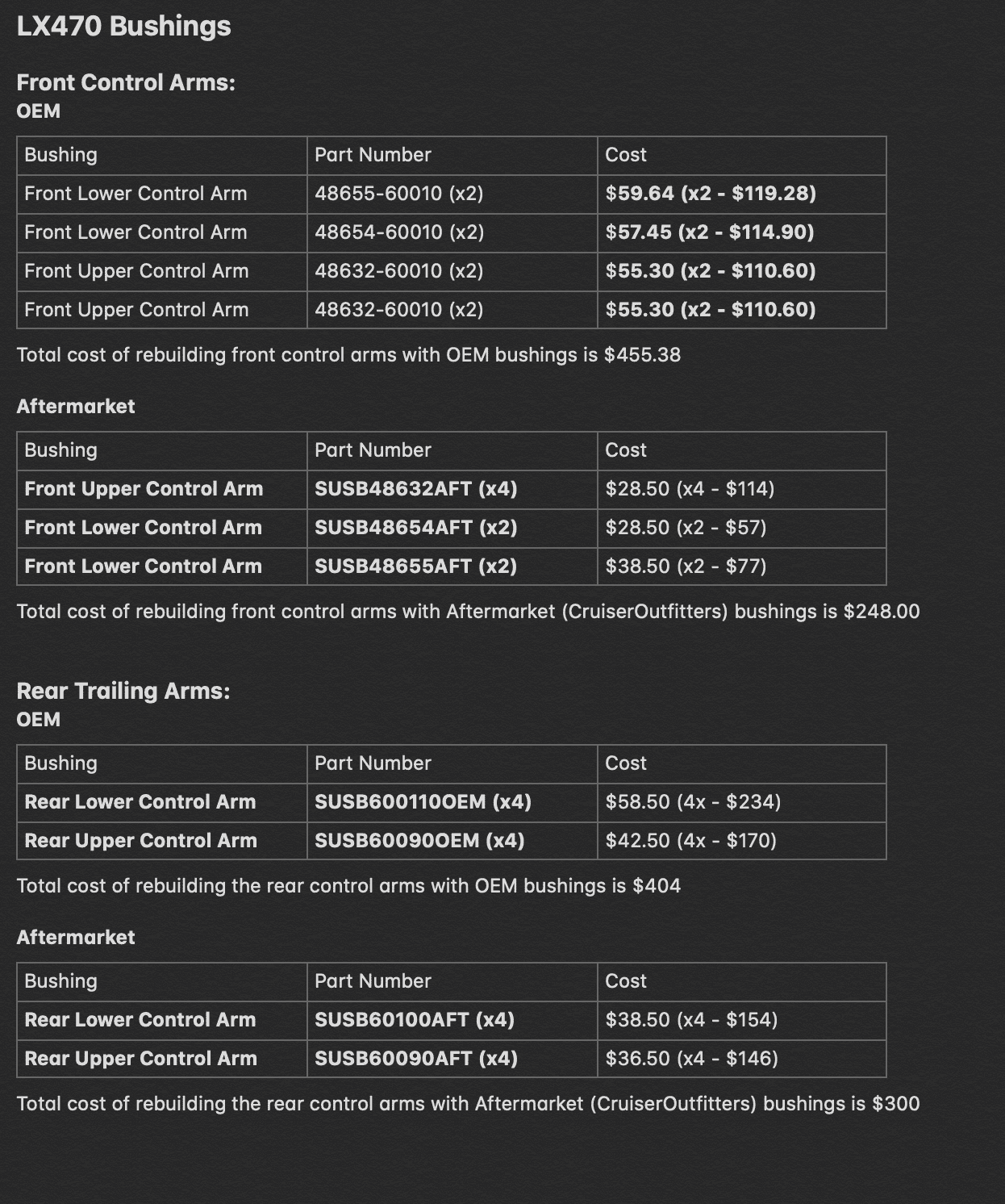

For the steering rack, I'm pretty sure I used some SuperPro bushings:
I still need to find and replace upper/lower control arm bushings, upper/lower trailing arm bushings, and the panhard bar bushings. They're toast now, just too expensive to replace right now.
I did make this list of bushing options for control and trailing arms, based off of diagrams and CruiserOutfitters
Attached is a PDF with copy-and-pastable part numbers
Thanks for that list. What are your thoughts on the poly bushings for the steering rack? Are they too hard (too much vibration in steering wheel) or are they smoother, tighter, and just a good purchase
I think poly is fine. You don’t want much flex there. It’s not designed to really “soak” bumps up like the suspension is, just keeps the rack in place without being directly bolted onto the frame. I enjoyed how tight the steering felt after I finished. I’d go rubber for just about anything else.

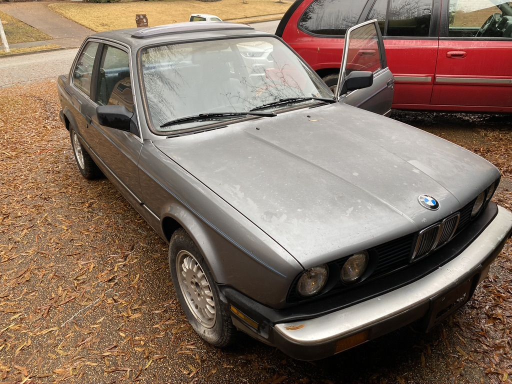

What's the plan for this?
Lemme guess, 1986 325 (without the e on the trunk)?
Haha, that one is long gone now, was a 1987 325 (without the e, but still had the 2.7 eta). I had a wreck in it, totally fubar’d the driver’s side. I put the motor in my convertible, wrecked that, fixing it currently. And I have another ‘87 sedan I’m doing a full resto on.
