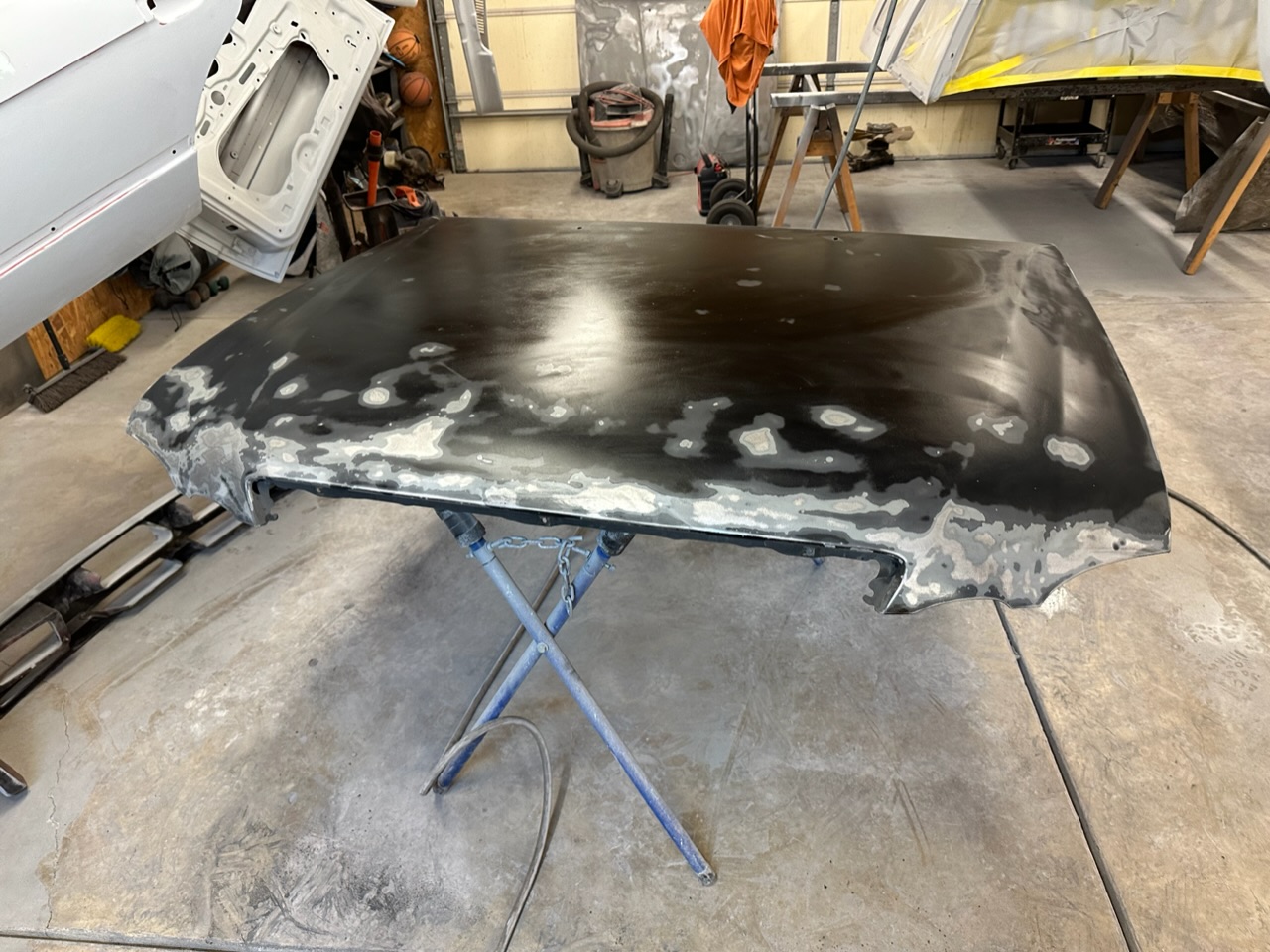

I’ve had this car for close to five years and in that time, all my highway driving has resulted in the front end of the car looking sandblasted. My hood was nasty and scarred by bird poop and sap the day I got it. Not too long after, I found out my passenger side fender was filled with bondo when I hit someone in a parking lot.

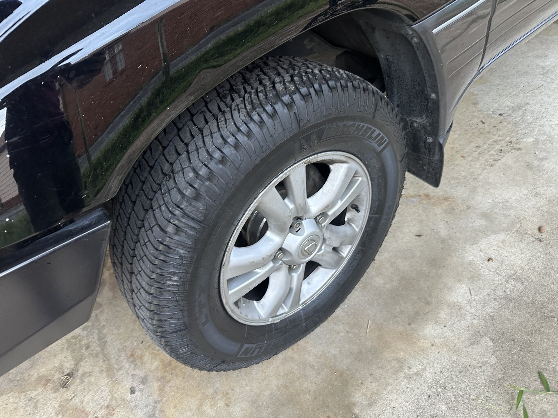

I was also about ready to replace my Nittos finally. They were pretty decent and wore really well, lasted a long time too, 45k/4 years, I’m happy though. I ended up with Michelin Defenders and I have to say the ride and noise is so much better.
Still 265/75R18s

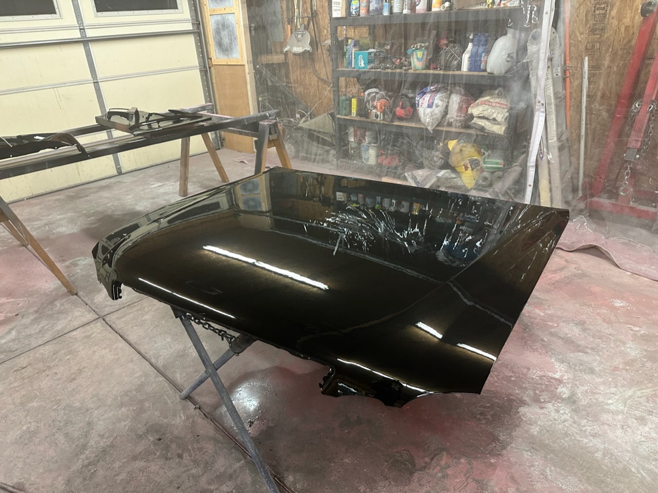

Hood looks great. Mine needs the same treatment. Can you outline what you did and products used? Thx

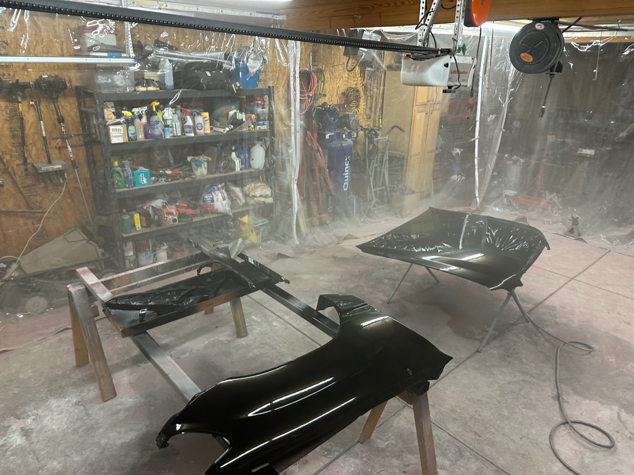

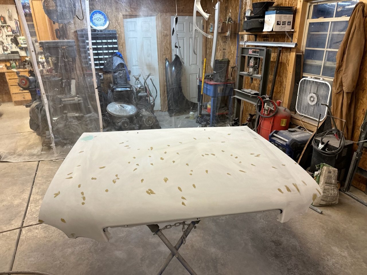

I completely repainted it.
I started by sanding off the old paint and getting it down to primer/bare metal where there were dents. Filled in dents with Bondo and tapped out what I could. Thick coat of primer then block sanding for hours, little bit of wet sanding. More primer. Then color, and more wet sanding. Finally clear coat and wet sanding, then cutting/polishing. I got all products from a local automotive paint store, and generally followed their recommendations. Spraying is the hardest part, dust is your enemy.
Did you use a spray gun or cans?

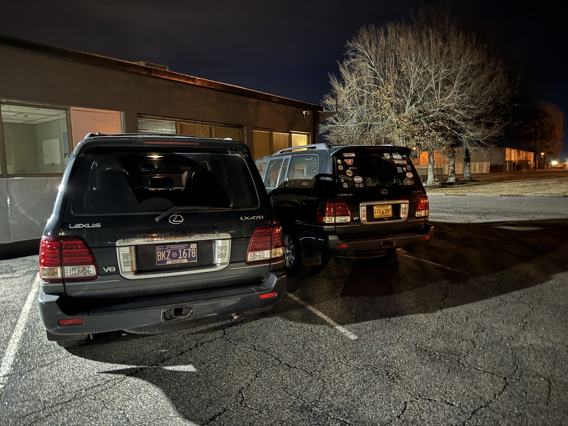

I have made a questionable financial decision but I think it is for the better. A friend was involved in an accident with his 2004 LX470, and I happened to be able to purchase it after it was totaled. Just now need to find some small things and get it fixed.
Car has ~229k, pretty much stock with a few additions. Fat stack of service history. Runs great, rides good, no frame damage, good truck.

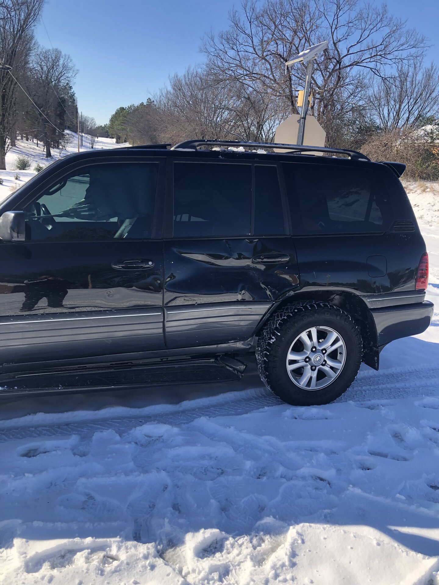

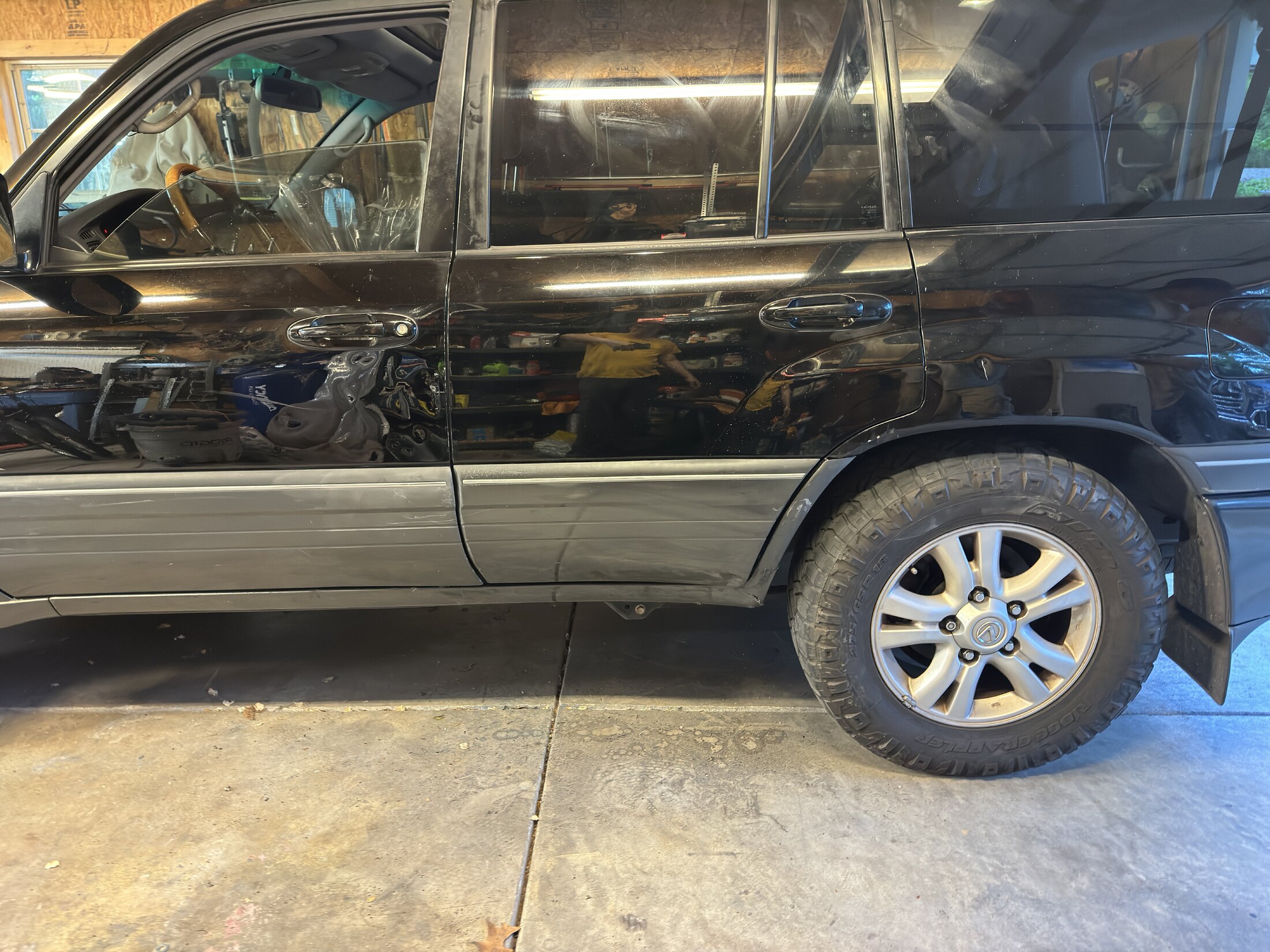

Finally got around to fixing up the wrecked ‘04. Sold it to my cousin, a former LR enthusiast so we finally have turned him from the dark side.
I got a used door, we swapped glass, trim, handles, etc, and ended up doing a little bit of work on the body just to get the door opening, closing, and sealing properly. Not perfect but for $0.00 in actual parts and labor, it’s great! No wind noise or rattles.
Swapped brakes, front and rear. Did the interior HVAC air filters and new paper air box filter. Heater Ts and radiator was replaced less than 25k miles ago. Did all the little Techstream stuff like disabling tilt away steering wheel and DRLs, enabling all doors unlock with 1 press, etc.

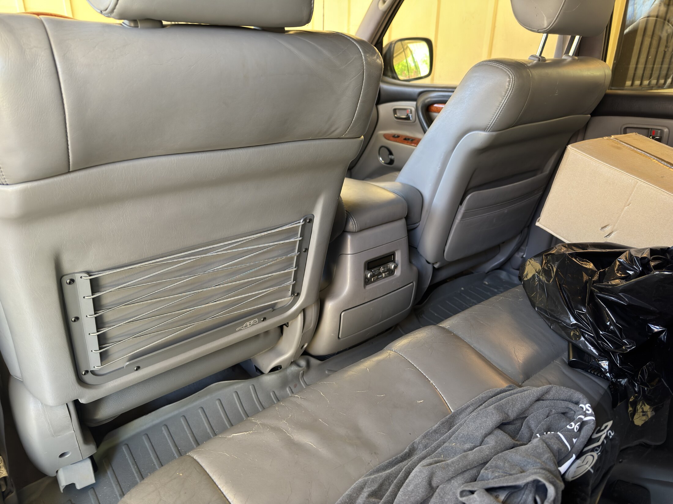

Since day 1 my seat back pockets were pretty much trash. The bottom dowel piece on both were snapped and the elastic material was just too stretched. Found this great product by @plaidwagon and it was pretty easy to install. Only had to drill 2x holes since the holes for the LC style pocket are there. Going to do the other side when I get the clips in.
Looks awesome, thanks for sharing!
