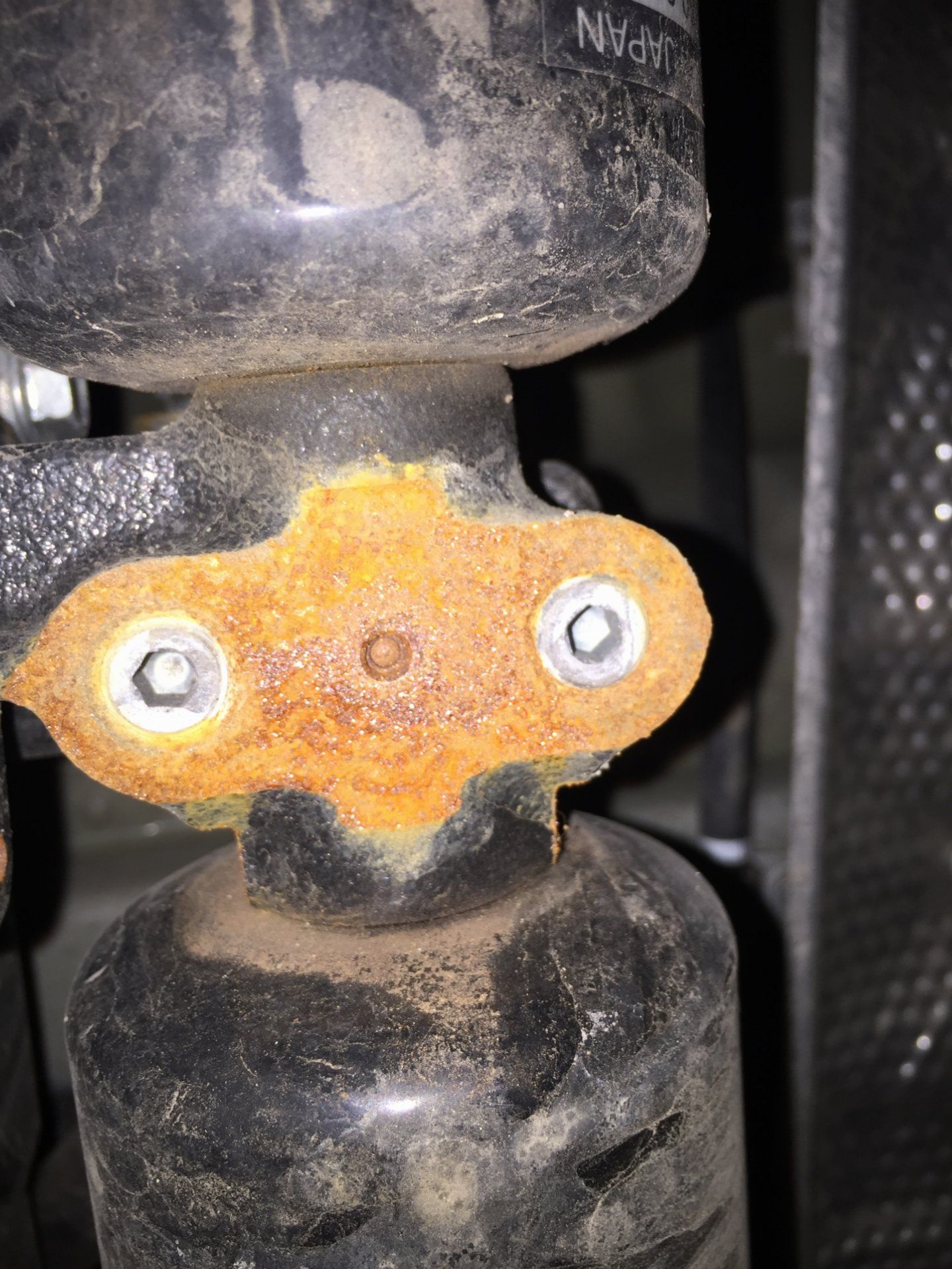

Just another reminder to check your KDSS Valves. The rest of the undercarriage is spotless, the KDSS not so much.
Thankfully not frozen and I was able to open them relatively easily. I used a wire brush to clean them up
and then sprayed some rust/corrosion inhibitor and some plastispray
Just a friendly reminder to keep an eye on the KDSS

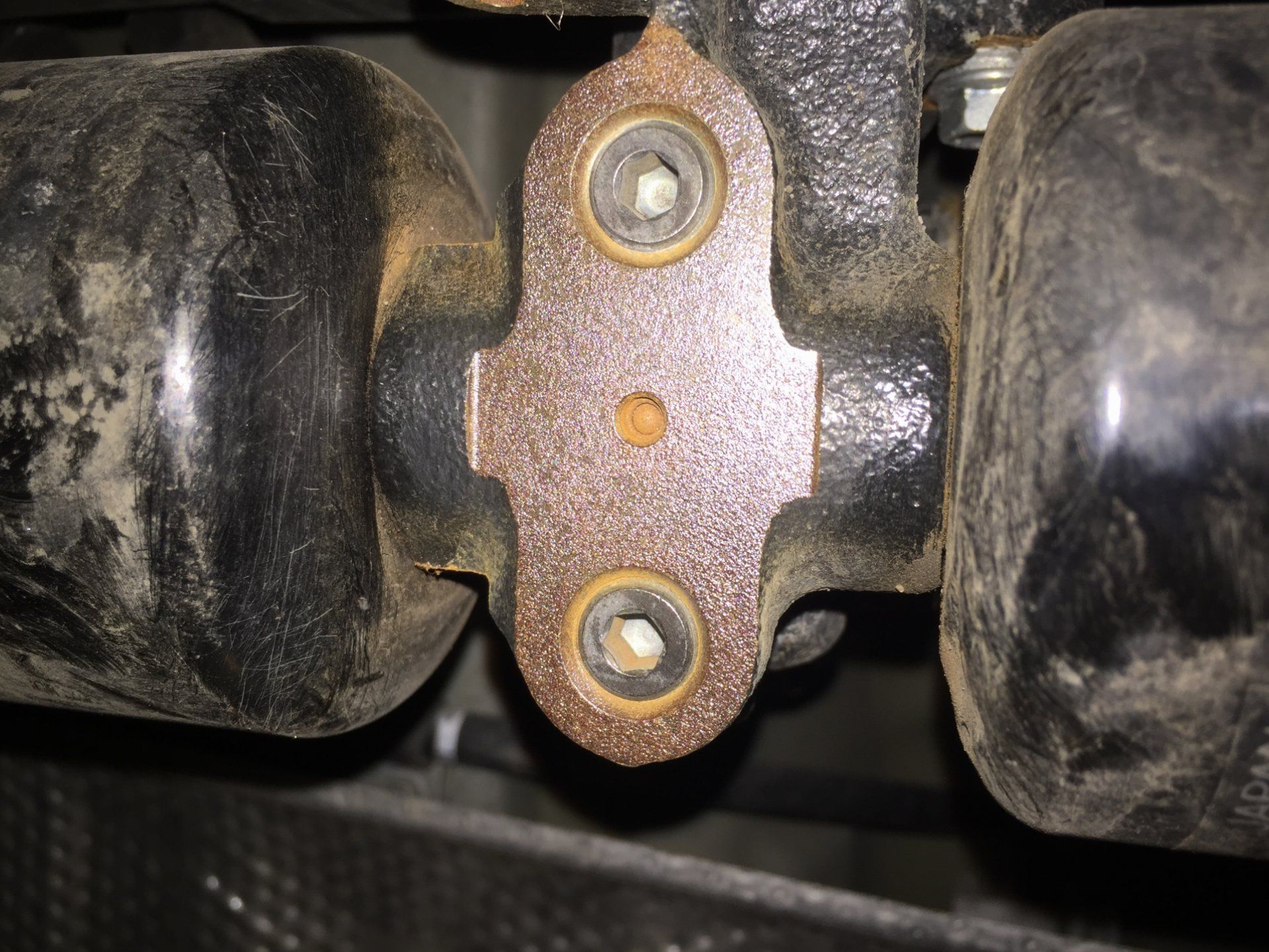

I have a test of sorts underway, however, as a scientist I learned long ago that the collection of data takes time. I read about the dreaded KDSS corrosion problems before I picked up my new LC. I considered various options to head this off at the pass and decided to use LPS-3. I drove the new vehicle 20 miles from the dealership, pulled off the plate to reveal a nice bright shiny new valve and slathered it with LPS-3. I had a tube of high quality marine grease in hand but opted for the former. My intention is to do the same at least at every 5k oil change and maybe at closer intervals. Either what I did should work/help, and others may benefit from my data years down the road, or some one will continue the experiment with another option so that the entire Mud community will benefit.
Just another reminder to check your KDSS Valves. The rest of the undercarriage is spotless, the KDSS not so much.View attachment 1443046
Wow - and you are in Texas! Not exactly known for rust and salty roads!
Excellent - I look forward to your results over time. I'm sure future owners will thank you too!
Thanks for the tips. I crawled under my 600 Mi. LC, found the valve, hit it with some Emery Cloth (just to make sure it's fairly clean), then liberally slathered it with marine grease. Will repeat this every oil change. Hopefully, this preventative measure helps me side-step the ugliness shown in some of the pictures here.

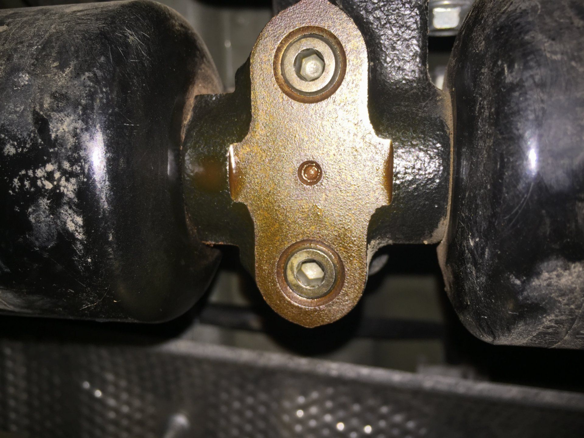

I did that in late Nov when we had the oil last changed. When I checked it this weekend it was looking rustier than I'd like to see. Even with a mild winter, limited salt, and hitting the undercarriage semi-regularly at the car wash, Chicago is still going to eat the KDSS valve alive.
