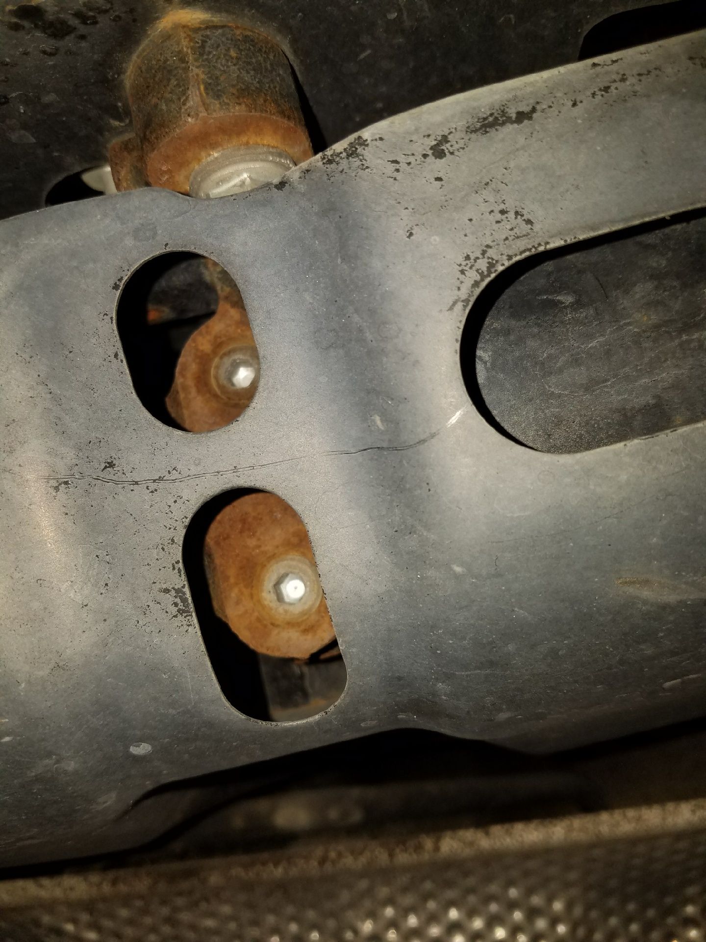

This doesn't look too bad, does it?
I would give them a quick soak, then expect them to break free without too much fuss. Rest of the underside of the truck is in great shape.
